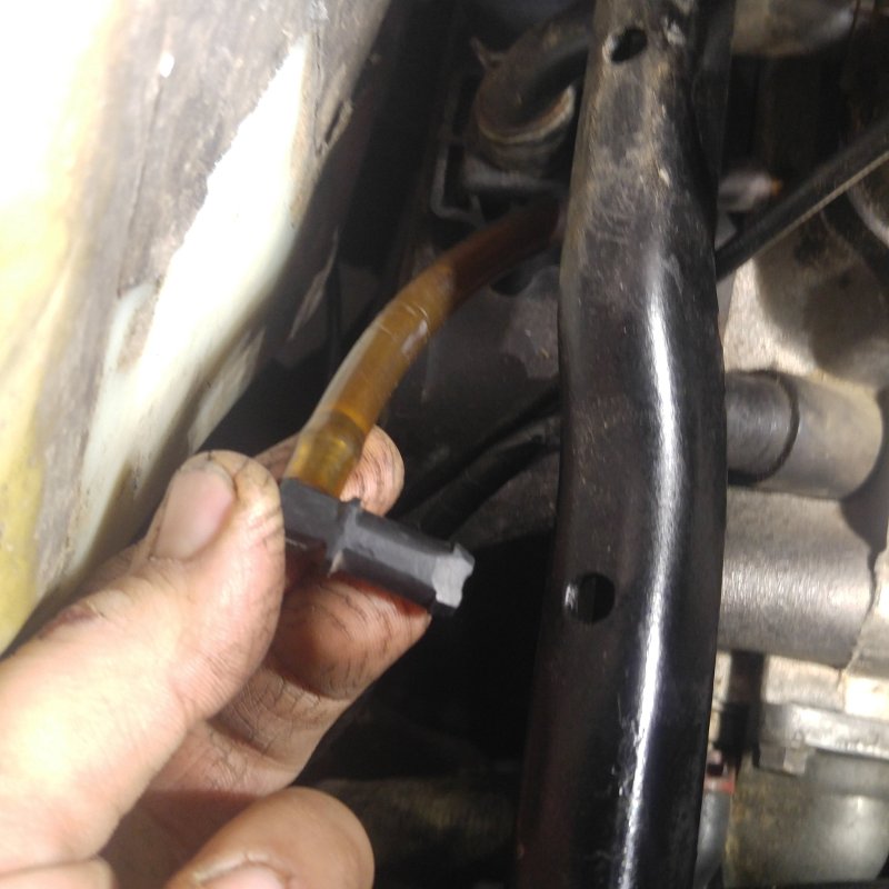

still have not found our ware it goes tryed putting it to the carb on one of the vacume ports it runs now just will not rev it will stay running as soon as i hit the gas it bogs out any one no whats up
There  is a service manual  for  your  Polaris in the download section . It is in  multi-part pdf  sections .A  quick  glance   at  some of them   on the engine  and carb didn't  show that  hose  , but you might  find it  in a  more thorough read through the complete  manual.  Could it  be  the  impulse  hose  for the  fuel  pump since it ports off the  intake on the engine side of the  carb.  If there  is a separate   pulse  hose from the crankcase , you  could try  blocking that hose off and  see  how the engine runs.  With it  open  the engine would be  running  very  lean. That  looks like   a  90  degree connector  to  join to another  hose   leading possibly to  a vacuum motor  to   operate   something on the  quad.
2 minutes ago, Ajmboy said:
Isn't that just a fuel overflow/vent tube?
Can't be .  it  comes off the intake  port of the  block  downstream of the carburettor. It is connected  to the  vacuum  of the intake  manifold .
I have to read better, I thought that was hanging on the bottom under the quad.
