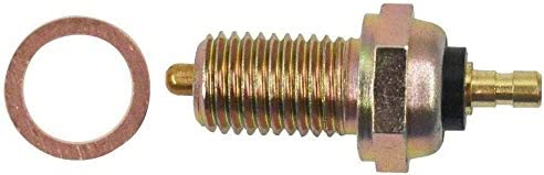

I maybe thinking of the 400 Kodiak should be close to the same place it would be a little sensor that screws into the engine with a wire that attaches to a little nub looks similar to coolant temp sensor.
The photo I posted was the part listed for neutral switch for 2004 Kodiak 450, it also fit numerous other bikes, I did see there was 4 on parts schematic not really sure what the other 3 do but I think they are under the air box.
Thanx  for all the info---OK I know where those are--If they are for each gear why is there only 4--L H N R P--I  was looking for a sensor that did all 5
