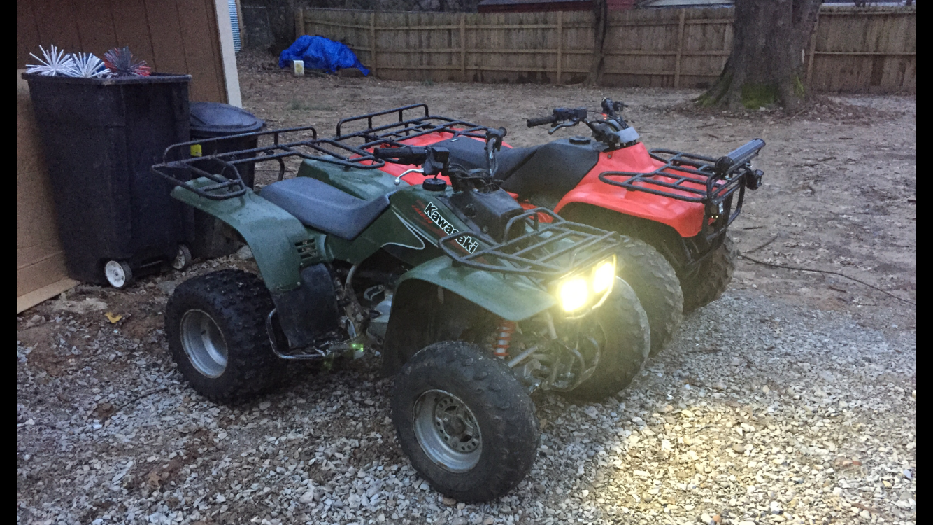

No I don't know if AC/DC.I Bought from amazon in which said for a Lakota  kef300. I bought new carb,tires,light kit,brakes,tail light, seat etc. I have fenders and racks off. Starting to go through with a meter to see if anything measures funny. I said screw it and already order, stator,pick up and gasket. I have to much into it now to give up. Plus I like the little bastard..This pick was a little over a week ago. All was working, till it sat for a week..😳
Hahaha little bastard!! I love it. If I had to sum up the way I feel about all of my bikes past and present I would put that way.  I love the bikes i get and feel the same way! Anyway I would guess it’s the stator. It’s an easy test with an ohm meter.  But a new one cant hurt! Keep us posted I’m curious how it goes.

I have been reading for the last couple hours..I will wait till next Wednesday to receive new stator,pickup,rectifier and gaskets. I just don't understand how one day it is running like a raped ape. And the next it just rolls over with not one spark.
Like my ole man always said.
"If it wasn't for bad luck, I would have and luck at all.." 🤣💩
It happens.  People jump start their bikes with a car or a jumper pack and don’t realize they can blow up a stator coil.  All sorts of resons.  Welding on a bike can do the same. I’m at the point where I can’t wait for a bike to give me the best problem it has to offer. Bc the bottom line it’s that it’s a machine and it has a diagram and if you can understand the diagram you own that bastard. So let’s get after it and fix that thing and make it run.
