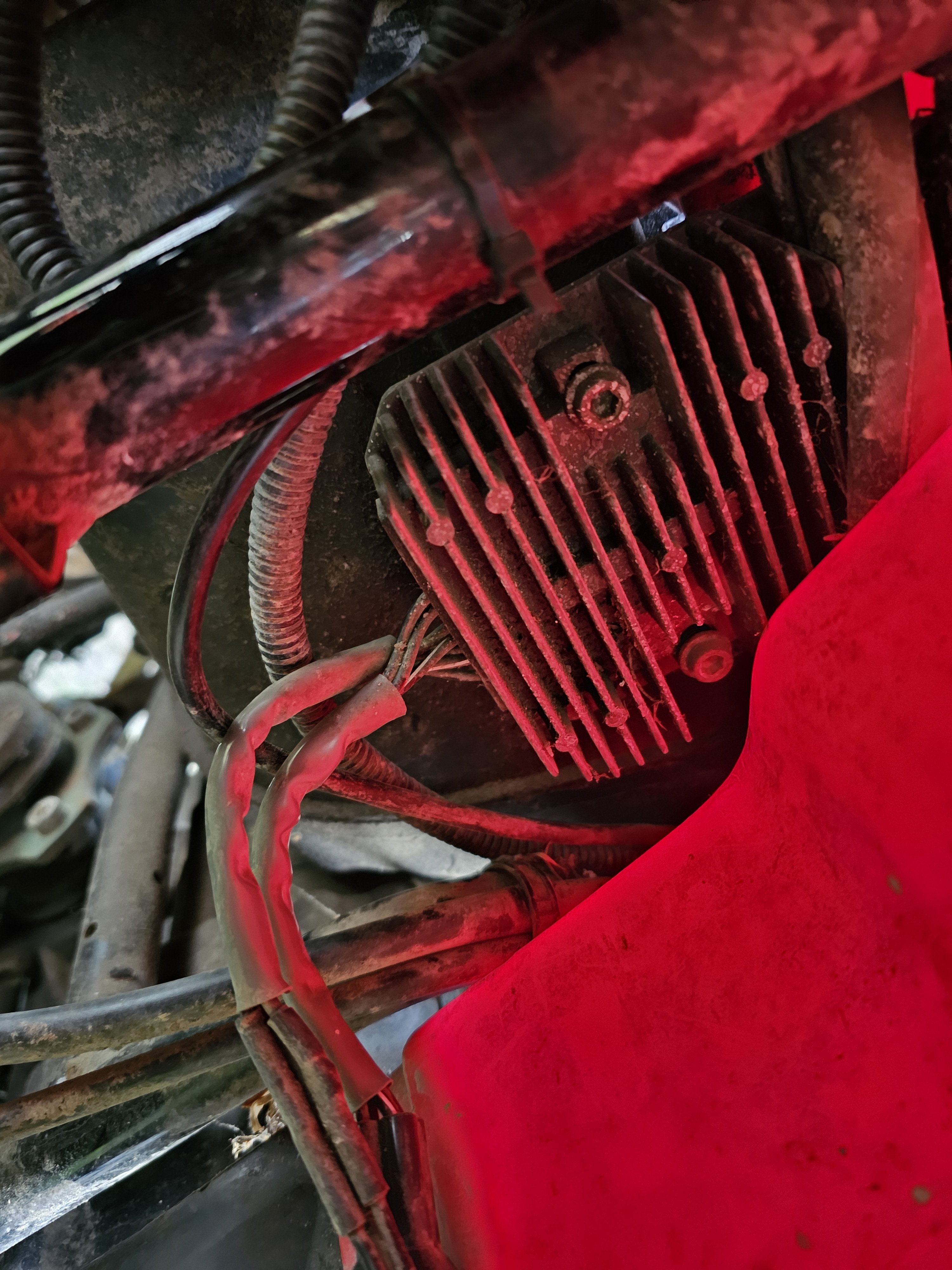

His I have a 2000 suzuki quadmaster was running fine one day on the snow to plow, 5hen next day no power to dash, nothing lights up have power to power fuse, traced to the regulator. Power in but not out, does that explain the no lights or pull over start? You can jump silinoid but just turns over. I'm at a loss for this thing.

I replaced key switch all fuses, battery's fine winch works perfect even now. But I have no power or fire.
Well wires do break. You need to use either a test light or a volt gauge and trace the wire from battery to fuse to switch, checking power is getting through. Sometimes we can find a broken wire by wriggling them one at a time near their ends where they connect to the metal terminal and they feel too flexible if the wire is broken inside, and if we have the key on at the time, the power might flash on.
When you say you traced the power to the reg, and had power in but none out, do you mean it was running and not charging ?

No with the on or off I was getting power past the fuse, past the silinoid to the voltage regulator. I followed my hot wire and nothing after the regulator as seen in the picture.
