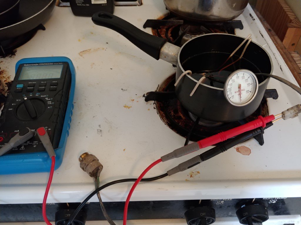

When I wired in the LED lights on the front rack, I used the two pin trailer connectors to make it easy to unplug if I had to remove the front rack, the fan uses the same so I unplugged the lights and plugged the fan it and had her run it manually. This was weird. Got home and pulled the sensors and tested them by heating up some oil.
The sensors tested good, and jumping the plug on the quad, the fan runs, so it was like WTF? Turned out the pins for the sensor were not fully seated in the connector.

That’s a common problem with lots of connectors with these bikes.  Most of the time it’s a simple fix but we (even myself) in the past have started pulling parts off.  Now that’s one of the first things I look for and open up, clean and add dialectic grease and check for either a slipped out pin from the base of the clip or I’ve also found that wires break at the bottom of the connector but the vinyl insulation is still good. It’s usually very flimsy when you bend it.
But that’s a great find and an easy fix!
