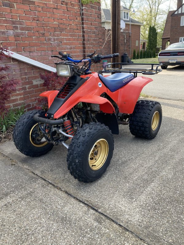

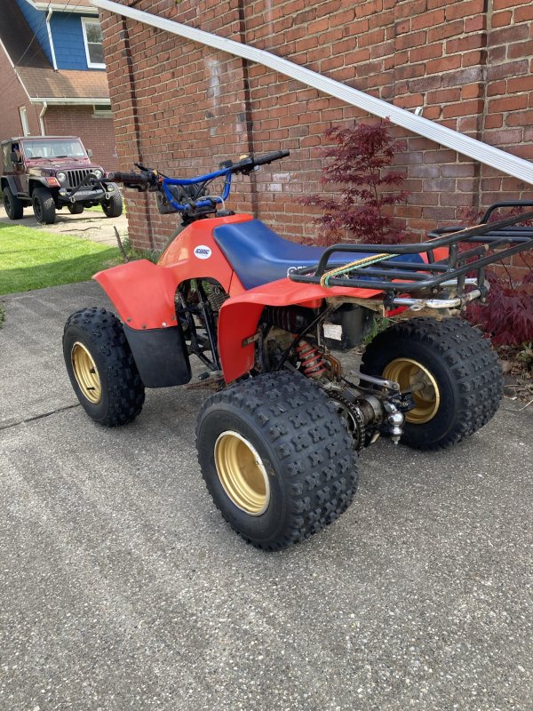

It turns out it didn't need a piston and rings.  The black smoke at cold start was caused by valves out of adjustment.  It needed new bearings, rear brake caliper, air filter foam, oil change and filter among other things.  Nothing major though.  All good now as you can see by the pics.
Yes I'm riding again.  She looks almost like a new one now.
