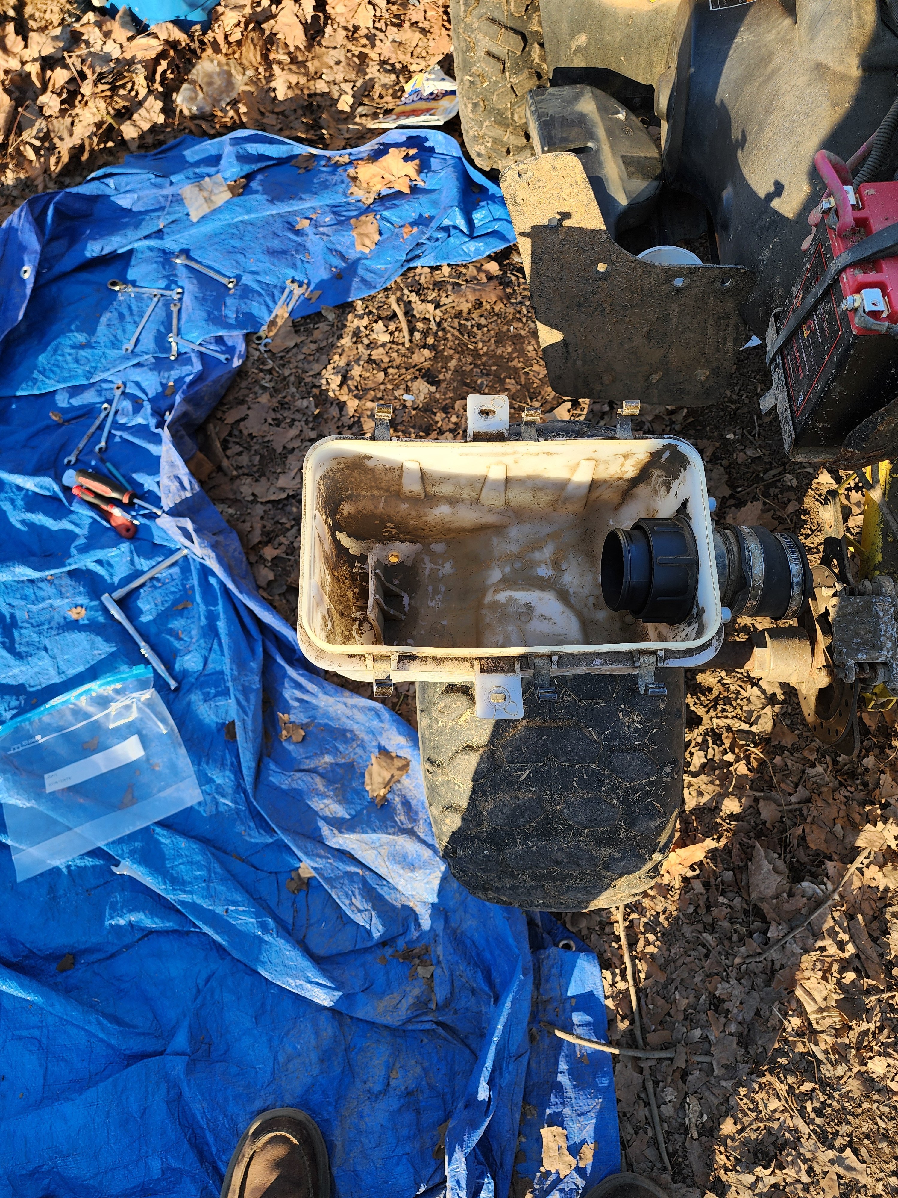

Well I got the carb off all cleaned out and put back on. I ordered a new air filter. I think the one that was in the air box must have came on the machine it's horrible looking. The air box is filthy, so I've got to clean it all up before putting back in.  Here's what they look like. 😨
I didn't really see anything that stuck out but there was some tiny debris. I'm hoping cleaning everything out will cure my problems. I'm going to put just enough back together to start and run. If it's still flooding, the only other thing to try is checking the float level. I got a new float needle when I put carb kit in.

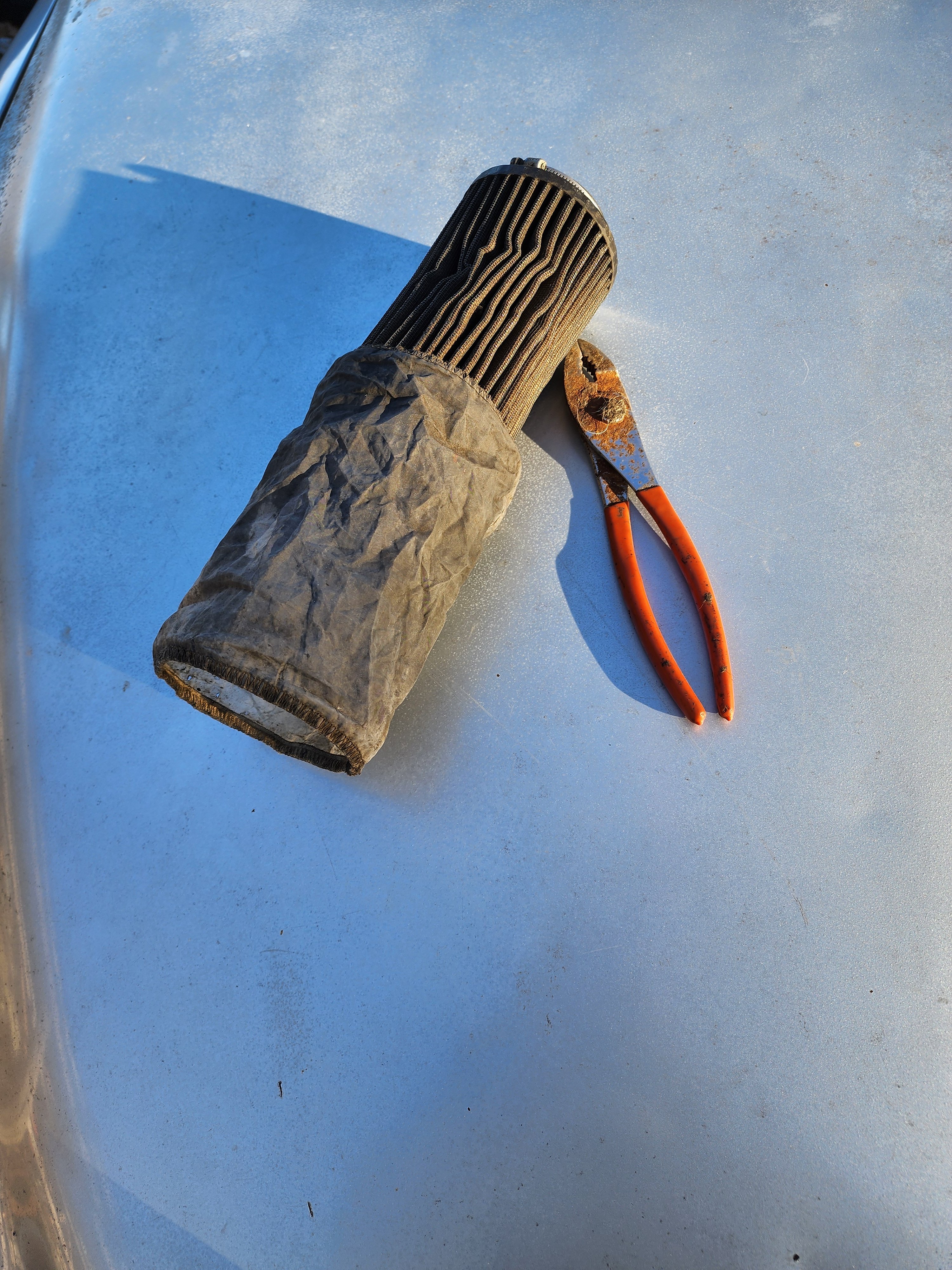

2 minutes ago, Mech said:
That filter looks like mine and just fine to me..
but I'd oil those pliers !!
I already ordered a cheap filter I guess I can put it back for a spare
Oil traps the dust and stops it working it's way through the filter or cover.. Engine oil is fine. It does need squeezing out because too much oil can make them run rich. If you give it a good oil and work it through with your hands, then put the cover in a rag to soak up the excess when you squeeze it in your hands it will come out about right. Just squeeze it, don't wring.
And I was just kidding about the old one looking fine.. Even I would change that one.
I never oil my filters no particular reason, i guess so if i see them oily im having some engine blow by. , i do oil 2 stroke filters, they get oily anyway.
I like the pliers it took years to get that amount of patina, priceless.
What oil are you going to use, i think they are all good, just curious as to what other members are using.
