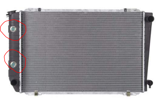

Sadly this may be the last post I make on the old '11 Crown Vic (320k).  So yesterday I heard a quiet hiss coming from the front which turned out to be a very small radiator leak...in the middle of a fin somewhere.  Doing errands around town today I kept extra coolant with me and added it as it needed.  After filling it up I make a 60 mph trip to a nearby city about 20 miles away.  When I get to a stop at the bottom of the off ramp, I hit the gas it it doesn't move.  No extra lights on the dash except for the check engine light which was already on for something else.  I put it in park and back in drive, tried all the gears but got nothing, not even in reverse.  Thinking it might have something to do with my coolant situation I checked it and ended up putting in like 1.5 gal of coolant which is much more than it's taken before.  Only thing I can imagine is that the leak got worse on the interstate and I didn't notice it.  Did the no coolant issue cause the transmission to overheat somehow?  There was a slight burning smell in the cabin so something definitely overheated.  The overheat light on the dash never came on (I think I have one?) and the engine ran fine the whole time.  I was traveling at 60 mph though so I wonder if that would be enough to cool the engine off while the transmission still overheated?
What in the heck happened and what do I do, besides sell the damn thing.
I  doubt the lack of coolant  affected the transmission..  Most transmissions  can  be  run a  long time with the  coolant  lines blocked off unless they're being run under very heavy  load. The  lack  of coolant  would have seized the motor  long before it  hurt the tranny.
