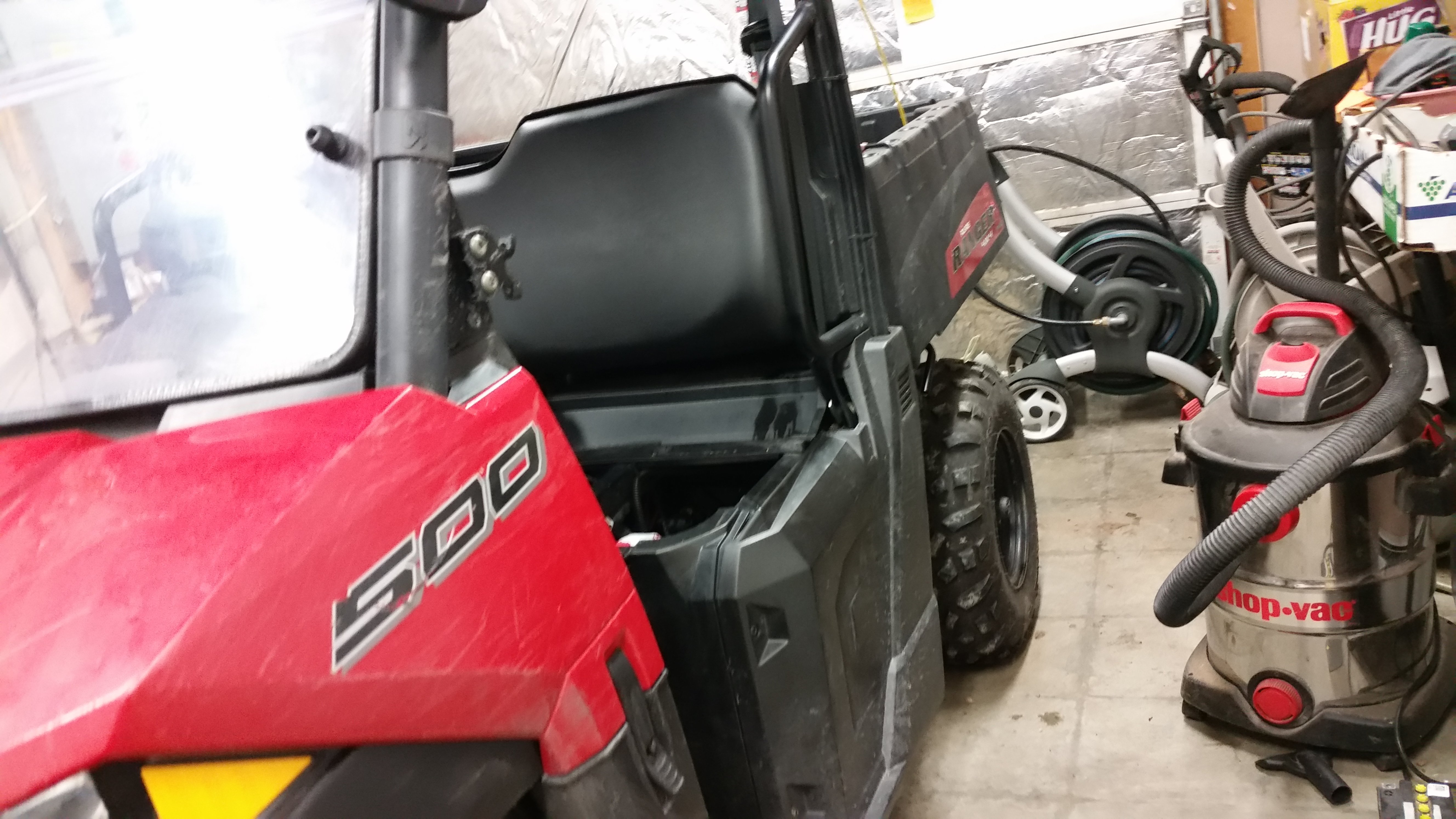

It looks like it was sunk deep.  Found rocks and sand in the roof, milky oil in the air filter box, water in the fuse box, etc.
So far, I've cleaned the air box out, vacuumed most of the rocks and sand, checked the engine, trans and diff casings for cracks/leaks.

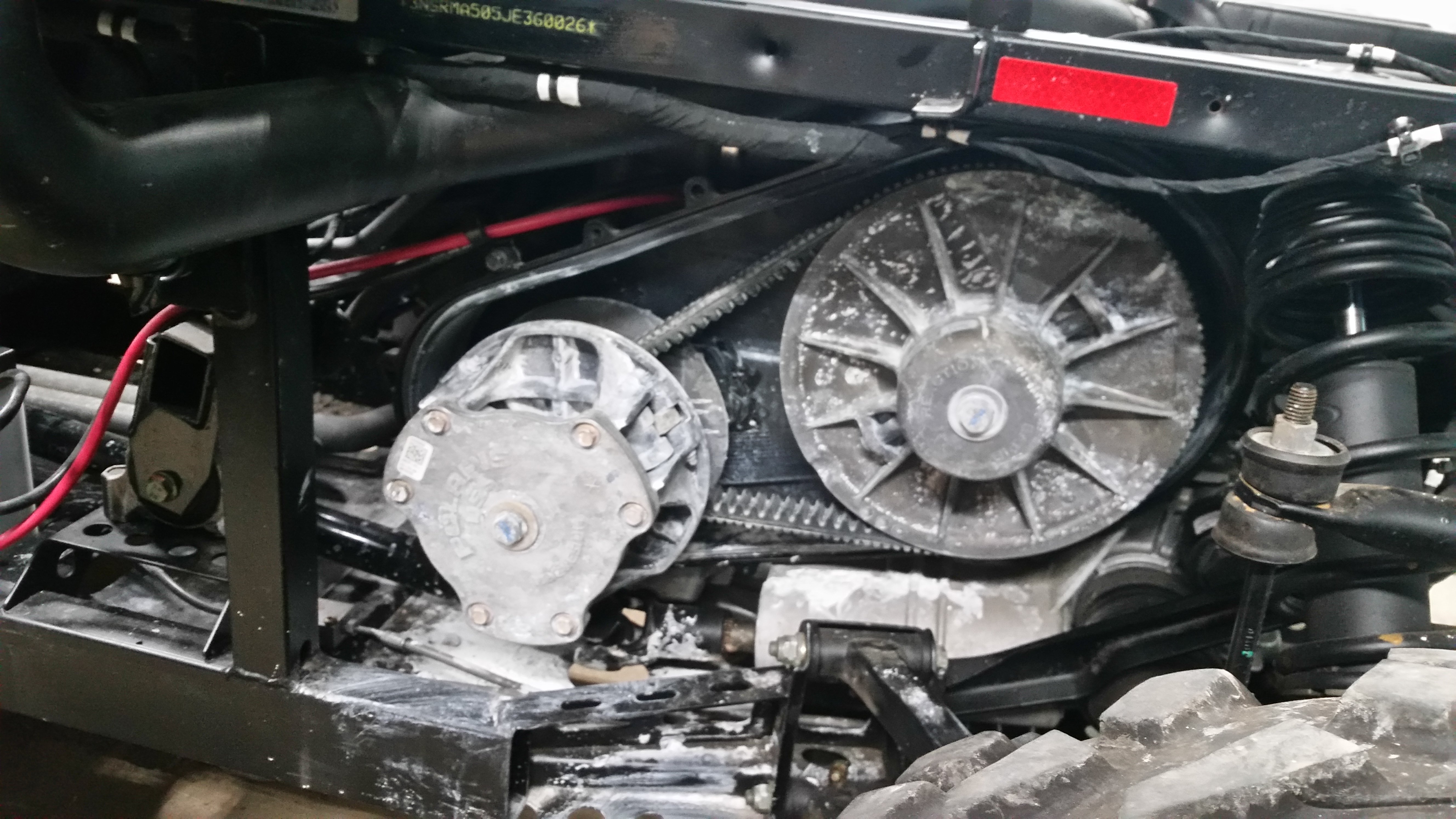

I wanna pull the clutch cover off too and see how bad it is in there.  I'm assuming its a belt drive.  I charged the battery and its been holding at 12.2v for 2 days(not connected) so Ill see how that goes later.  Would like to get a sealed AGM battery if they're available.  A buddy of mine said to drain everything from the engine, pour a little oil in the spark plug hole and manually turn the crank to lube the cylinder or the walls may get scratched up and lead to major blow-by.  I heard it is ok to use 5W-40 oil in it so I will run a few oil changes through it with that before switching to the pricy polaris PS-4 oil.  My buddy recommended like a half dozen oil changes to get everything out.

Thats a good deal, hopefully no engine damage. Depends how it went in the water and for how long.  You'll know once you drain the oil and pull that plug. Take the belt cover off, there also should be a drain plug somewhere. Inspect everything. Hopefully the engine is good, the rest is probably ok.  Worse case scenario I think is an engine rebuild. You can then look used, look for a rebuilder like https://www.rev6sports.com/sportsman-500-engine-rebuild/

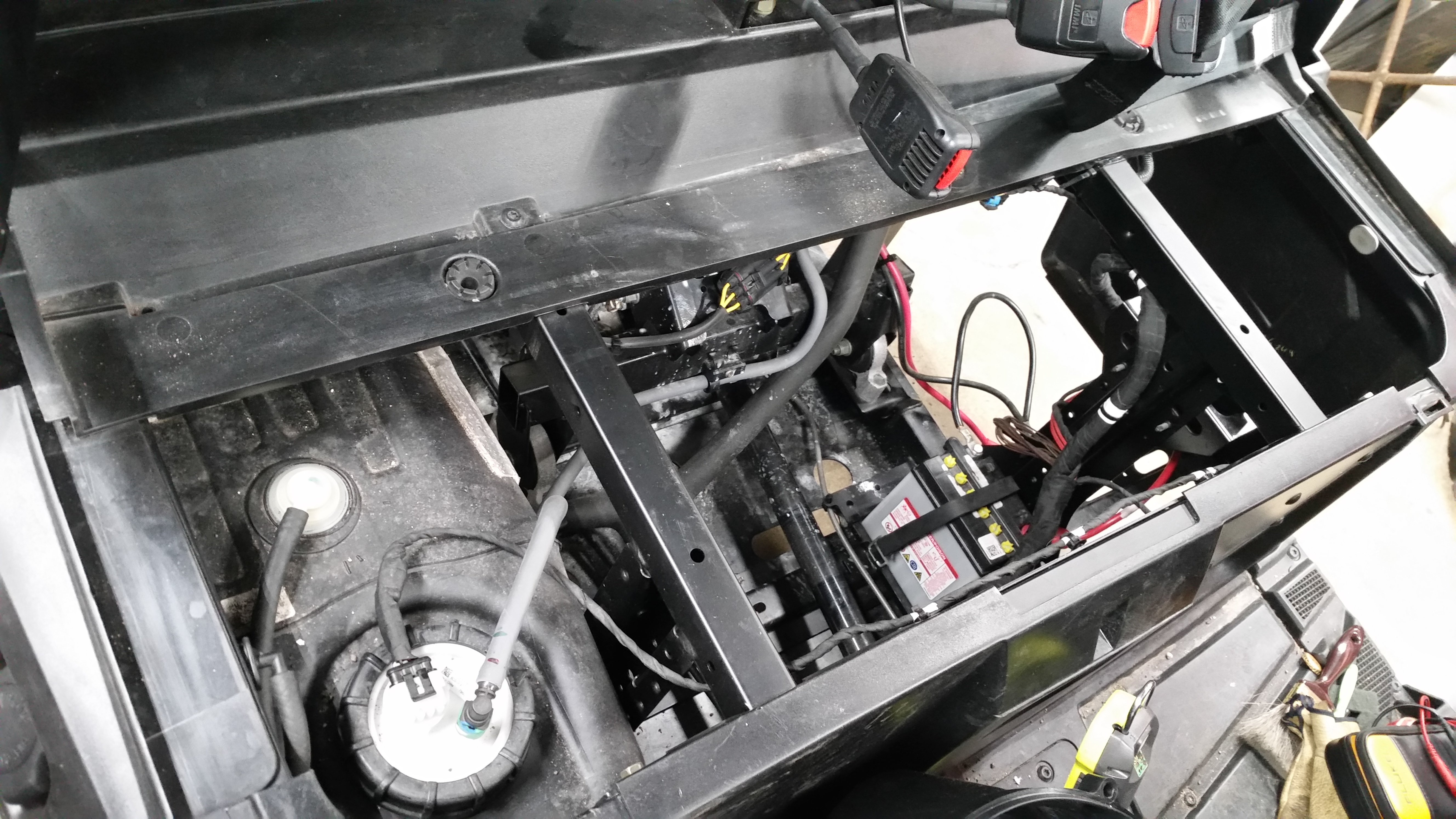

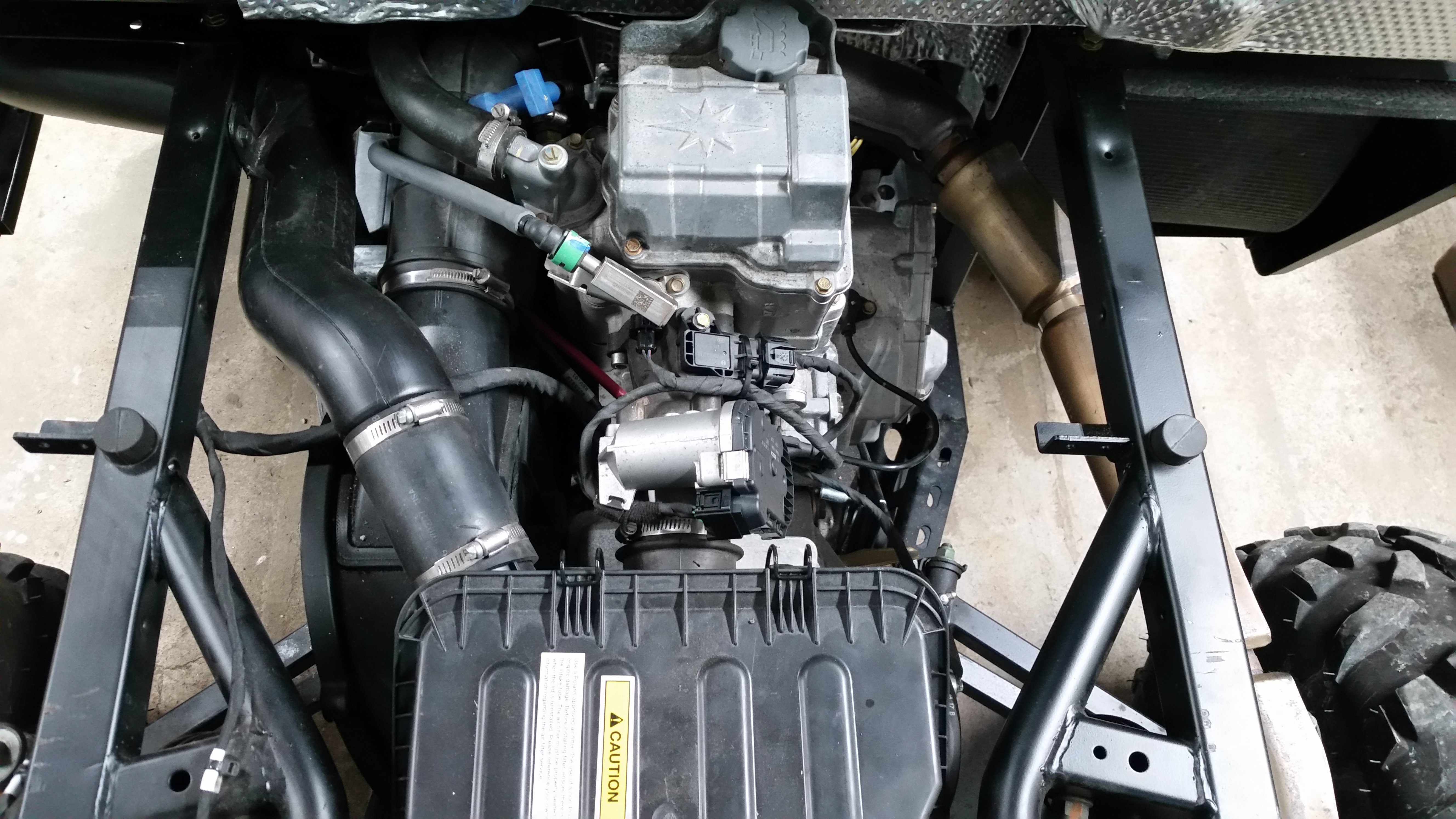

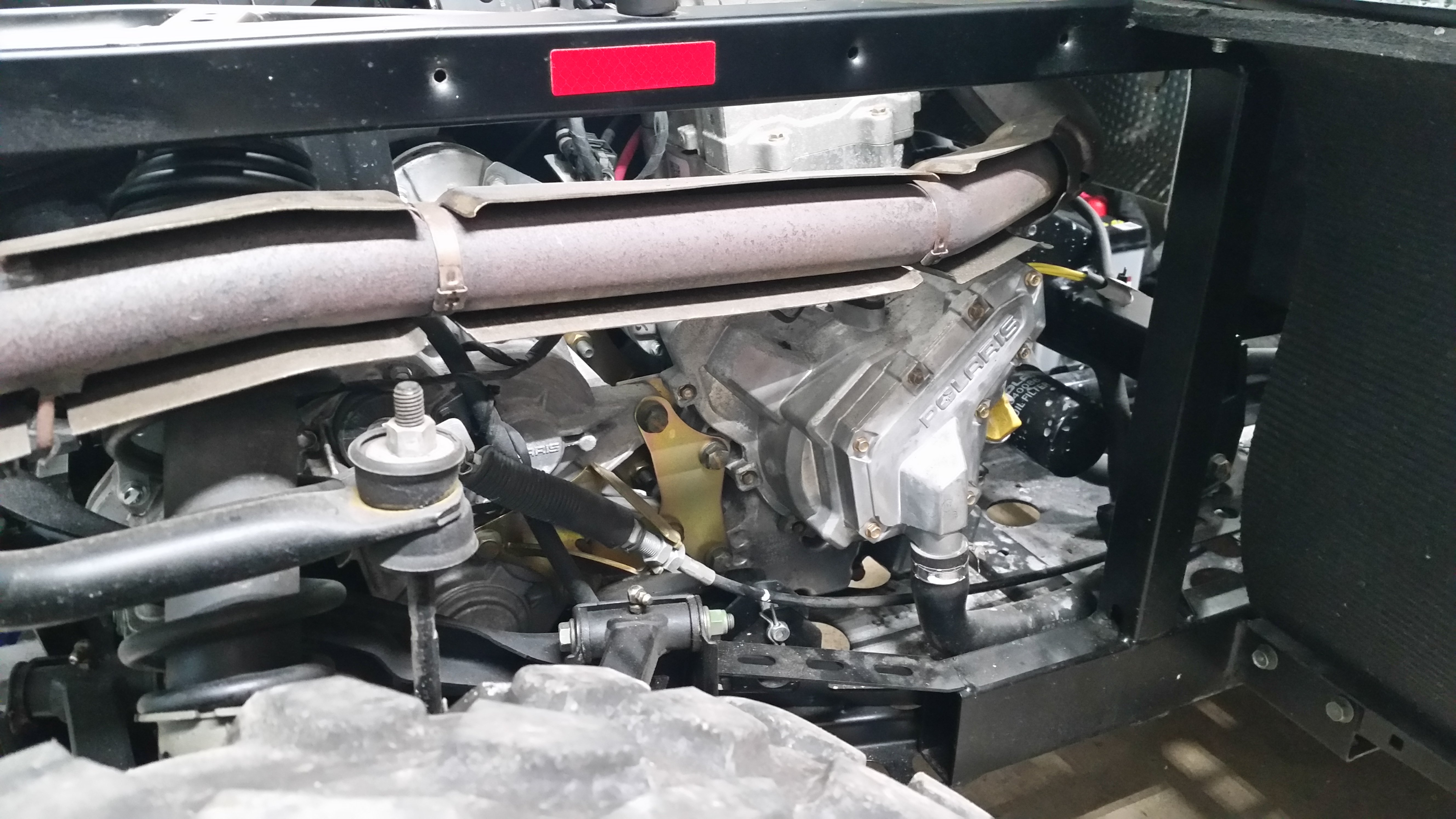

After a good shift last night,  my brother thinks the mechanical stuff is solid but has fears of the electrical stuff.  Being an electronics man, I stand polar opposite.
He showed me the motor parts moving properly with the borescope and I showed him how to clean electronics.  He sprayed some lube/penetrating oil/etc into the spark plug hole and turned the crank a few times...looked fluid.  Also showed me the valves moving.  (Note to self: Buy a borescope).     I removed all the aftermarket electronics,  washed and dried out all the electrical plugs I could find and then cleaned and tested the fuse box.  Brake light fuse was blown.  Bed lights need to be tested before re-installing....I'm sure they're filled with water.  From the amount of sand in it, my brother thinks it was sunk for days...possibly stolen and ditched in a river.

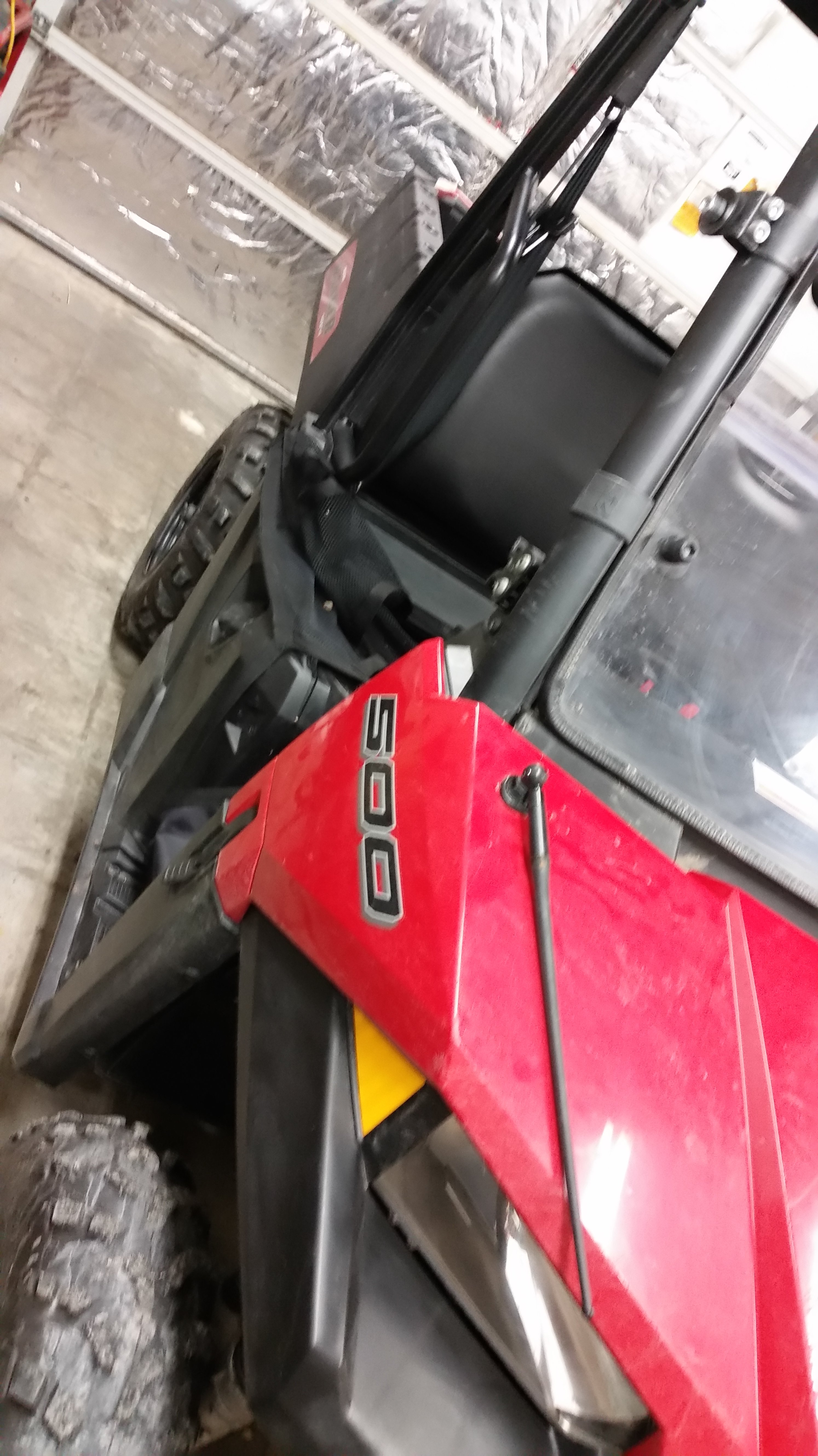

Project is going slow due to the holidays but looks promising... see pic. :D

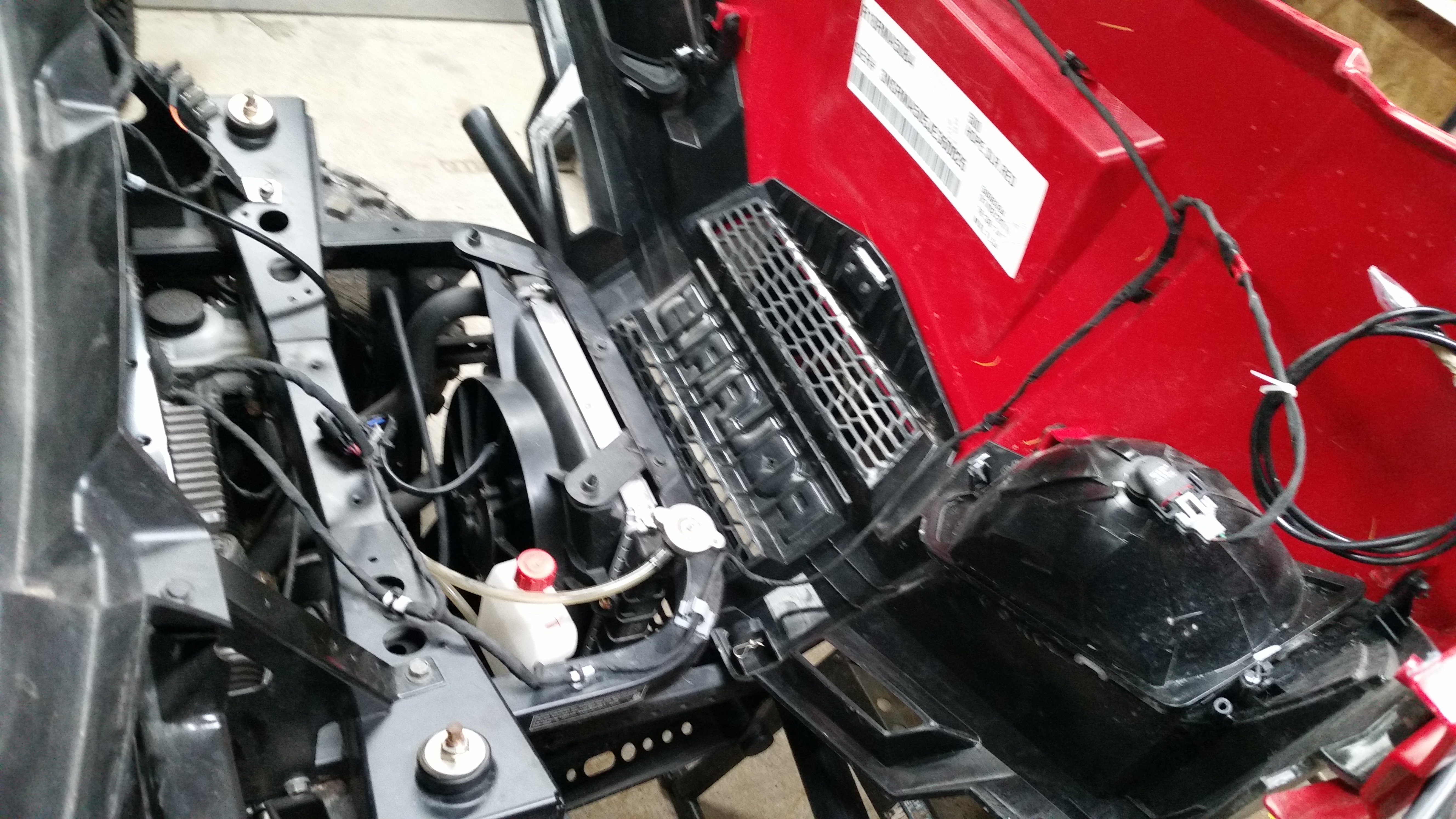

Got her up on stands and drained all her orifices.   Water came from everywhere she can puke from!!!  We replaced all the fluids.  Starts and works mechanically but seems weak.  Display doesn't work again and still no lights.(???)  Don't care about those, I can rig lights for now.

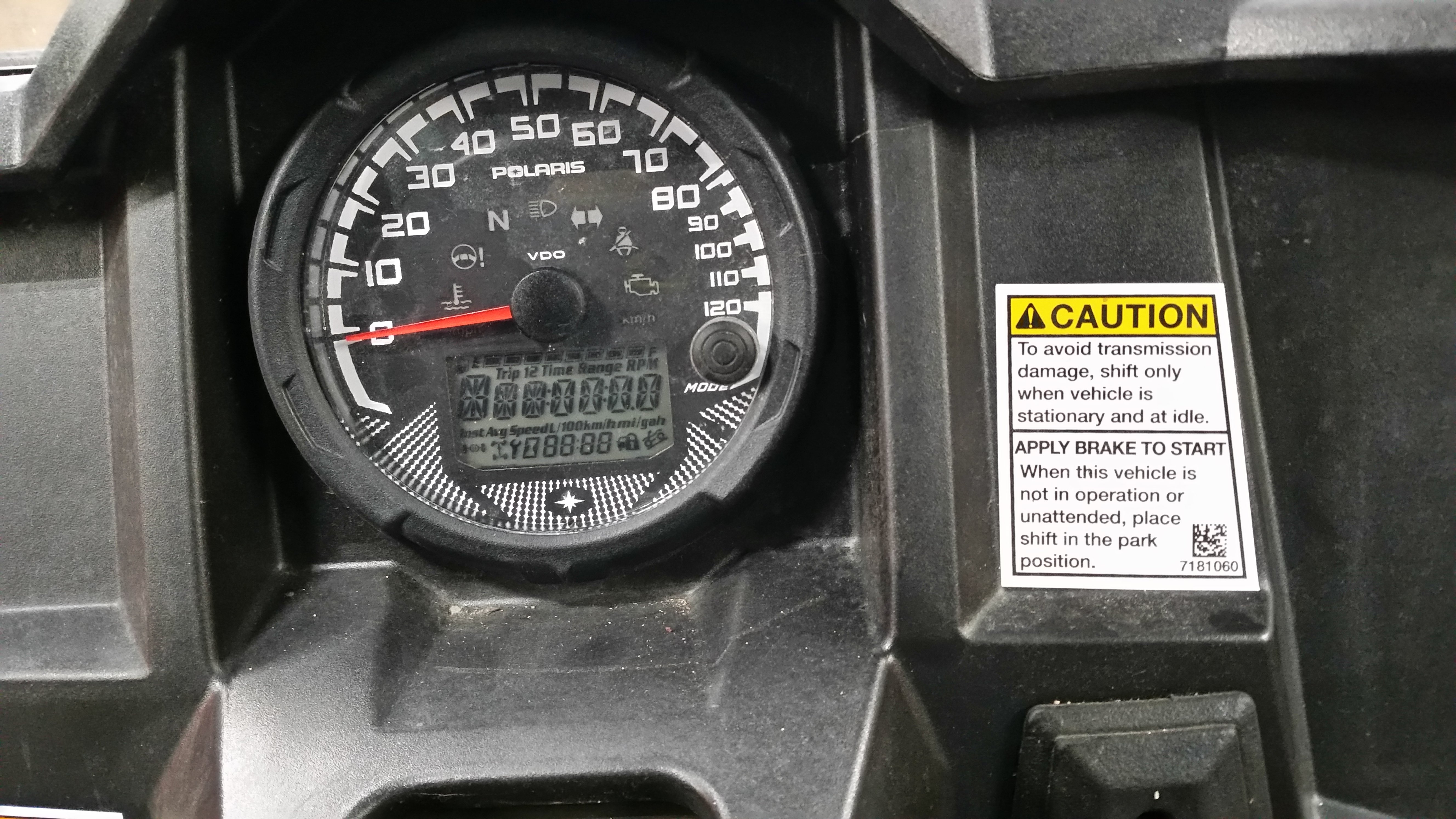

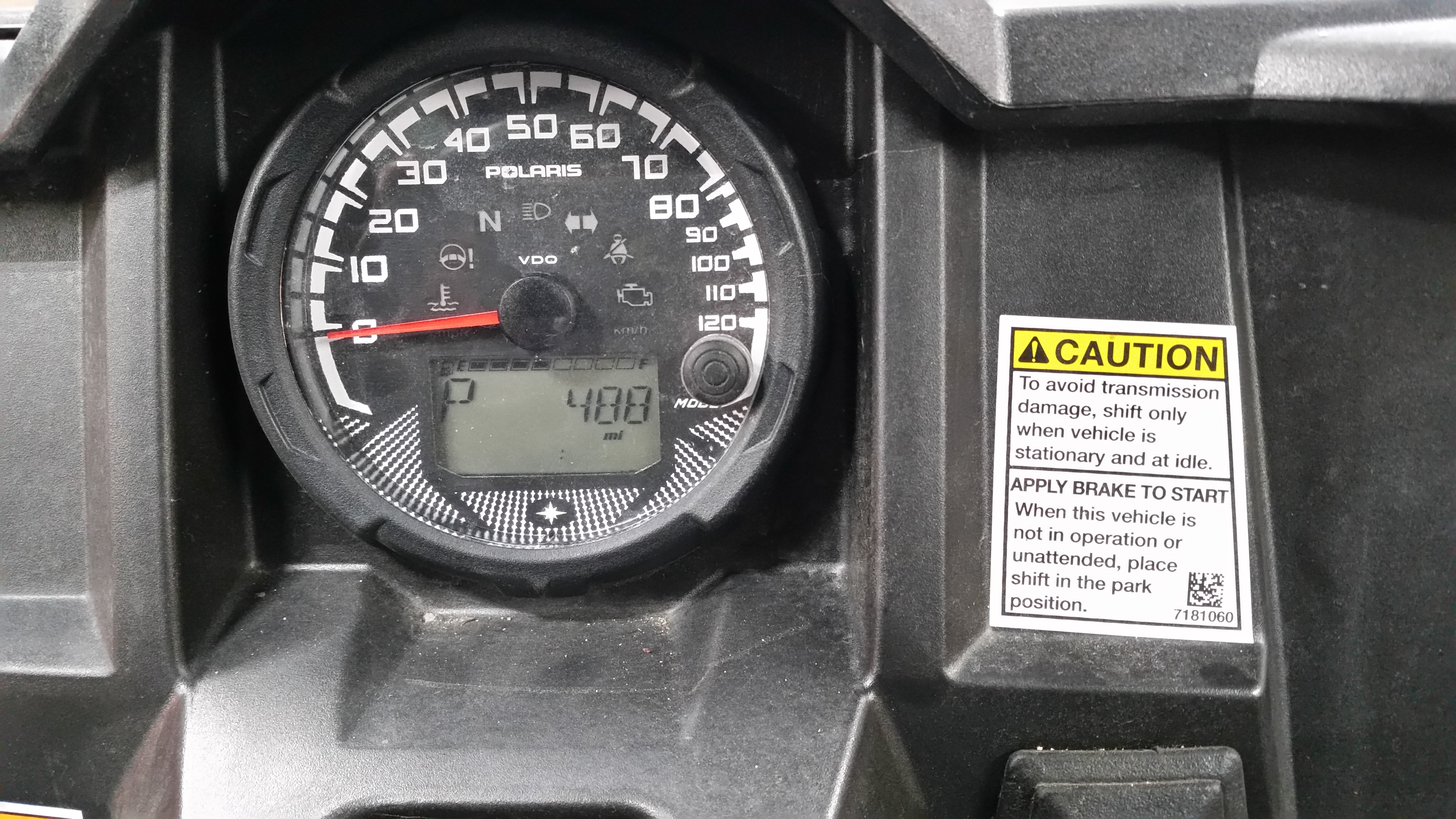

Well, we're not out of the woods on the repair yet...  My brother tried the new ignition switch.  We got lights, still no instrument cluster, battery was at 7.5V and won't crank.  Figure the charging system is messed up and we ended up driving it on battery power only last week.  Started troubleshooting according to the service manual.  Stator output is good(Thank God...it is a pain in the arse to replace!!).  Regulator seems to work but maybe causing voltage spikes.  Found this test on youtube and am going to try to get my brother to do it tomorrow...If I can explain to him how to use the diode test on a multimeter...
I am not affiliated with these guys, but it seems like a great guide for troubleshooting the diode bridge-rectifier inside the regulator.  If it's not ok to post this link, mods please delete it.
Did a google search and it seems these instrument clusters are extremely sensitive to voltage spikes.  This may be caused by a bad regulator(fingers crossed :)).  I brought the cluster home to do some testing later this week.

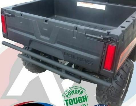

Trying to get some accessories ordered so I can close some windows on this PC and get my sanity back.  So far, bought a cool rear bumper(pic attached), trying to get a better deal on the Polaris Glass rear window($310 MSRP) and this door kit: https://shockpros.com/product/full-half-solid-series-door-kit-set-of-2/

Yep i figured as much with electrical, the cluster as much as you tell me its good i believe it's intermittent at best and needs replacing. Regulator/rectifier I would just change it. Diode tests will tell you what's going on but i still would not trust it. I hate to be the bearer of bad news but this is going to be an ongoing problem until you change all the electrical components. If your lucky you might be able to save the ECU but I'm even on the fence about that.
I wish you luck my friend and i hope I'm wrong but I've seen a lot and water is deadly when it comes to current.
I'm optimistic.  Think I can drain/reset the meter with a 10k resistor.  Polaris went Overkill on the protection here.  Search for problems with this cluster...the list don"t stop!!
