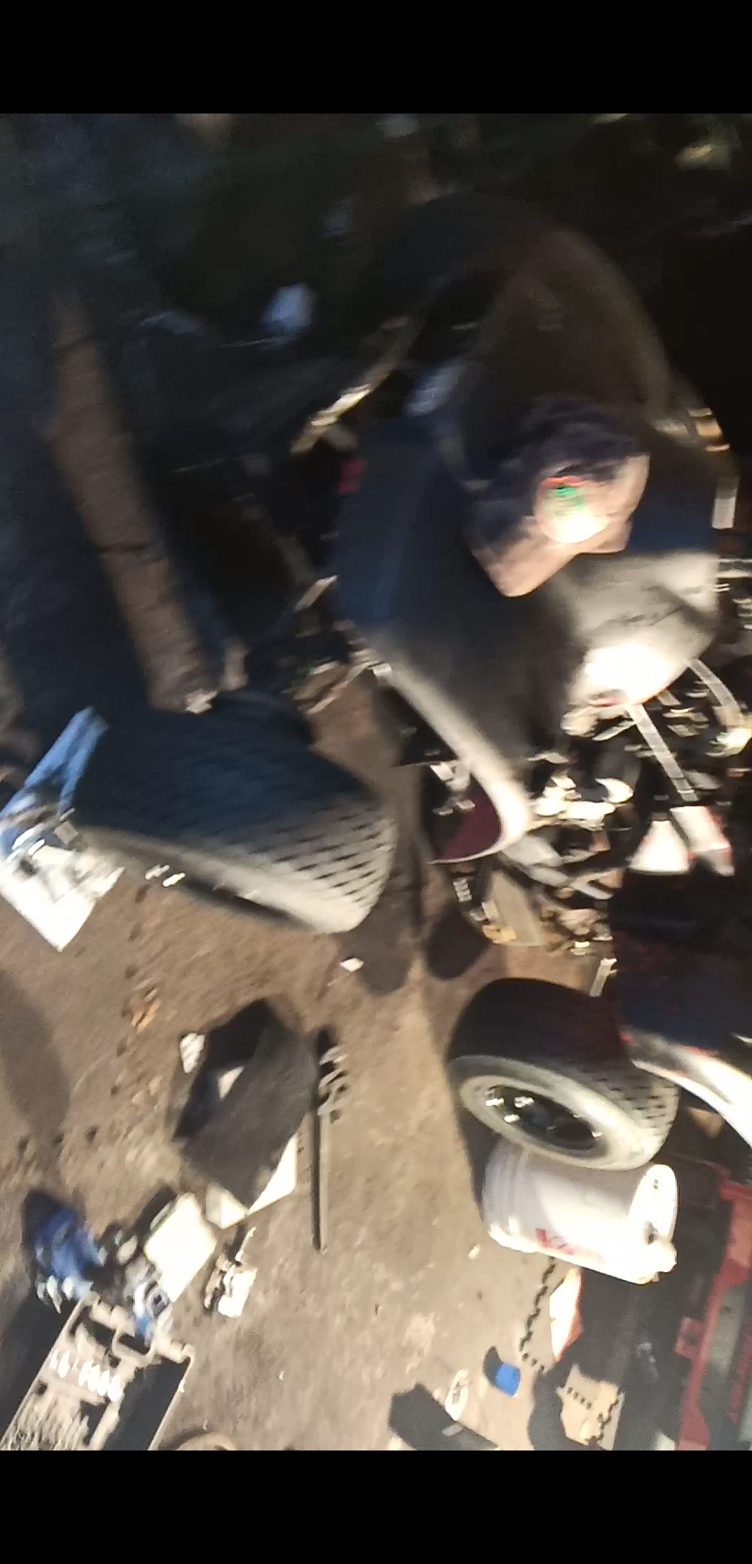

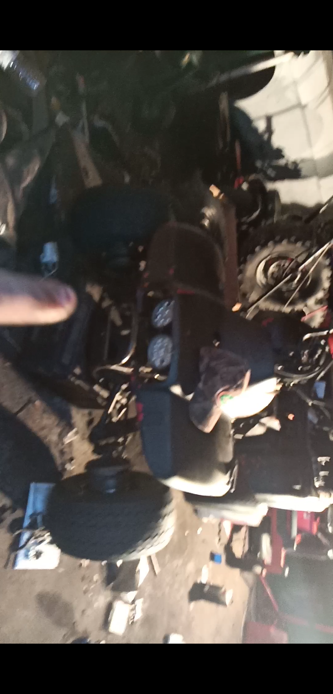

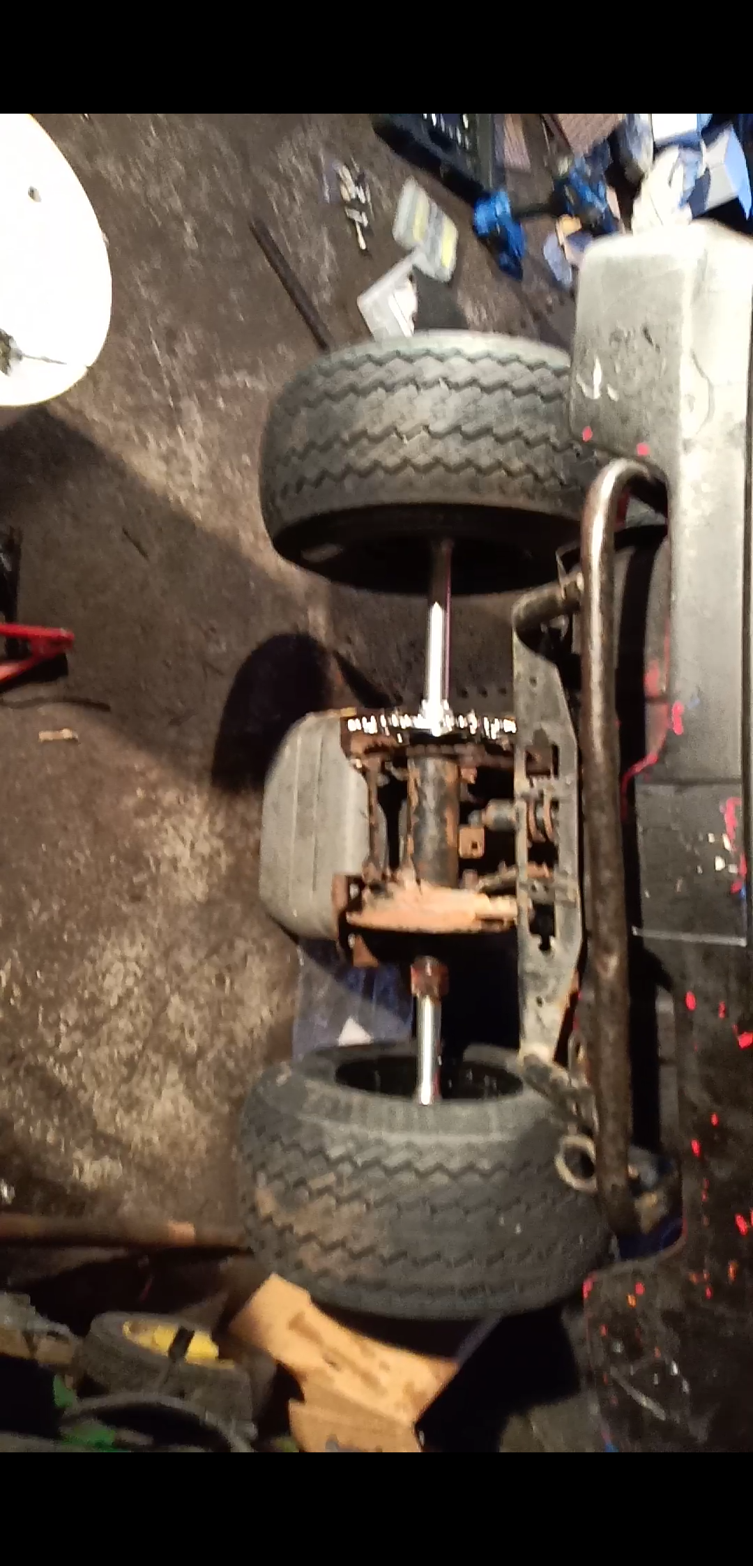

Okay I honed it out and it's still not fitting.it's fitting only a quarter way through the top and the bottom but when you push it through the middle it almost gets stuck without the rings in it. And I heard the living crap out of it and it still ain't working.Well I'm thinking of is the whole cylinder is warped and you definitely have to board out if that's the case so I just bought a whole new cylinder head and piston kit. It was pretty expensive $375 but it should be here tomorrow but I'm not sure if it will be done by tomorrow this weekend I will have it on and hopefully get it running.I am fixing to send some pics so far of what I done to it.like the tires LOL because I don't have no more pics of the rest of the stuff. Definitely not finished with the plastics and all that though and tires. I still have to drill 2 more tires out for the studs to fit but the other two I did just right and they don't wobble but I think it looks good so far. It was kind of dumb but I put about now $1,500 in the ATV so when I get it running it should run like a damn top LOL. Hopefully I can get about 1500 to 2000 out of it.
I was thinking about you buying a used cylinder because there was one for about that much or it was like $100 or $120 but I didn't know if I should have trusted it or not so I just went ahead and just bought a brand new kit.also their golf cart tires but I'm going to be running out on the street a lot so hopefully they will work well on the street. if not I have some good size rims on there now I can put street tires on when they wear out.

Golf cart tires work ok as long as you keep the speed really low.  They will balloon pretty bad with much speed because they are meant for low speed, soft compound driving on grass.  I've done trailer tires before that are almost identical and they worked great b/c they are speed rated.  I used them on an old Bayou 220 for packing dirt and it worked like a champ.
Okay thanks markinAR, when these wear out I'll get me probably a set of trailer tires to put on there. I saw some good ones but they were a little bit too pricey for the rims too but now I can just buy the tires and they'll be cheaper.

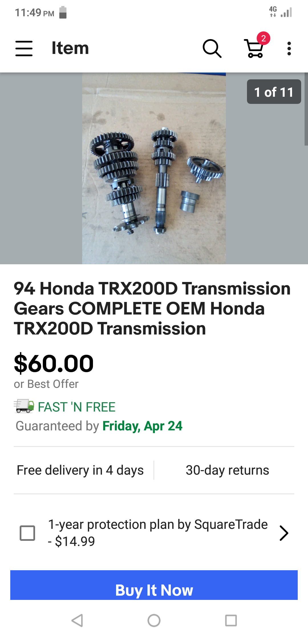

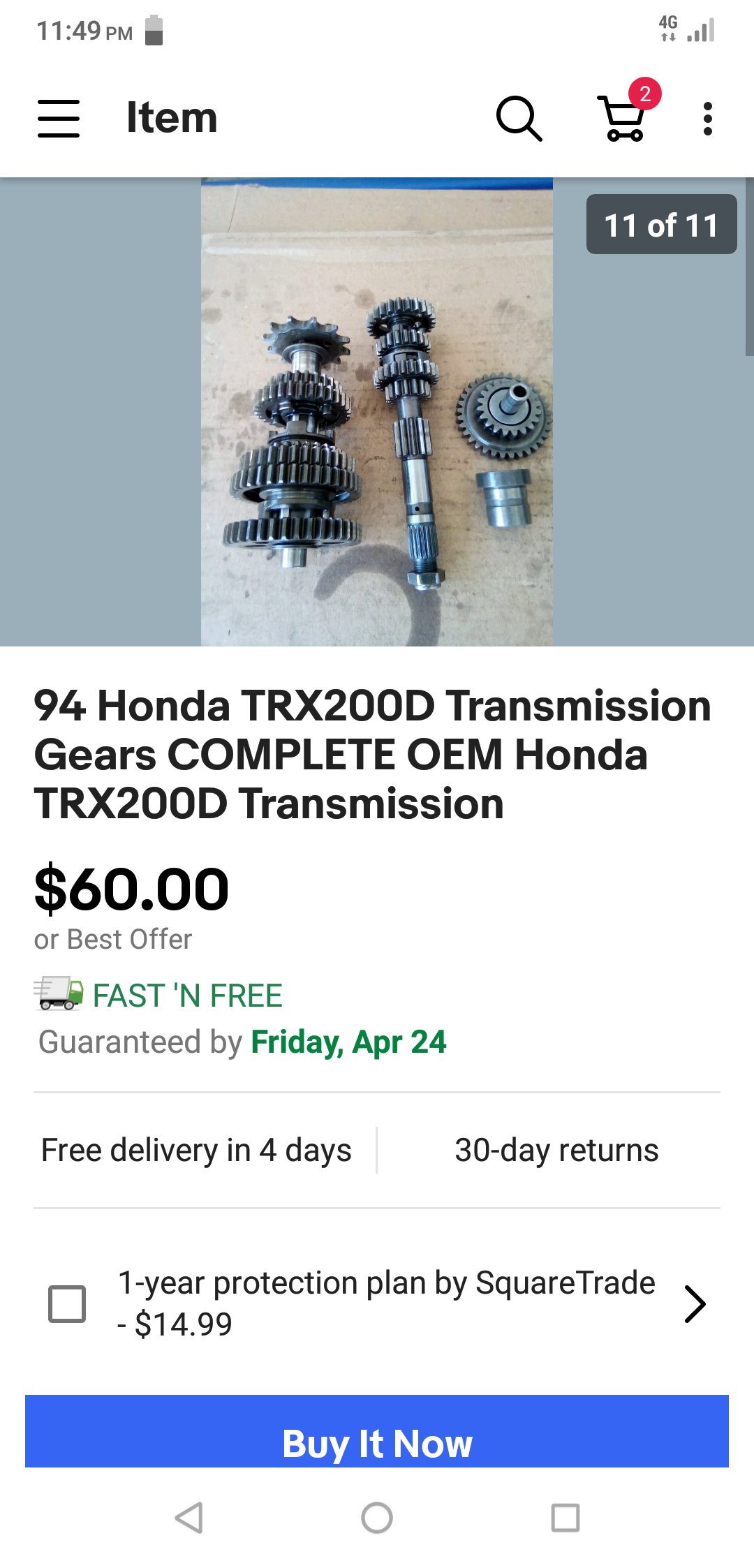

Also I was going to ask you what kind of transmission is this. a 5-speed or 4-speed. I heard that if it's a type 2 Honda that the five speed will fit the 4 speed. Mine's a 91 so it's the year lower then when they started to make the five speeds witch suck. And if this is a 5 speed I'm going to buy it so I can put it in mine.
