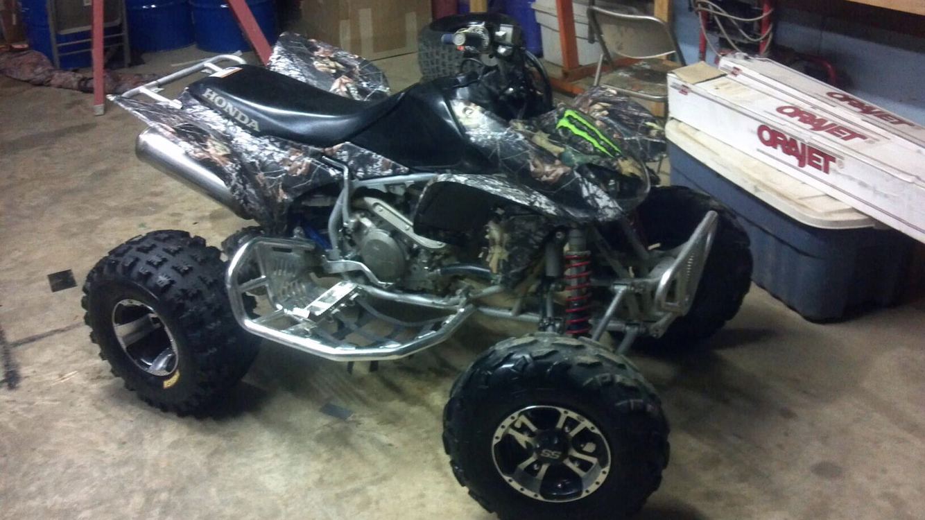

Ive been flirting with this idea. Ive done the sanding and hit it with a heat gun after, but that was on my black Honda 450r plastic. It was ok, i ended up wrapping it in vinyl, that gave me the best results.

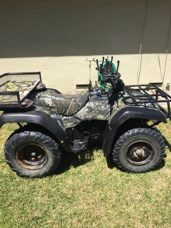

I had gotten this vynl for I think $120 9 years ago. It held up real nice on trails. I put it over Maier plastic to protect it. Frank is right though, it will get expensive on a big bike.
