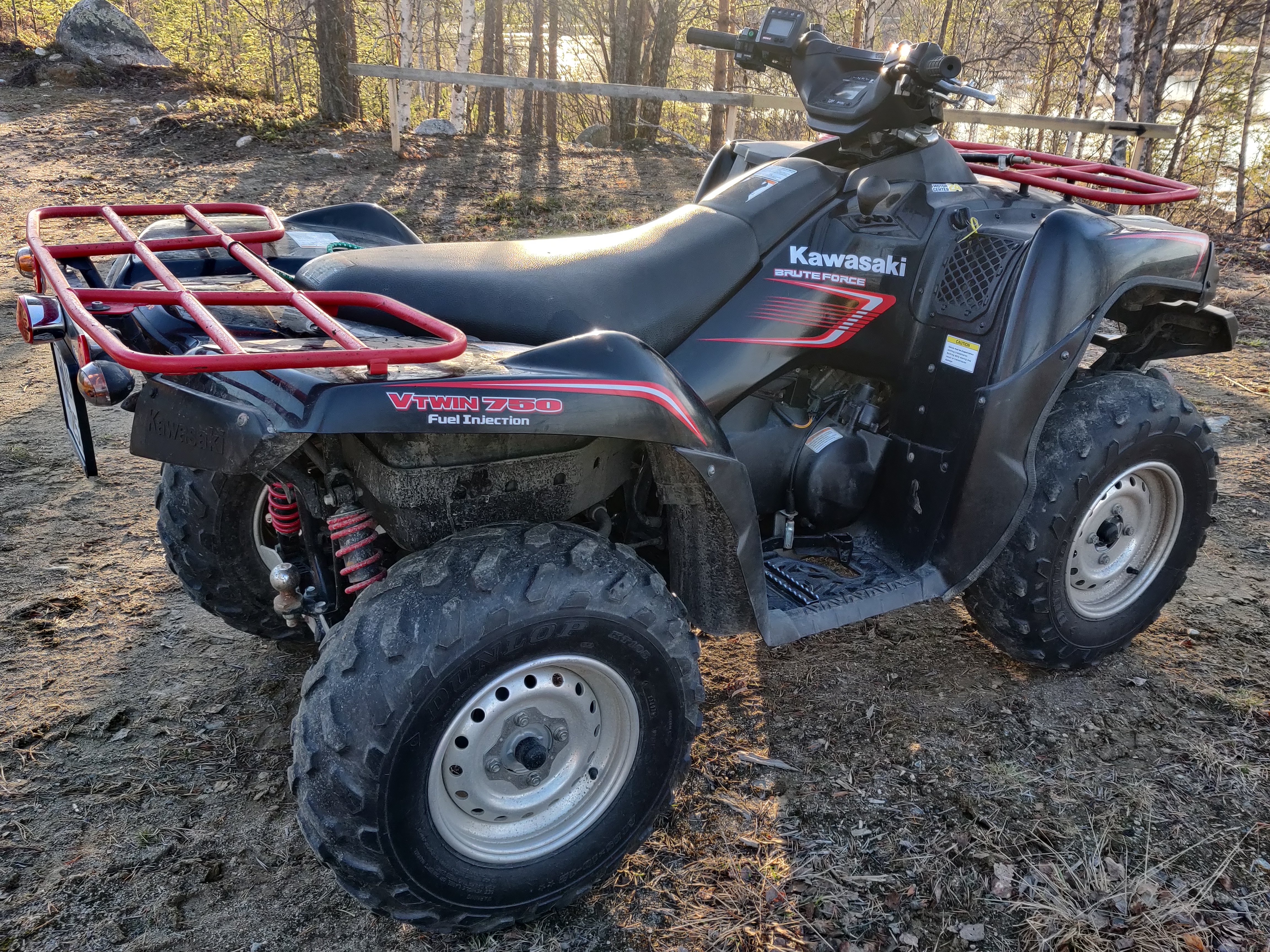

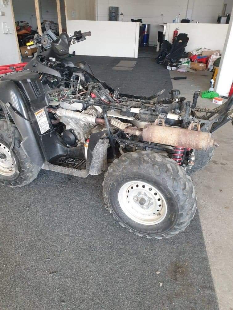

Finally got it delivered this morning, after my work in the forest I took it to the workshop to start the repair and see what they actually did.
To my biggest surprise they haven't touched the fuel pump at all. A thick layer of clay and mud gave that away. How can you start diagnosing a fuel pressure related issue without checking the item that provides the pressure. Shoot me, I have no idea what he has been looking for.
Took the fuel pump out and "popped" the screen which is in the middle section of the pump. Cleaned it all out with compressed air and brake cleaner. Put it back together and all problems were solved. It has got its full power back and runs perfectly fine.
Two hours of work and that was it. Has probably been one of the easiest repairs I have ever done.
Hopefully my tyres come in next week and after they arrived I will give an update to the shop.
On the photo you can see how the machine was standing in their workshop. If anyone has a clue what their mechanic was looking for, please share. Second photo taken just a few minutes ago while out driving.
Cheers all!
I'd say don't take anything to that shop again. It seems they were trying to throw parts at it without an actual diagnosis. That's lazy and incompetent. Glad you got it fixed though, good work.
