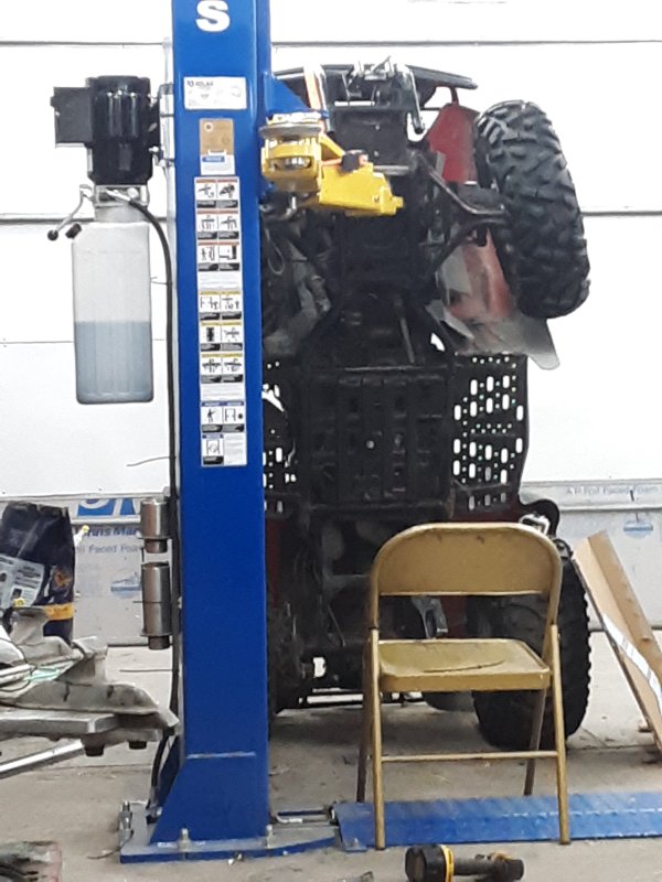

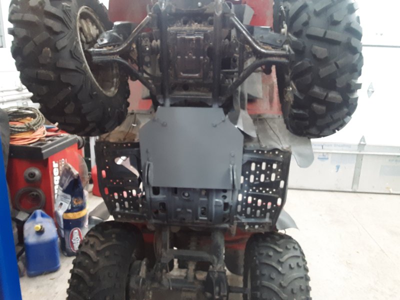

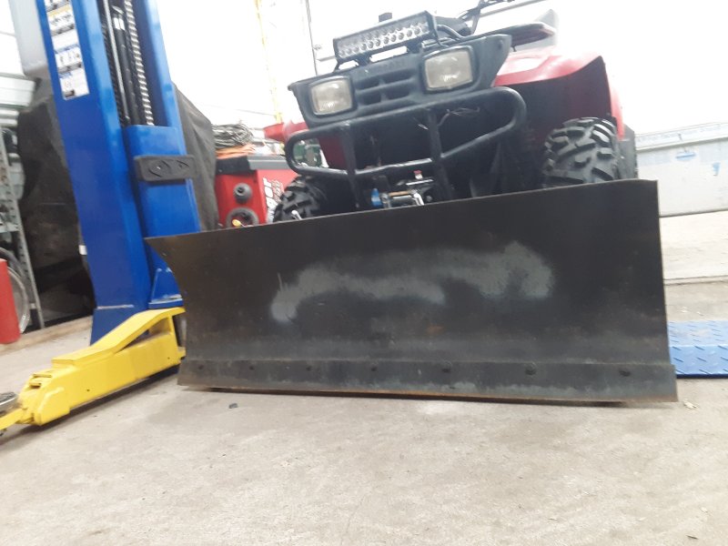

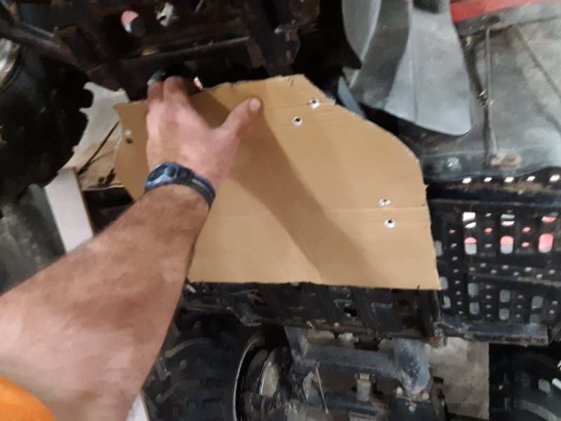

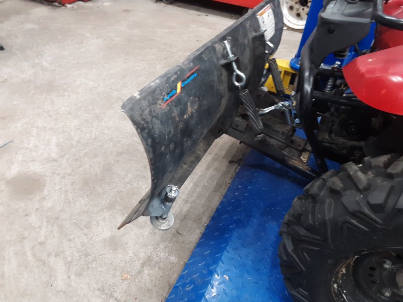

So I have a 2001 Kawasaki prairie 300 I could not find tough country snow plow... it's a older plow too boot... so I made the plow mount and updated the plow with some skids.

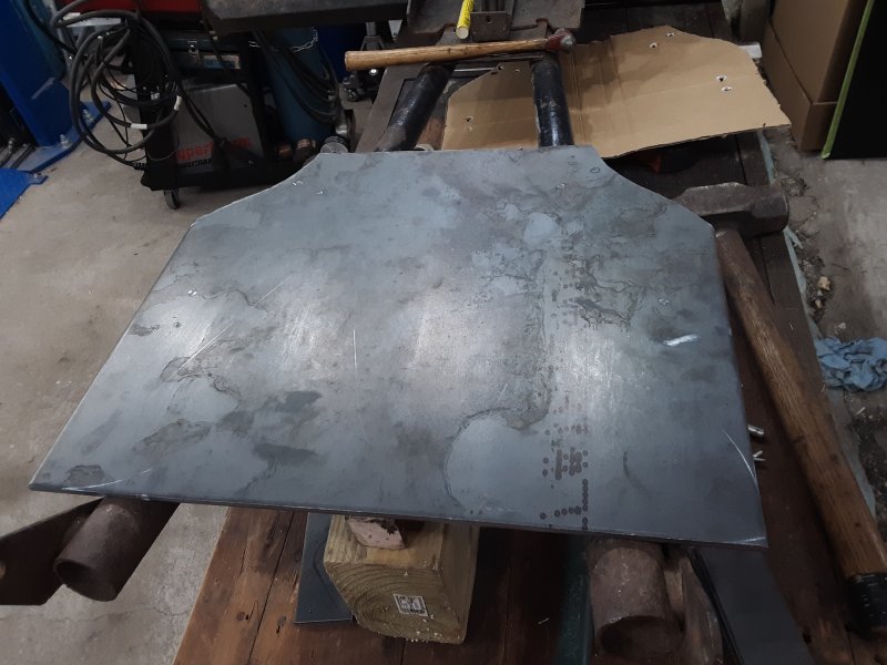

Mount plate is 1/4 steel plate and so are the pin points

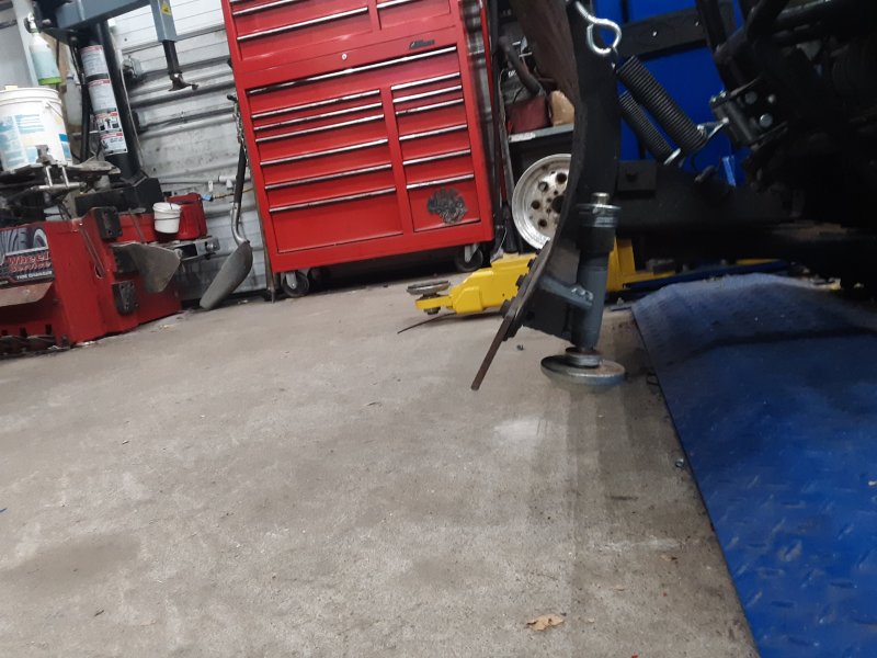

The skids are off a moose plow. I got some plumbing black pipe for holders to weld to the blade and braced it with pieces left over from the plow mount 1/4 steel...
1/4 plate cost $45
Skids cost $24
U bolts and other hardware where $20
I got the blade free
