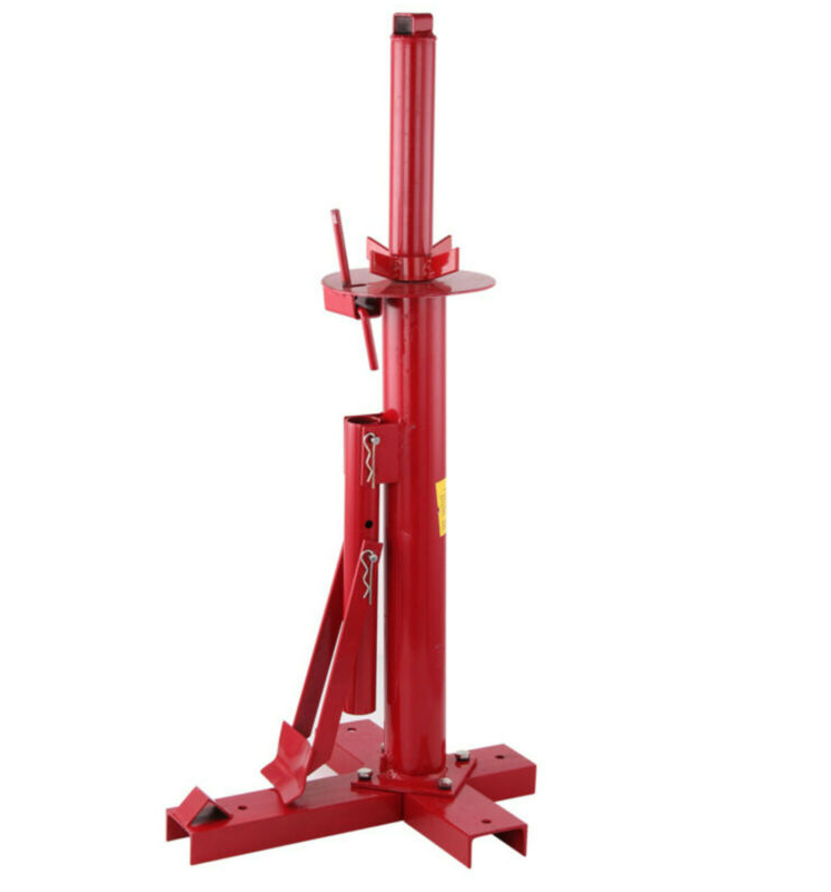

This is what me and my dad use to break tires beads off of rims (we have this red machine screwed into a giant piece of plywood for stablity (i spray cold soapy water from a spray bottle and he uses the machine and breaks the beads)I Love You Smile GIF by corgiyolk
