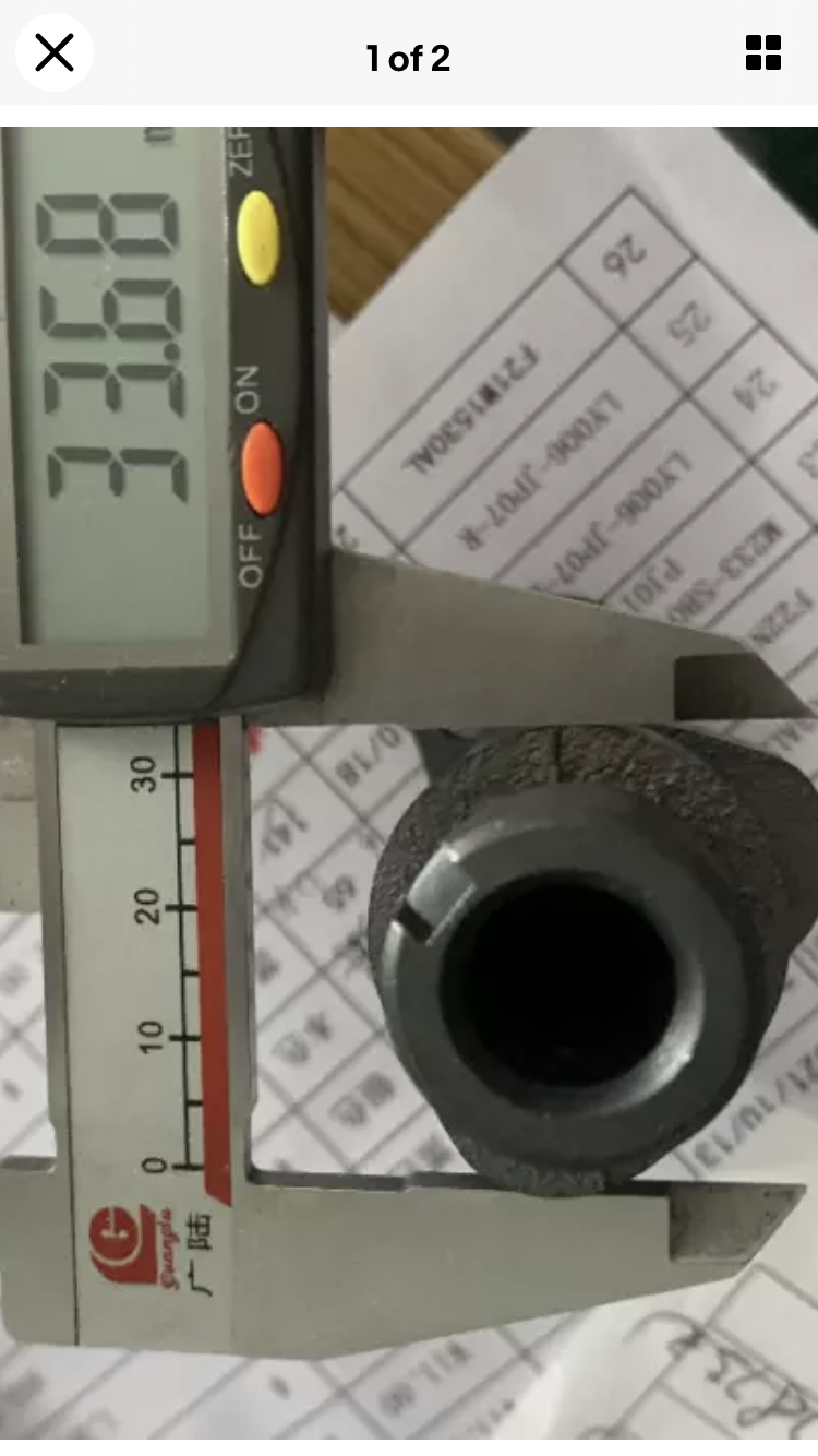

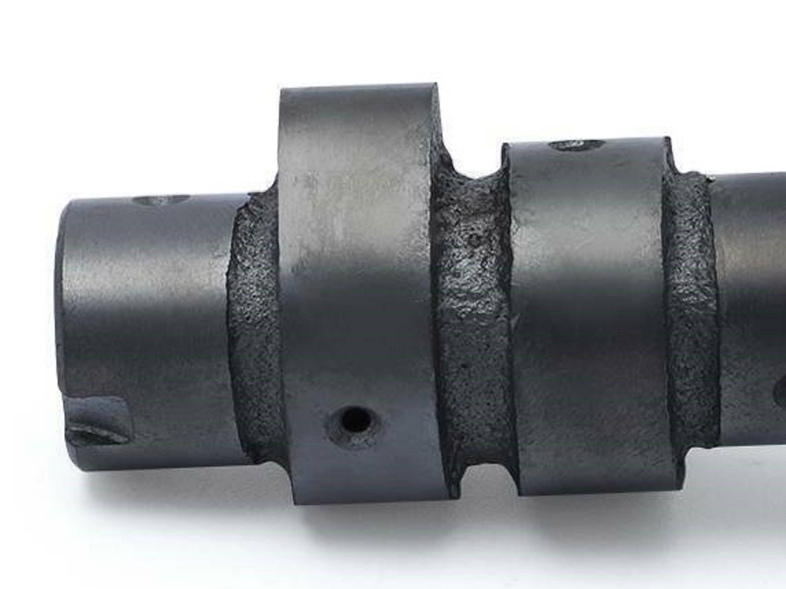

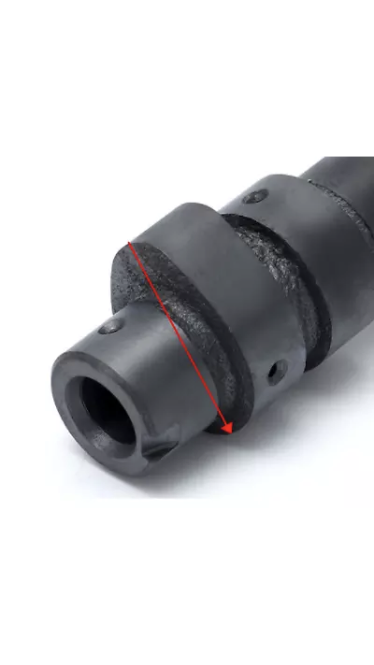

Would be interesting to see how it compares to that Chinese one I asked for specs on. They answered me back with a measurement that was meaningless.
Gave me total lift in mm so without knowing base circle diameter. But I suppose I can measure this one the same way for some sort of comparison.
B703A541-E8B3-432C-BF1E-9EBD9F4F4903.thumb.png.9823a66990fa62da30a49210df6e500d.png625B8FC2-C58D-487F-A595-C19C9AF35970.thumb.png.794a71b78c39c893c76c4d3f6926cf67.png
Well at least they put a lot of effort into the meaningless answer which is more than I usually get.

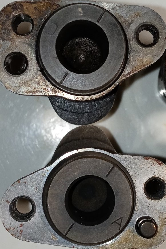

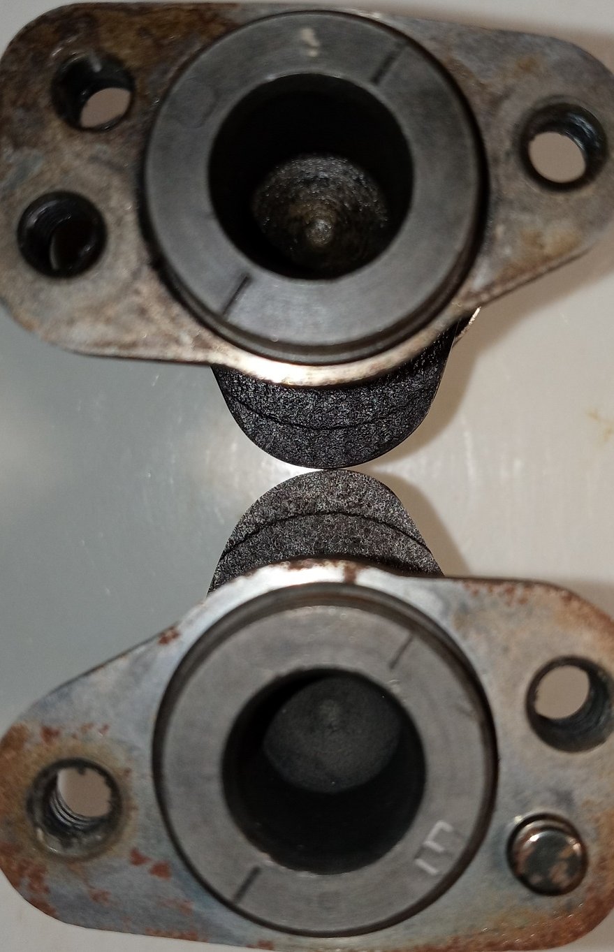

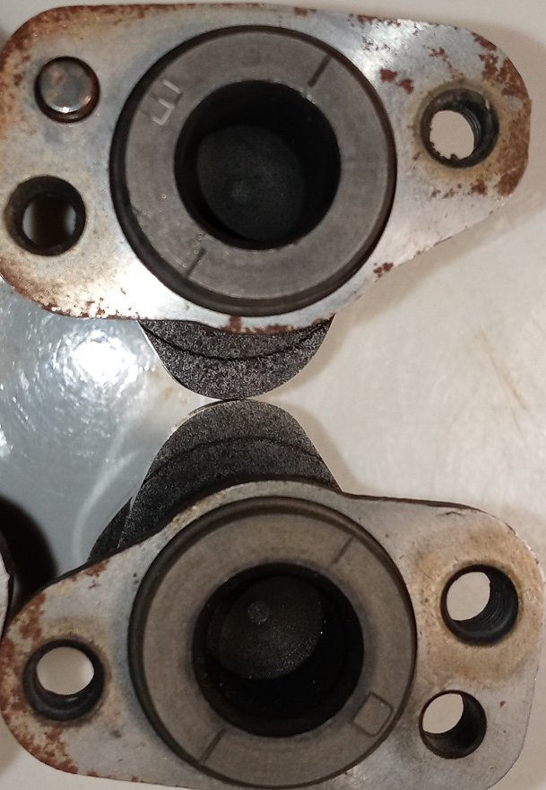

For what it's worth, the same measurement on my old 250 cam is 1.307, but that's the one I ran out of oil.
Base circle is 1.108
The other lobe that doesn't seem so worn is 1.326.
33.68 = 1.326
But I wouldn't get too excited since the A cam is also 1.326.  I think that cam is for the 250 4x4.
The D (300 4x4) and E (230S) are less.
Looks like I wore 0.020 off my lobes.  Dang.  Probably same amount off the rockers.
So the 250 has a bigger intake valve, more intake duration, and same intake lift.  Exhaust has more lift.
Seems to me if even more lift added anything then Suzuki would have done it.  That's what Vince said too.
Yet every aftermarket cam has more lift.

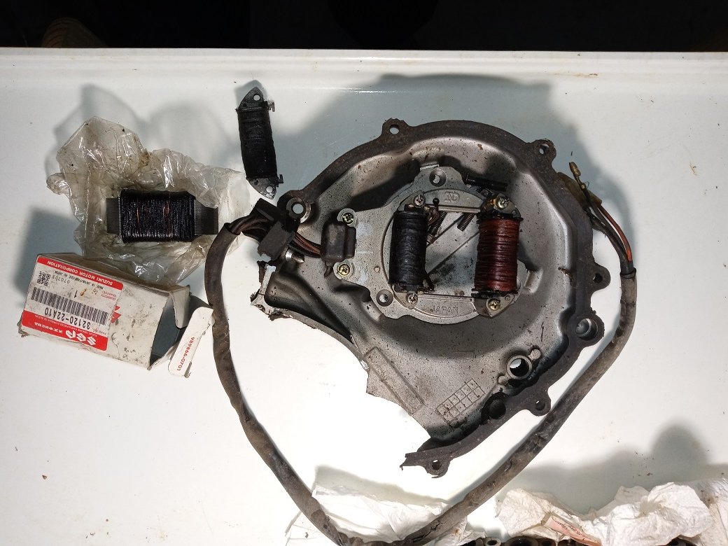

So, I had this weird thing happen where I would confirm getting spark using both a spare plug in the boot, and the plug in the engine, when unscrewed. Smelled and felt the plug was wet with gas. Check spark again, nothing. Tore the harness apart looking for fuckery, found a little, but nothing to account for this intermittent no-spark condition. Started thinking "What would cause spark then no-spark, seemingly at random?" and it occurred to me that contaminants in the oil (water?) might be sitting peacefully in the bottom of the oil until they get stirred up by a few cranks. Decided to pull the shiny new stator cover that someone apparently went to a lot of trouble to install. After being annoyed by the mismatched hardware making me run to the bench three times for different sockets, I got the cover off and was immediately greeted by milky-gray looking oil. Not great, but I felt vindicated in my hunch, however impossible it may have seemed, this stuff was ready to turn to mayo if it actually did run.  As I was letting it drain into the catch pan, I noticed something amiss inside the shiny new stator cover - a small stray screw.
Was one of the ones that held the pickup coil in place, which was just kinda dangling there, with the other screw also backing out of its threads.
Screwed that all back together and snug and noticed ANOTHER screw loose, this one on one of the main coils of the stator, backed way out and bent over at a 30 degree angle. Pulled it out and got it straightened in the vise, started screwing it back in, and then noticed an entire third of the stator plate that contained one of the mounting holes was broken off and missing entirely. The remaining two holes had buggered phillips screws in them, and also not tight at all. This was the rough equivalent of that zip-tied stator in the RV125. Absolute fukn trainwreck.  Luckily I have that 230S motor that's all JB weld, and it's that same stator. Going to swap those out in the morning.

Oh jeez man.  Someone should introduce that guy to locktite.  Well at least you caught it before something worse happened.
I was kinda waiting until you actually experienced problems before telling you this but since you have it apart I may as well tell you those coils of wire should be replaced.  After 30-40 years the enamel on the wire cracks causing shorts and the problem manifests as hard starting when hot.  You'd really be chasing you tail and scratching your head trying to figure out why it starts fine when cold but won't start at all when hot.  At the very minimum you should at least check the resistance and compare it to the service manual, but even that wouldn't give me a lot of confidence.  They don't cost much so I'd just replace them.
Another thing I noticed is the 230 flywheel has more spark advance than the 250, so I put the 230 flywheel on my 250.  No clue why they retarded the timing on the 250.  If you have both flywheels then check it out and see if you notice the same thing.

Out of curiosity, and not being able to find any replacements new for the 230/250S, what are the chances a 250R stator would work? It appears to be the same mounting plate, but has 3 coils instead of 2.  Otherwise, I suppose I could repot the coils in some epoxy resin. I'm heading to the hardware store to get a third mounting screw for the stator, and going to put it back together for now.
What's broken is the backer plate that the two large coils and the pickup attach to, which itself bolts to the stator cover.  I replaced the stator with the one out of the 230S for now.  How do you determine what the timing advance/retardation is by looking at the flywheel? Is it the placement of the notch in relation to keyway? I have both 230S and 250S, as well as ones from LT160, and 230E. Would be interesting to compare.
I think there is a piece of metal tacked onto the flywheel that determines the timing.  When it goes by the pickup coil it tells the coil to fire.  So it would be that metal bit in relation to the keyway.  Yeah it would be interesting to compare.
If you need that plate let me know.  I don't think I'd ever need it and I'm sure there's another one on the engine sitting in the woods.
