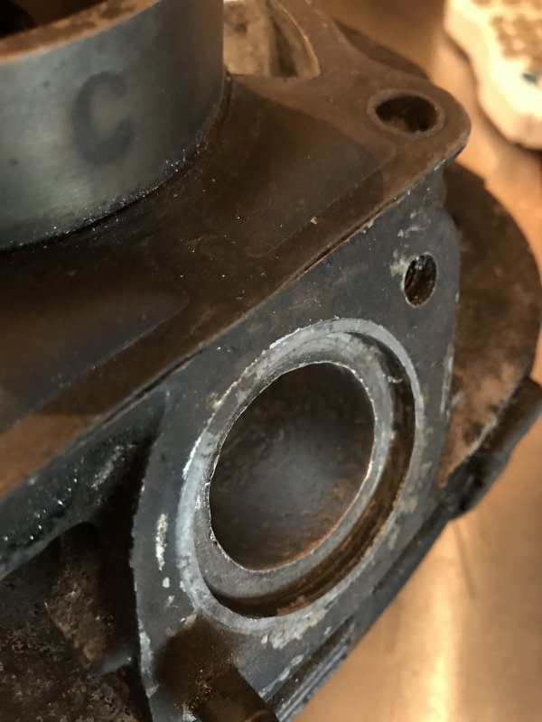

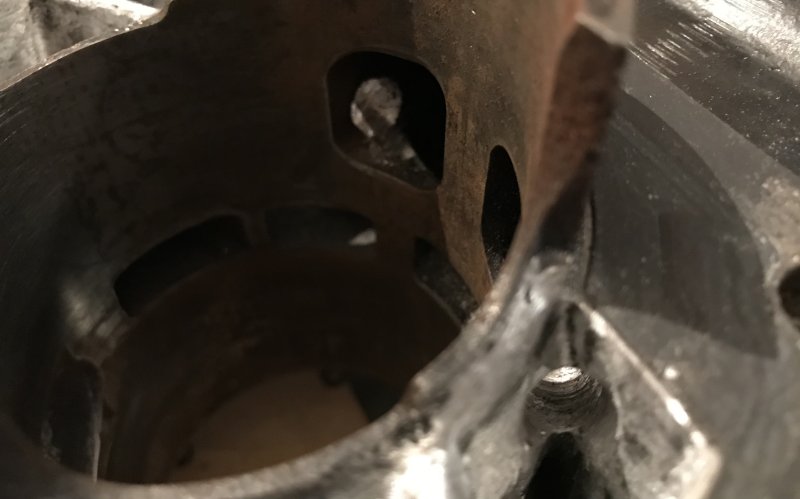

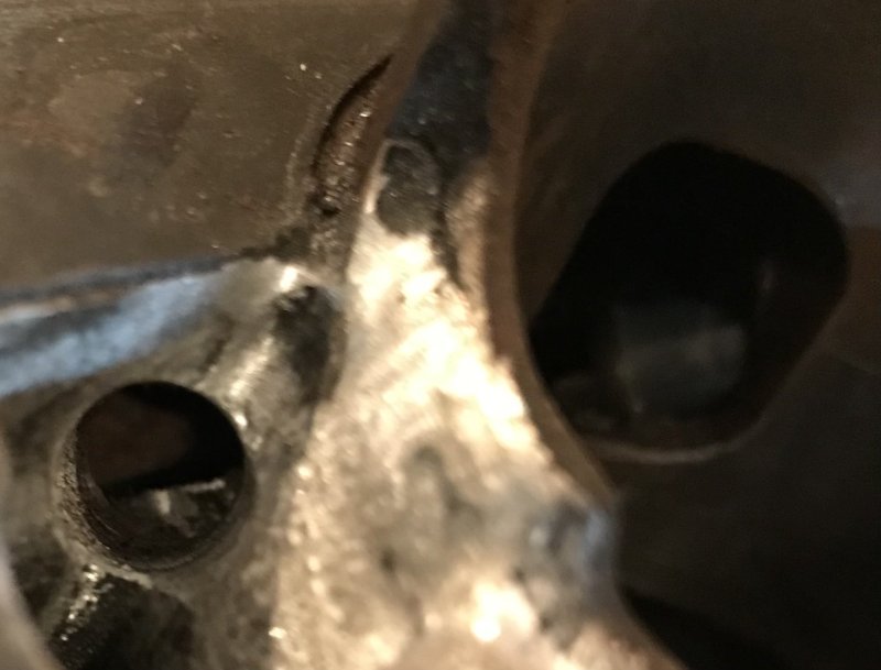

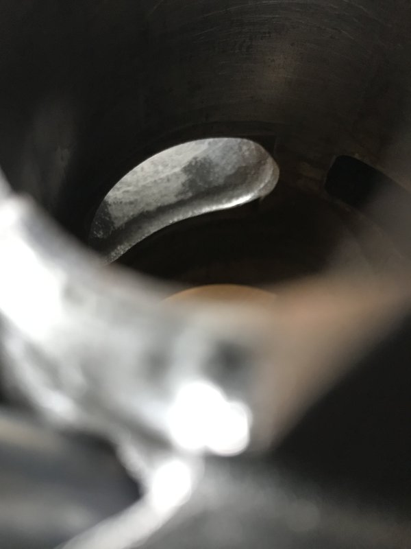

Been doing a little puttering around with a Blaster cylinder, polishing and smoothing out casting defects,
matching the exhaust port to the gasket,
smoothing the transitions between the transfer ports, and was reading a little of Eric Gorr’s writing on 2 stroke tuning.

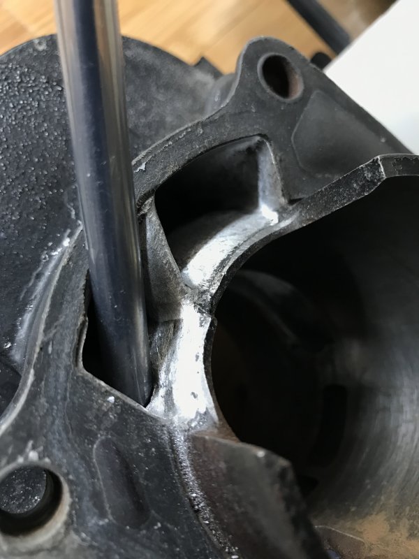

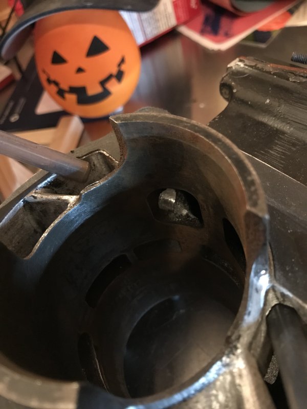

Since I have this spare to fiddle with I decided to try my hand at milling out some “Boyesen ports” - essentially lower boost ports between the transfers and the intake just behind the reed cage.
DB8B8572-0245-4CD8-AF05-5CE80F03ACAB.thumb.jpeg.b41e9df0d86f90d8bda6dc67dba1949f.jpeg4F3251A3-C10E-4434-BF02-18C30F6D295A.thumb.jpeg.9633bab3fdcbf2a3a999a7e409acd579.jpeg
Ideally they are around .5”, I chickened out after getting to .375+/- without fu***** it all up, and called it a day.
In theory these increase scavenging at the cost of some velocity- aka more low-mid brap with less top speed. Going to start out with some Boyesen fiberglass reeds and see how they fare.
And THIS time I’m going to make it a point to remember to clear the transfer ports of honing pumice BEFORE firing up the engine and frying the new rings.

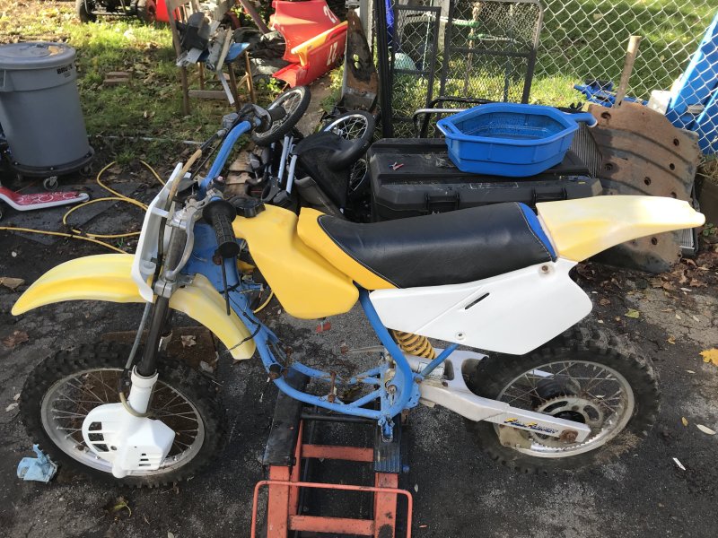

Did I mention I found an ‘87 RM80 roller for free? Have a DS80 motor that won’t fit in it, so yet another thing to hunt for in vain lmao
I don't know much about 2-strokes but scavenging in 4-strokes is a function of velocity of air.  I make my ports smaller (and uniform) to increase velocity which increases scavenging and low-midrange power (at the sacrifice of top end due to the restriction of the smaller ports).
The faster I can get the air moving the more of it will fill the cylinder while the piston is doing nothing at the bottom of the stroke.  It's supercharging effect similar to an expansion pipe on a 2-stroke.
I don't profess to know a whole lot either, but I see nothing but respect for Eric Gorr and Edvind Boyesen when it comes to smokers. Also, from the early-to-mid-90's on, you see them being cast into new OEM cylinders. The earliest how-to's you see about them are mainly for retrofitting older bikes of the same model without buying a new jug from the stealership, then other folks caught on and started modding older bikes in the same manner. They're also fond of using JB weld to build up the jug, but on the outside corners, to achieve 1/2" bore for the boost ports. My 3/8" ones could probably be enlarged by another 2mm but I'd just as soon not drill through the side either. I'm probably about 1.5mm away from the sleeve as it is, so erring on the side of caution seems prudent, as I'm not building a race bike. If it pans out, I'll be happy, if not, it's no big loss. Chinese jugs are cheap.
5 hours ago, JustRandy said:
OMFG my eyes. As soon as I saw the phrase "AltaVista search engine" I knew it was going to be a winner LOL.  It's a hell of a concept, and I'm curious to see a dyno readout for one of his motors vs a stock cylinder.
AltaVista brings back memories of when google wasn't evil lol.
He has dynos posted on those pages and claims something like 5% more HP.  I'd expect less gains on higher revving engines like DOHC crotch rockets.  Gains should be higher in the long stroke 250s, which can't rev high enough to be choked off by small ports so nothing is really lost.
Half the stuff you're talking about concerning 2-strokes I can't even conceptualize in my head to know what you mean.  What the heck are boost ports? :confused:
The only thing I know is the general physics and colloquial use of words wherein scavenging usually means the exhaust draws in more intake by virtue of inertia, which is a function of velocity and mass.  Maybe it has some other meaning in the context of 2-strokes.
After (evidently) 13 years of thinking about it I'm pretty confident that porting for velocity is the way to go in the 4-stroke arena, especially if the engine is constructed such that the piston dwells a lot at the bottom (and the reason why I like the longer intake duration of the 250S cam which takes advantage of the inertia of the air in the intake port).
Basically the air is accelerated by the downstroke and, while the piston is not moving at the bottom, which is quite a long time in terms of degrees of crank rotation, the air continues to rush into the cylinder by inertia which supercharges the cylinder.  What normally would be 300-400cc of air is squeezed into a 250cc cylinder (ie supercharging) because of that velocity.
If the ports are too large to achieve the necessary velocity to have the inertia to supercharge the cylinder then as the piston dwells at the bottom, nothing happens and the extra duration of the 250S cam adds nothing; the intake valve may as well be closed.
But the opposite will be true at high rpms since the piston moves down so fast that it can't accelerate the air fast enough to fill the cylinder because the port is too small.  So tuning an engine for high rpms necessitates bigger (and shorter) ports, which makes it a dog at lower rpms because of the loss of velocity.
Analogous to subwoofer ported boxes the port length and diameter determines the resonant frequency of the engine (where cylinder pressure will be highest or internal pressure of the speaker box is highest).  And the dB dropoff is really sharp below the resonant frequency of the box (because the port and speaker are out of phase and cancel each other) and the same is true with engines.
Scavenging in a 4-stroke would once again be a function of velocity since the exhaust gas rushing out begins drawing in the intake charge during the valve overlap.  If the exhaust port is too large then nothing will happen during overlap (maybe that's why exhaust valves are always so much smaller than intake valves).
Scavenging in a 2-stroke, as I understand it, is when the exhaust draws the intake charge all the way through the engine and into the exhaust pipe, then bounces off the narrowing of the expansion chamber and rushes back just in time to squeeze back in through the exhaust port before it closes which supercharges the cylinder.  It's pretty cool, but only happens at a narrow band of rpms (and why they call it a power band).  How the internal porting affects all that is out of my understanding except for the generalities of velocity and inertia.
Tuning an engine to be a screamer is pretty fruitless in my opinion unless you're designing F1 racers.  Banshees are really good at throwing dirt into the next county but kinda suck at actually winning drag races because they have no grunt to hookup the tires and get going.  And that's really evident when watching souped up muscle cars getting clobbered by stock Teslas which have mountains of lowend torque.  The big engines are frying the tires while the Tesla is moving down the track.
The analogy is quite apt, it's a shockwave that's at work inside the resonator pipe, and as it pushes the charge of fuel and air back into the cylinder, it acts like an invisible valve preventing the charge from escaping.  There's free software available for determining the dimensions of a 2-stroke pipe based on displacement and targeted RPM's of the powerband. I watched a video of some guy in Sweden making one. It seemed... involved.
Finland, my bad.  Make sure you turn on CC ;)
