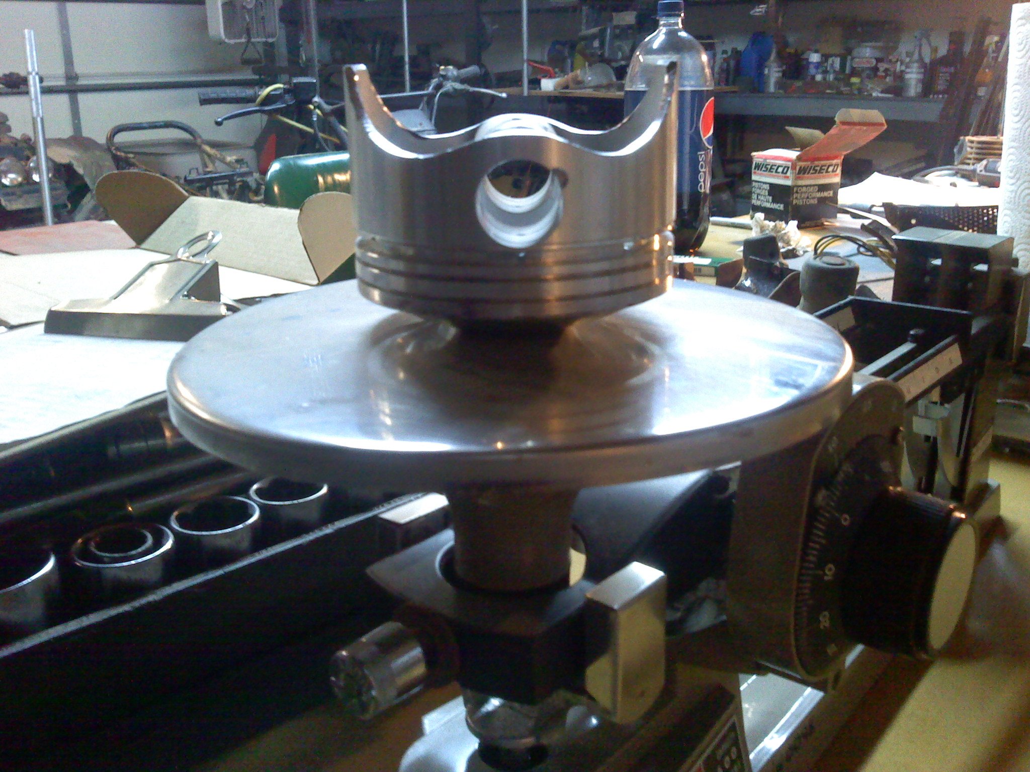

I just got a deal too good to pass up - $40 for a NOS 66mm Wiseco piston kit.
Image 1 - Suzuki LT 230 ATV Wiseco Piston Kit 4382PS
I know you're not a big Wiseco fan, but this is about $10 more than what I was going to spend on a set of rings lol.

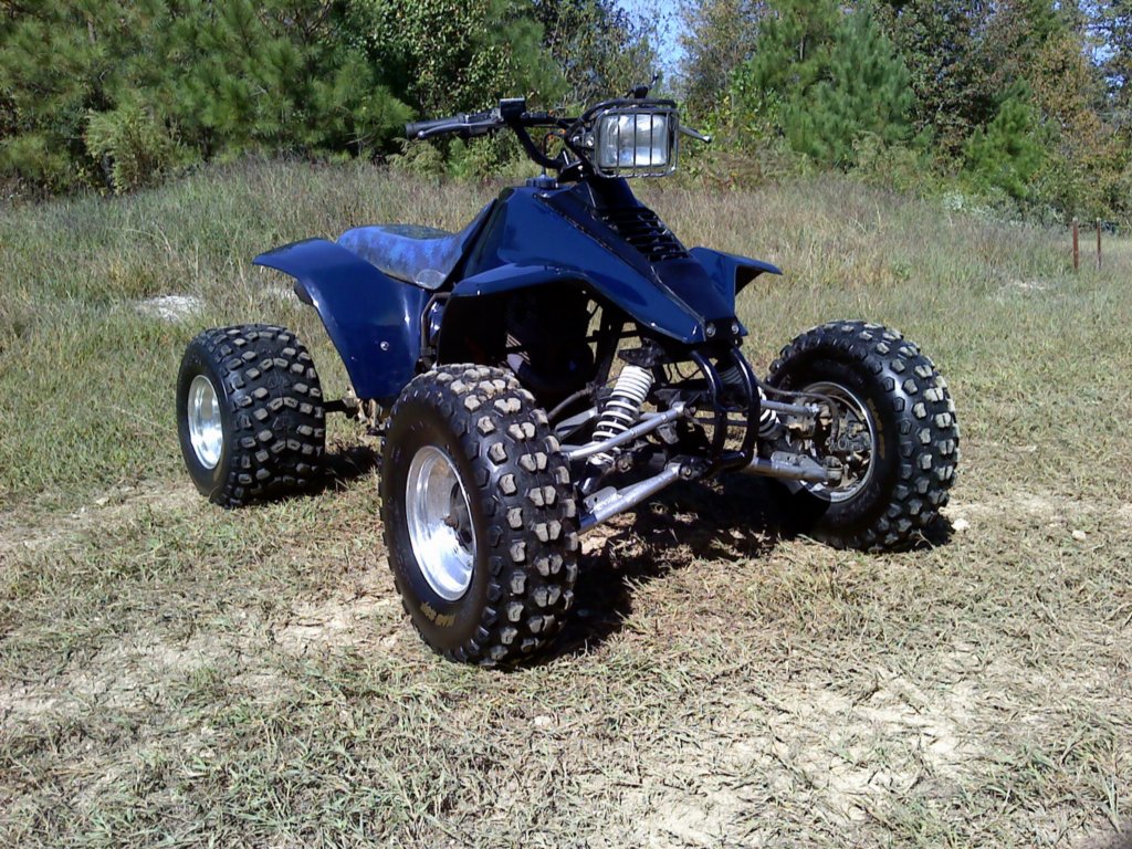

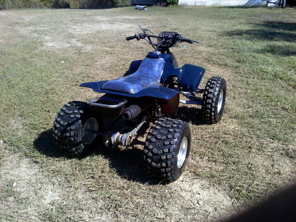

Some random pics while I'm thinking about it:
The geometry changed since that pic.  The suspension looks a little flat there.
Love how the exhaust is a straight shot right out my homemade muffler.

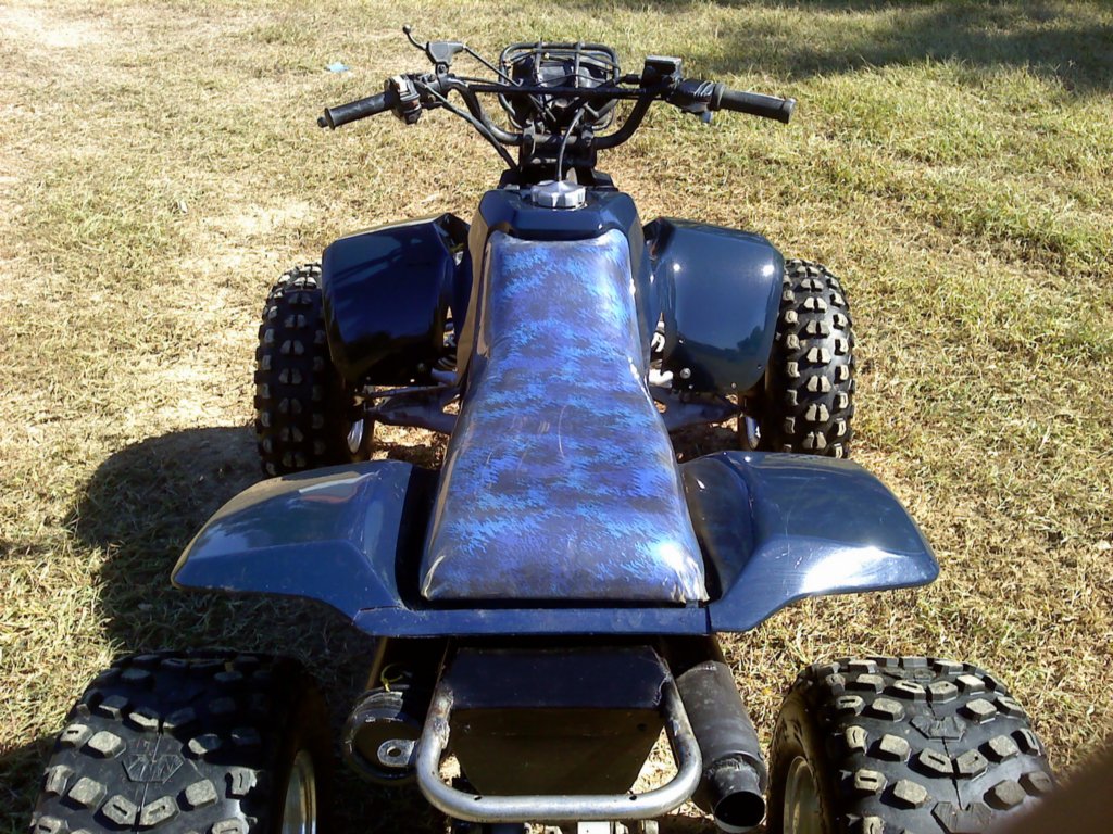

My upholstery work.  It's just cloth with a plastic cover but surprisingly durable.

Wiseco piston.  I think the black indicates what I cut out.
I don't think it amounted to much, but every little bit helps!
