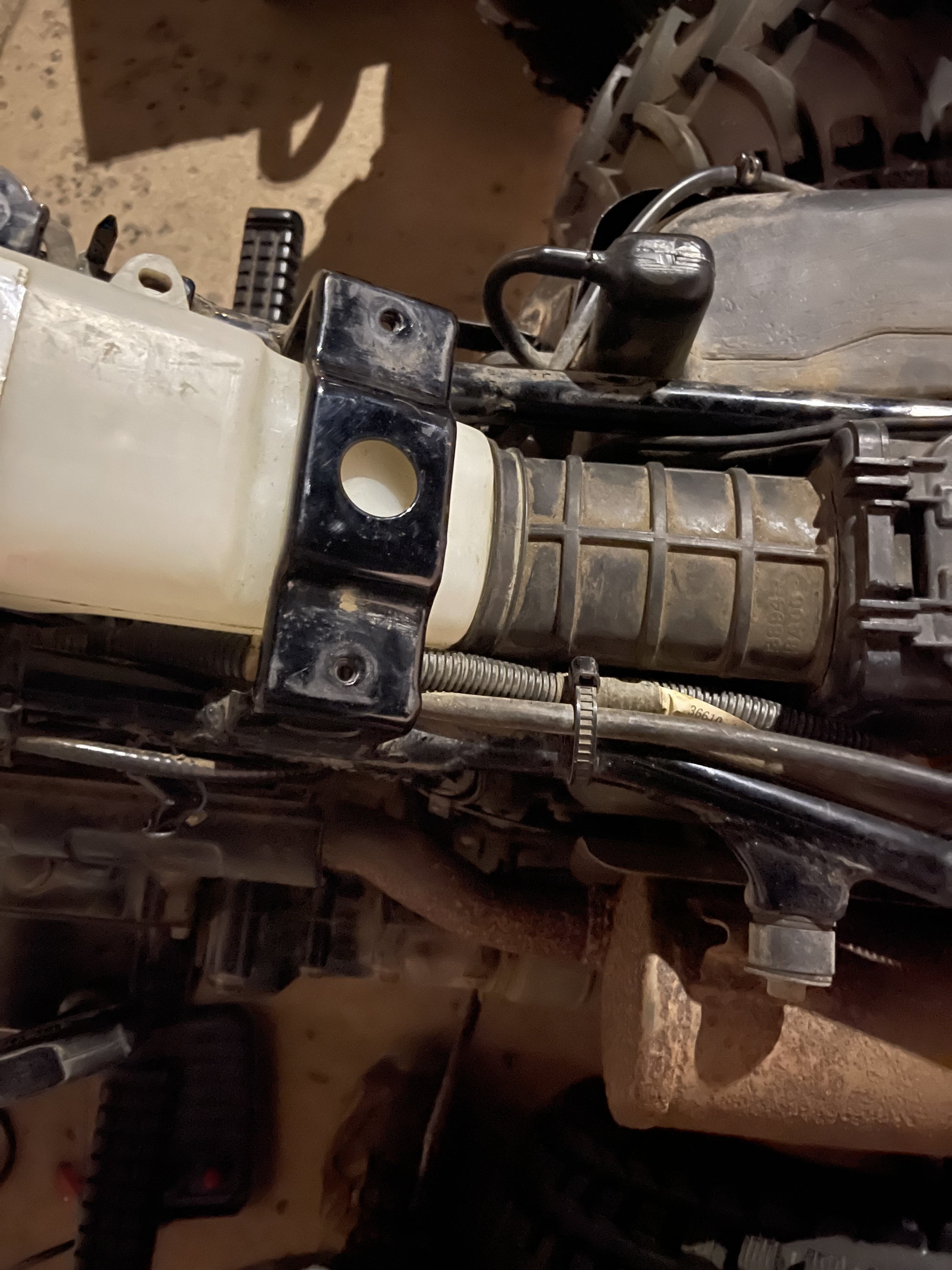

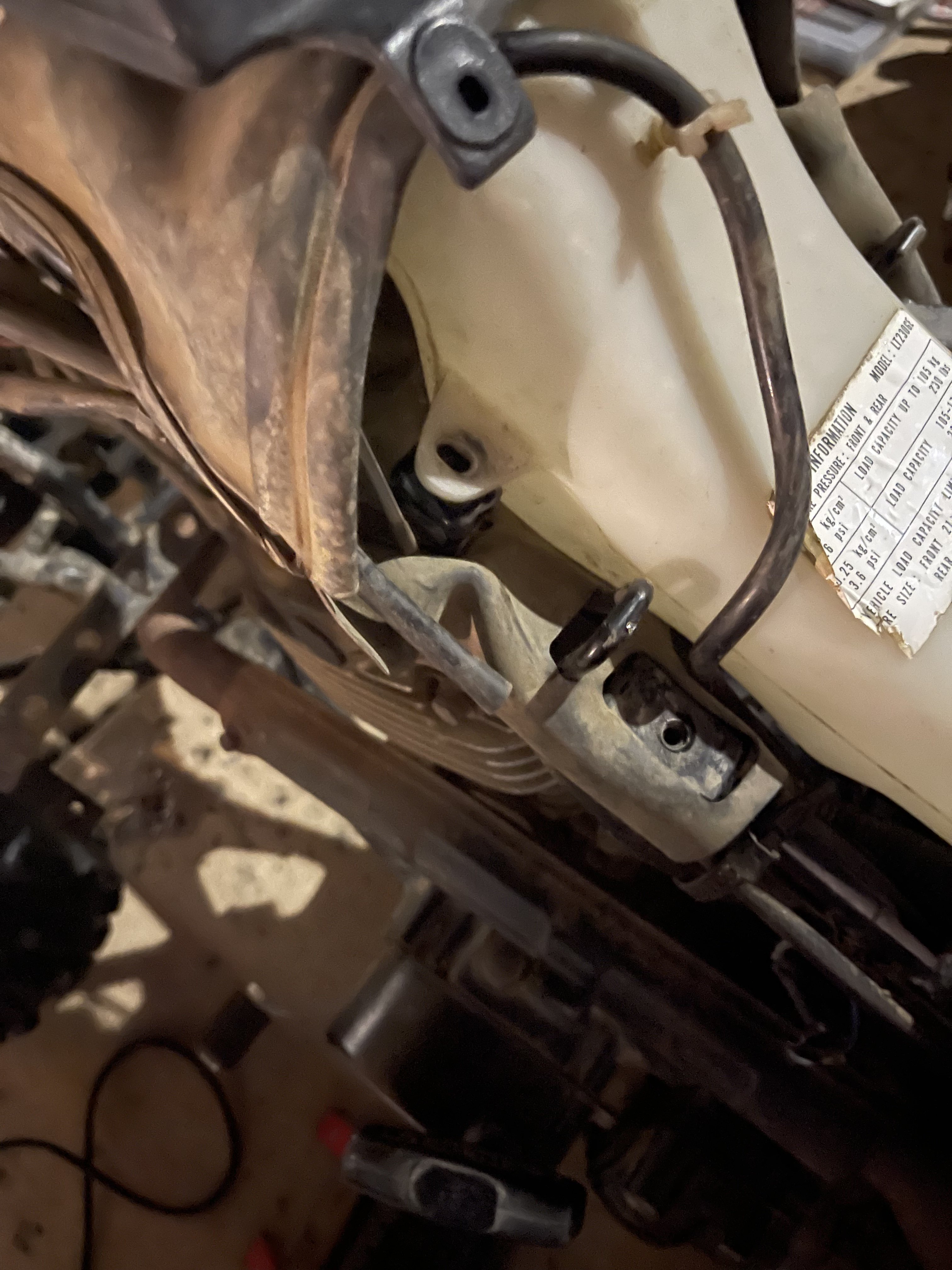

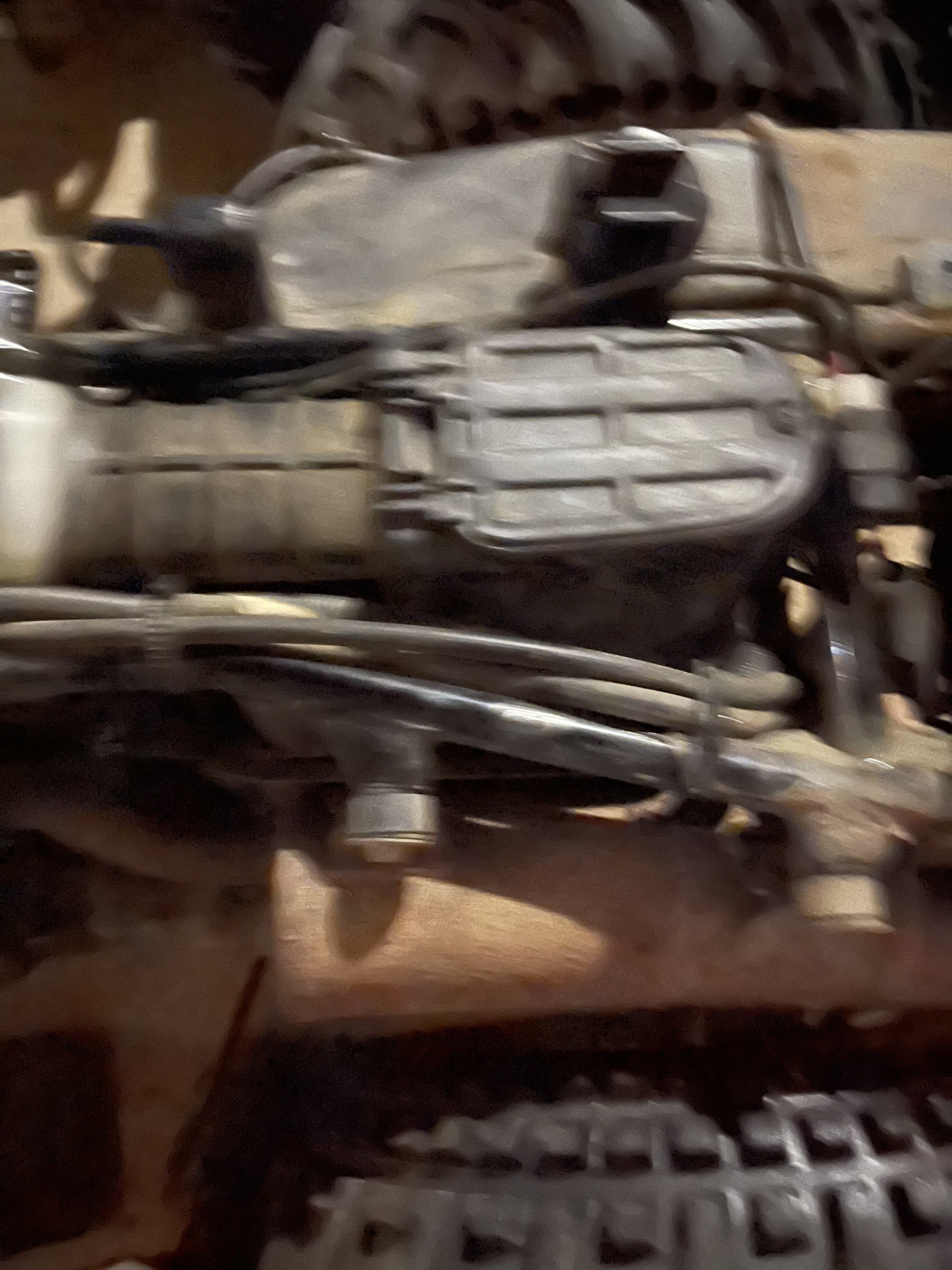

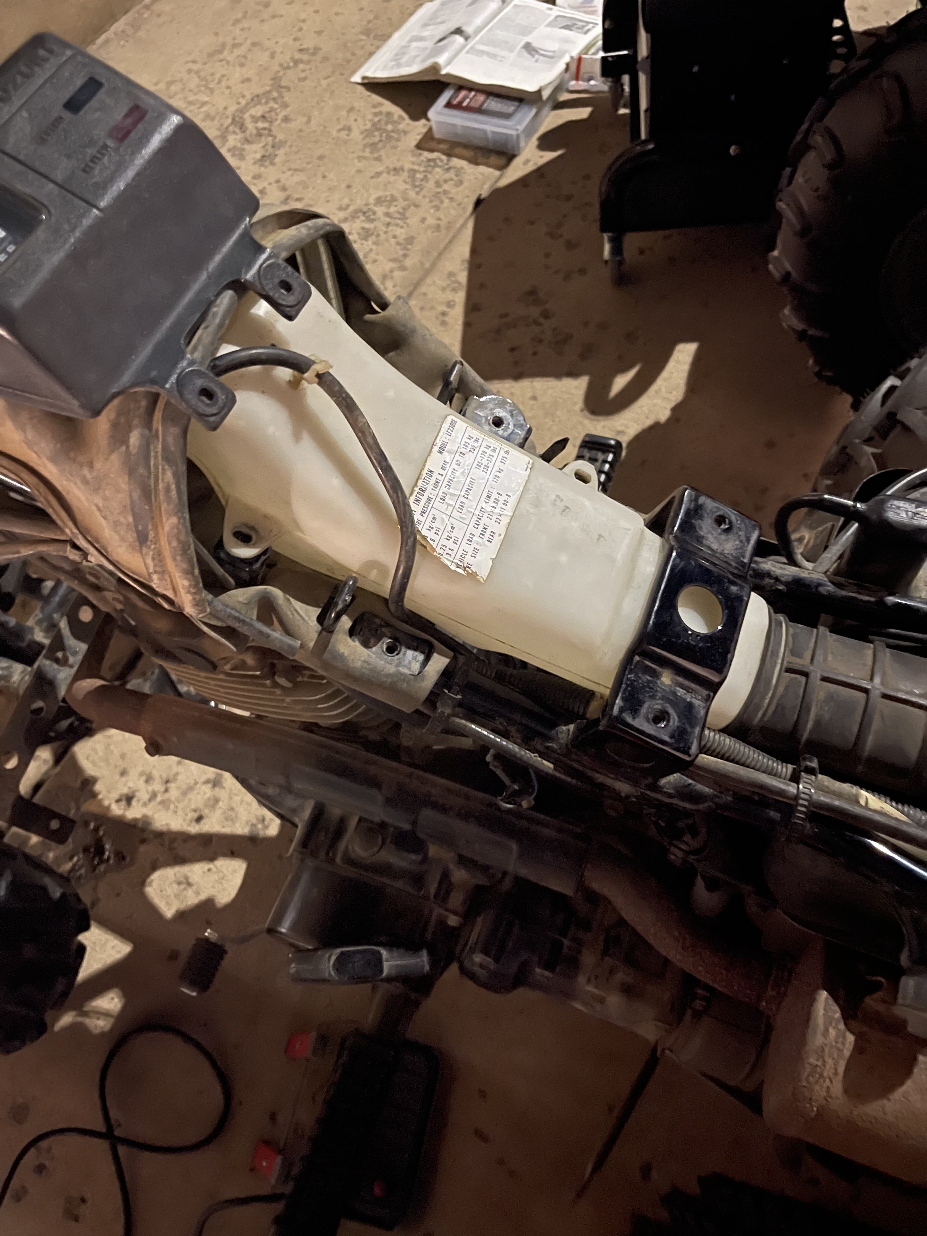

I replaced fuel Pump and i still having a problem ! Im getting fuel and its all good but engine is reving super high red lining I adjusted throtle cable took off air box checked all air ducts and lines no cracks or holes I pulled spark plug running rich if i put my hand over air duct i can get it to isle good but with air boxs on i cannot lower rpm of engine! Do u think if i lean out carb with the needle that goes through plunger will that drop idle speed or possibly add another air filter in air box Im using a uni air filter i will put a pic of air boxs and ducts in talking about .Its the black one that goes into the white one when i hold my hand over it it runs great but thats not a fix Could it be a leaking top end gasket on engine or a bad piston pushing to much air ? Im at a loss right now The white box goes into a canvas bag witch is dirty full of dust does the end of this box go to something or it take s in fresh air and the vent line from carb that goes to this white box does that connect to anything i have manual i have to check any advice will help
