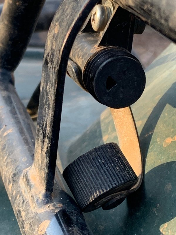

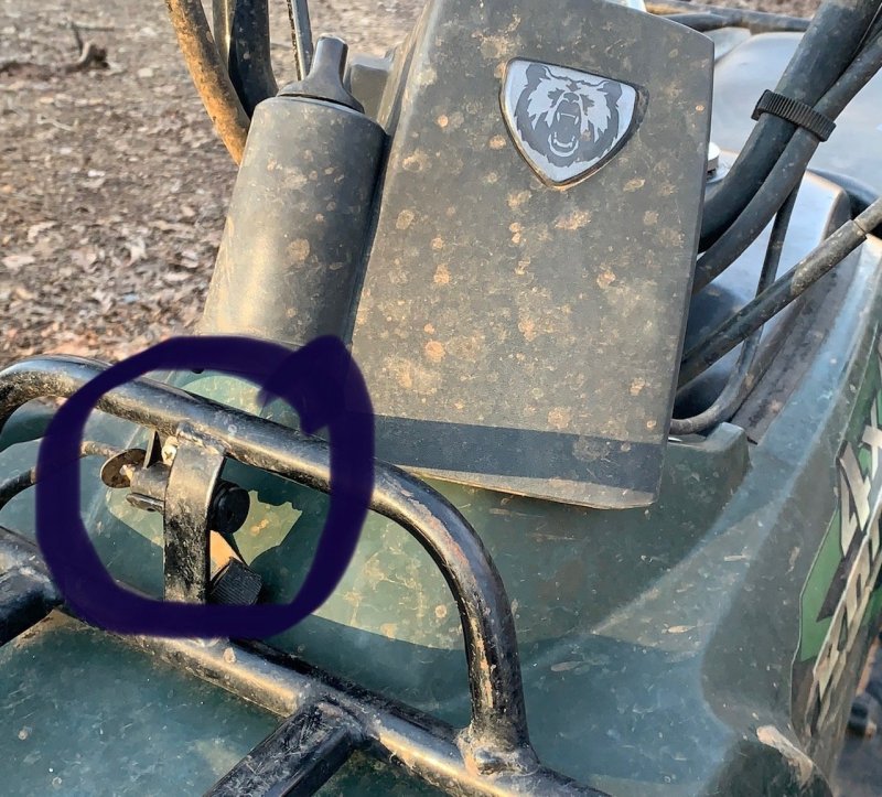

Hello everyone.  First post here. I have a really nice 1999 Kodiak 400 4x4 I picked up a few years ago as the second owner.  I have put around 500 miles on it but just the other day I noticed a small, and somewhat hidden, auxiliary electrical plug.  It is located, and firmly mounted on a factory mount, on the rear of the front rack but in front of the steering column assembly and plastic housing.  I have searched the internet in depth and found that this is in fact an auxiliary plug.  I took the cap off of it and it is a very odd design. It is a female plug with only one receptacle.  I did find online that some of these older models came with this DC outlet and that the machine, when purchased new, would have come with an adaptor for it so it can obviously be used.  Can someone please point me in the right direction where to find this adaptor, its part number, or basically any information that can be of assistance regarding this "new find" on my 4wheeler?  Thank you all in advance.

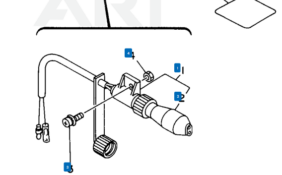

I think #1  is the plug  https://www.partzilla.com/catalog/yamaha/atv/1999/kodiak-4wd-yfm400fwbl/electrical-2
#59V-81942-00-00 COVER https://www.motosport.com/oem-parts/YAMAHA/1997/bigbear-350-2x4/electrical-alternate
