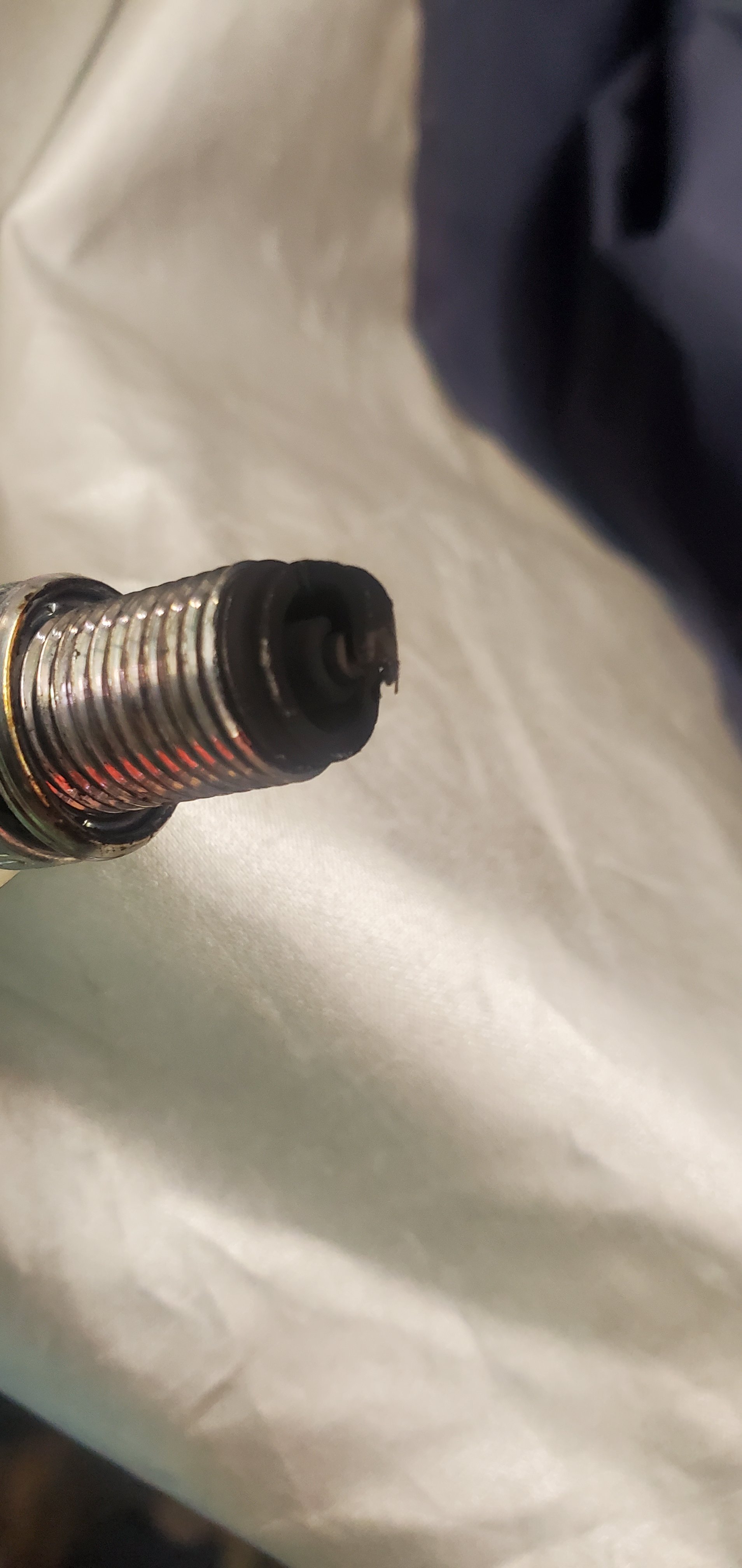

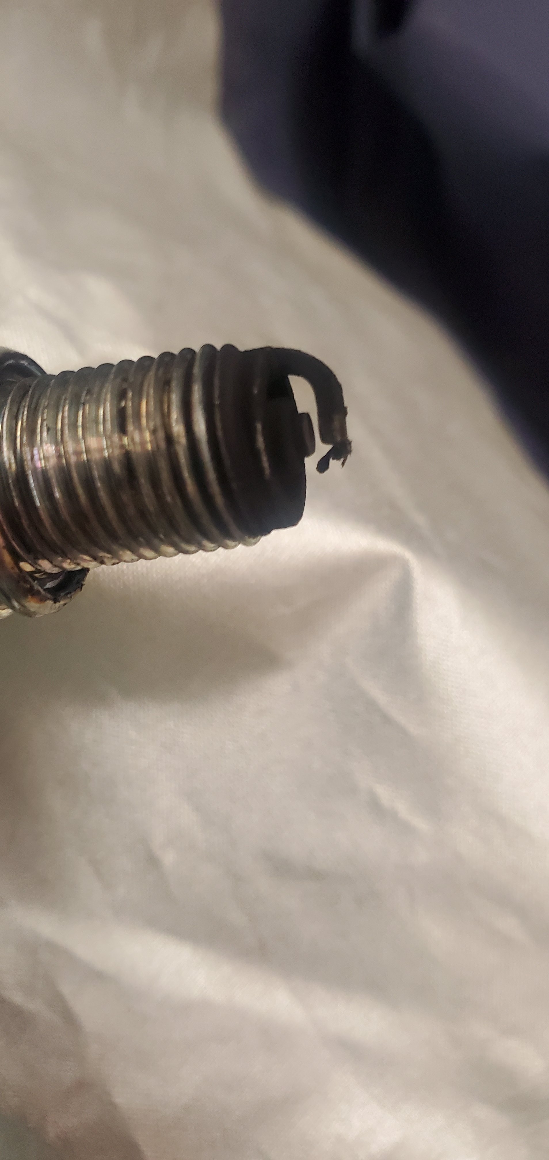

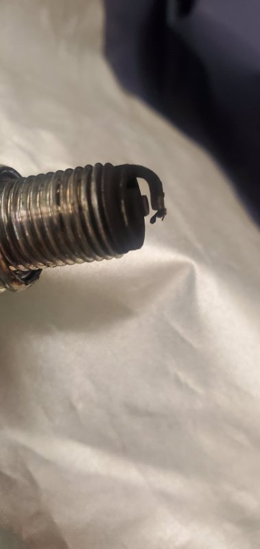

I checked with a new plug after I checked and had fuel. It had spark but wouldn't start with the old plug. Changed plug and it started right up. Only issue is old plug was not that old and has a buildup of either oil or carbon on it. Any idea20220926_163530.thumb.jpg.5d96d69f4c57a476dc10fcf03334fe93.jpgs what could cause it? I'm going to attach pic.
It looks like it's burning oil probably..  If you have a propane burner or welder heat that plug till t stops burning clean, then put it in and start the motor. Warm the motor up and then start opening and closing the throttle, give it about a quarter or a bit less throttle so the revs come up to about three-four thousand revs, then let it off, then on again once it slows but before it gets right to idle. Keep doing that while you watch the exhaust. It will probably start smoking, and get worse and worse the longer you sit there cycling the revs up and down.. If it does, it will be the rings. The other common thing is the valve guide seals, they show up if you let it sit till it's cool, then start it and it will smoke for  a minute or two ..
If it's not oil burning, it must be burning way way too much fuel.. The carby needs checking over.

When I see plug that looks like that I think it is flooding, but since you put a new carb on it with no change I would suspect it was not getting a hot enough spark which would point to the cdi, and it also sound like the timing isn't advancing enough to keep up with the increase in throttle which would also point to cdi. It could be burning some oil but I don't think that's your problem, the plug looks sutty black and not shiny black. When its running is the smoke black or blue.

It could be that the oil you are using isn't tolerant of being used in older/worn motors.
Some oils burn up just fine, some oils when they burn foul plugs..  You might try finding an oil recommended for older or worn motors.. The flasher oils generally have additives in them that foul plugs if they are burning oil.. Plain old mineral oils are better for old motors.
Well.. it depends on the brand of oil and what sort it is, but I've found that in old motors, and two-strokes, that some oils foul plugs. High detergent oils seem quite bad for it. They don't get a big thick layer of solid carbon on them, just an oily look.. Just shiny or wet looking, but it really buggers the plugs, even a good clean doesn't always get the plug reusable.. heating them in a flame sometimes does though..
