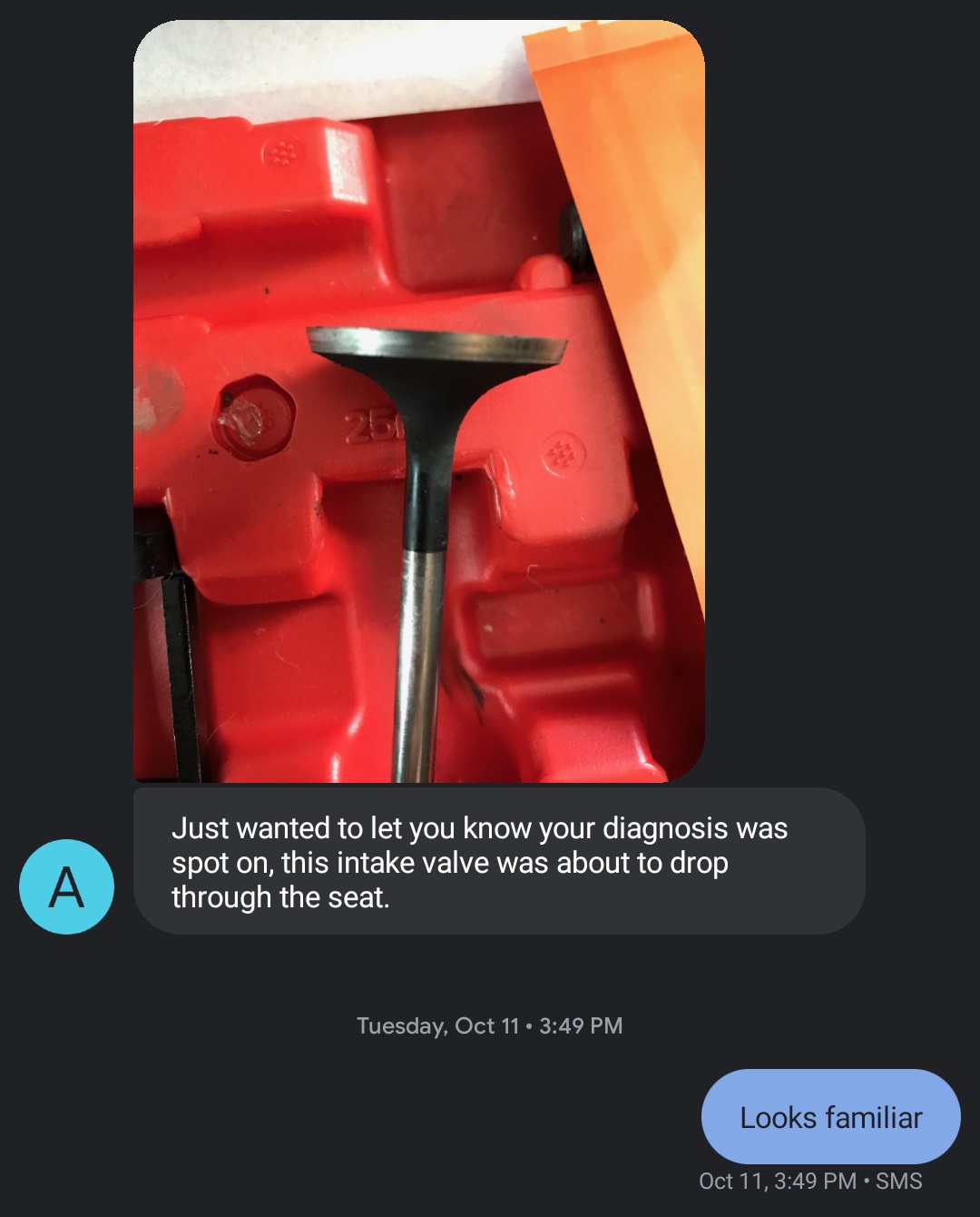

Here's a pic from a guy who posted on here before:
And here's how I knew:
I've seen it a lot.  And I'm not even a professional mechanic.
