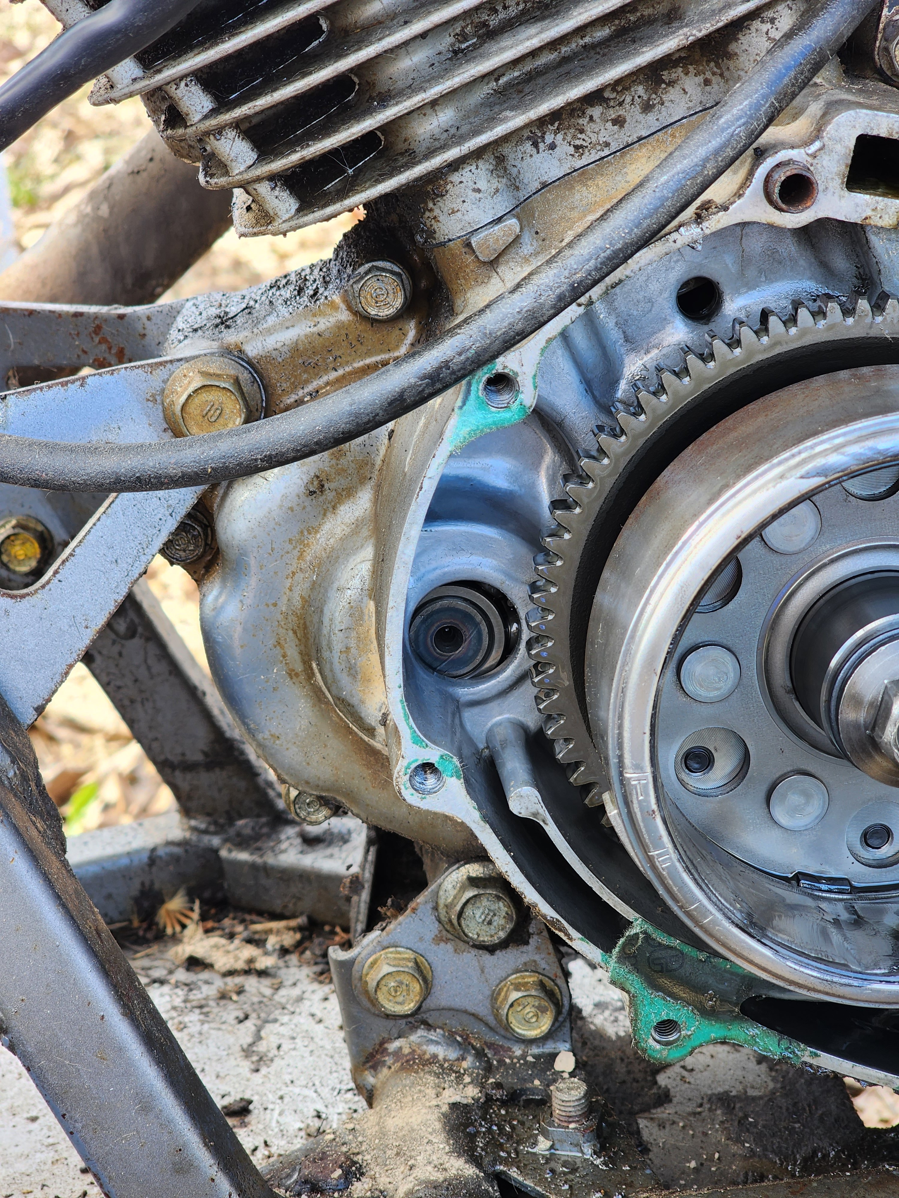

I'm beginning to think there is no telling what I bought. I tore it down to the flywheel and, I've found something that's making me wonder if I just through a bunch of money away. 😟 Here is the photo that has me worried if you look to the left of the gear and flywheel, you'll see a hole with what looks like something that's not, lined up with the hole inside the engine.
I did that gently and it did move a little. I sent the photo to my grandson and he thought maybe it was the cam. I've got a starter clutch one way bearing coming next week. I'm hoping that will let the engine turn over and start. That starter sounds like the ones in the old cars when the bendix went out.
Oh, well that's not so good..  That bearing of course shouldn't allow any movement to speak of, a thou or two..
Might be good to check for metal in the oil and filters..
