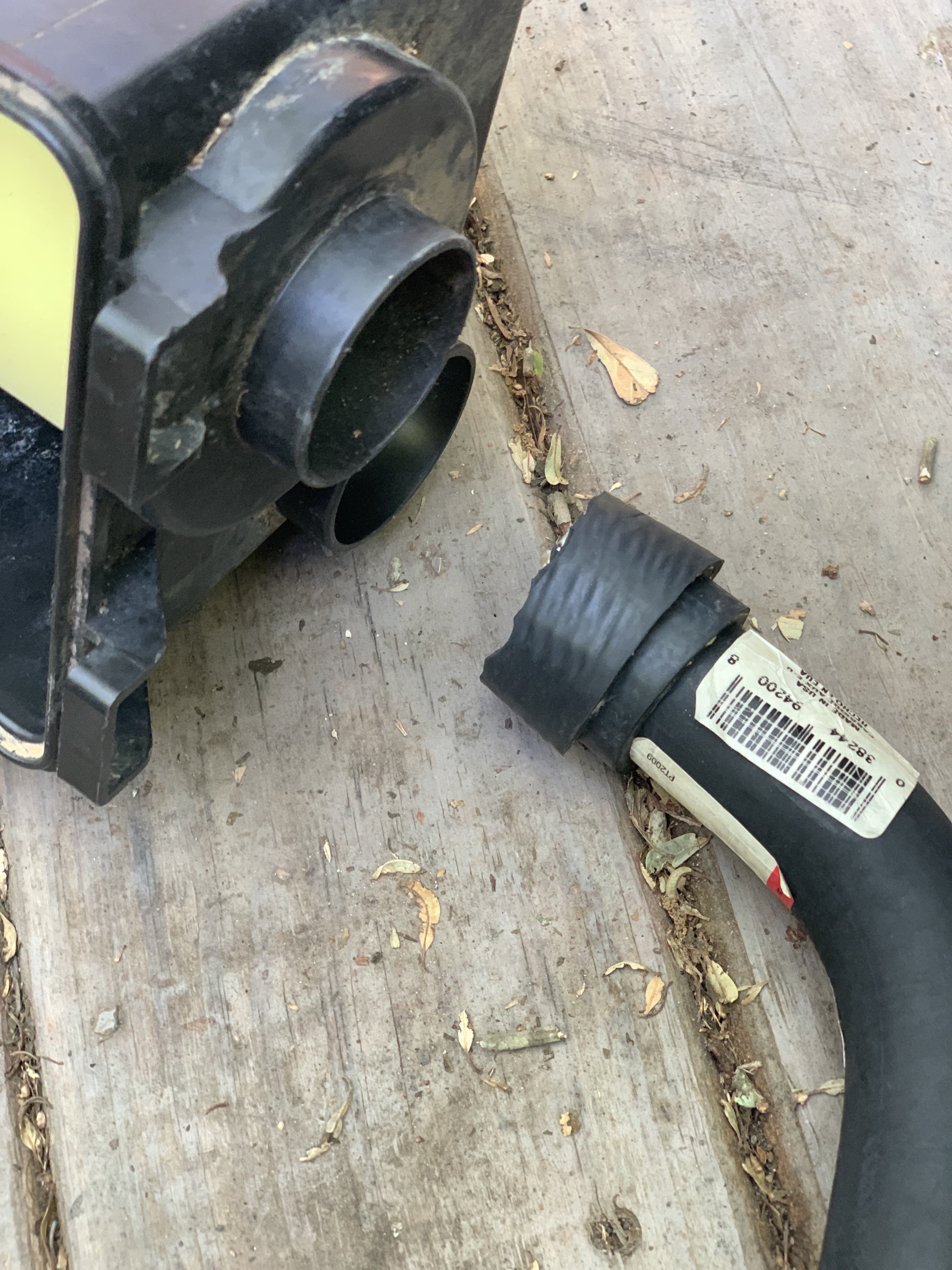

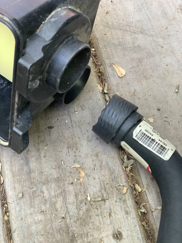

I am in need of a breather tube diagram for my Rancher.  This picture is all I could find in the manual I have.     If you have the hose size and/or lengths needed that would be a bonus.

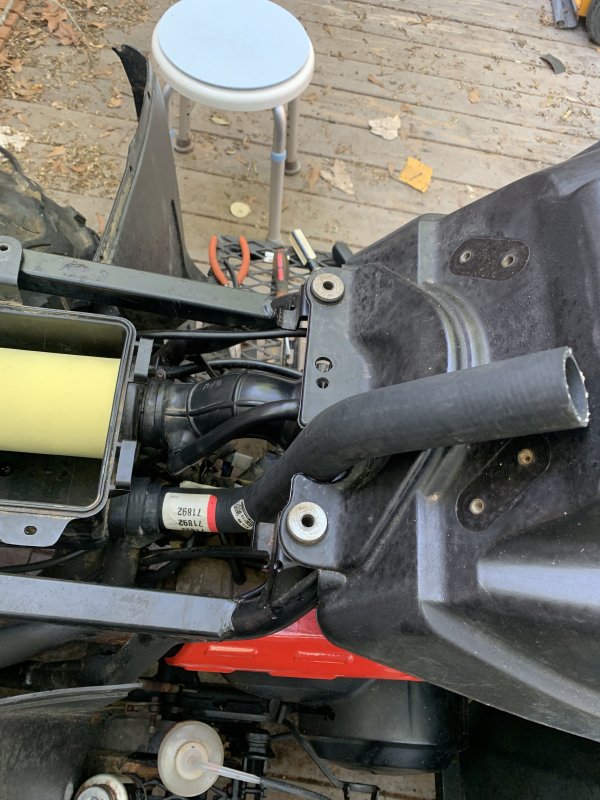

Pretty bad illustration, but it does hook to the Airbox under the brace, like the photo shows, and just hangs out with all of the smaller hoses going through the underside grommet to hold them in place, there are several angles that are premade on the OEM one, are you trying to make one that will work , or what are your thoughts.
Almost all of the hoses are dry rotted and i have no idea where they go as they are all broken, disconnected and flailing about.  I just want to buy some hose and replace them.
I did that on mine it kind of works but their was no place to put the smaller vent lines, you can make something or tape them to it. Had to make an adapter to fit tight and glued it in , hose wasn't big enough to go over the connector
It worked I ended up cutting it even with the gas tank mount. OEM for mine was not available and so far I haven't been willing to pay 70.00 for the muddy deteriorated one I found on Ebay.
Good idea but wrong tubes.  I am referring to the about 1/8" tubes coming and going all over the place.

Oh Ok I thought you were talking about the large tube, smaller ones are easier. I had some of the smaller ones also didn't have to replace them just figure out where they went and route them accordingly, and the OEM large hose had a grommet for them to fir into.
