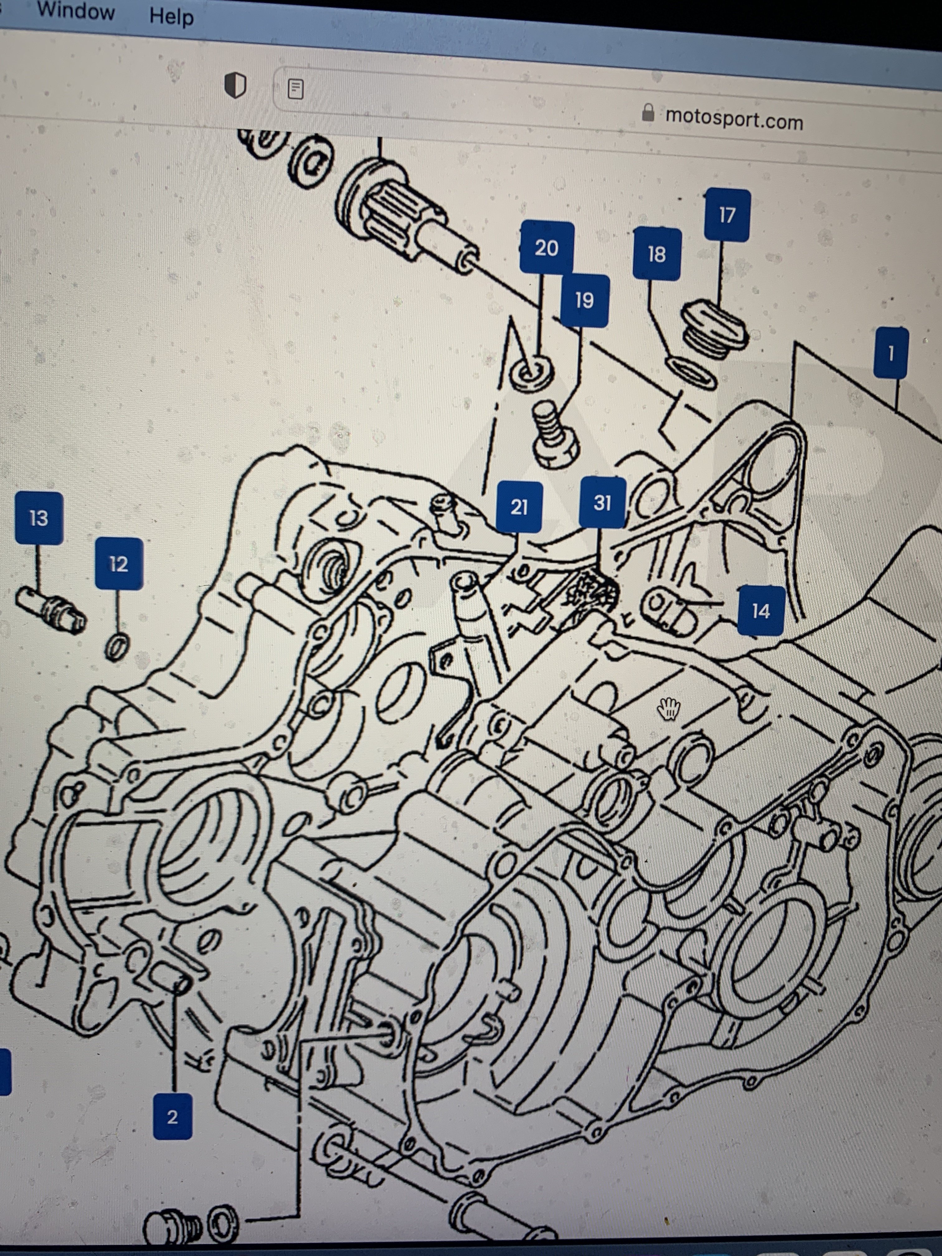

it got me thinking though… where is the crankcase breather on these? Maybe mine is plugged and as it generates heat and runs it slowly pressurized and pulls fuel hard from the carb and dies? Is there a way to test this? I noticed one breather is missing the little snorkels they come with.

Anyone have any idea where the crankcase breather is on these LT4WD?
They vent up near the front of the tank and into the air box. But the problem is the fuel in the cranckcase..  It gets warm and evaporates causing the pressure.

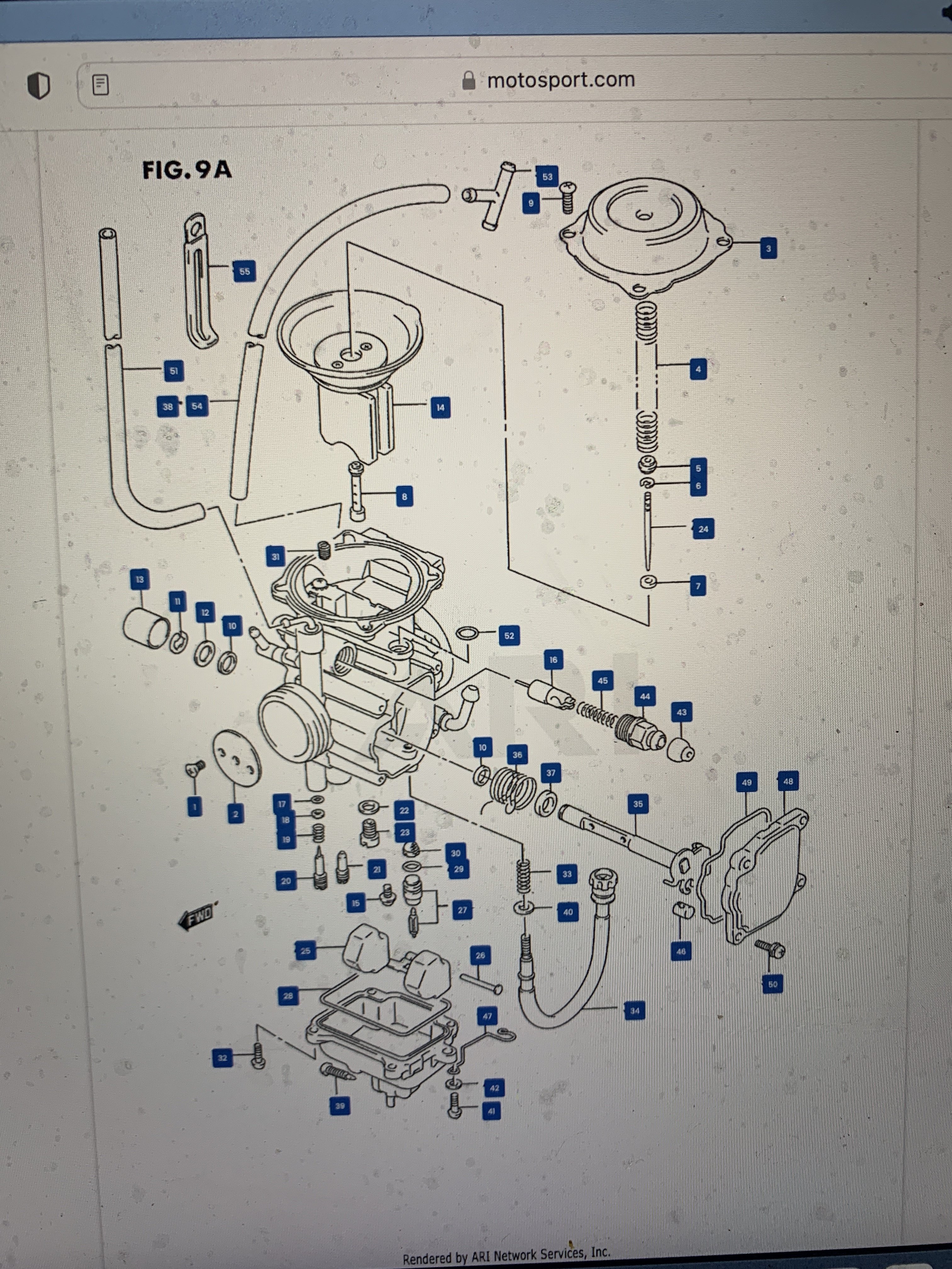

The crankcase vent is on the top of the crankcase where mech said just to the left of 21

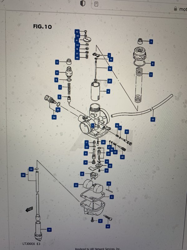

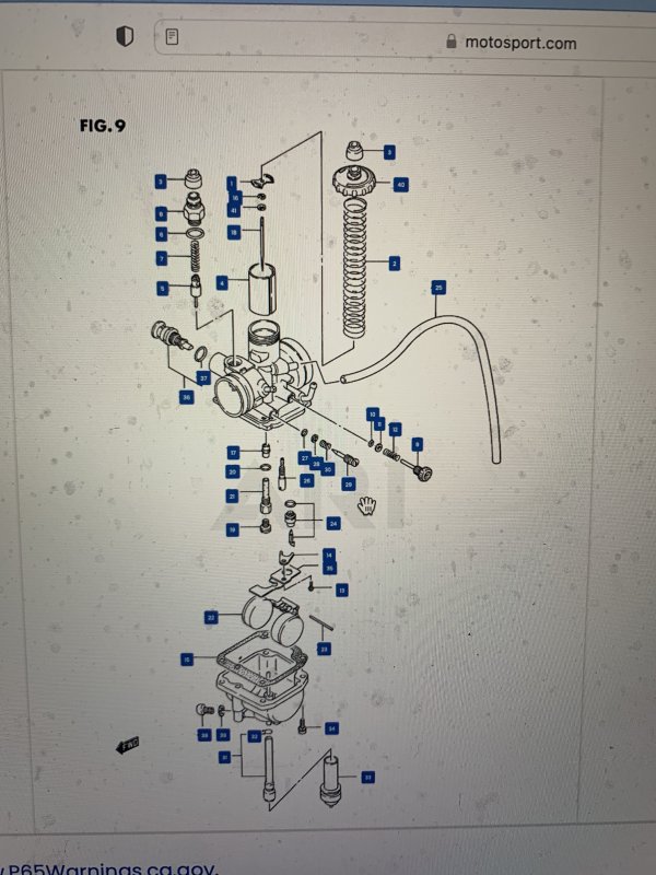

It appears there were 2 different carbs that came on the 88 model depending on the model letter this is a diaphram model it had a 122.5 main jet and a 40 pilot jet with a 160 air jet.
This one had cable actuated slide it had a 100 main and a 22.5 pilot no air jet listed
This is the one from the 300e with cable slide 112.5 main and 20 pilot.

And yep, I have the slide carb in the middle diagram.  The shindy kit I had replaced the jets with exactly the ones you mentioned.  100 and the 22.5.

I also noticed that those crankcase vents only vent into the airbox, no branch to the front near the fuel tank..  Where that hose fits to the front of the airbox there is probably a restrictor, or it might even have a restrictor inside that rubber hose.. some did. They get blocked with gunk and can cause crankcase pressure..  but again, it's not your main problem..
