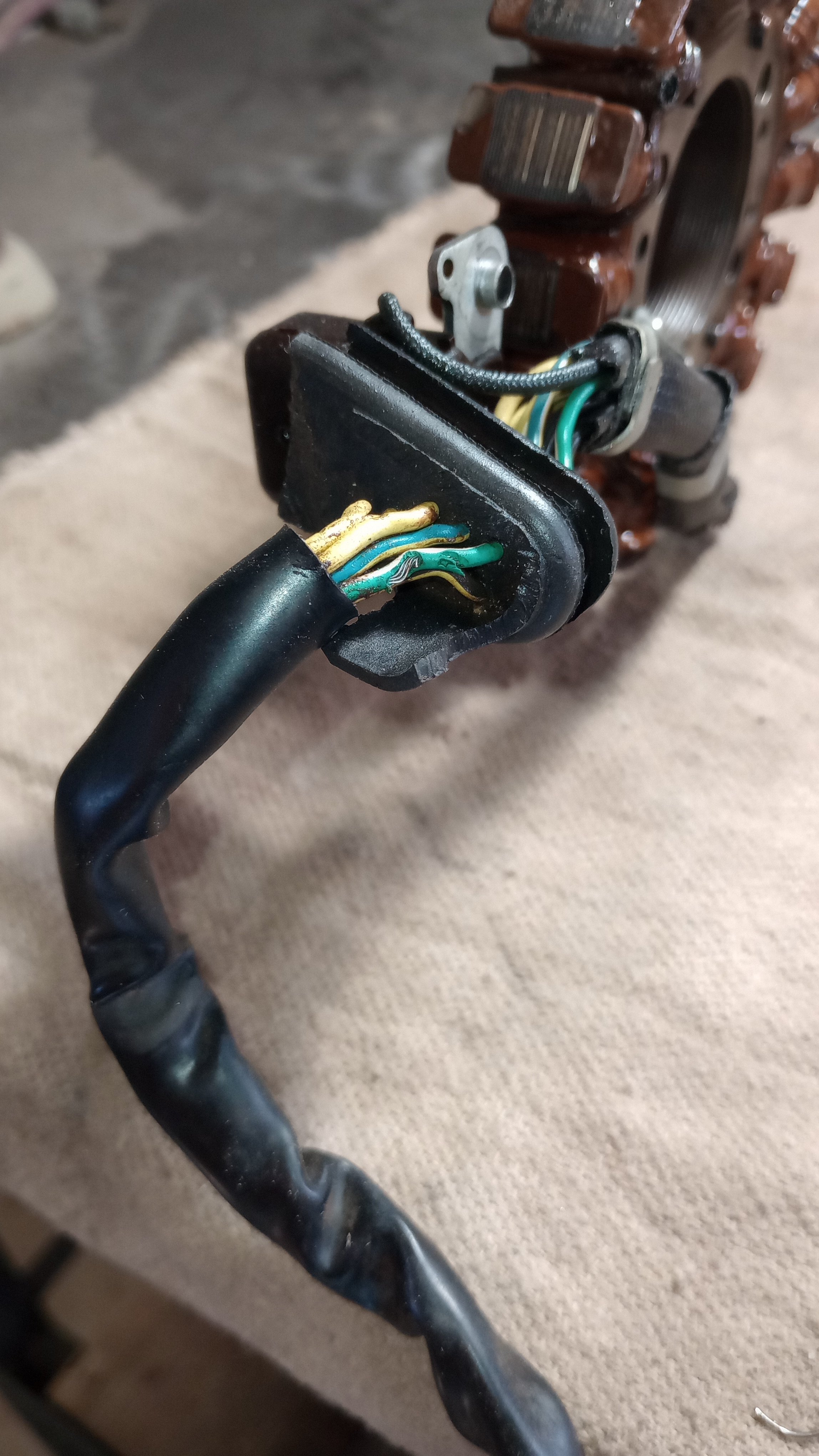

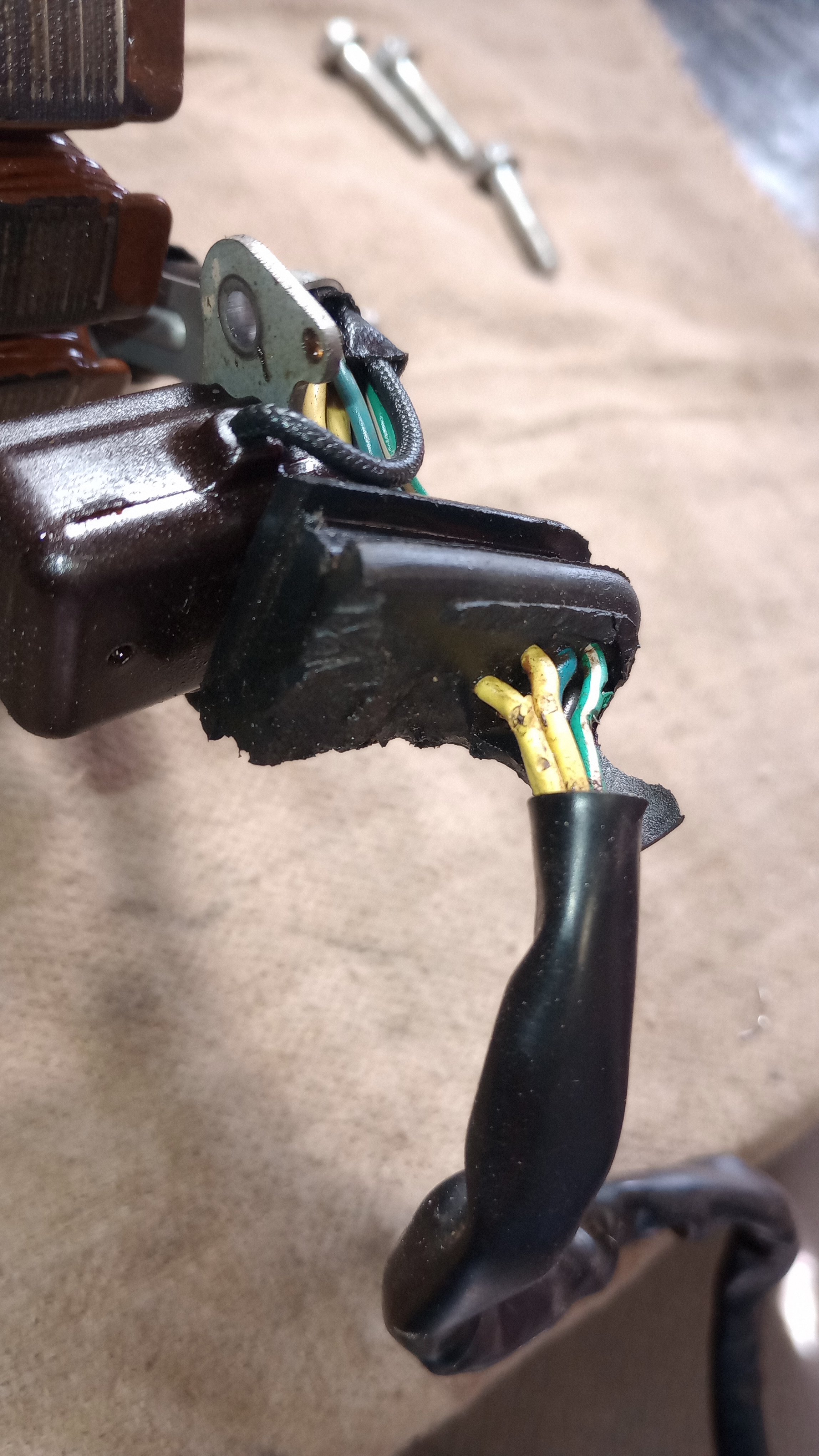

I have replaced the spark plug, ignition coil/wire, and traced wires best I can. I noticed a couple frayed wires at the pickup coil where it enters the case. So, now I have the cover off, stator and pickup coil out and trying to test the coil. I do have about 114 ohms resistance for pickup best I can tell. And I can read minute voltage when I drag a magnet across it. Could it still be bad? Can a bad ignition switch/button cause this? (I did have the switch off to oil the choke cable)...pulling rope makes no difference though...any ideas or help would be greatly appreciated!!! It's the intermittent part that's throwing me off!image.gif.6dad23e7ae8666bc1deffc7cb5213c4e.gif
You really need to download the service manual and follow the diagnostic procedure. The battery needs to be charged.
First I'd carry out the resistance tests on the cdi unit. You need the manual for that.
Then I'd check all the wiring for continuity from the stator and pickup coil to the cdi and all the earths on the bike, and for any chafed wires that could be shorting to earth.
The pulse sounds about right but the manual should tell you what it's meant to be. You need to be sure it and the stator are connected to the cdi though so I always test their output at the cdi plug. If there's any chafed wiring they might have continuity but they might be shorting to earth intermittently, so inspect the wiring. The spark should be fat and blue even when it's intermittent. If the sparkplug cap comes off the lead I'd take that off and test the spark. The switches earth to kill the spark and in theory shouldn't have a problem with dirty contacts but I'd strip them and check they were getting full travel of the contacts and that they didn't have dirt in them causing shorts. I'd check all the connection plugs too for dirty contacts, broken wires or dirt causing shorts.
Get the manual and have a look. The models vary a little and you need to check which model you have to test things properly.

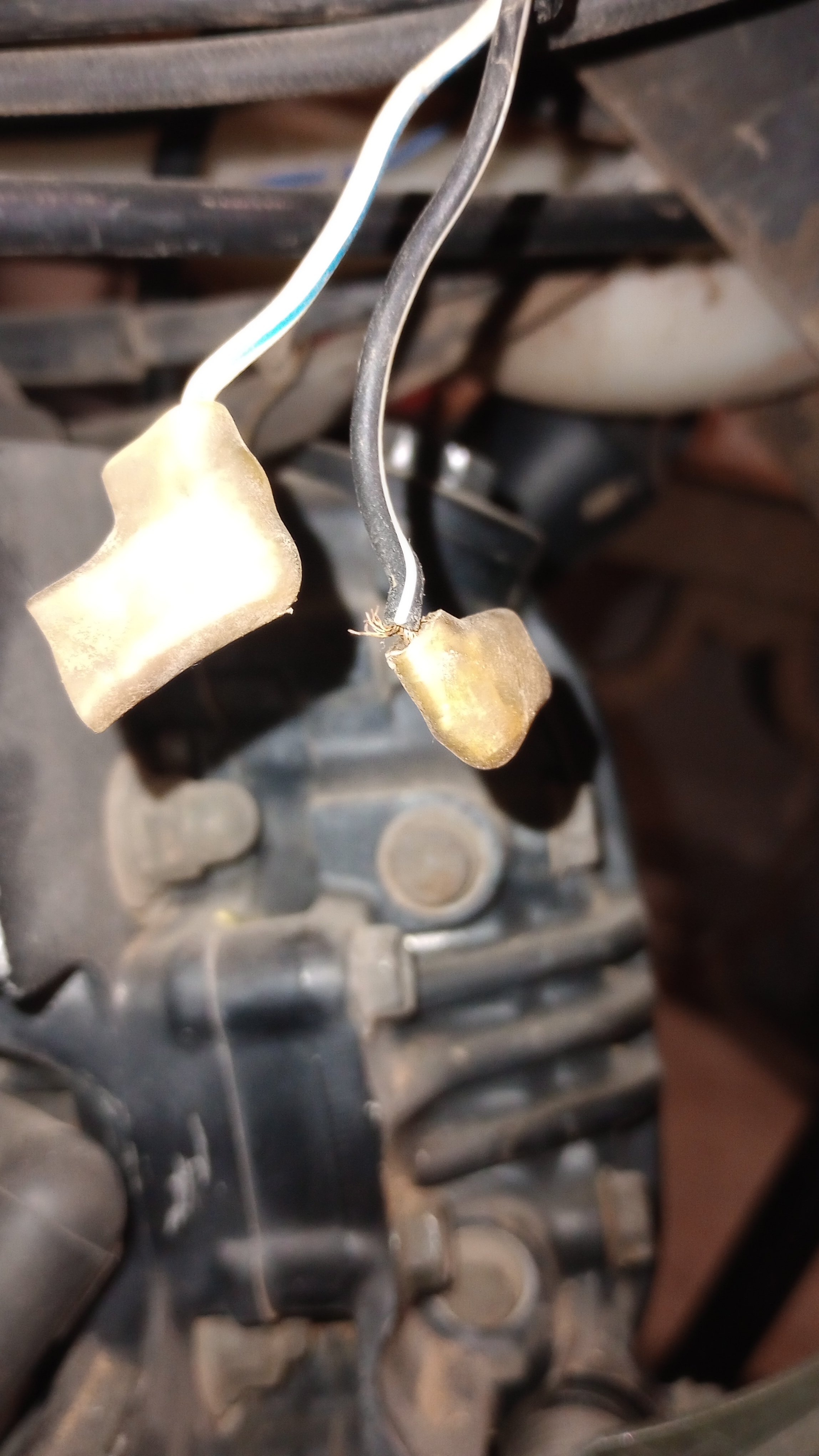

Thanks Mech,
I will get a hold of manual. Working on my requirements on here...lol. Last night I did find that the black wire coming to the ignition coil only has about 50% of the strands connected.🤦🏼‍♂️ So, that could very well be the problem. Once I get ahold of the manual I will look into all the testing procedures.

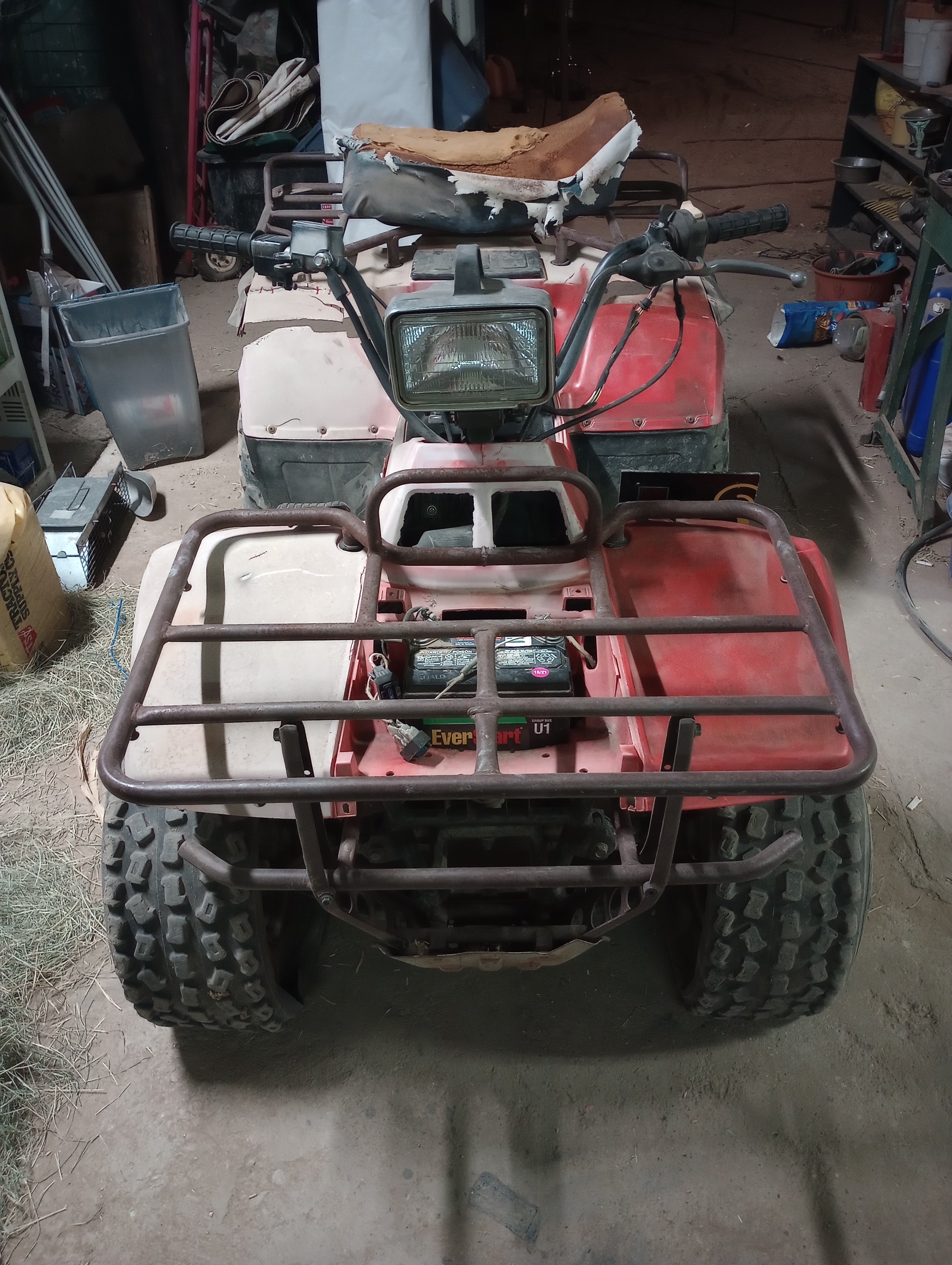

Thats funny! $20 he should have give him 20 to haul it away.
Lol. Even if I didn't do anything else to this quad, the few times my son was on it when we had it running was definitely worth $20! Smiling ear to ear the whole time. But, since I'm this deep into it, I'm gonna take it all the way and get it somewhat restored 🤙
I think they are fine machines, i  myself like the older ones, they were built strong tough and reliable. Wont take much to get it going i bet. The memories you will make with your son getting it going will be priceless. Family and all It would have been worth 20 dollars to me to see his face when i handed him the key . Good luck with it keep us informed.
Those big smiles are definitely worth it! My Wife says I have that smile every time I ride! I can feel it in My bones! $20 is nothing compared to the feeling of finding and fixing the thing and then riding it! There is something about bringing a great old machine back to life. Enjoy the time with Your Son!
Yup, the size of the smile is pretty much the measure of a bike I reckon. Doesn't matter if it's a little mini or some beast, if it makes us smile then it's a good one.
Good idea to go right over the bike when you first get them I reckon Ugly. Take all the plastics off and grease all the bolts and screws, inspect and re-tape the wiring and check it's tied on securely, check all the hoses for ageing,
Wires nearly always break right where they go into their metal terminals, and sometimes it can be inside the insulation so it always pays to wriggle each wire gently checking it isn't suspiciously flexible. Hopefully that near broken wire will be the trouble. If that doesn't fix it and you have the plastics off you could disconnect the regulator and try it. If the earth or battery power wire going to the regulator break they cause misfiring. While it's apart I'd clean every electrical plug because dirt in them if it gets wet can conduct and cause problems. I like to clean them, let them dry and then fill them up with petroleum jelly, which is vaseline.

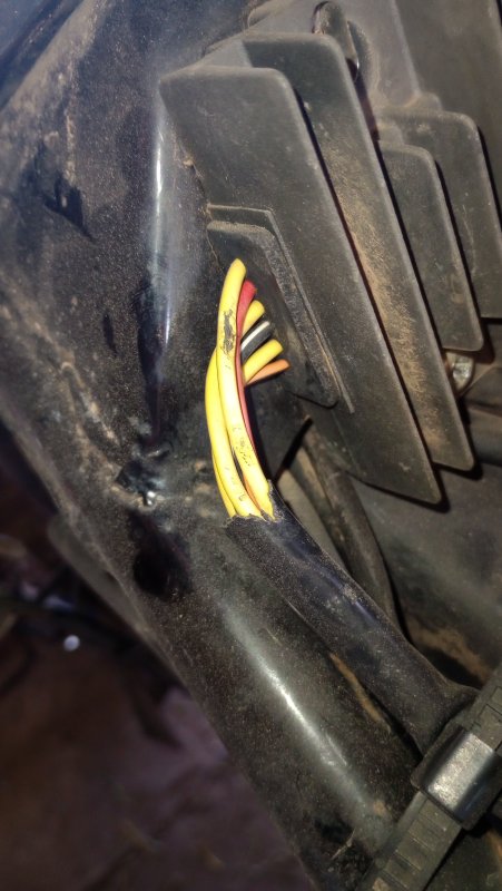

There are definitely a few wires throughout that have been chewed on...one at the rectifier, a couple at the pulse coil/stator and a few more minor ones that I'll address while I've got it all opened up. I'm learning a lot about these things. I'm a "get in there and just do it" type of learner...lol. But it definitely helps to have all this advice! Here's some pics of the current state of it and some of the wiring issues. Might just get some of these open insulation areas taped/sealed off and see what I've got. The pulse coil and stator tests out ok...so I think if I get them sealed up I may be ok there until I can get a new one.

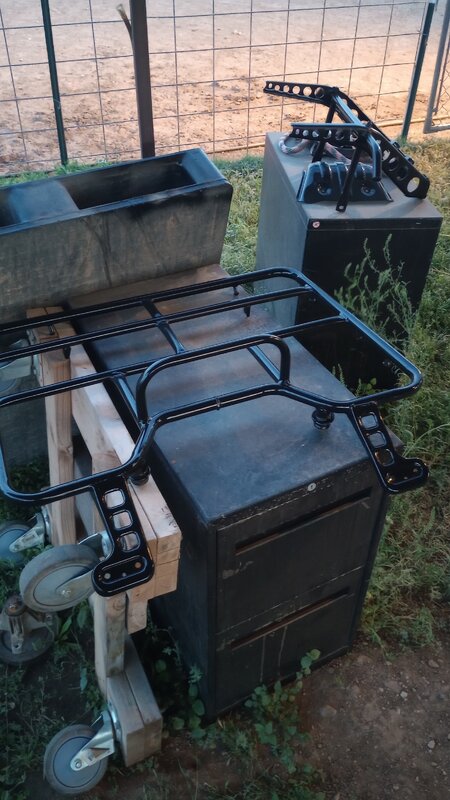

The frame really is in good shape considering it's age. Surface rust on front bumper assembly, both racks, and the hitch. But I'll address those once I get it running again. I did the torch trick for the plastics... since they were so chalky white and flaking. Here's a pic of while I was doing that awhile back. I was pretty impressed!
Did a great job with the heat, i have never tried that , i was afraid i might burn through, i guess it takes practice. What i did with mine was take all the plastics off. I set up a table in the back yard with the plastics on it. I washed all the dirt off and let them dry. Them sprayed them down with armour all it will suck it up fairly quickly for the first few days, I did this multiple times a day over a 2 week period, the color started coming back. After that i just kept it wet with the protectant walk by and it be dry spray it down again. After it stayed wet for a day and i was sure the moisture level was back in the plastic, i wet sanded with all grits up to 1000 spend more time with 220 to get out imperfections. After that i went over it all with boiled lindseed oil. Worked well. If you have a lot of broken pieces may not be worth the time but your front piece looked good.

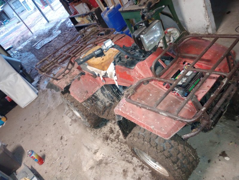

Here you can see the back plastics...😬 Pic from back in September when we played in the mud a bit when it was running.
Pretty rough condition lol 😆. I have some tin formed and riveted underneath the broken parts to just maintain the shape for the time being. Aftermarket plastics will be on the agenda down the road. Although, used ones do come up from time to time on the Bay...🤷🏼‍♂️ Also, I keep an eye out on marketplace for a used quad. Have seen a few on there I'd like to pick up for parts.

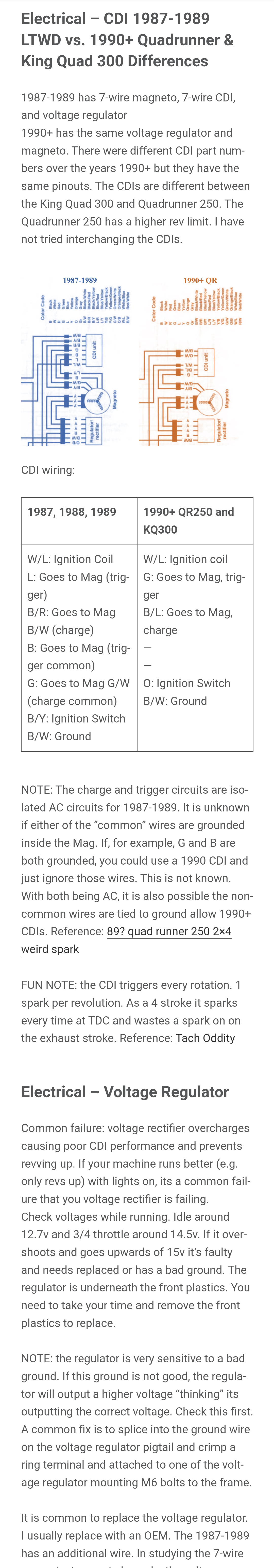

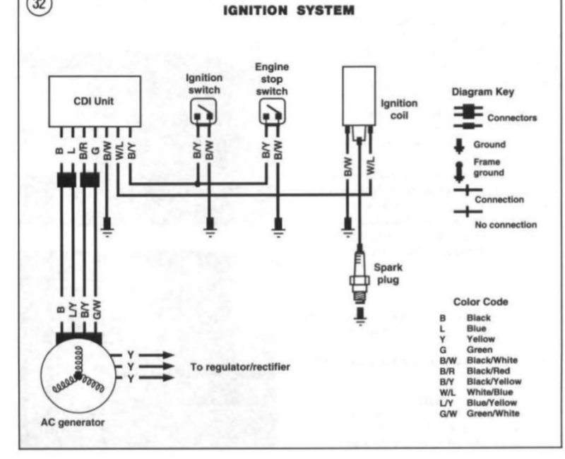

Looked into CDI box just in case. Mine has 7 wires coming out of cdi. Most aftermarket ones are 6 wires, but I think I can wire the kill switch to the coil and it should be able to shut it off?🤔 That's how my mind is working anyways...lol. OEM cdi is about $300. So hopefully it's not that, but I'm worried if the rectifier is bad, it may have fried the cdi...🤷🏼‍♂️🤦🏼‍♂️ We shall see!
19 minutes ago, Mech said:
I don't think the kill switch is going to last long if the capacitor is discharging through it.
This is why I need y'all's help!!!!😜 Lol.
Do you know of a way at all to use a 6 wire cdi then?
There were some aftermarket CDI that claim to fit yours on Amazon but i didnt check the number of wires. According to you schematic what does the seventh wire do, it may just be a ground and the aftermarket CDI grounds differently.
Mine does have a ground...I suppose the 6 wire one could ground itself?🤔🤔

Just a bit more info on these CDIs...
In comparing the 2 CDIs, 1987-99 to1990+, I was trying to determine what the 2 extra wires coming from the stator assembly were for. I was assuming ground. After some research, it appears I may have been correct about one of the wires. And the other should be for the style of rectifier used prior to 1990. So, if I ground the one wire and use a 1990+rectifier, I could possibly use the 6 pin CDI...

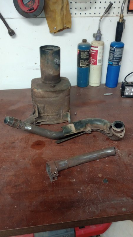

Working on exhaust tonight. Prepping for paint. I had to cut it off, so I'll get it welded back up when I re-fit it.🤙
