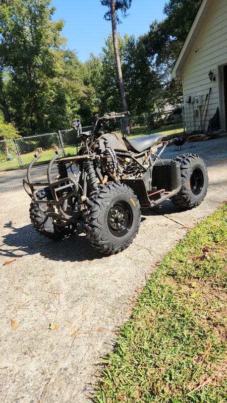

Been awhile! Everything on the ATV is now in working order. I have finished up the wiring, everything works great. Now I've gotta make it pretty.

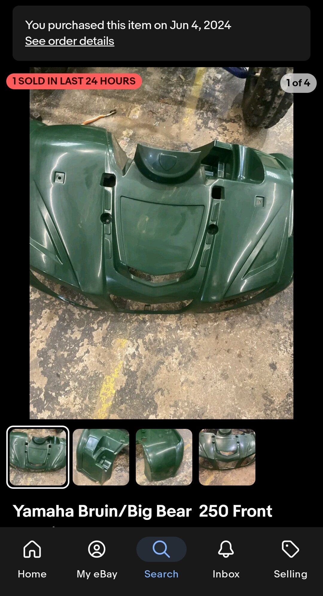

I've been struggling to find front fender assembly, does anyone know if I can use the front plastic fenders from a 2006 bruin 350? They look very identical.

Its not a perfect fit but could probably be done with a few alterations.
Well, I guess we will never know. The correct front fenders I needed popped up on Ebay, I bought it. Hopefully they make it thru the mail in one piece.....looking at you fedex 😂😂
1 hour ago, Gwbarm said:
Good, thats definately the best option, but i may be wrong about the fitment according to  the Ebay ad it says it fits the Big Bear and the Bruin.
That's correct. I went on partzilla and they share the same part number for the plastics between the bruin and big bear 250cc ONLY.

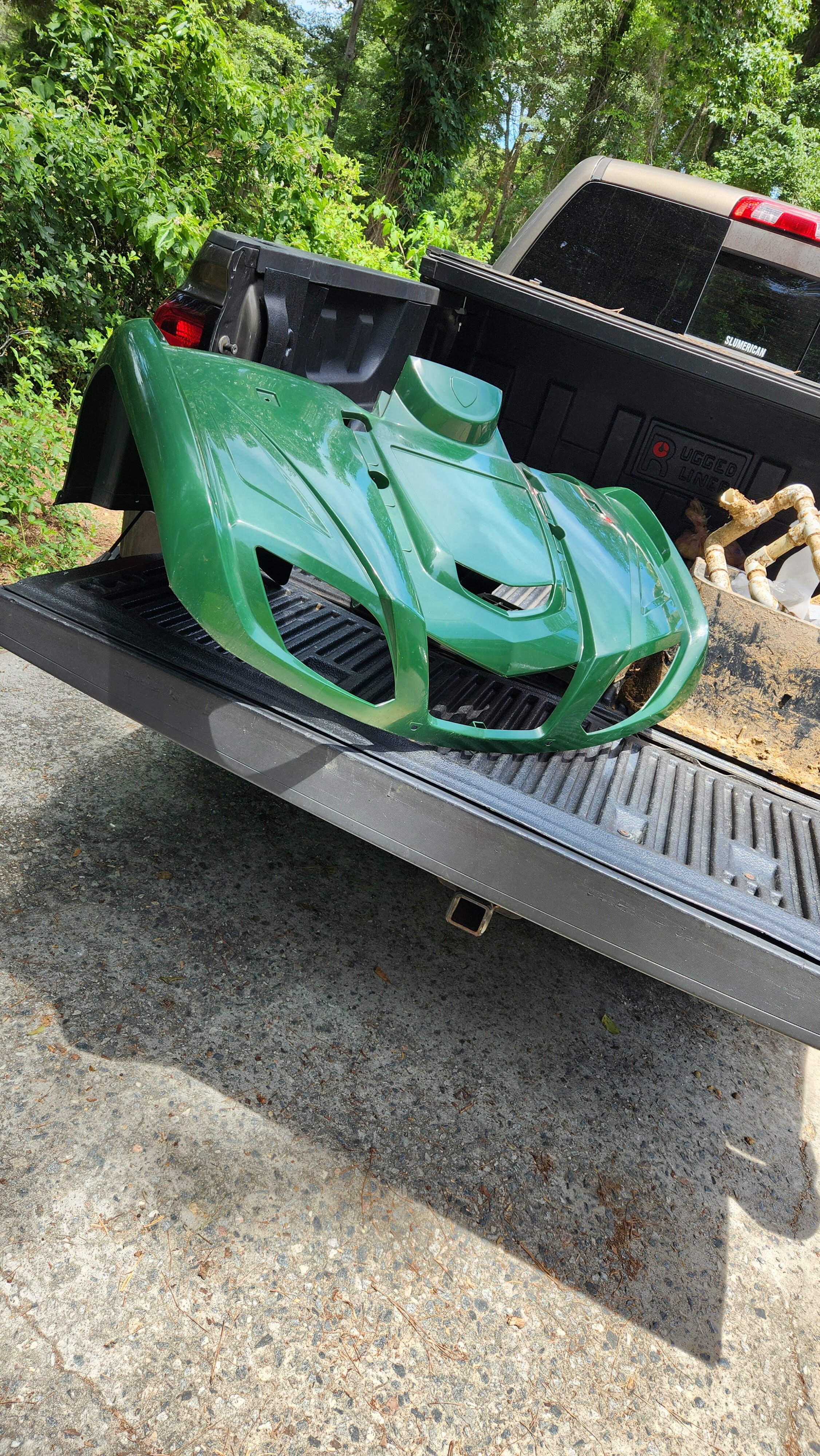

Mail call!
Fedex came by and delivered the front fenders I needed. Wasn't too thrilled with the packaging, but the plastics look brand new! Very pleased!

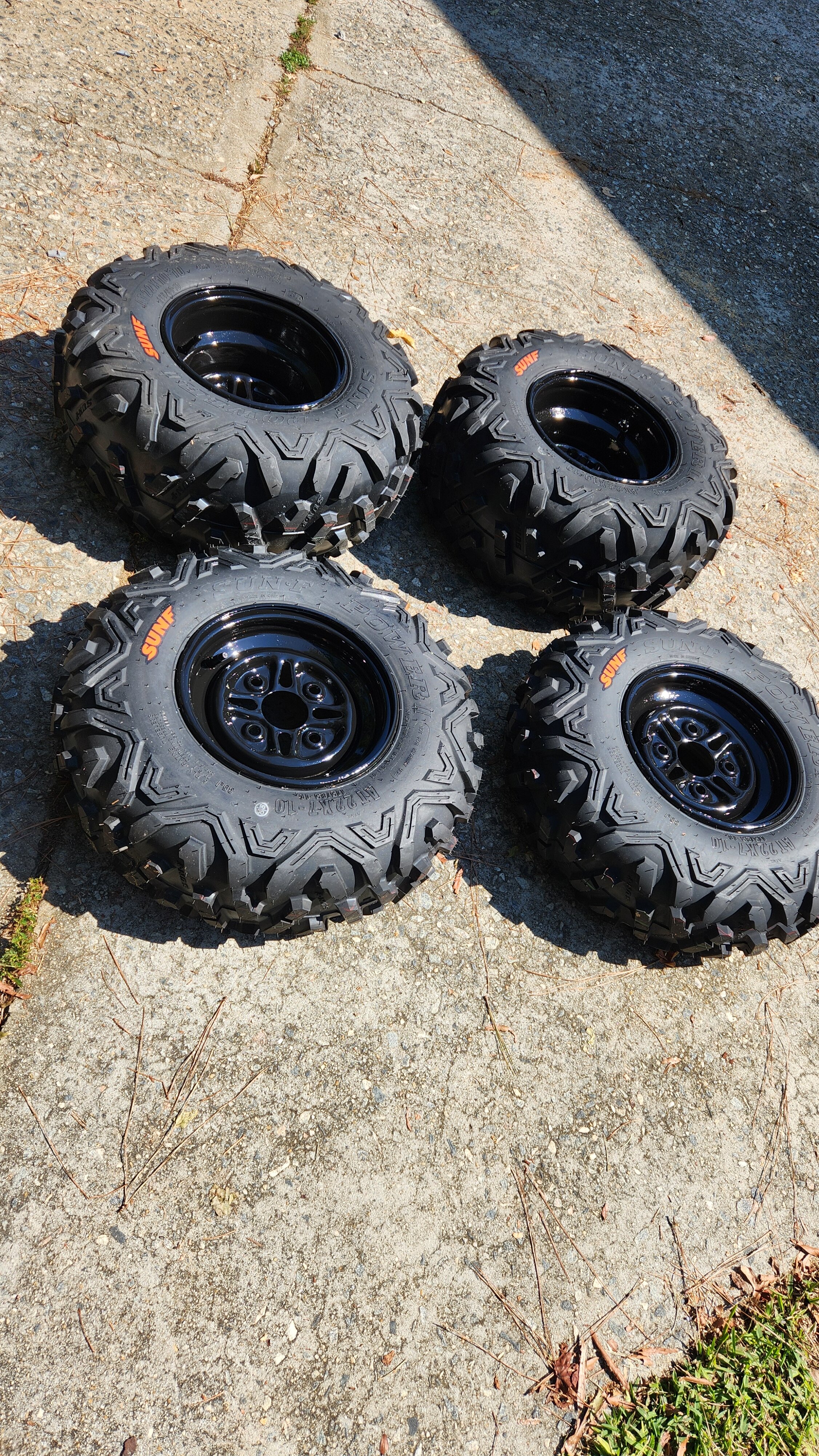

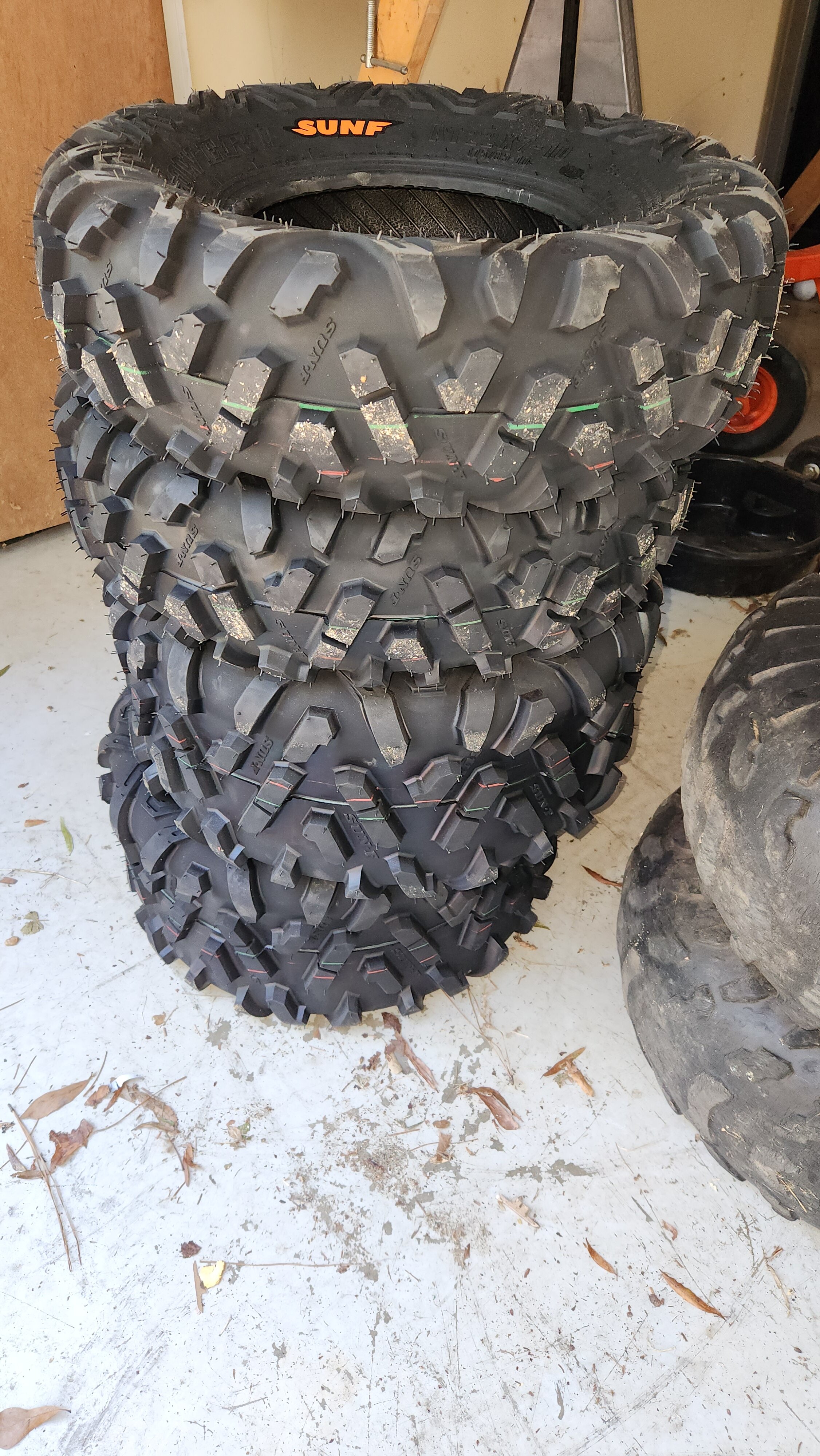

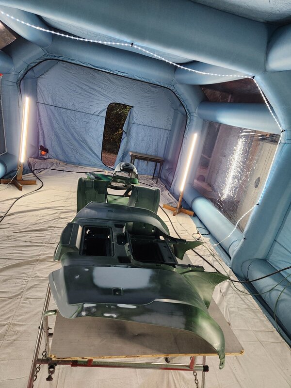

Alright, it's been awhile! I've managed to get all the plastics prepped for paint. Should be spraying those early next week... The new tires did show up today! SUNF Power 2! First glance they look pretty cool, I've got an appointment on Saturday to get them installed. We gonna see lol
Also, bought some lights and switches those will be here Sunday, hopefully.

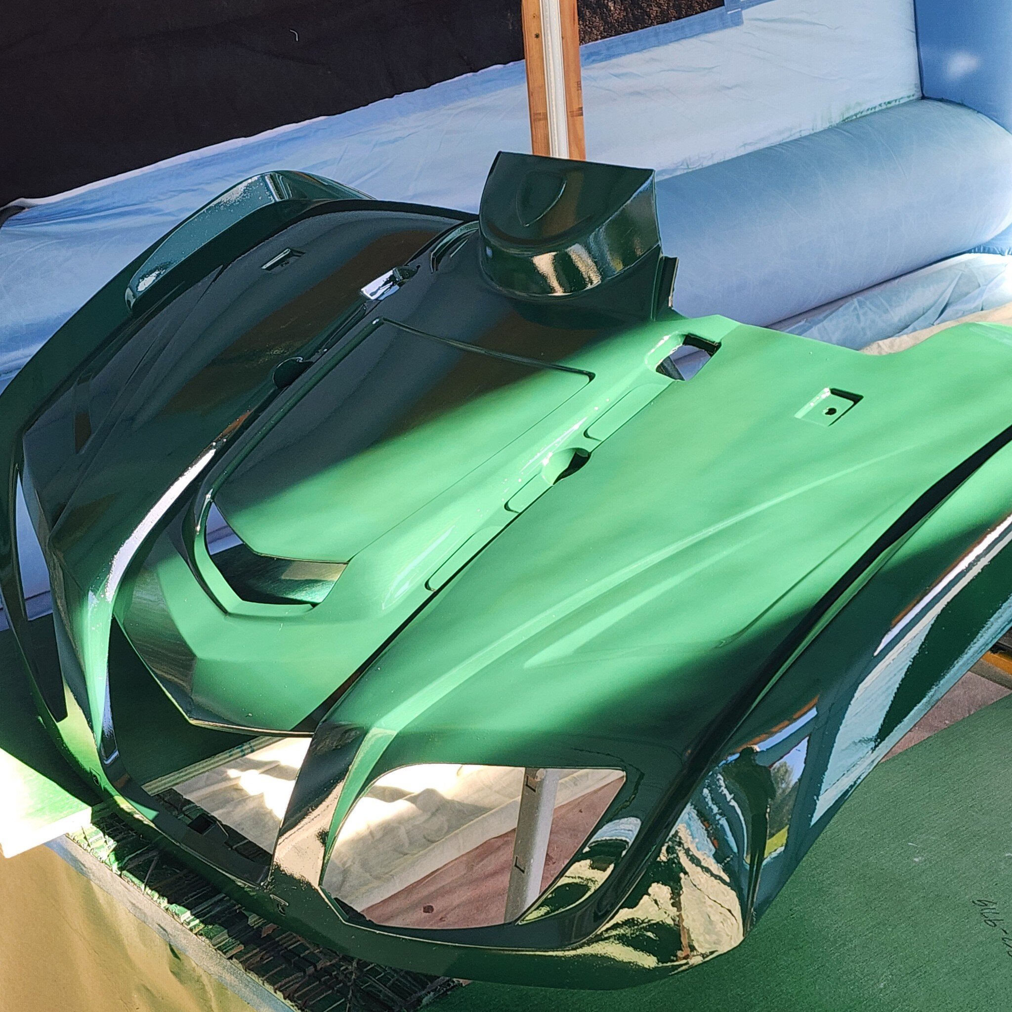

Big day today!

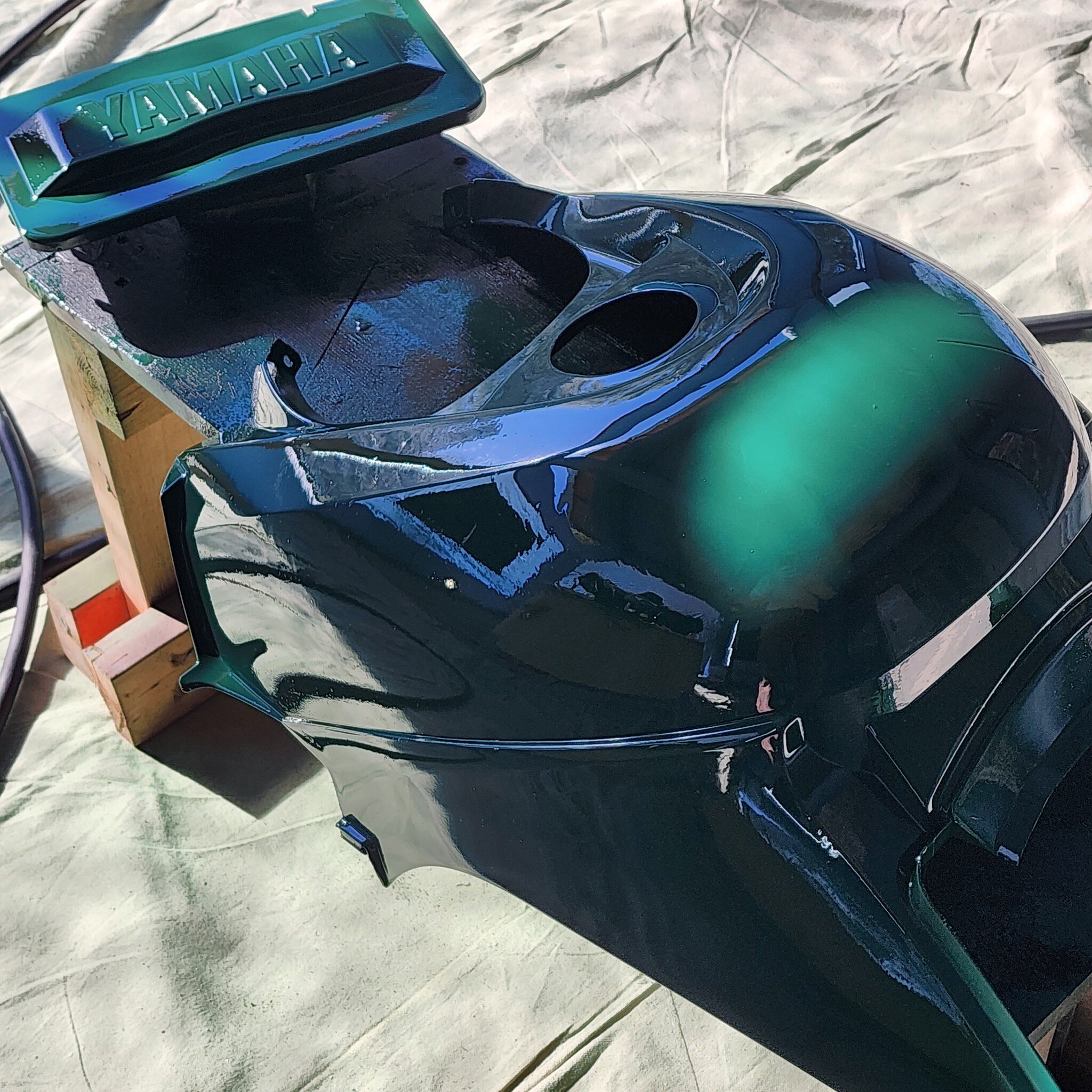

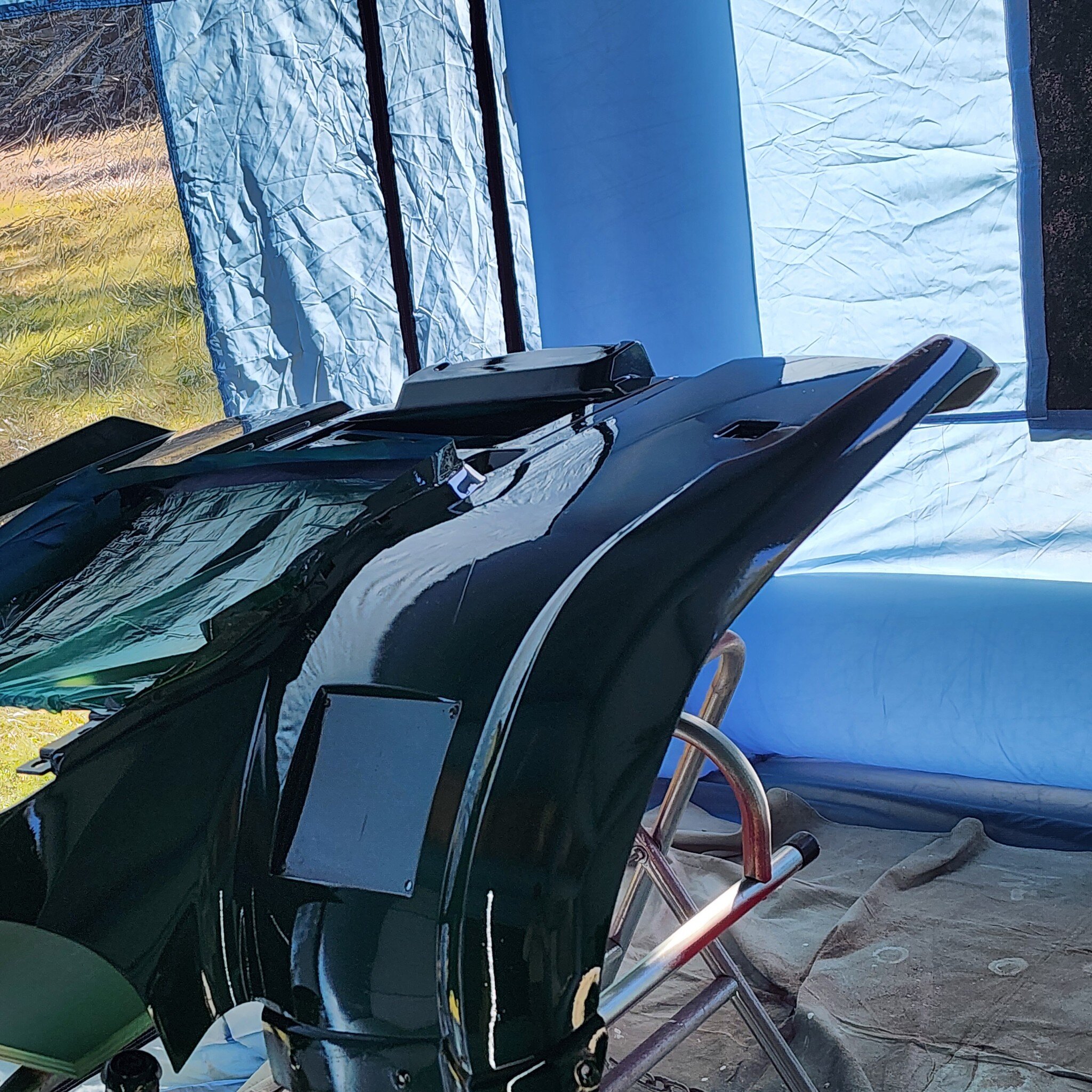

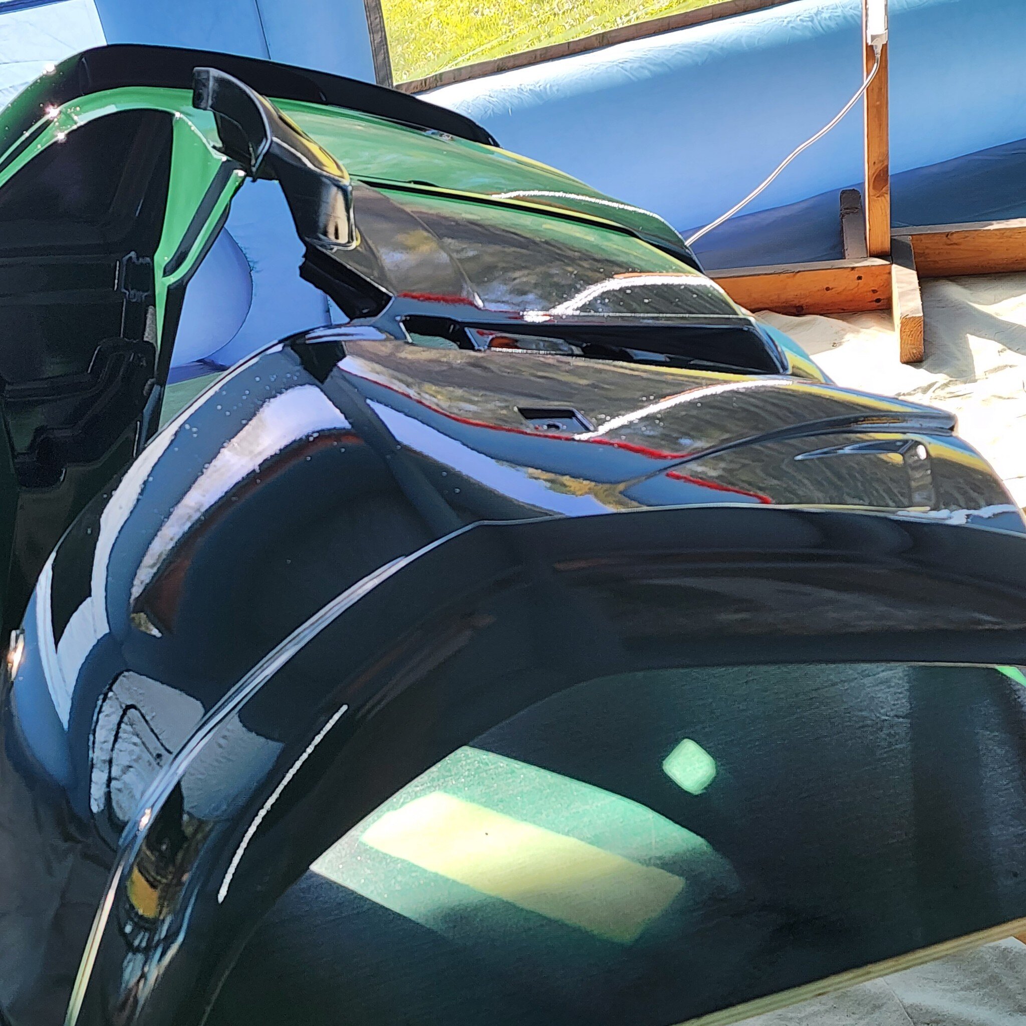

Got the plastics all painted up. I tried to match it up as close as I could. This seems to be correct.....close enough lol I also painted the wheels after I got the new tires put on.
Time to watch paint dry!

You are coming right along how did the painting go tires look good i was looking at those tires but went with the Kenda they had a less aggressive tread which is what i wanted.
Well, we used the wrong type of hardener on the paint, long story short the paint won't ever dry. Gonna have to strip it and go again. Trying to keep costs down so I'm using products I don't normally use and mistakes are being made. Funny thing, now it's costing me more...😂😂 oh well, live and learn.
Tires definitely look good! They are like a maxxis bighorn knock off....time will tell if they hold up and perform well.

The tires look great has the best rating of any on Amazon and also the biggest seller. I got another project im working on i think i will try those.

No worries! Just a lil more work. Most paint today can handle decent flex. However, to be safe I sprayed adhesion promoter to ensure the paint won't flake with the flex. Same as everything with this ATV, I don't mind learning!
I Do like the way the tires look. I picked em up for just under $300 plus $60 to get them put on. I did throw em on to move the ATV around. Lol

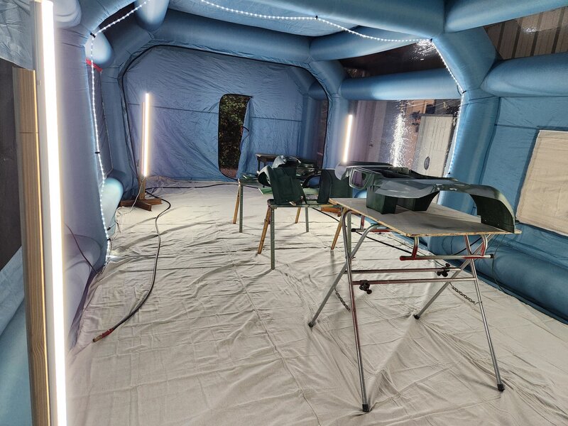

Looks like I'm gonna need a round 3... I can't win with this thing! Got the 1st coat done getting ready to do 2nd, the power company shuts the power off in our area for maintenance! Power was off for 3 hours. 🤦🤦 Now, gotta wet sand and try again.
