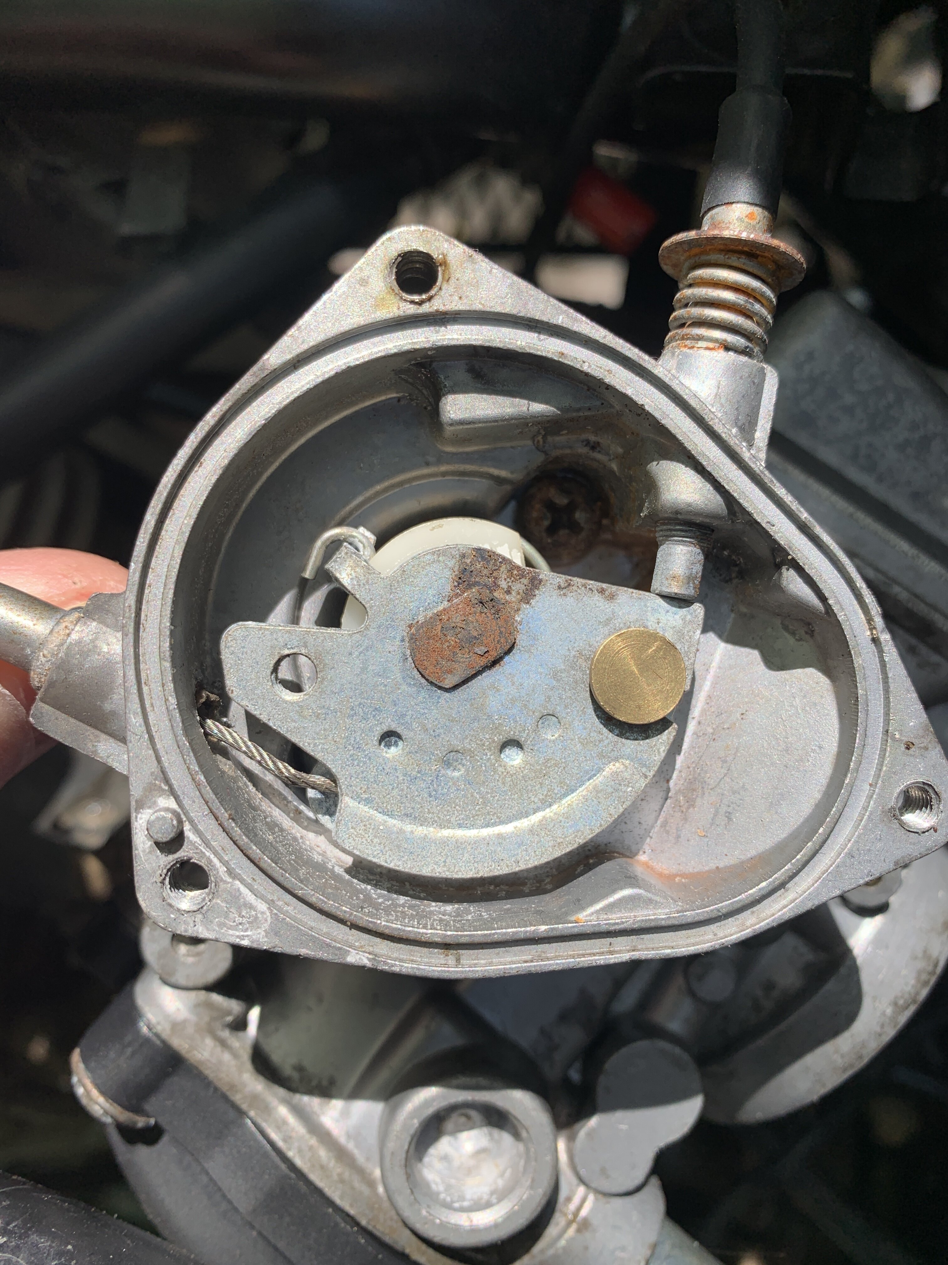

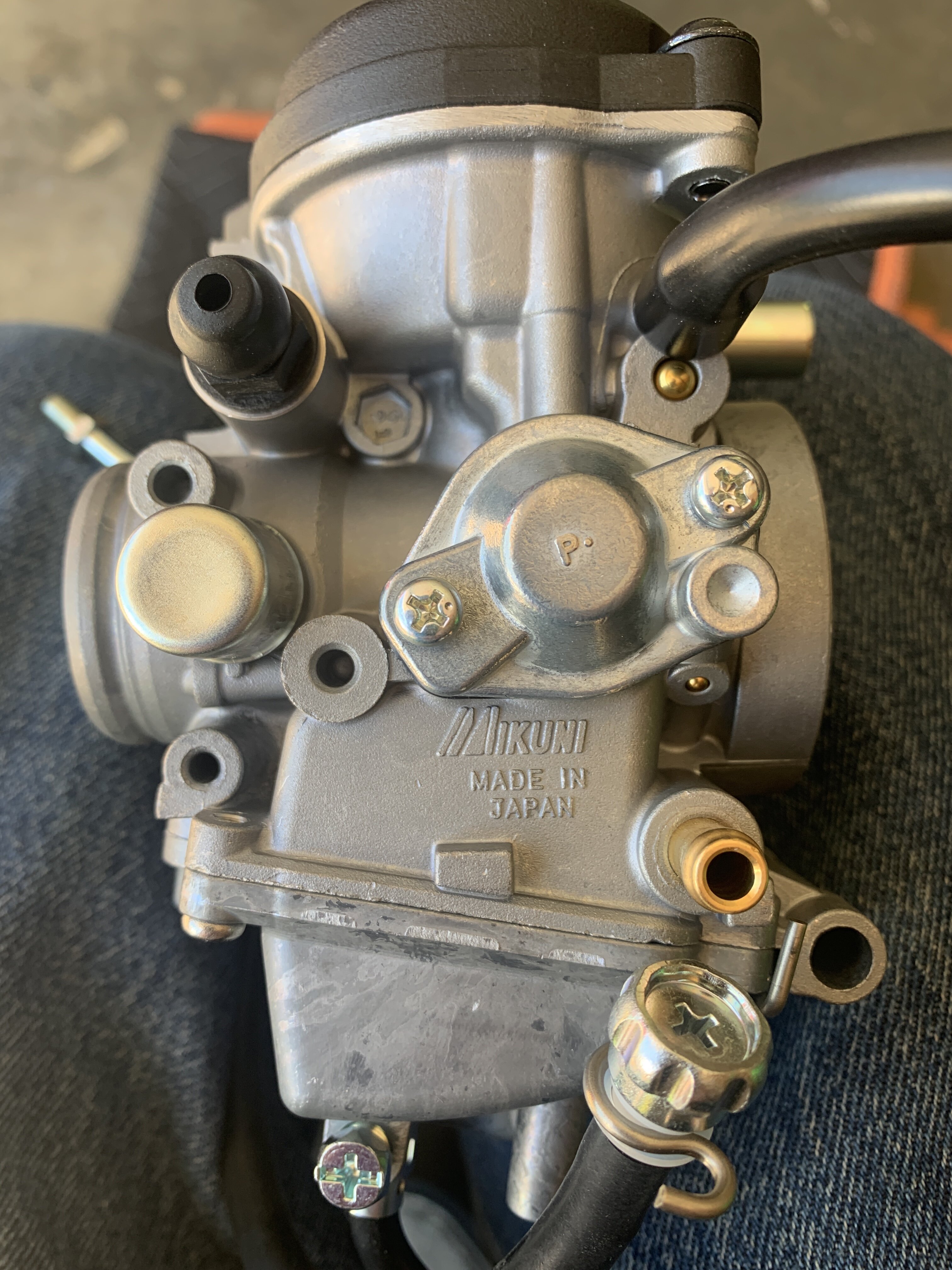

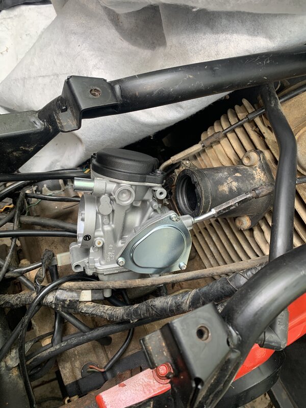

Loosen the clamp on the carb it will come right out of the boot. Take the cover off unhook the throttle cable and unscrew the enricher plunger(choke cable) upper left black plastic piece on 3rd photo. Petcock screws may be rusted or corroded take care not to strip them when taking off.
