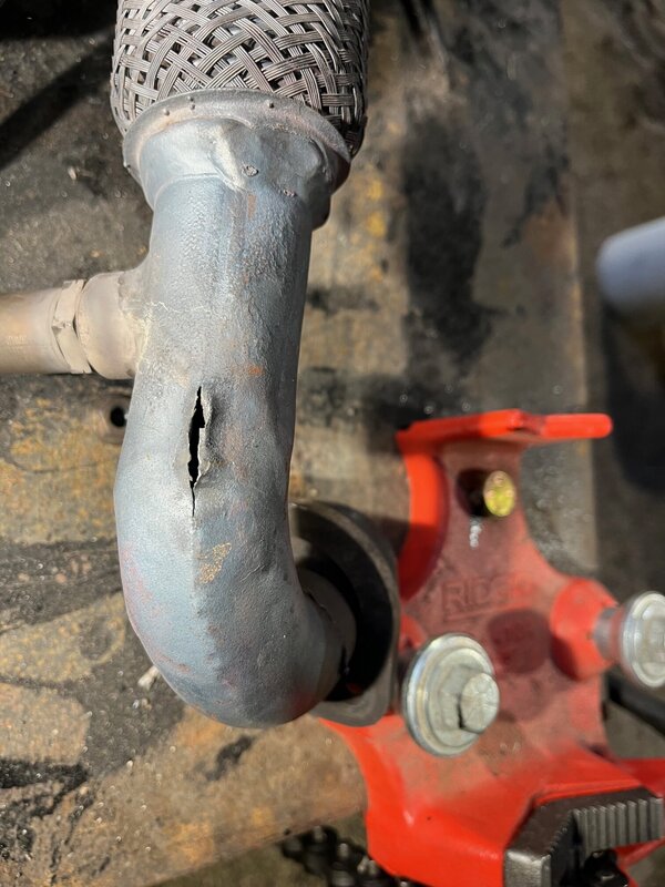

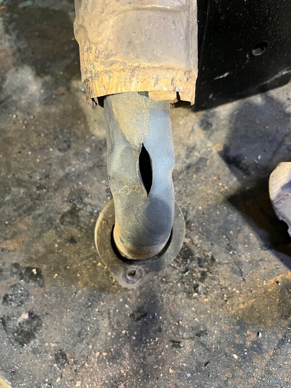

Well finally had sometime to look at this exhaust. When throttled up still very little exhaust coming out the can.. I took the pipes off and zip cut the insulation off and found that both pipes were blown out on the bends. I tried welding the pipes but the are paper thin in that area. I'll bite the bullet and order some. I'll try to post some pics, maybe it will help someone down the road.
That is strange it almost looks like it just blew out, but both the same spot,  and you didnt even put a potato in your pipe. The last photo metal does look thinner than the first  I would have expected better from John Deere. It almost looks like metal fatigue or a production flaw.
Yeah bad design there. That pipe's got a seam along it, both of them do, and it's right around the outside of the bend.  It's well known that exhausts always burn out on the outside of the bends. They should have that seam at the sides, (two piece bend), or on the inside..
That's rather alarming that they would do that.. They would have known better.
