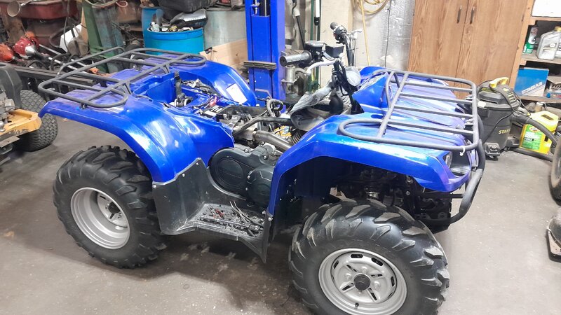

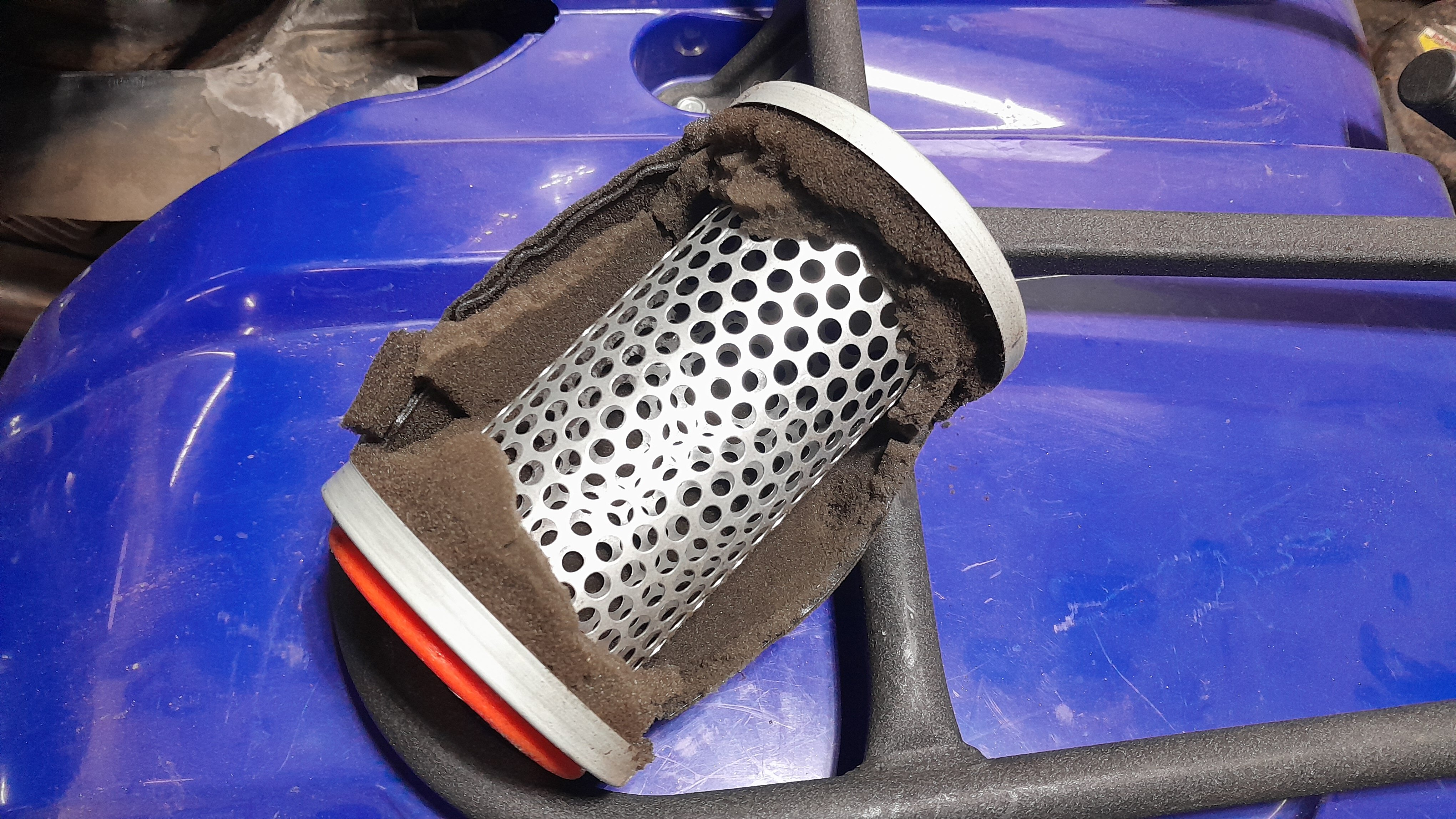

(Question is at the end if you want to skip my blabbering) I got this unbelievably well taken care of Grizzly 350 in for a carb clean, it belongs to an elderly couple that bought it brand new in '07. Apparently whoever has been doing their oil changes for them never checked the air filter..

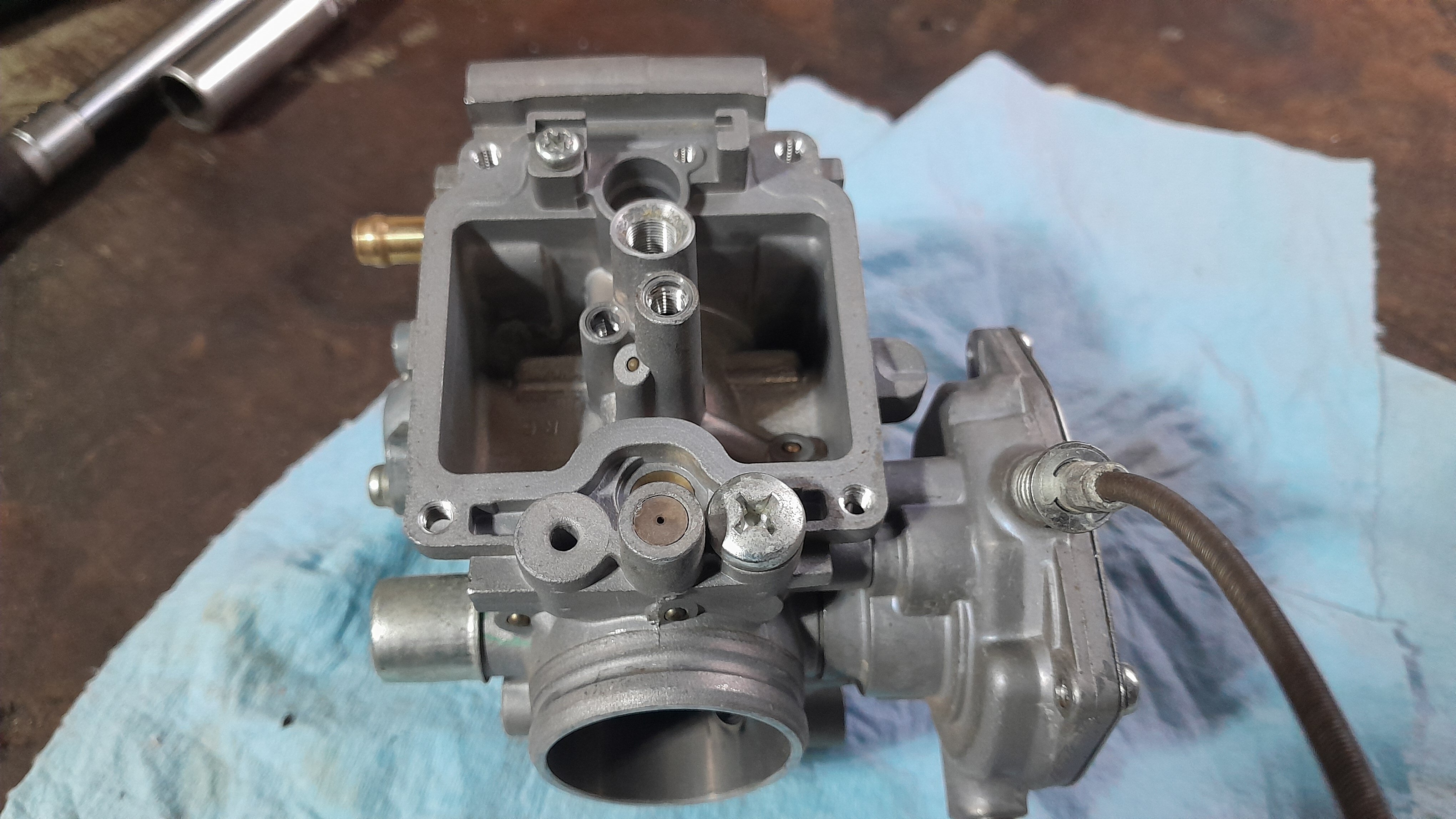

Obviously it got debris in the carb, it would still run but only idle with slight choke. I've taken it apart and cleaned it, have new o rings, gaskets, etc. As far as the mixture screw is concerned, I'm assuming I obviously need to remove the plug. I'm mainly a lawn equipment guy, I've worked on slide carbs in the past but never an unmolested one with the plug still intact. I hate to mess with it as the carb had very little debris but I'm sure the o ring needs to be replaced at minimum. Finally, the question: what's the best way of removing the plug? I DO NOT want to mess up this carb..
  • Solution
Did you ever get an answer to removing the plug on your ATV carburetor?  I think I see a little hole there, just stick a strong pointy thing in and gently pry, it should come out.  Or use a short wood screw, screw it in 1/4" and pull it out.  Or drill a hole near one edge, then use a small screwdriver to pry it out.  Drilling shouldn't damage anything, as when it goes thru the plug you'll feel the drill drop down, so then just stop.  Done Johnson outboard carbs for years this way never a problem.
I did manage to get it out but I appreciate the reply brother. I did end up using a tiny drill bit as you mentioned.  I drilled the tiny hole in the center then stepped up to the next size bit, the second bit actually pulled it out as I was drilling. 👍
