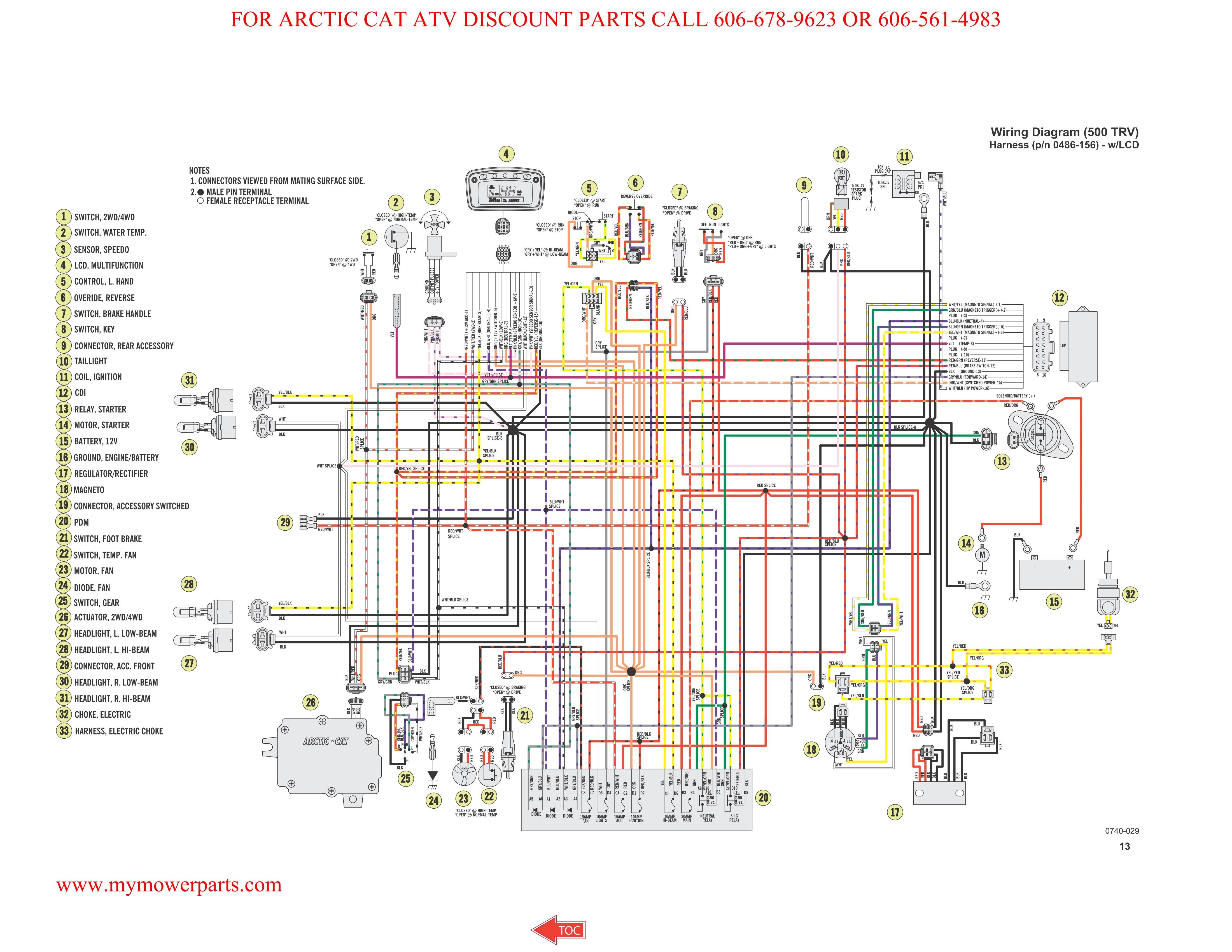

Here is the diagram exported as a JPG. If you look at the orange wire coming off the IGN fuse, it splits off, so if you follow it it connects to the 4WD actuator, Front ACC plug, Neutral relay, foot brake switch, gauge pod, left handlebar controls including a small switch for the hand brake. Your front accessory plus is probably under the pod by the steering, it is a 2 pin connector, commonly used to add grip heaters and winch controls.
I would disconnect all these things, put a new fuse in, start plugging stuff back in and wiggle each. If the fuse blows before this, then it is a harness issue, probably at that splice. (common issue with 200X Cats) If it holds then plugging in one item at a time should find it. (fuse will blow again)
