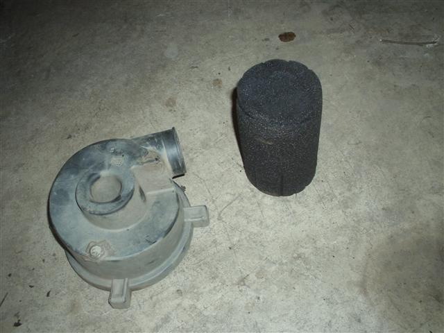

I had water in that box under the seat so I thought I had better look at the filter. By the time I got it back together I was almost in tears, and I used to work on British cars. I tried to remove the lid and it wouldn't come off until I removed the whole air box. To get it back on I had to remove the mounting bolts for that water catch box and separate it from the throttle body. I had to put the factory intake pipe on the air box 1st hoping I had it positioned right and fish it up through there. Basically the whole system is in it's own way. I also had it jacked up with both front wheels removed. Am I missing something here or is there a trick to this? I also wanted to ask if any one knows the HP rating for my machine? Arctic cat seem to think it's a secret
I think yours is basically the same as the 366 model, does the lid to the air filter look like the picture? It is a bit of a pain to change it out. What I do is use a 1/4 inch socket to loosen the clamp from the air filter top to the intake snorkle. Then disconnect it from the air box. Then I pop off the three clamps (of course one is behind the unit which is real fun to get to) Then it should come out without too much trouble. You shouldn't have to disconnect the other side or take the wheel off. I turn the wheels hard left before starting and that helps. You have to work around the air deflection shield but it has enough give to it to allow slipping off the air box top.

That looks pretty close. I could not reach the back clip or the hose clamp holding the snorkel on with out removing it. Just no room to get your hand any where. I was going to take a picture today but forgot.

Manual says rotate locking tabs and remove lid .
