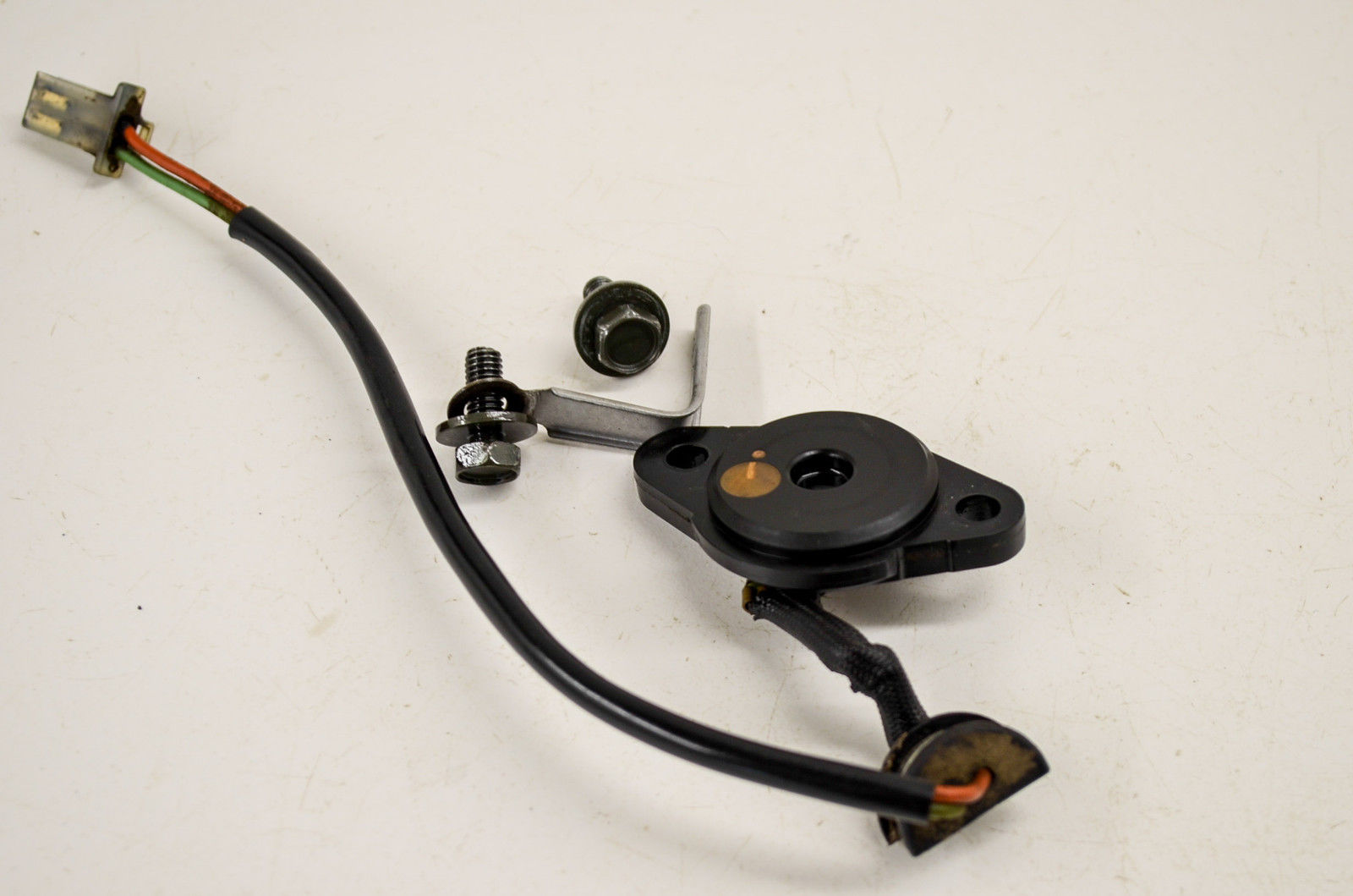

It sounds to  me   like there  is  a  "plunger"   or whatever  activates the  neutral switch   out of adjustment or sticking .  If  you  changed the  switch, my  guess is it  is  out of adjustment. Without seeing the  switch  and its location  I can only  guess on how it works... There  could be  a   little  flat that allows  a  lever/  plunger  to  drop  into  to  close the  contacts  in the  switch  and  it  is  not  lining  up  without   putting  some pressure on the  shift  lever ,  or there  is a  little  bump  (cam)  on the  part  that   activates the  switch and the  switch is not  close enough   for that  cam to   close the  switch.  Switches  can  be made to either  have  a  lever/  plunger   push  to  close ,  or  have  a space  for the  switch's  lever/  plunger  to drop  into  to  close.

Here is what it looks like. It mounts behind the secondary clutch. It's really a pain in the a** to get to, especially now that I have changed the oil and will have to drain it again and pull the primary and secondary clutch off to get to the switch.

In the manual I have I found how to test the neutral switch and the neutral switch relay. I will test and report back the results.
Funny the light came on and stayed on after cleaning the connectors on the switch and the switch relay. Then I rode it a bit and the light wouldn't stay on. I think it may be the plunger that was mentioned before but, I don't want to tear it apart again. I can live with pulling the brake to start it, for now.
2 minutes ago, davefrombc said:
Try  tapping on the neutral switch relay when  it  is  in  neutral  and the light  won't come  on. The problem  could be  in  the relay.
I cleaned the relay it had a bunch of dirt in it and was rusty. I can hear the audible click when I mess with the shifter  and when I hold the brake. Seems to be operating properly. I will try to tap it and see if that makes a difference. Thanks
