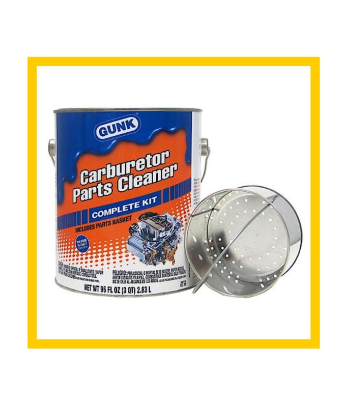

You rebuilt it, ok got ya.  Well is it in decent shape ? Was the bike sitting,  and most importantly when you rebuilt the carb did you inspect the rubber diaphragm for any punctures or damage and is it seated properly ?  There is a tab that aligns the rubber on the carburetor. Also the airways in the carb are super important are they all clear ? It may need a good soaking.  Whenever I have a difficult carb I soak it in a gunk bin that you can buy at any auto parts store. It has a basket in the tank etc take a look I attached a pic. Maybe break it down really good again and soak the heck out of it and blow out all the passages again with a compressor. It’s worth a shot then a new carb $$. And the cleaning solution is reusable for future parts so it’s worth the investment. Also double check that rubber diaphragm and that the parts holding that main needle down in the diaphragm under the spring are in place there should be a washer then a clip that clips onto the main needle and then another washer that the spring sits on top holding the needle down. If this is not correct the needle jumps up allowing fuel to flow into the carburetor unregulated causing a rev up.
