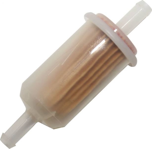

I’m not sure.  What would it look like.  There is a white tube that is connected to a hose going to the carburetor.  Any thoughts other than that.  Also you say I would need to rebuild the carburetor.  What would that install?
A fuel filter goes after the gas tank but before the carburetor to clean the fuel of any debris that might make its way into the carburetor and clog the jets. Here is a generic picture of one. To rebuild a carburetor you have to take it completely apart and clean and soak the parts. You buy a rebuild kit that contains gaskets and parts that usually wear out. If you are not comfortable with rebuilding the carburetor you can buy new ones pretty cheap. Around $50.
