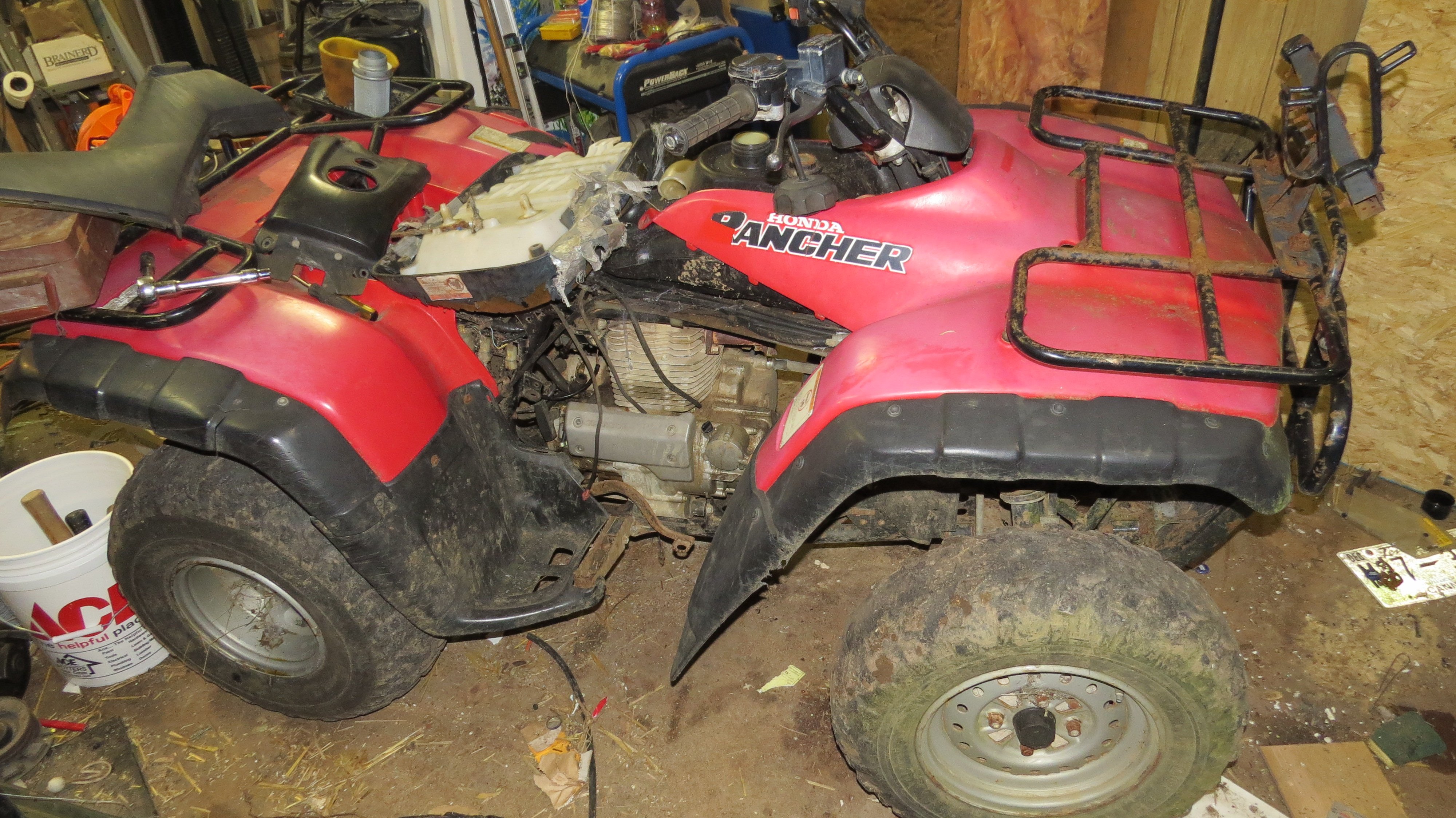

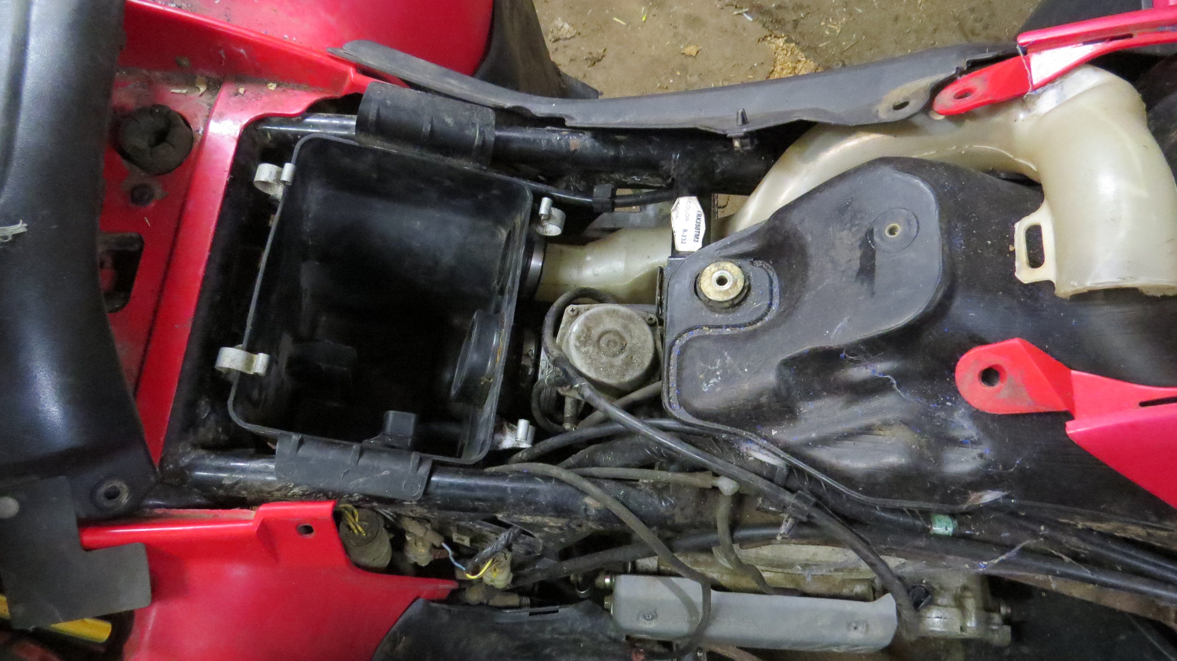

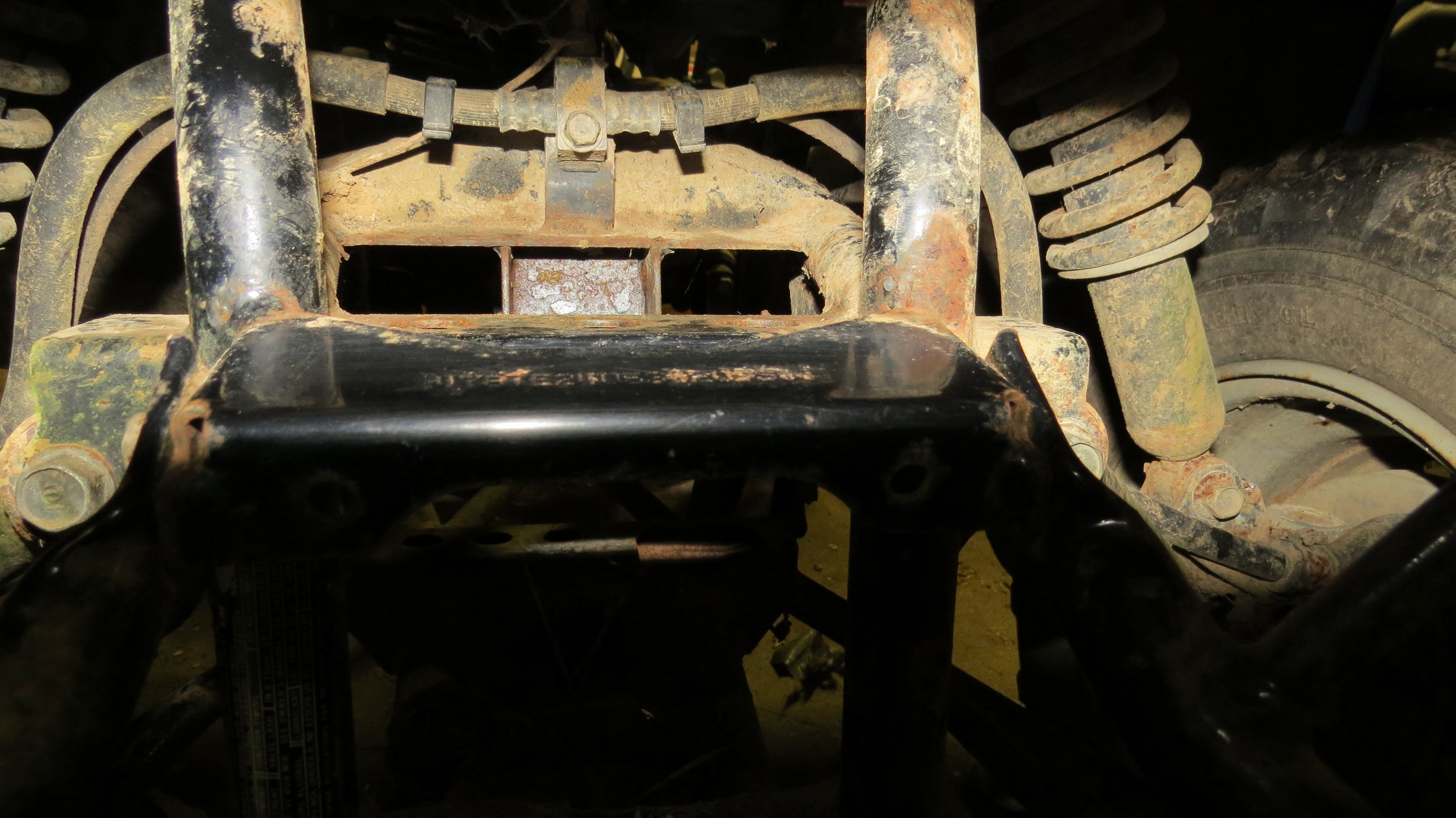

                I bought a roughish Honda rancher TRX350TM3 and I am having trouble locating the vin number - I would like know year and specs as is it rough , it runs but has multiple little issues ( choke cable seems frozen , carb has sticky or ill adjusted float and leaks gas from bottom of carb , shut off valve needs new o-ring to stop leaking , ect)  just age and lack of maintenance issues , but I need to know what it is to get correct specs … I was told there would be a tag on front end of frame but I don't see one . Any help would be greatly appreciated .
  • Ajmboy changed the title to Help Identifying Honda Rancher TRX350TM3

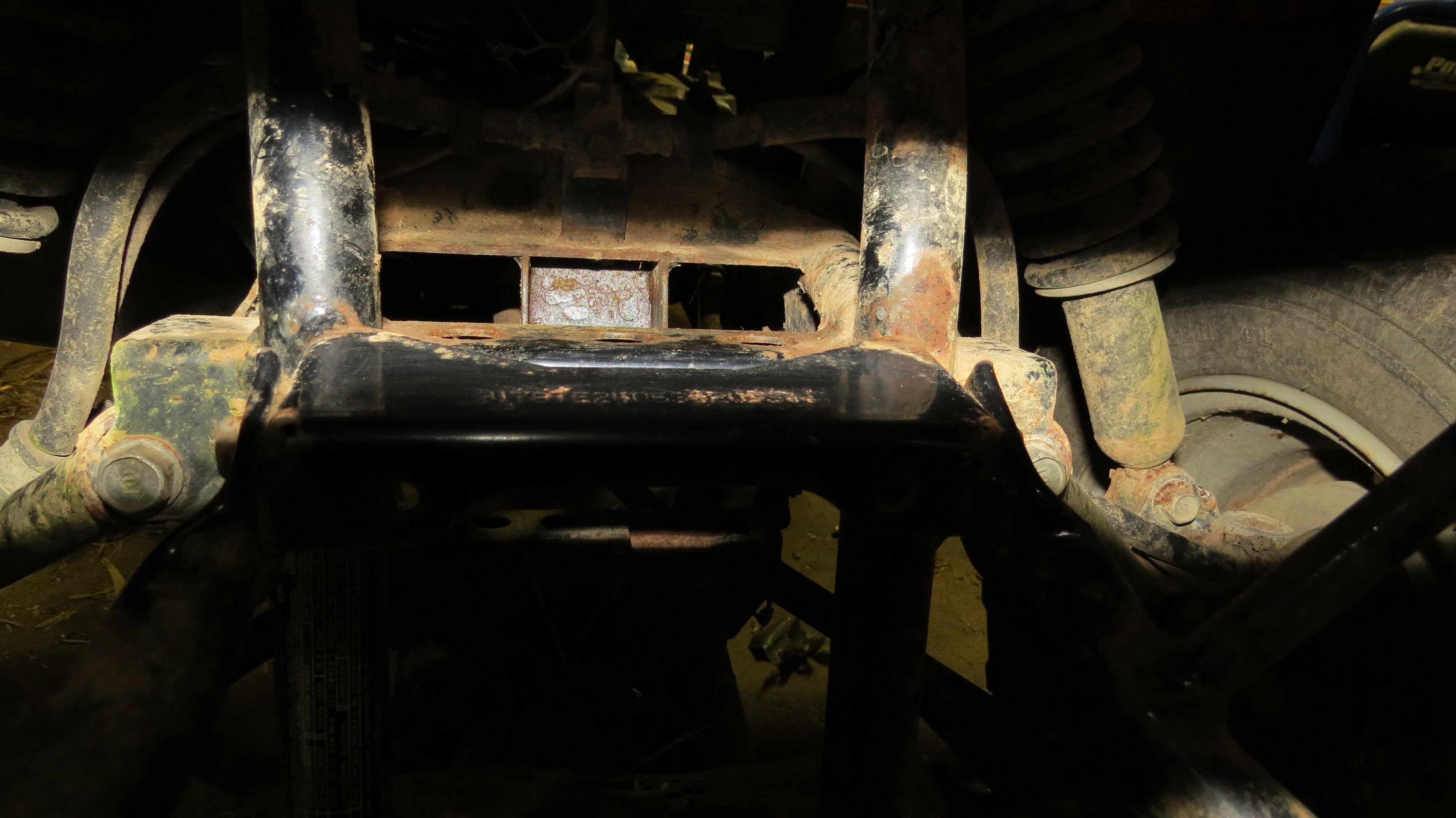

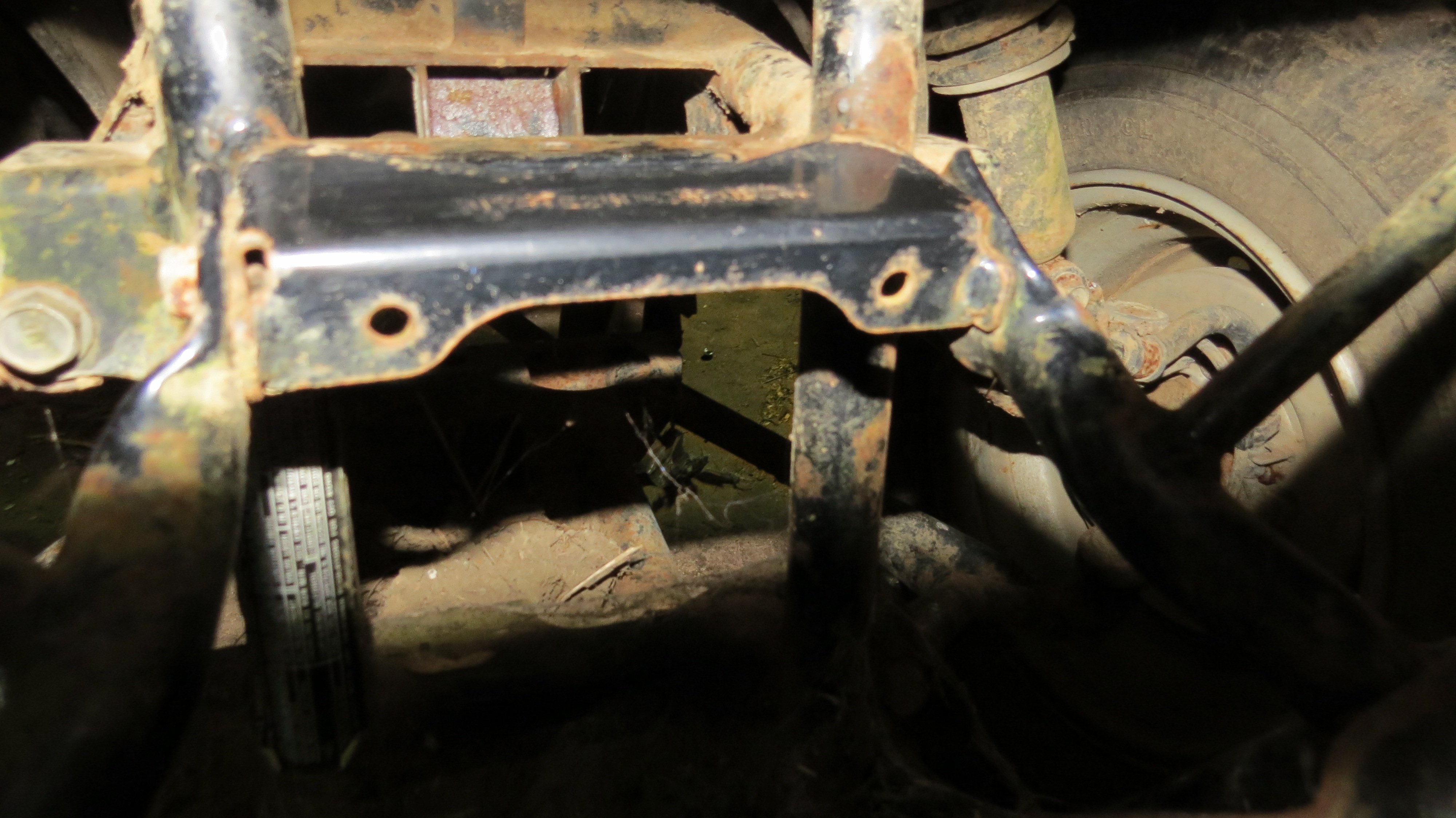

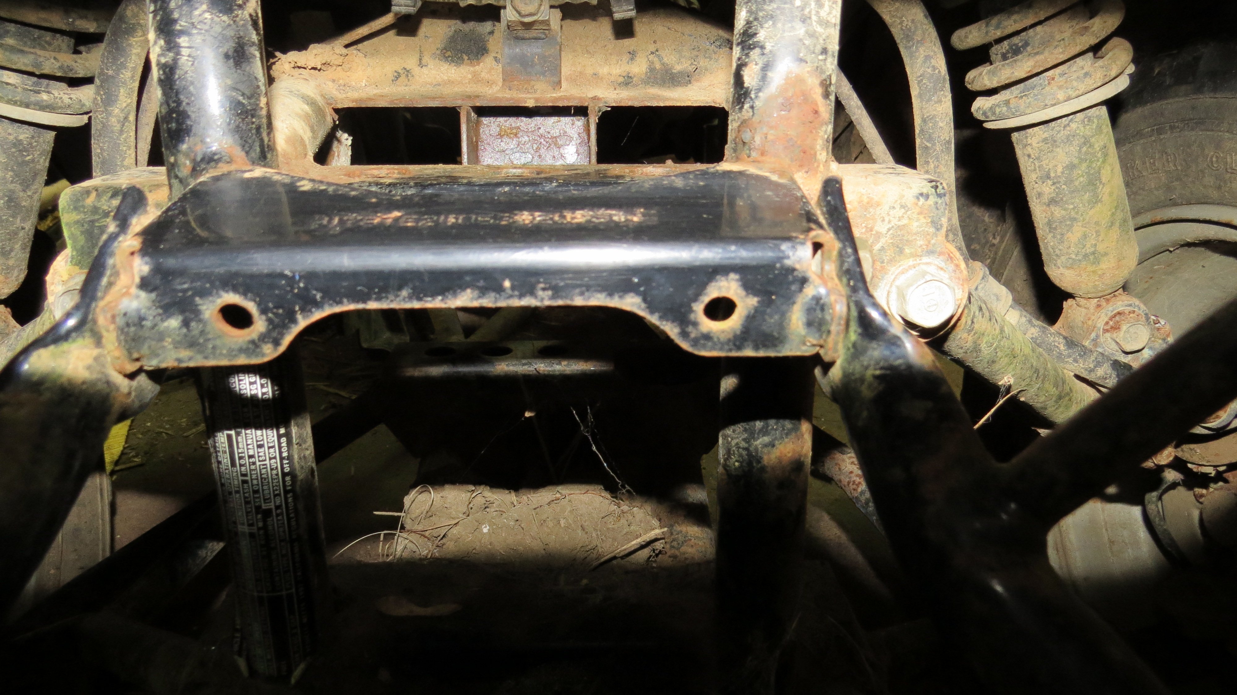

Welcome to Quadcrazy. The vin is stamped on the frame in the front cross bar right behind the main front bumper/steel bar. You will find it there.

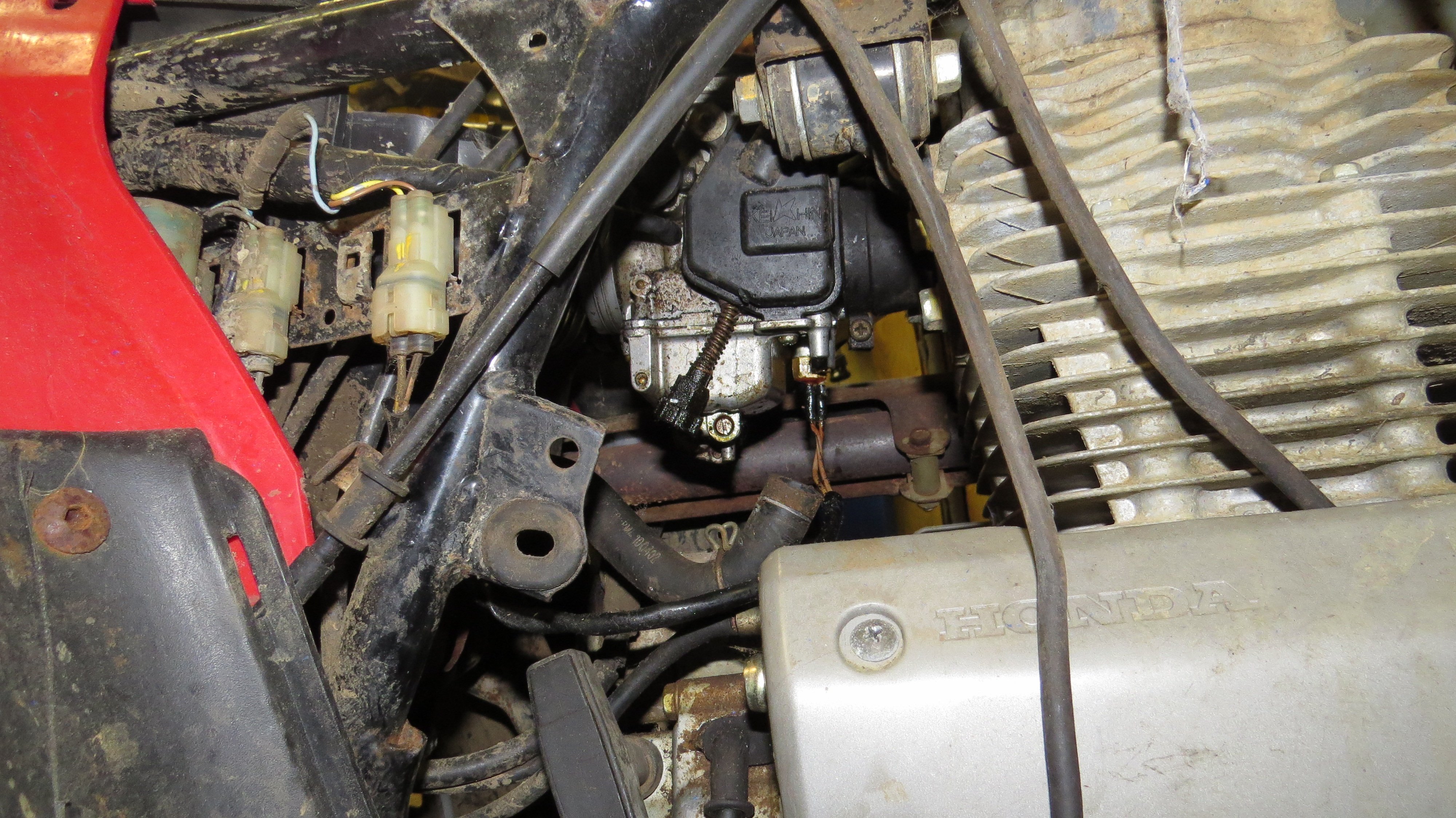

As for the carburetor and choke cable you should be able to take the carb off and clean it good with carb cleaner and some small wires to clean out the jets.  Also a small can of compressed air will help.
The choke cable can be freed up taking the end off the control and holding it up high and spraying wd-40 into it and letting it sit. Or remove it completely and roll it up and soak the entire cable in oil.
The gas fill valve (petcock) I would replace it entirely as its cheap enough. Replacing the seals may not work or only for so long.
Fresh spark plug as well  and clean the gas tank out when the petcock is off  the tank. I like to use a dishwashing soap like dawn and warm water. With the tank off I put soap and water put the cap on and shake it up good and rinse it out. And put the new petcock in.
thanks … great advice …. that's pretty much what I'm in the middle of now ……  this poor carb has sooo much build up - it looks like it's been on the ethanol a long time .  I also checked on the gas valve earlier and yea .. they are so cheap I'm not even going to mess with it . I'll likely just buy the cable if this gives any resistance at all , they are cheaper than I thought they would be also . I will keep the factory one in case … sometimes when I receive those cheap aftermarket Chinese parts I see why they where so cheap , sometimes they seem alright - It's kinda like internet dating - they always look good in the pics . I have already pulled the tank and it looked surprisingly clean inside … gonna give it a good clean out anyway just because I pulled it .
         I'm getting some before pics up here in a few minutes …. didn't think about it earlier so plastics are just sorta propped in place
                                             Thanks again for the good advice : )

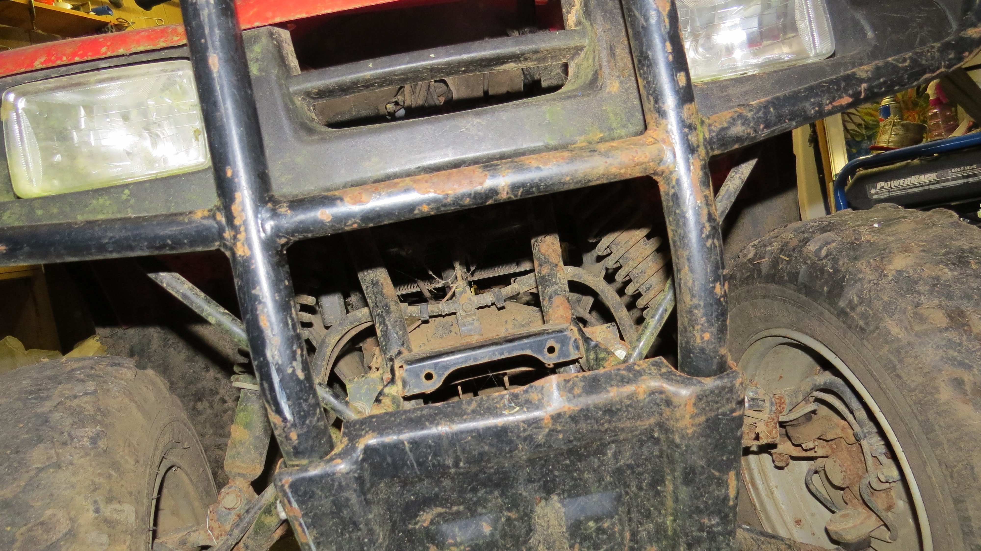

  crud … I forgot to mention I did find the vin where you said , but I'm not sure I can recover it , I took some close ups at dif. angles and may be able to pull it from one . I may try taking a rubbing like people do to grave stones .. who knows   lol
  I can make part of it out after several cleanings but not all … I'm starting to think the year doesn't matter much in this particular series

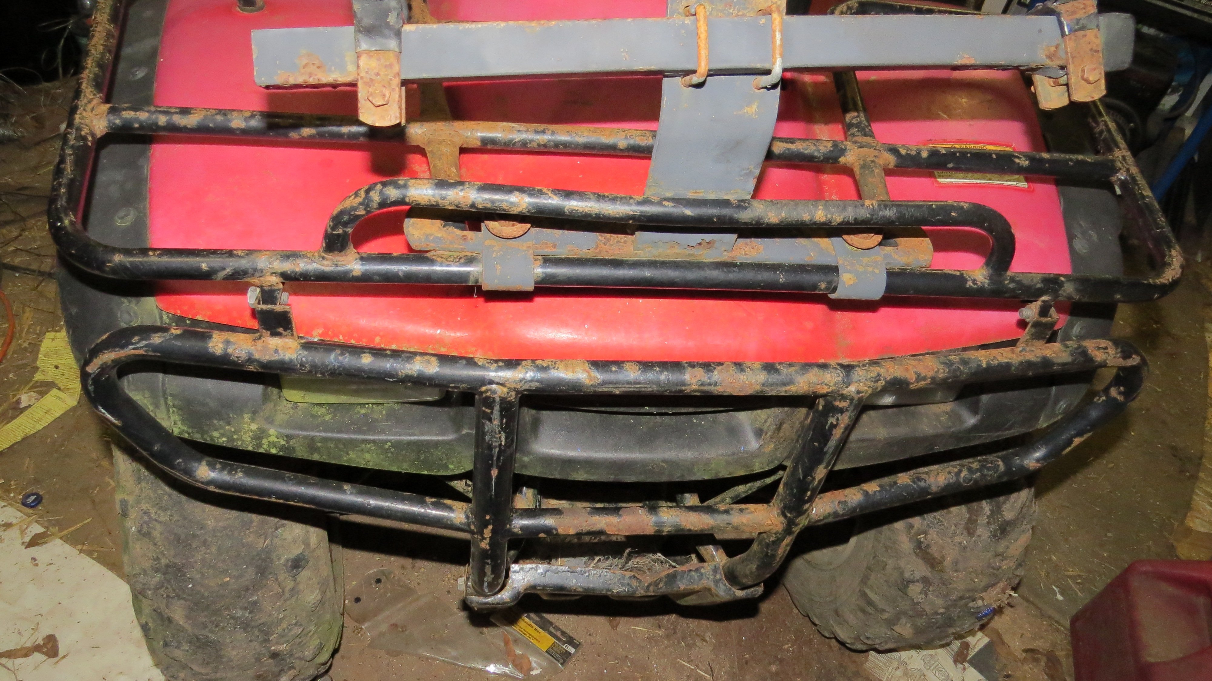

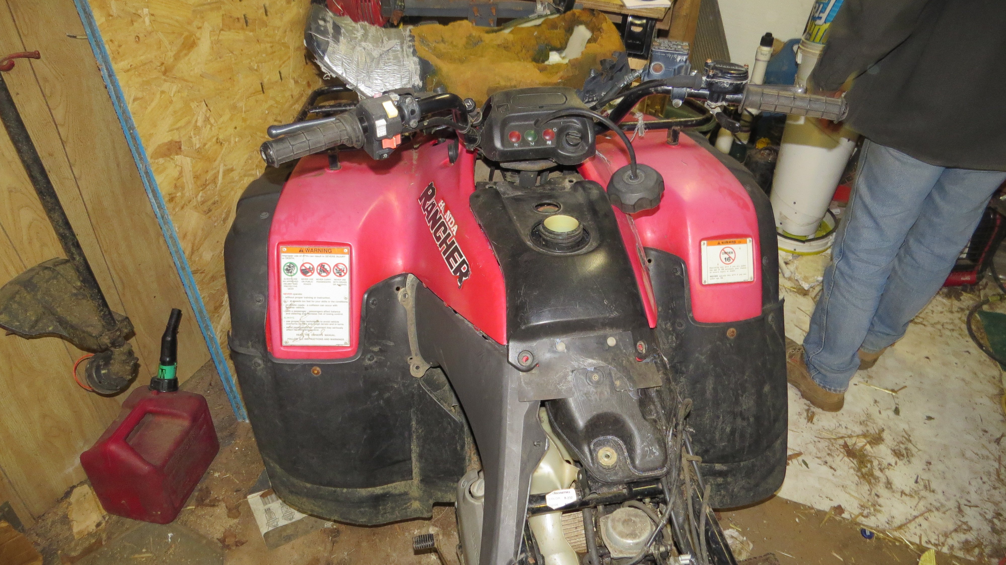

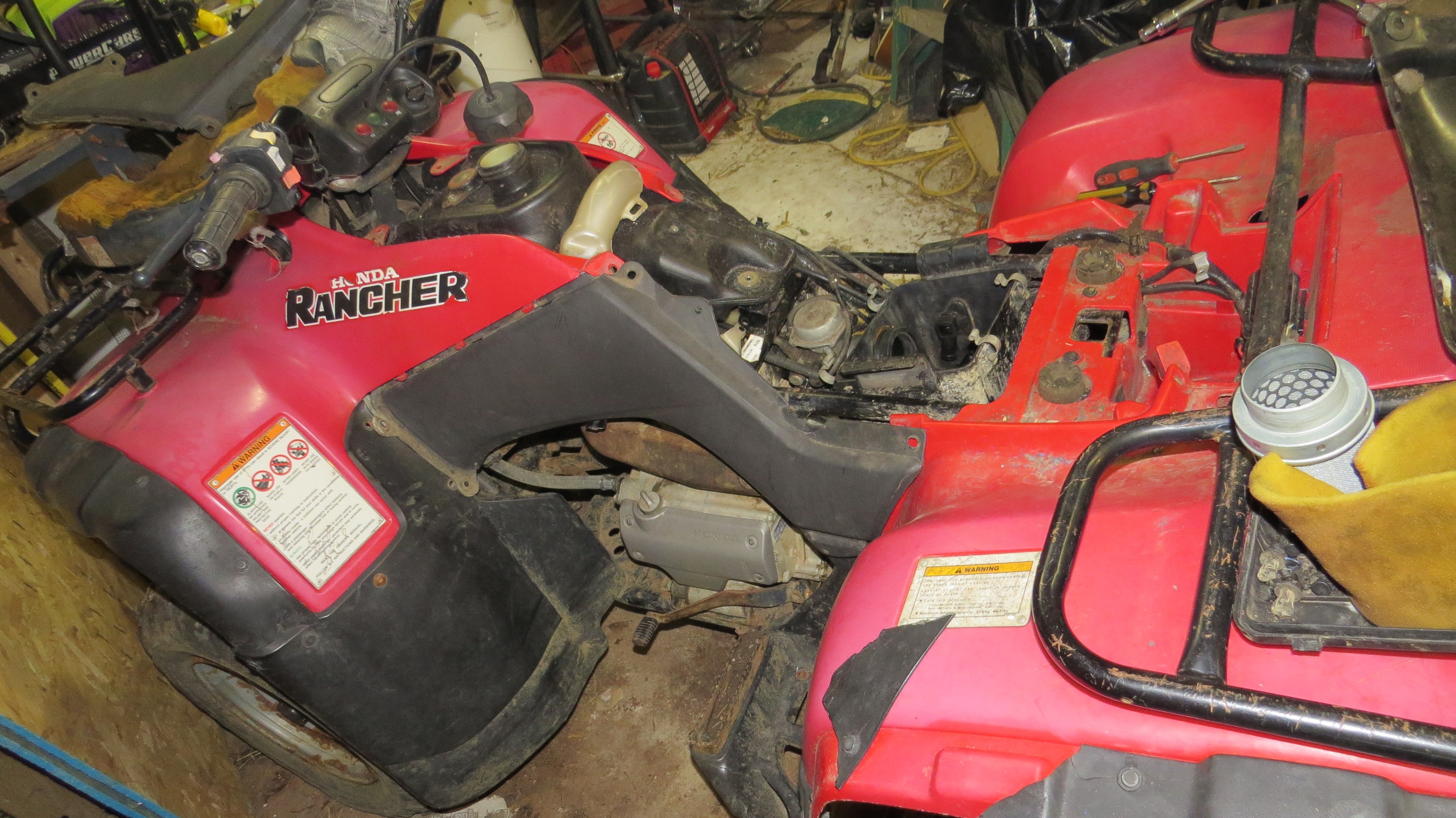

Welcome to QUADCRAZY! I edited your topic title and moved it into the Honda ATV forum. Can you post some pics of your rancher? There should be some numbers on the frame somewhere.
   Thanks for both … the welcome and the proper placement of my post . I got some pics up now … should have thought of before I got it the workshop and started tearing it apart  lol
Just hit it good with a wire wheel and take a pic with the phone. You will be able to make it out.  You can also run a white crayon over the numbers and then lightly use a piece of sandpaper to take off the excess crayon leaving the white in the vin number.  Take a pic of that also. You can really zoom in with the pics.
Speaking of a wire wheel that’s what I use on the metal racks when mine look like that.  I put a course wheel in the drill and go to town on the metal and hit them with some black paint and they come out great.
Post a few pics of the vin we will help you identify.  It looks like a good intact bike.
I  would  use fine sandpaper rather than a wire wheel . .Honda  serial  numbers aren't very  deeply stamped on the older machines and the  metal  of that crossbar  is  quite soft.  A wire wheel  might  "smudge"  the  numbers. I learned that the  hard way when I did  mine .

Definitely good advice.  I’ve been lucky tg and not had a lot of rust on my vin#s. I always use a very soft grade brass wire wheel. It helps clean the number grooves out for the crayon purposes. But I agree with @davefrombc he knows a ton and don’t want to make things worse.

ones a little blurry … I can get some of it …. I'm going to try the white crayon thing … that sounds like it might work .

vin recovered …. 2003 .   thanks for help the guys . I went through the carb and cleaned the plug and it runs and idles smooth now . I do need to find a rim and better tires . The front left rim rusted out … I sanded and JB welded it … but every fix just finds the next weakest spot ….
