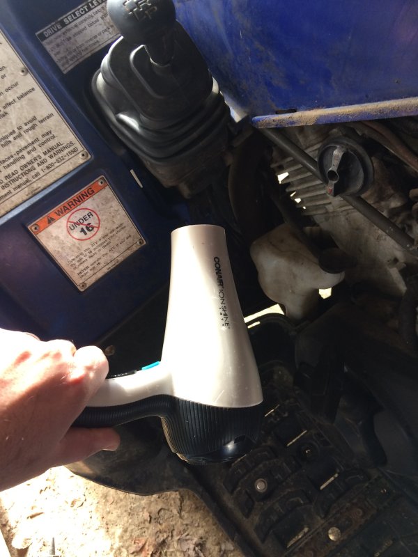

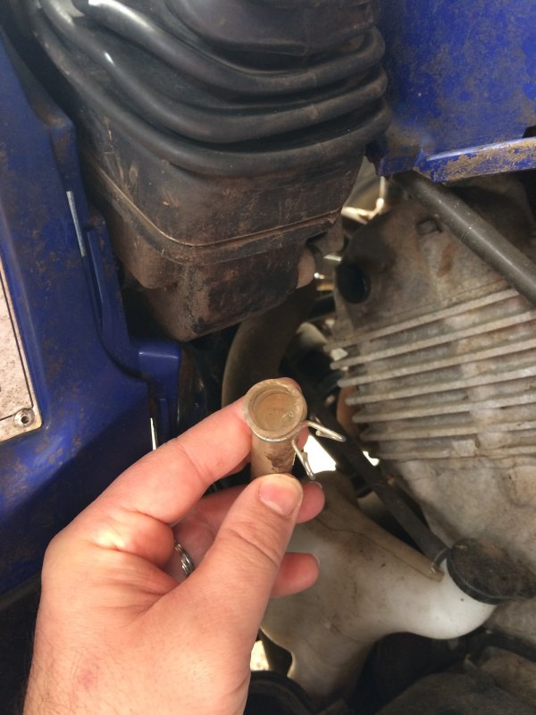

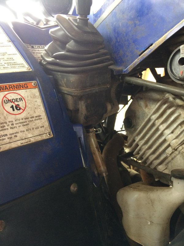

My Grizzly has been getting harder and harder to shift this winter and today was completely stuck and I needed to plow the few inches that came down this morning. First thought...oh no, tranny...but it’s winter and maybe it’s iced up. I pulled off the plastic to see what was going on and indeed I did find the drain tube iced up.
I took the blow dryer out and de-iced it. Quick fix, I never really thought about the shifter drain tube icing up before, shifts like new!

That’s a great find and fix. Thank goodness not a tranny! What’s the moisture from, condensation? And where does that line go to ?
You know I'm not sure really, I'm assuming snow got in there and I left it out in the rain a few times before the winter. That line is just a drain and has a plug at the end of it. I think its just there to hold any water/condensation or if you submerge it to drain the shifter box I guess. But that tube had ice in it because the quad sits in my garage outside with no heat. Yeah I'm glad it wasn't a major issue, I need this thing to keep going until I can get a new quad down the road. 💵
