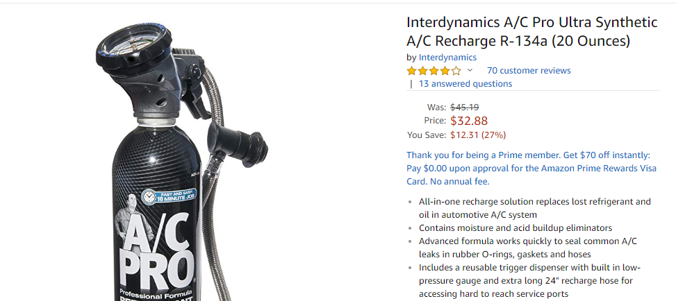

Assuming that's R134 which it should be, you can use one of those quick blast R134 cans with an indicator gauge and just top it off. However, are you show your climate controls are working correctly, blend door, etc.? This is from Amazon, but you can find it at the auto parts stores, walmart, etc. Has sealer and oil  in it also.
R134 AC recharge
