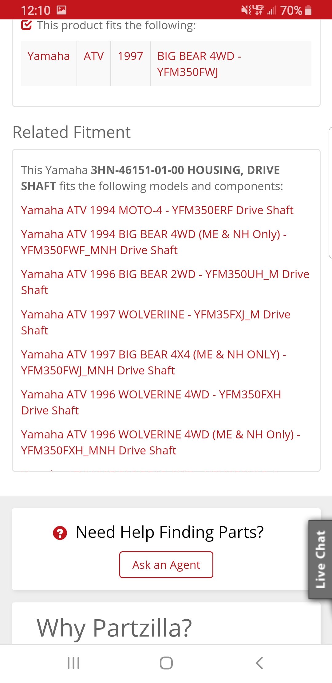

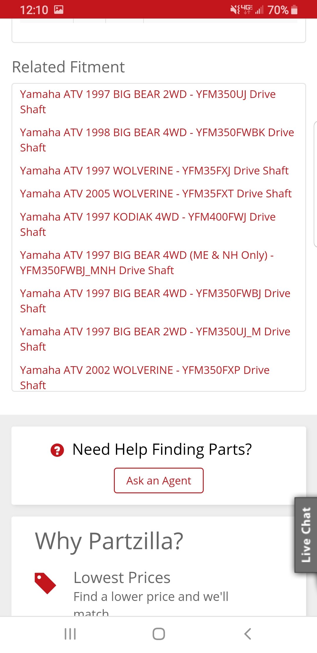

Any good way you know of doing that? A specific website that could tell me or how do I go about googling it? I found a 99 350 diff for just under 200, it looks the same anyway. I know anything under 96 or 95 wont work because the shaft coming from the diff to the driveshaft is different. Dont know about 2000 but 99 looks the same from what I can tell
I use Partzilla.com  Find the part you're looking for.  Click on the part number and the page for that part will have all the different models that used that part.  There were several big bears, wolverines & kodiaks that used that particular rear diff.  Not so many on the axle.
Buying a used diff. & axle is going to be your cheapest route.  Trying to rebuild it will cost you 2-3 times more.
