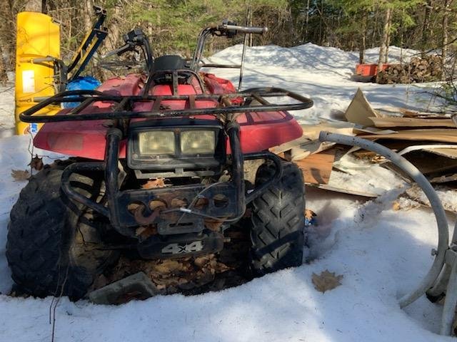

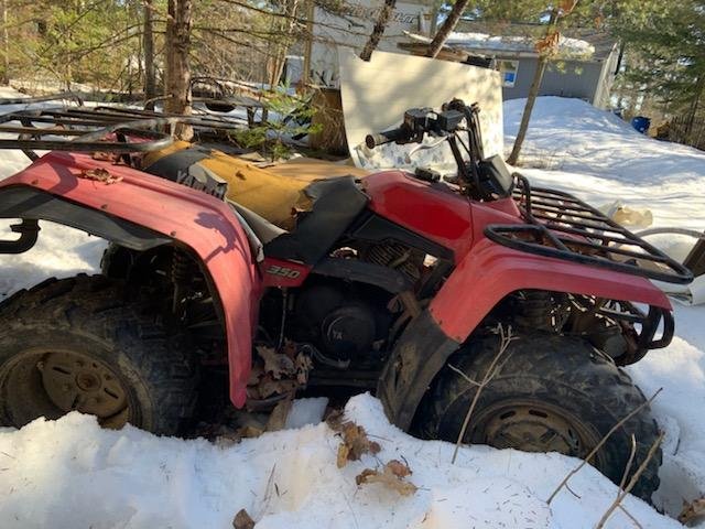

I've got the opportunity to buy a running big bear for $130 from a guy I work with, has a winch, electric start, lights work, but the axles are screwed I guess, he says the rear is stripped on the inside (whatever that means) and I guess the front pretty much (or did) snap in half. My question is before I even go and take a look at it, is it worth it? And how difficult/expensive is the fix? Dont have any experience with driveshaft driven wheelers.
$130 bucks is worth it.  As long as it’s running, the engine parts alone could be worth double that.  And if the plastics are in good shape then that’s worth another $150 for both front and back even if there faded.  And if the metal racks are not too banged up they are worth money also. Easy $60 bucks a rack. So you would get your money back.
Now having said that, if your looking for a project then you can go to eBay and find some used axels for a fair price and play around with it as a project but your probably going to spend about $250 on parts and some time. As far as experience goes well that’s another story.  If your mechanically inclined and have some knowledge about cars and things of that nature then you will be good. The seat is an easy fix and cosmetics are as well.   Try and get the price down more. It’s basically a dead bike as it is. Offer him $75 bucks. He will come back at $100.
I guess it's worth $100 IF you've heard it run and it sounds ok.  If it doesn't run, tell him you'll give him scrap price ($25) and get it out of his way.  That way if it turns out to be a total mess, you can get your money out of it.
From what you said, it'll need at least a rear diff. ($200), rear axle ($100), front axles ($50 each), maybe a front diff. ($200).  Those a used prices.
From the picture, it looks like it needs tie rods.  Then you've got the unknown....brakes, transmission, clutch, etc.
It could be a money pit.  Then again, it could be worth sinking $500-1000 in.  One thing it has going for it, it's a Yamaha 350.  Those engines are like the Energizer bunny.

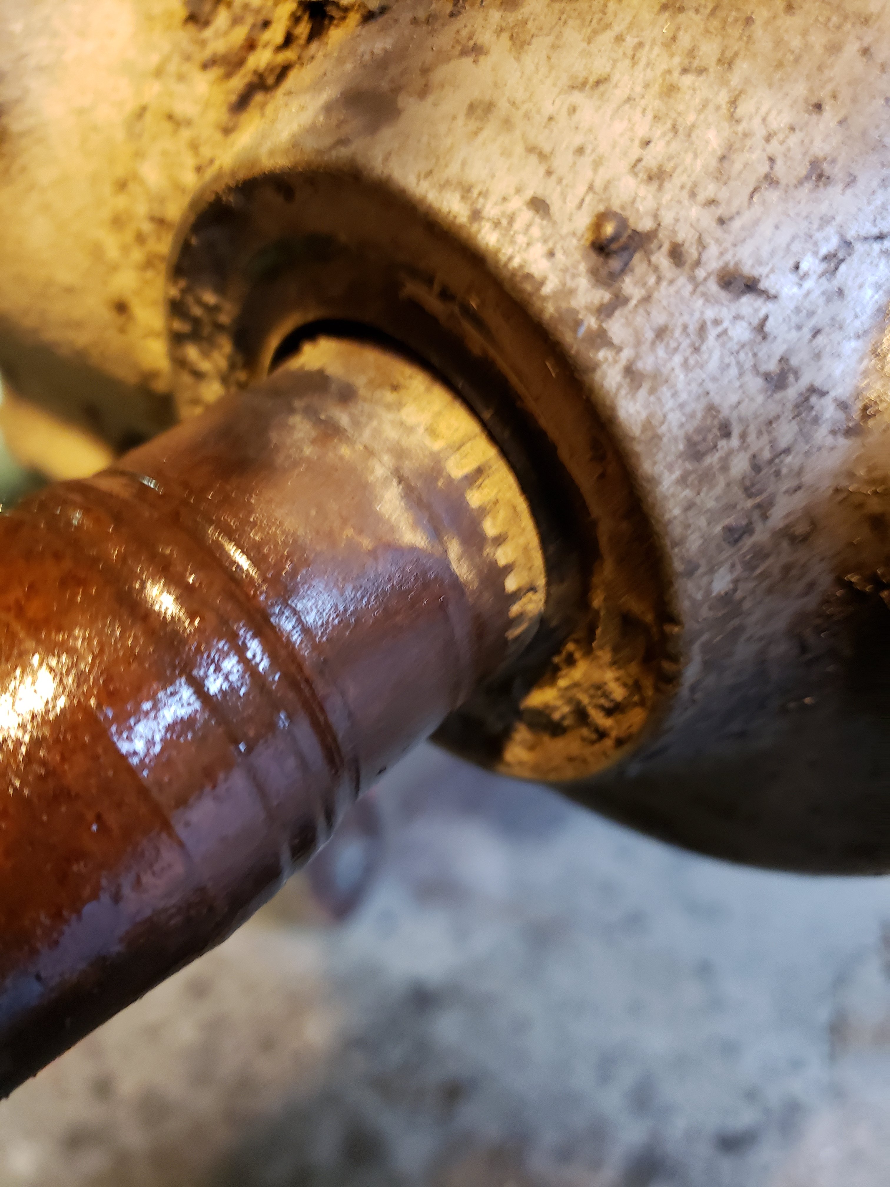

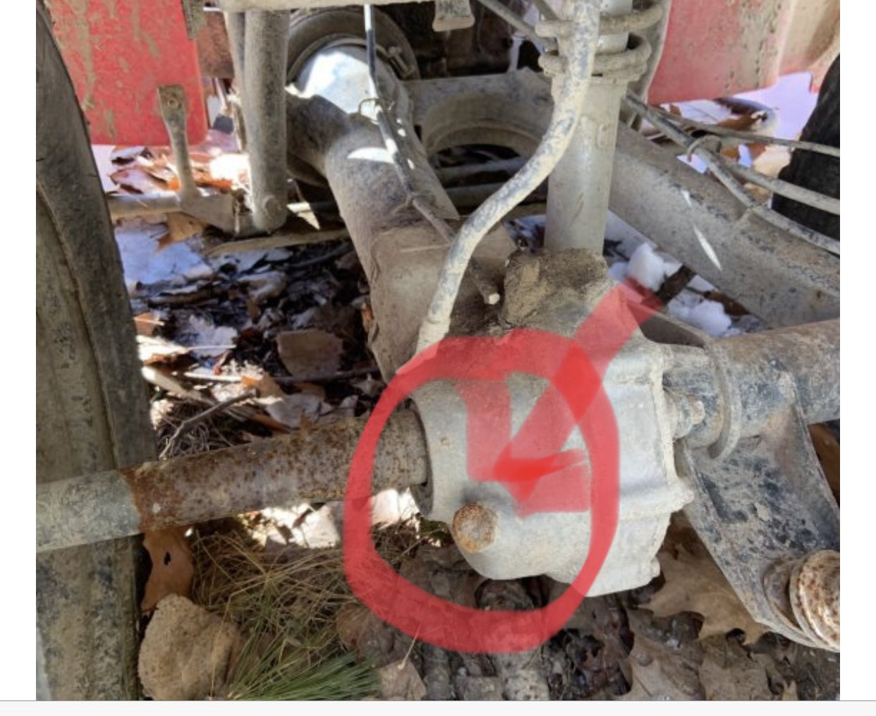

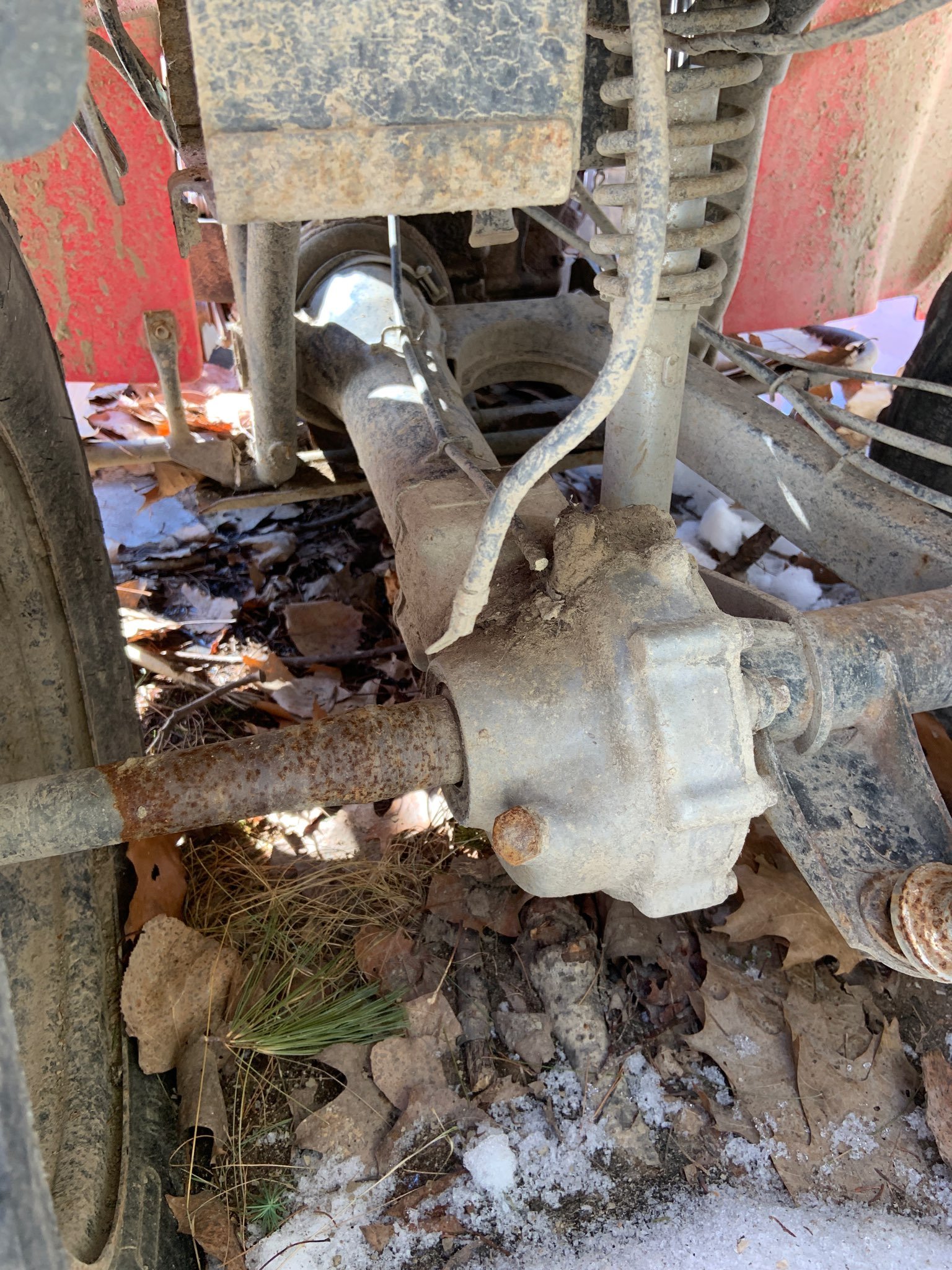

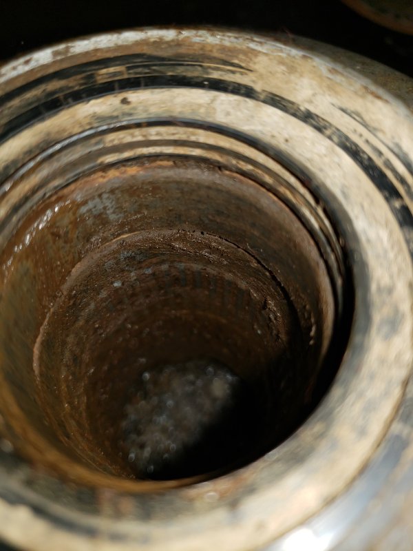

Okay so on the exposed axle side in the rear I can grab ahold of the tire and lift it up and down and watch the shaft move up and down where it connects to the rear diff, the diff is filled to the brim with oil and water I assume. Anyone tell me what this means so I can look up replacement parts?

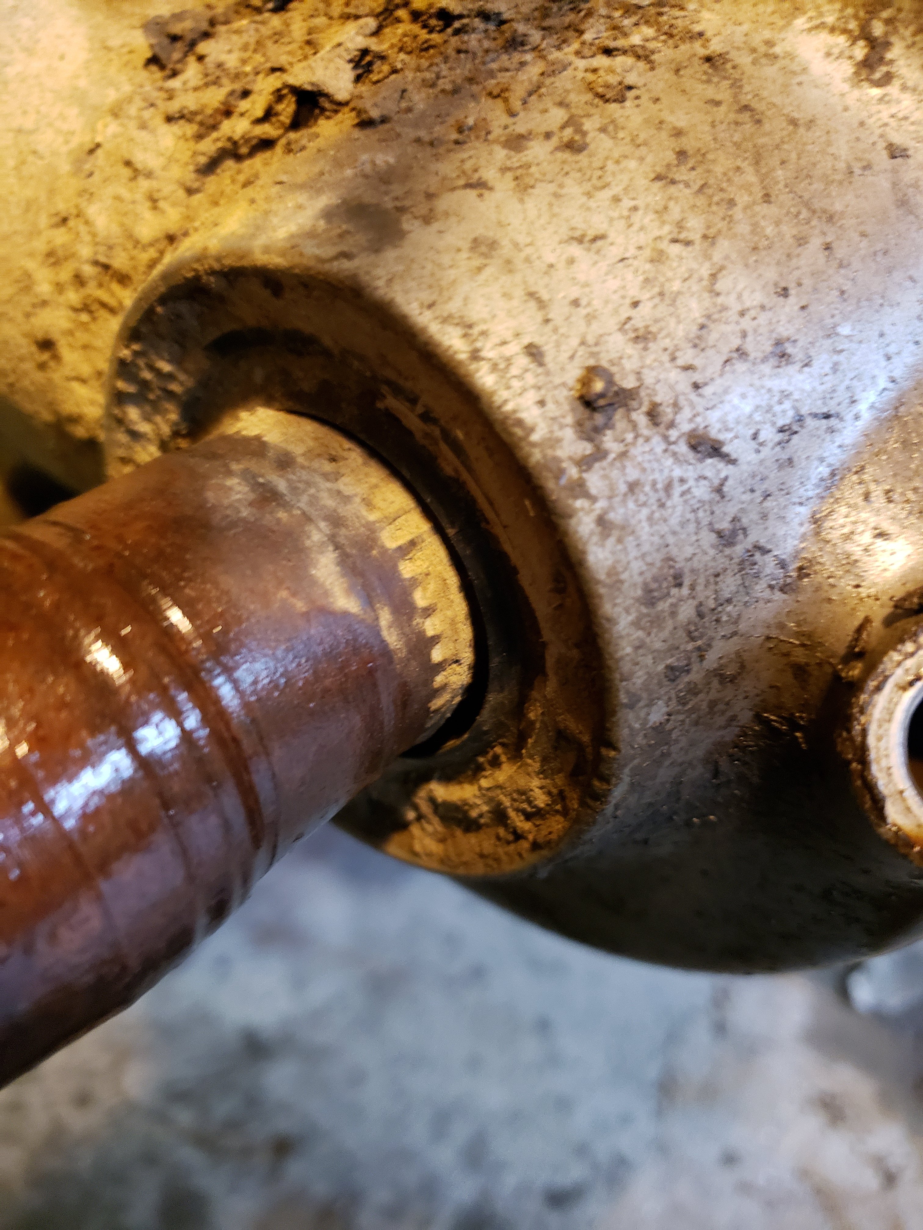

Sucks the video wont play, it shows the movement well, these are the best I could get, it's got almost a 1/4in gap between the axle and the diff. Definitely seems to have water in the diff, dont know if that helps.
Yep that’s a bearing seal and bearing.  Going to need to swap it out and might as well do both sides. Or see if you can find a rear diff if it’s shot on eBay.   I believe  that is one continuous axle and that bearing assembly for both sides would be about $50 bucks.   Have you found anting else ? Anything chewed up like gears or the yolk ? Is everything spinning for the most part ?
I'm thinking the bearing went and it screwed the splines on the axle, but I can't drain the rear diff fluid the allen plug is stripping on me, the yoke and the rear drive shaft seem fine I believe it's the axle not connecting with the diff
