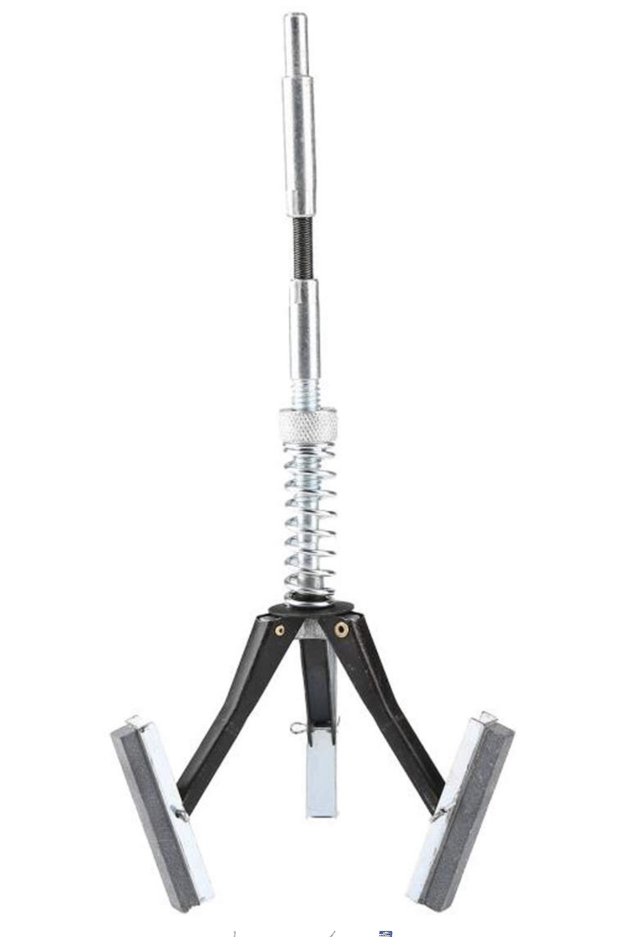

I have a Yamaha warrior 350 and it has a brand new head and piston set. The piston has some scoring on the sides so I bought a new piston kit and it should be here tomorrow. The bottom of the cylinder head still has the cross haching on it but the mod and top don't and still looks good. Do I have to rehone it or no? No would be a great answer LOL.. need help. Also if I do is there another way to rehone it without a honing tool.. don't have one..
