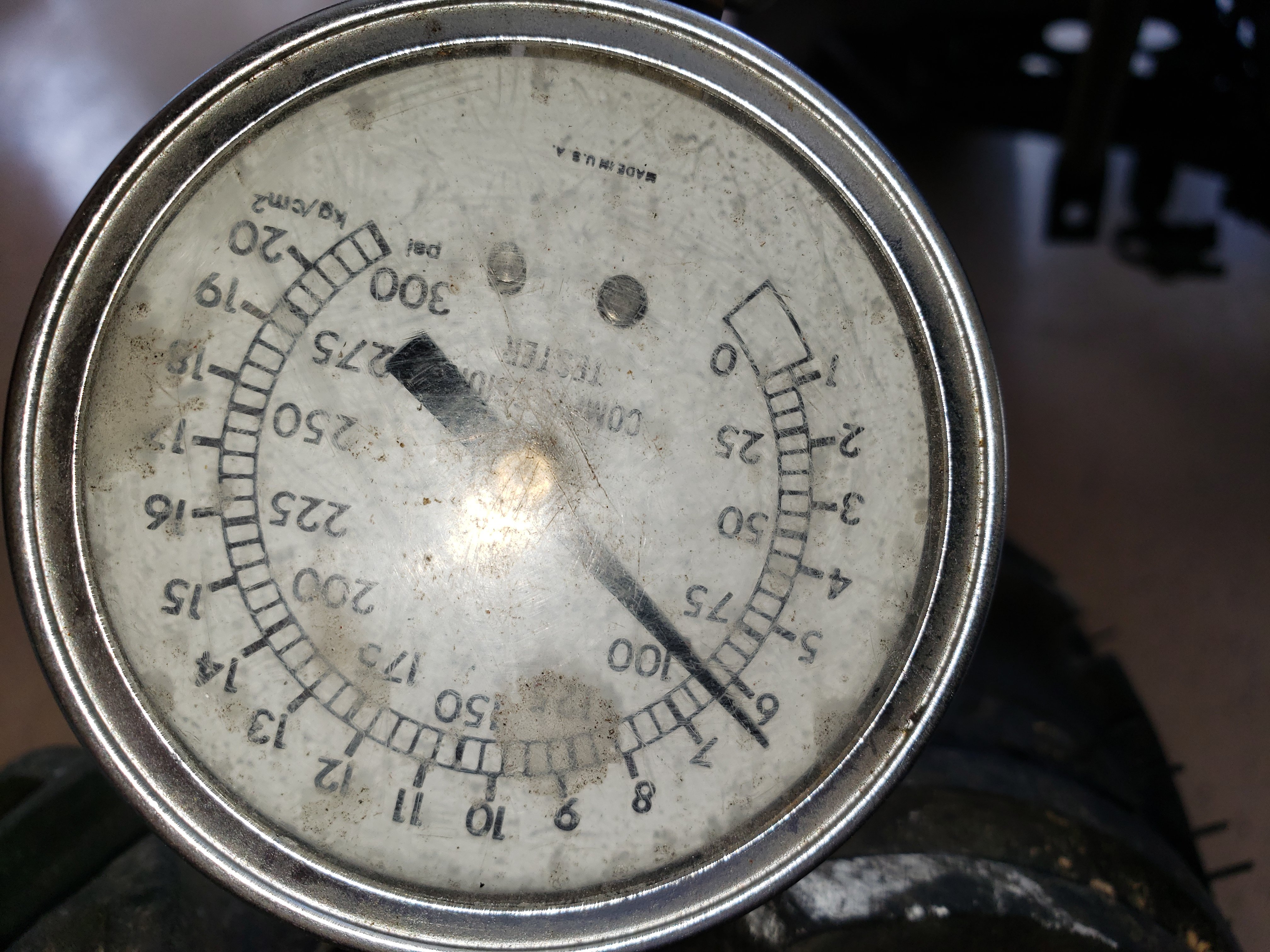

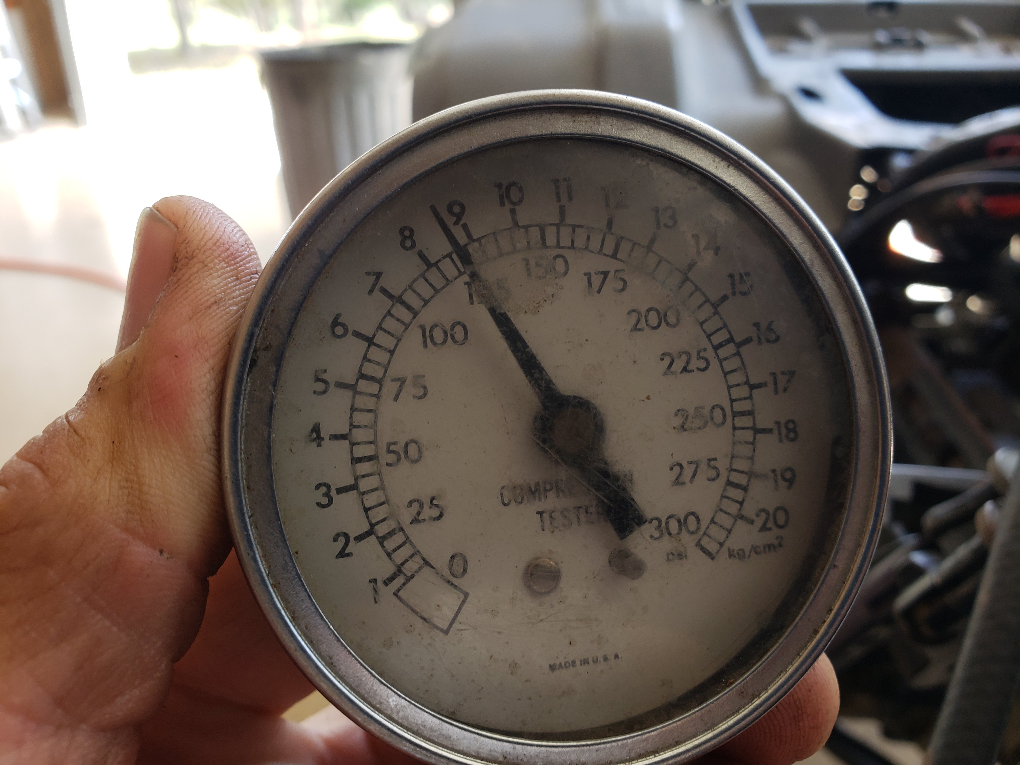

Well was going to tear it down today but double checked a few things
rechecked compression, right at 85psi then rechecked compression with
throttle wide open and I get 125 psi. Double checked and confirmed with throttle
open 125 psi. so I assume the motor is not the issue.  Still looking at the carb as it

Hey Az, if I’m not mistaken and maybe a few others can correct me if I’m wrong but the  compression reading should not change wether the throttle is open or not? The compression reading is contained at the top of the piston stroke so the only place to loose it would be valve seals, head gasket  or ring wear and not opening the throttle.

Yes the compression changes every time I either open or close the throttle.
 Never heard of
the readings changing with throttle angle. It will read 125 as long as throttle is opened.
If not it reads about 85psi. The motor runs super smooth at idle and doesn't smoke.

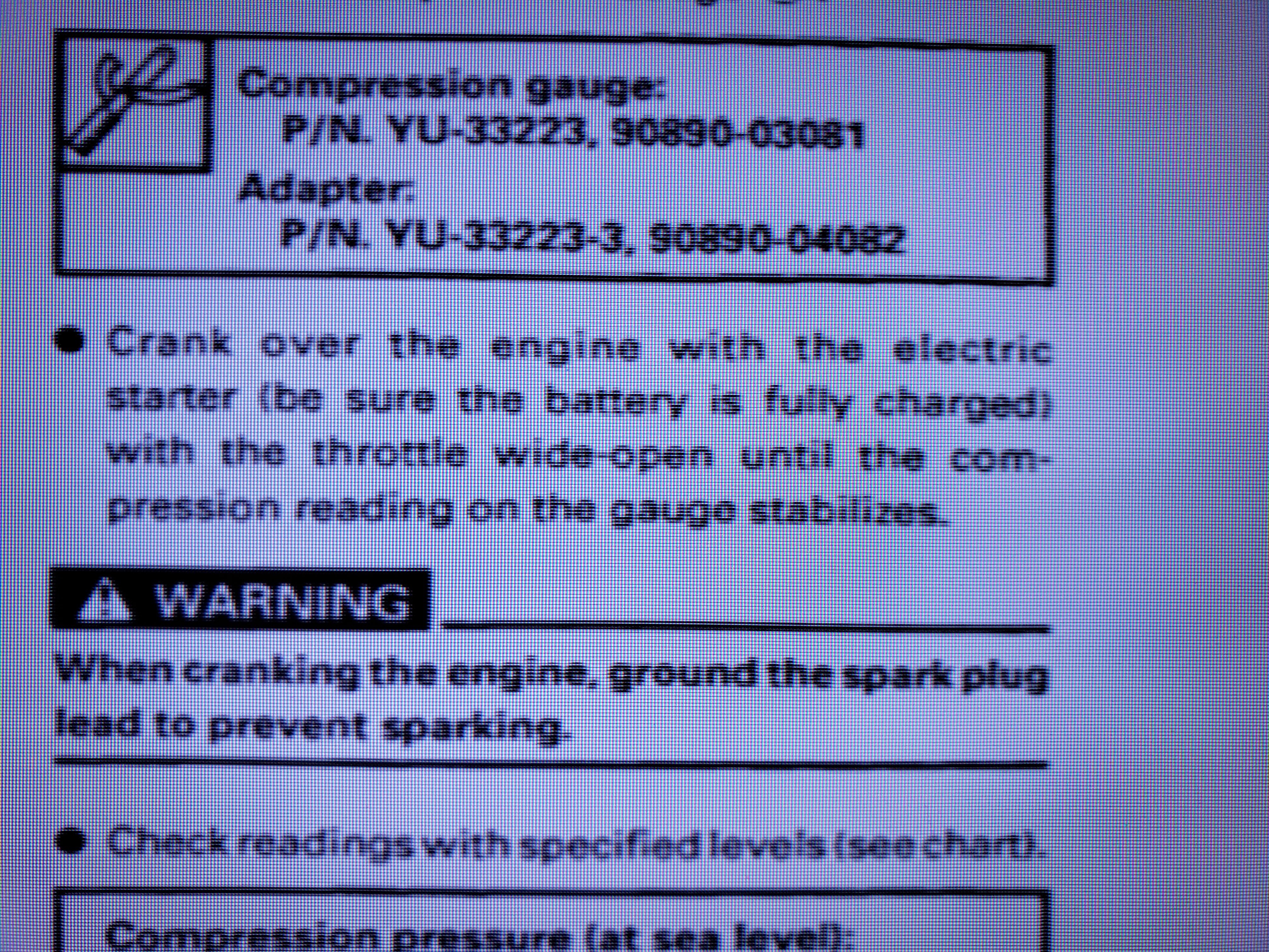

talked to an atv engine builder and he said you will get different compression readings
between no throttle and full throttle. Should be checked at full throttle. I checked the online
manual and it says check at wot20191010_175945.thumb.jpg.a013fc8caaf6aa9c635aae8bbd9211f1.jpg
I would assume that as the piston goes down and takes in air through the intake with an open throttle that allows more air intake thus more volume and more to compression on the way back up .  Makes sense now never thought about it really.
