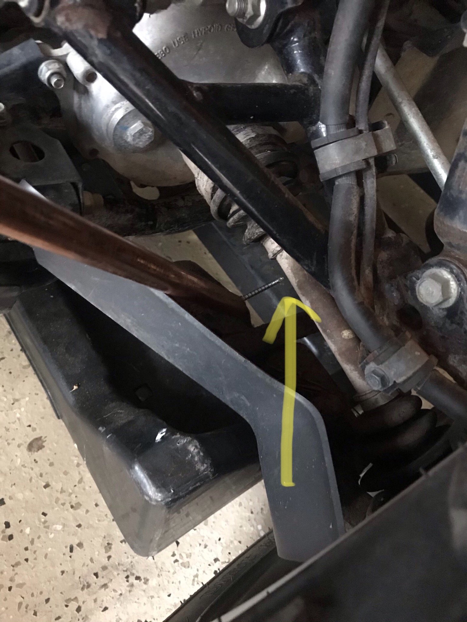

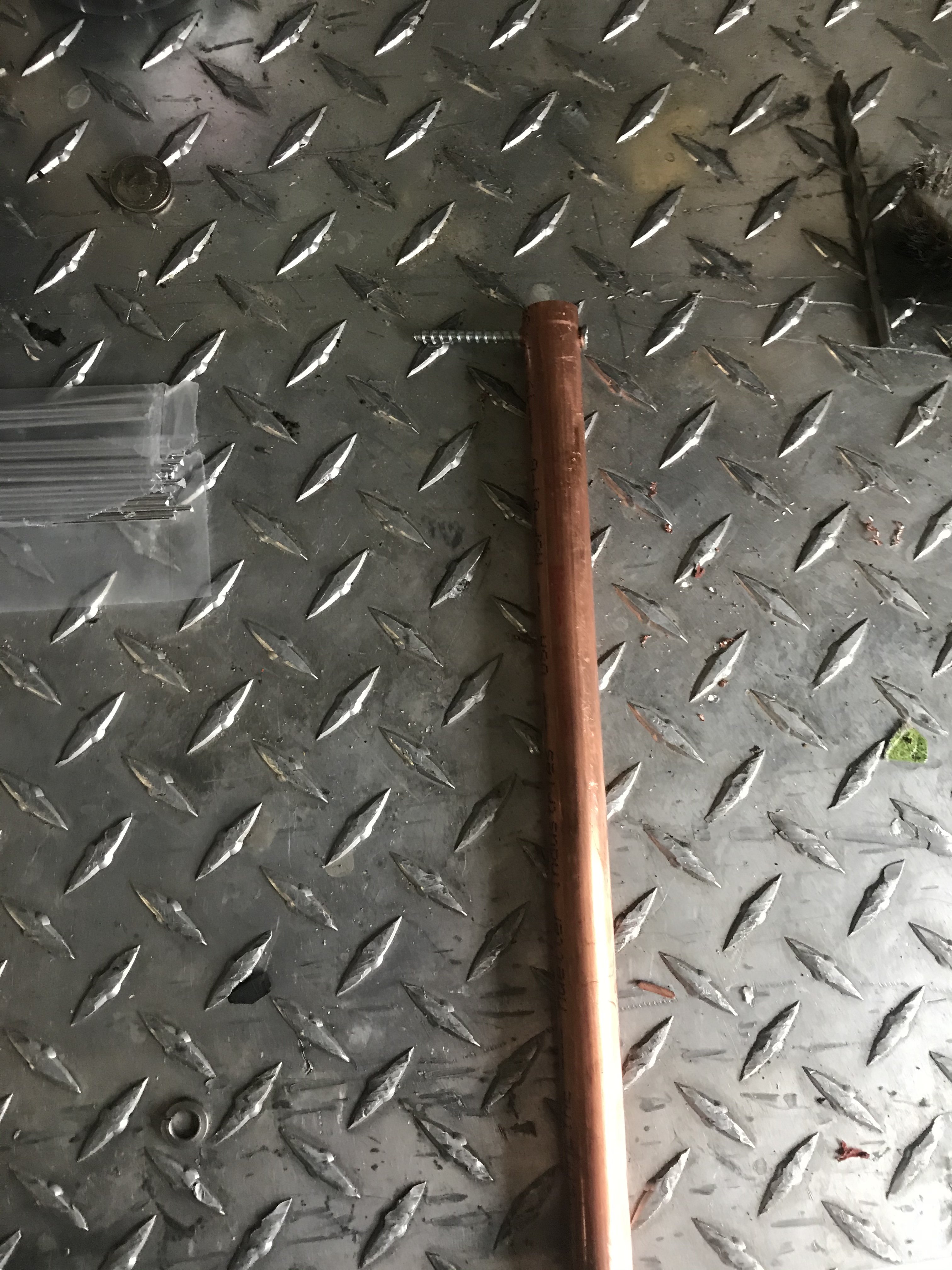

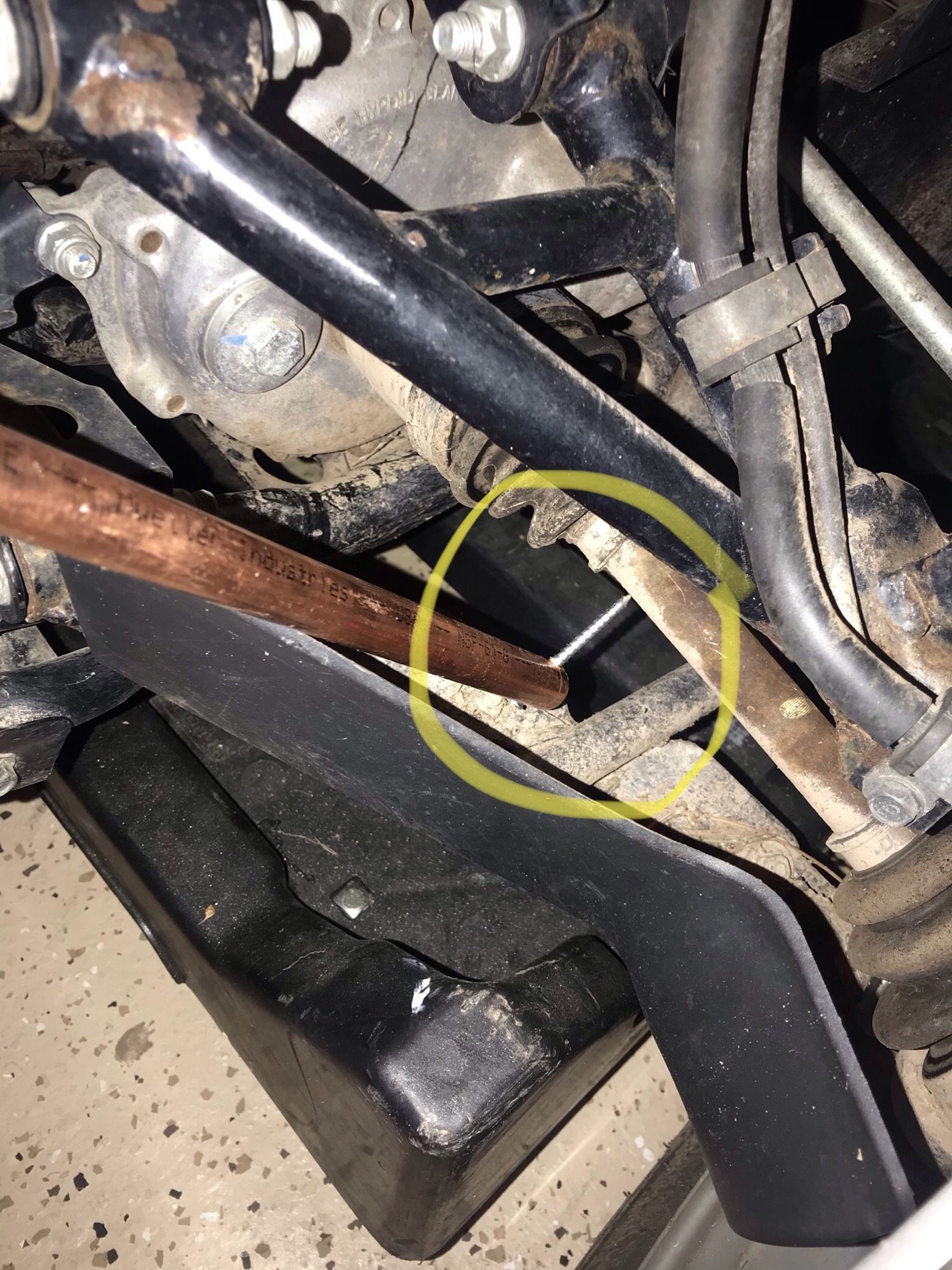

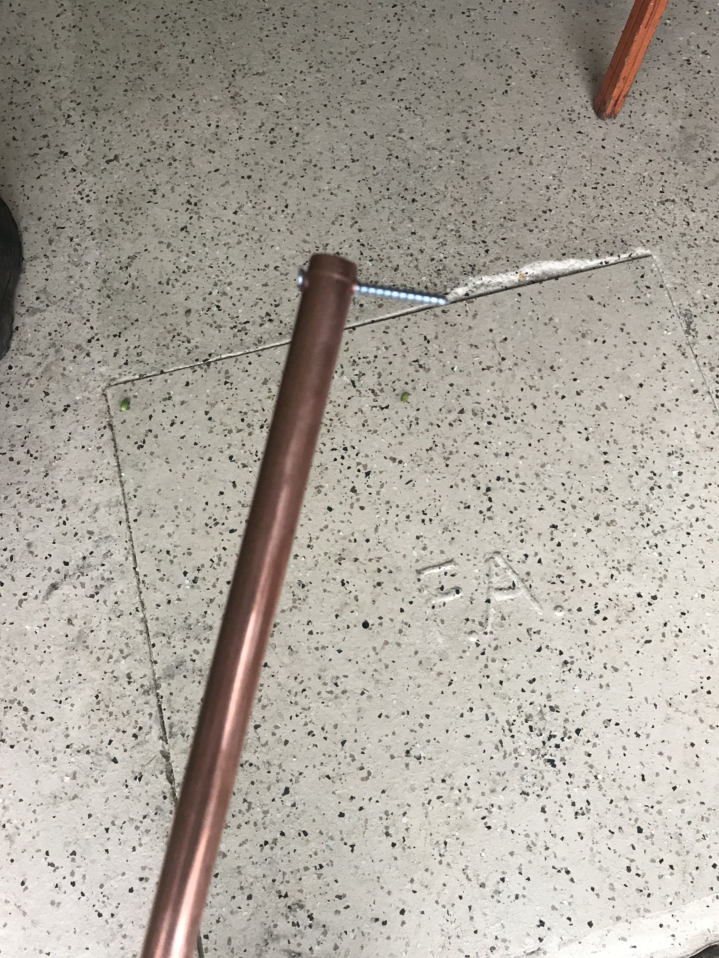

This may sound weird but you can check all the axles and shafts for a bend but it’s a pain in the as*.  I’ve checked drive shafts and axles for bends by getting the wheels off of the ground so they all spin free. I took a piece of 1/2 inch copper pipe that’s two feet long and drilled a small hole through the pipe at the end. I stuck a 3 inch long screw into the pipe all the way  through so the last 2-1/2 inches are sticking out the other side of the pipe.
I took the pipe and placed it where I can clamp it to the frame of the bike and the screw is close to and pointed at the shafts your looking at.
The screwtip should be  just under a 1/4 inch from any axle your looking at. Rotate the wheels by hand so the axle spins and see if the shaft gets closer to the screw tip or even hits it.  If it does mark that spot with a marker.
In addition to and before going through all of this you should start by looking for any obvious damage to the shafts first.
I attached some pics for you to help visualize what I’m talking about.

Good idea, I have a dial indicator for checking rotor warpage, should work too. Thanks

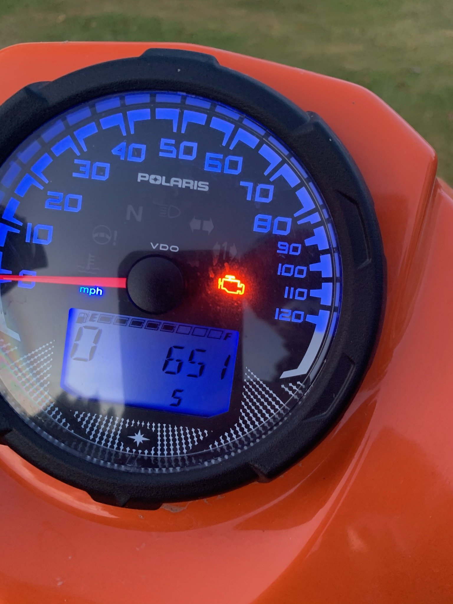

2 minutes ago, Frank Angerano said:
Can’t see the video.  I did a quick search on that problem and the remedy seems to be a replacement plug/harness. Looks like the injector plug and about 10 inches of wire that comes with a splice kit. Sound right to you?
@Frank Angerano I can see it on desktop, although might be an issue if you are on a phone.
@Jim Horst nice video and picks. I would have to agree, maybe be a balancing issue, shaft or rims. No caked on mud or anything inside the rims right? Have these tires ever been dismounted and mounted?
Yes sir. Harness is about 50.00, that's what my deductible is. I would fix it but it will cost the same and I want th ore vibration issue looked at also.
