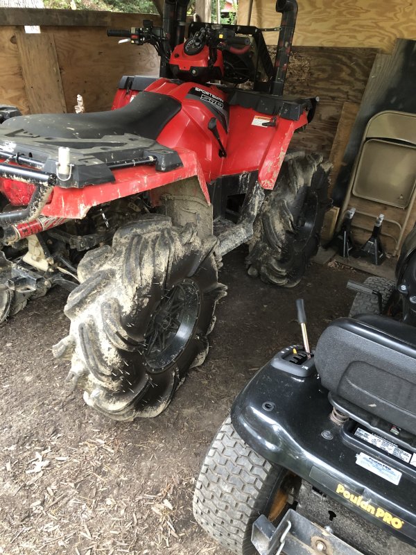

So I tried making a stock polaris boot work but both ends are too big in diameter.  I'm taking it to my grandparents farm tmr to work on some fence lines so ig i wont be hitting any mud 😪😭.  Heres some pics of it in AL where I picked it up
The temporary fix is to use the oem boot and zip tie it back on. The right way is to get the right one. Lol. if to much play is in the boot, cut a small enough line to split it but still use it. Then take silicon to patch the hole.
Sorry was having wifi trouble couldn't get pics up last night.  So I tried a oem boot and clamping it as tight as i could and it still popped off.  Maybe what@06kfx440 was saying would work but I'm leaving rn-  just gonna run it easy and keep it outa mud and if the axle breaks it breaks😆👍

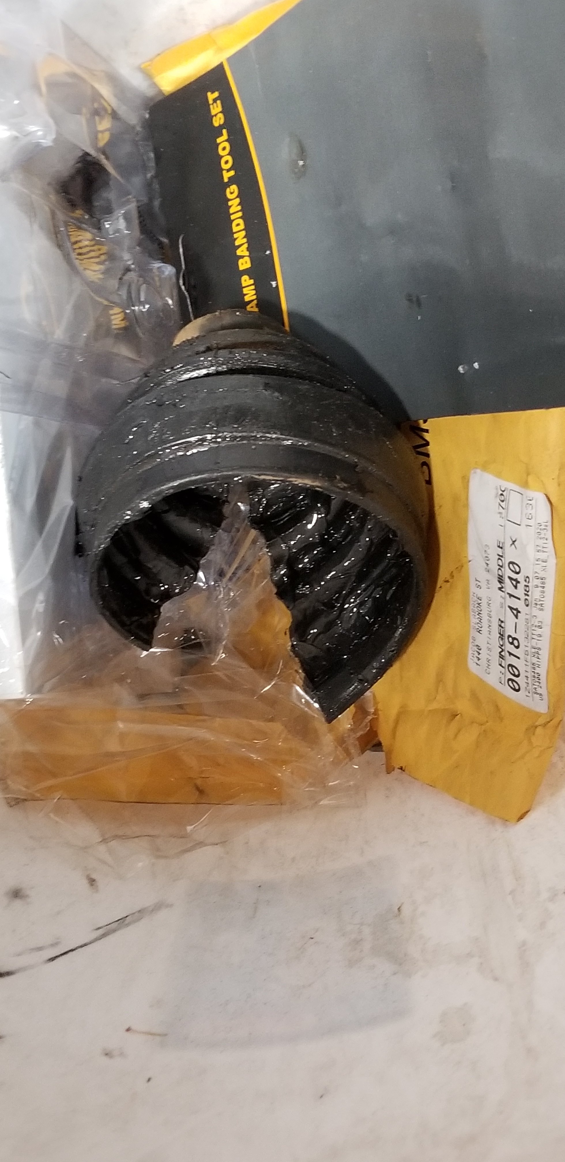

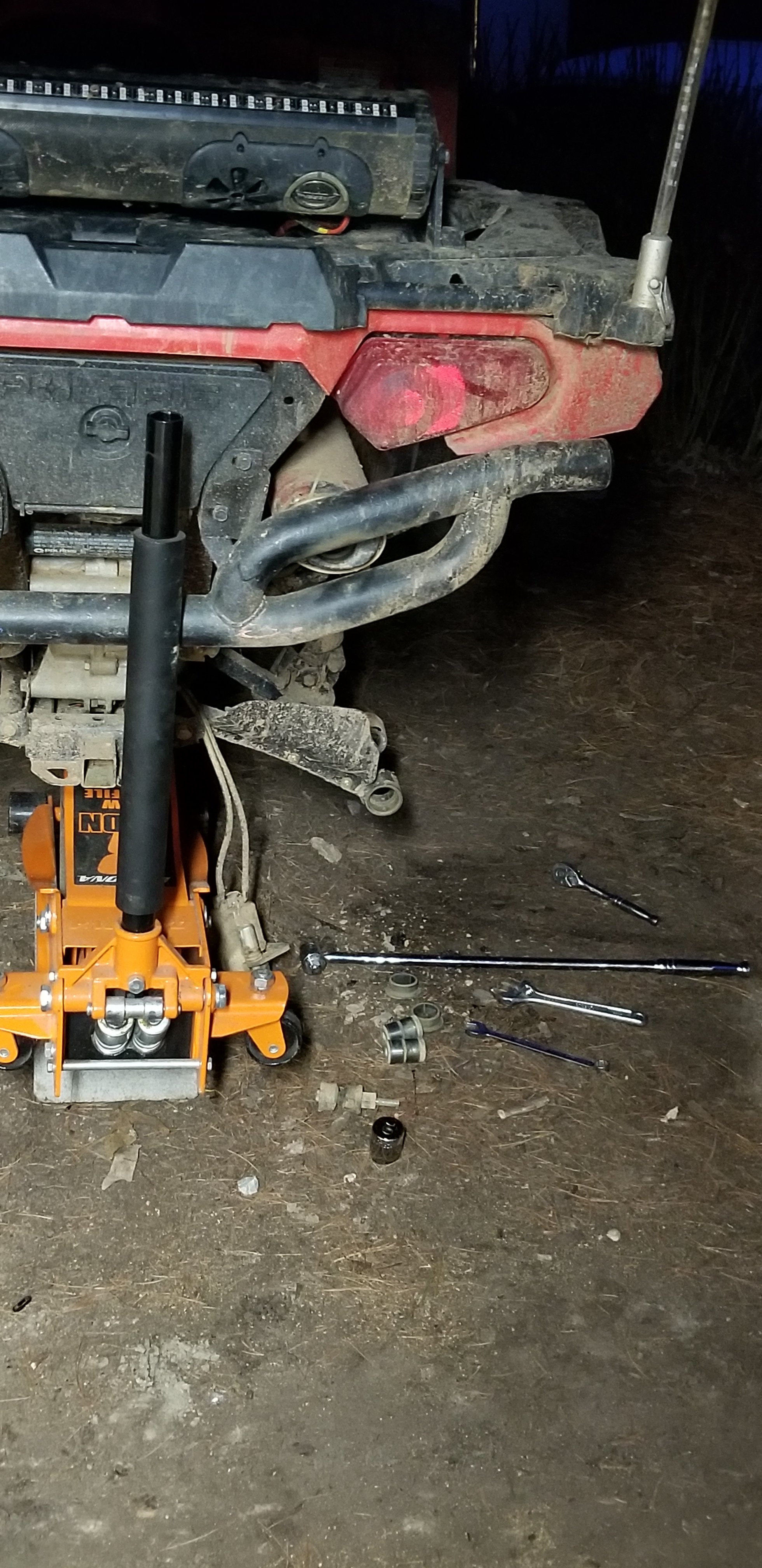

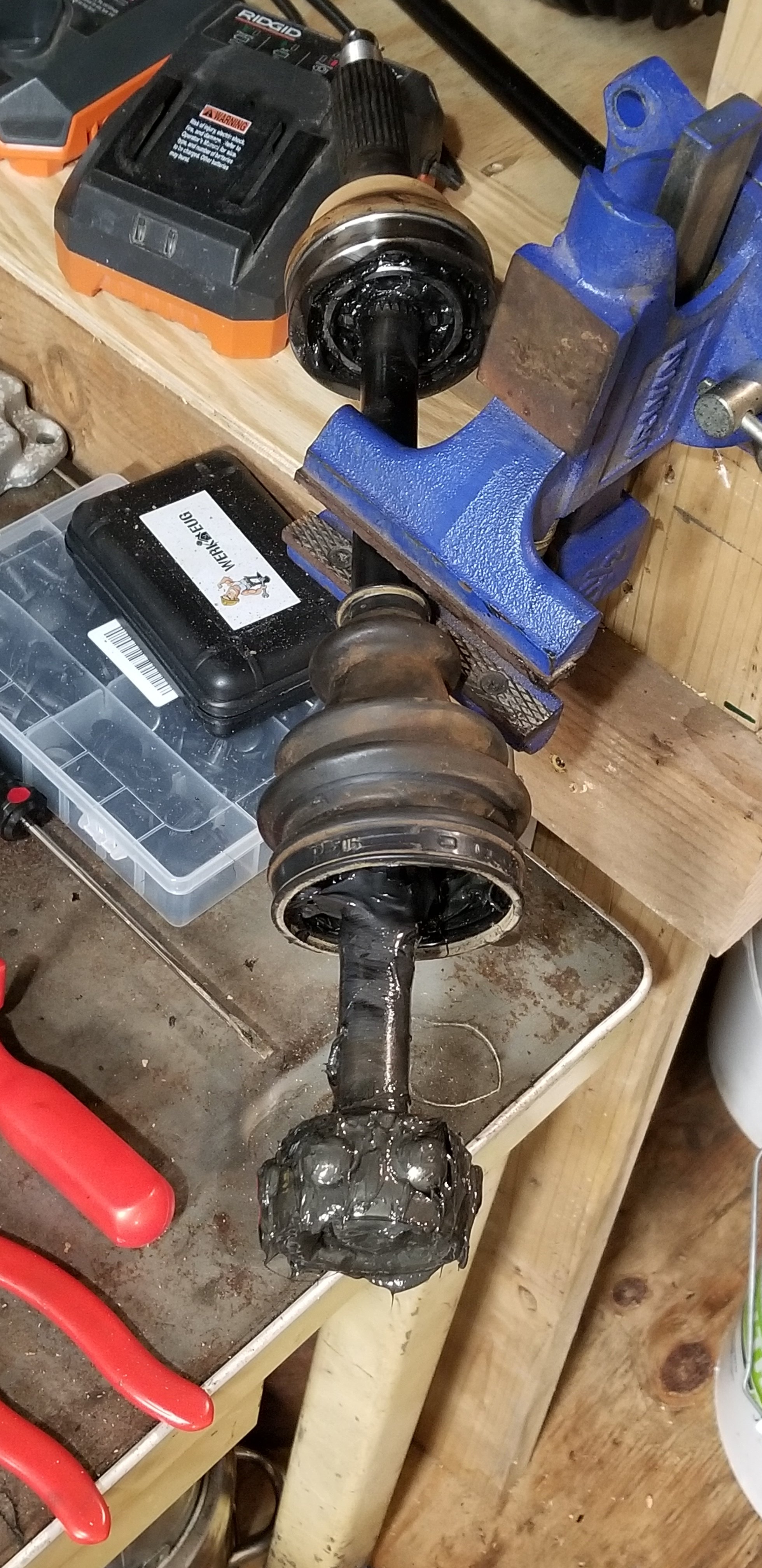

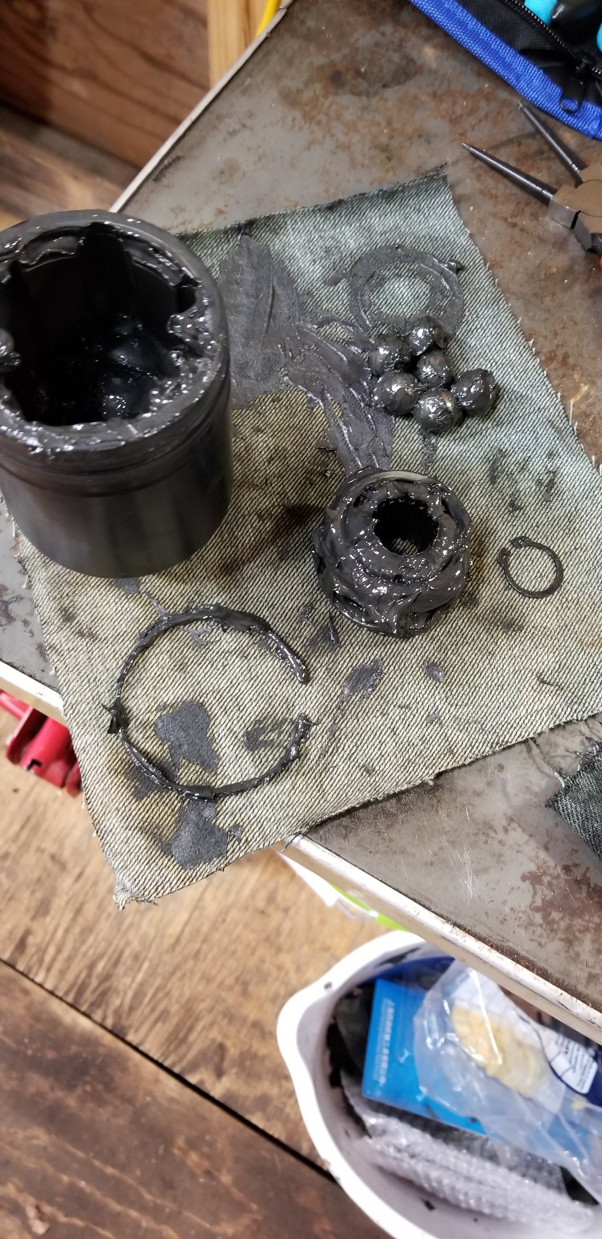

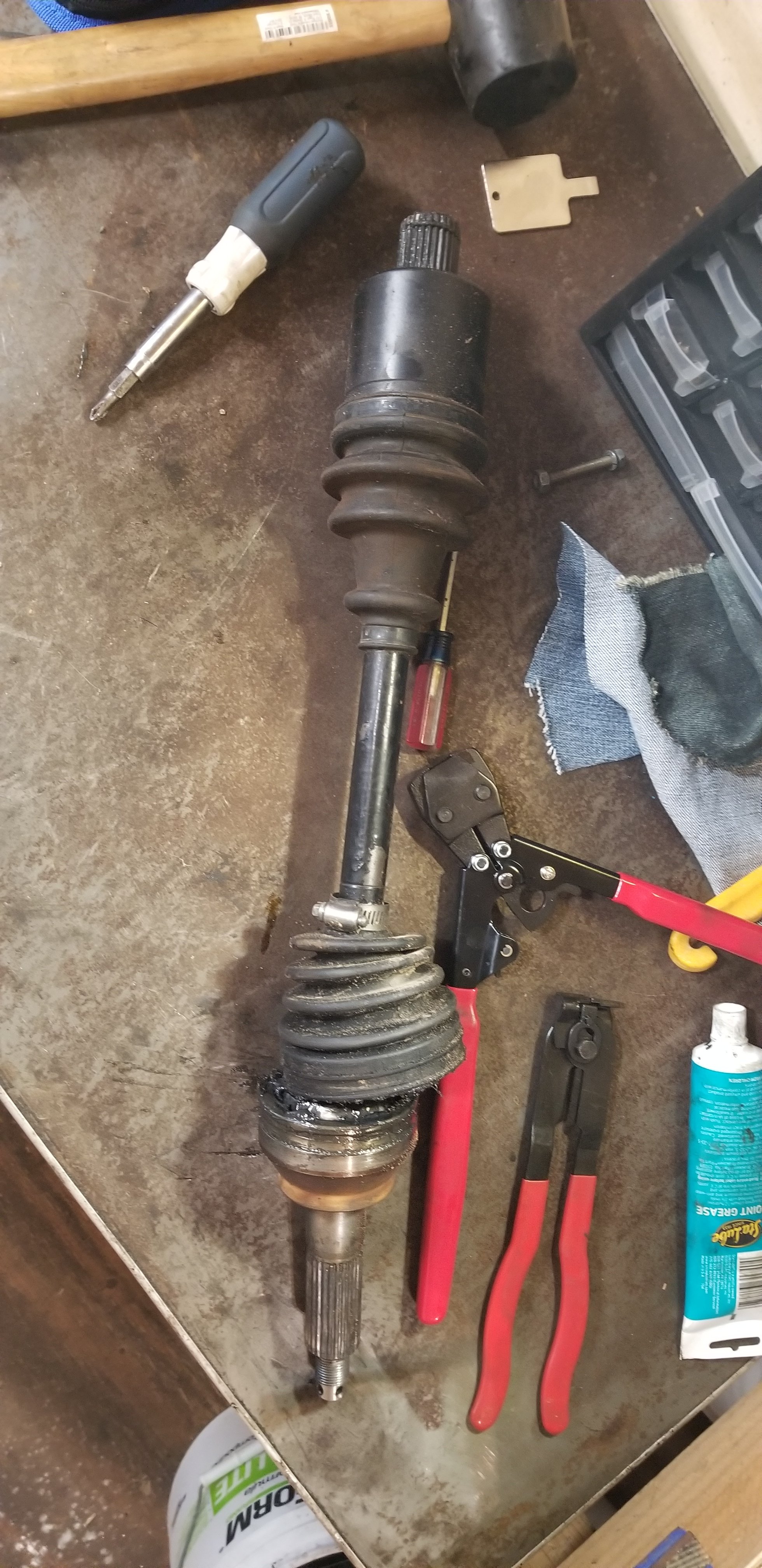

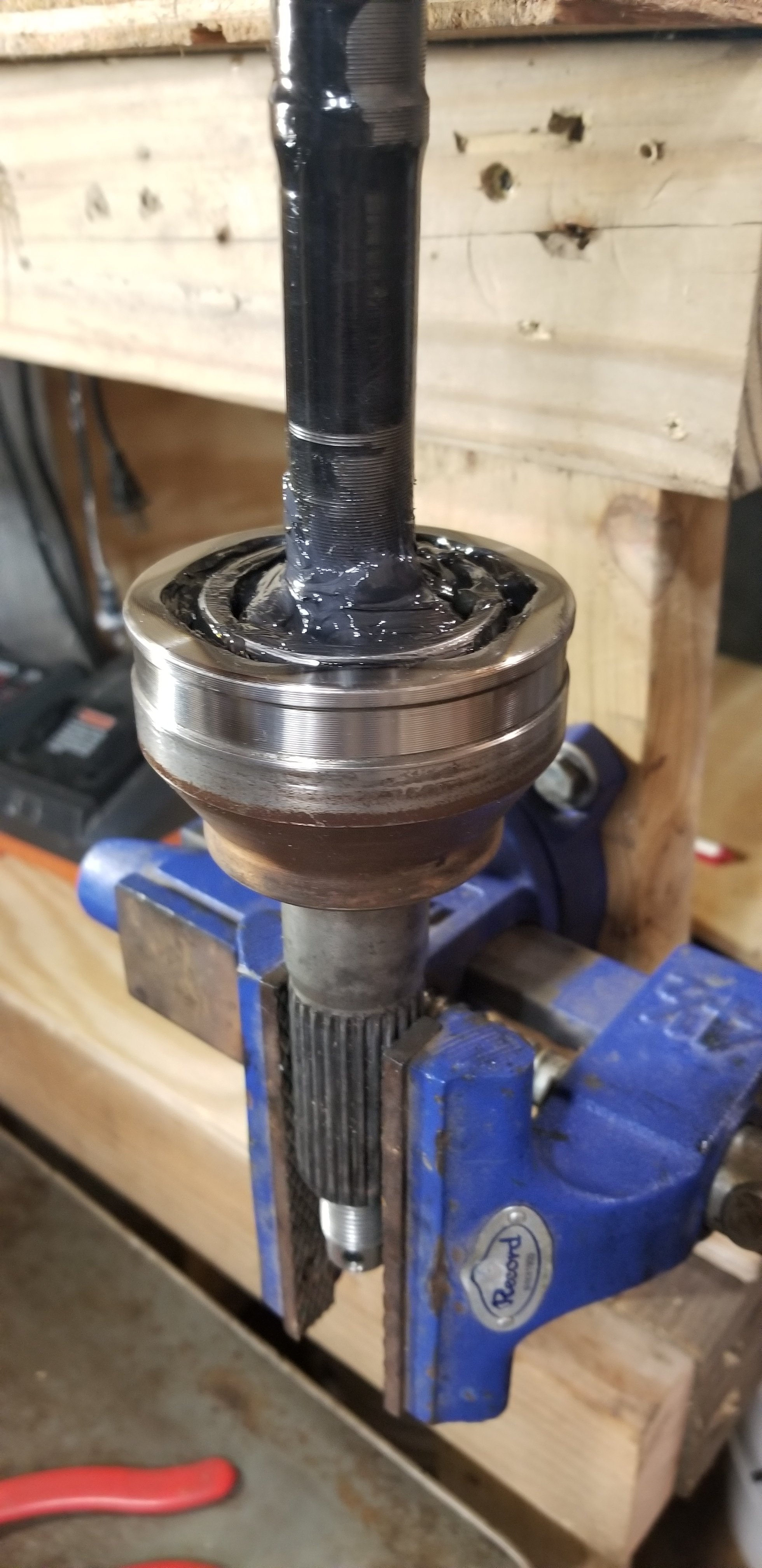

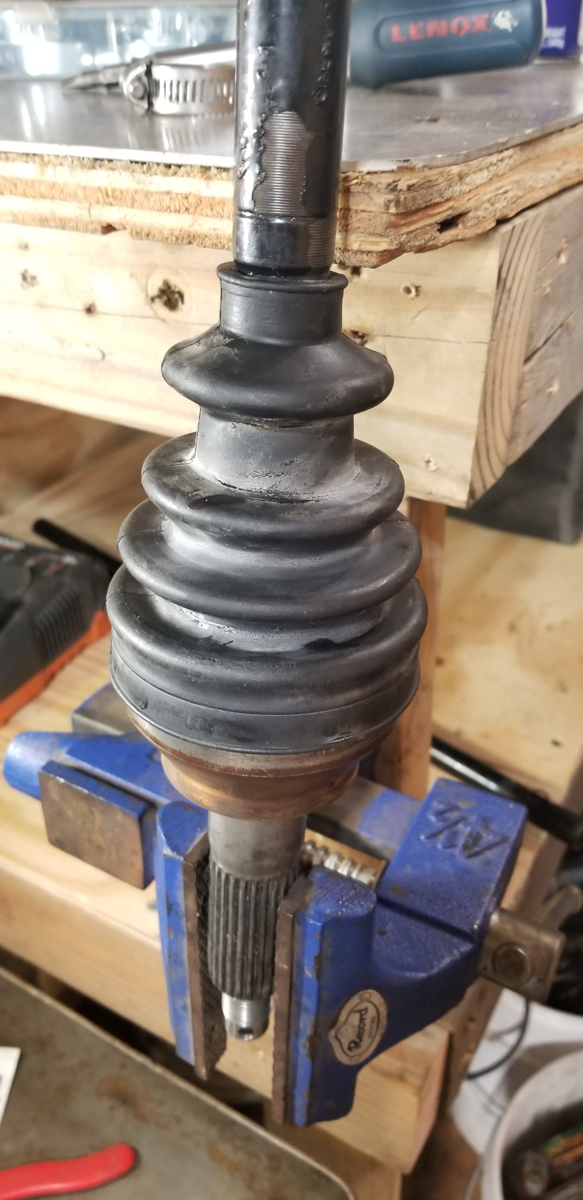

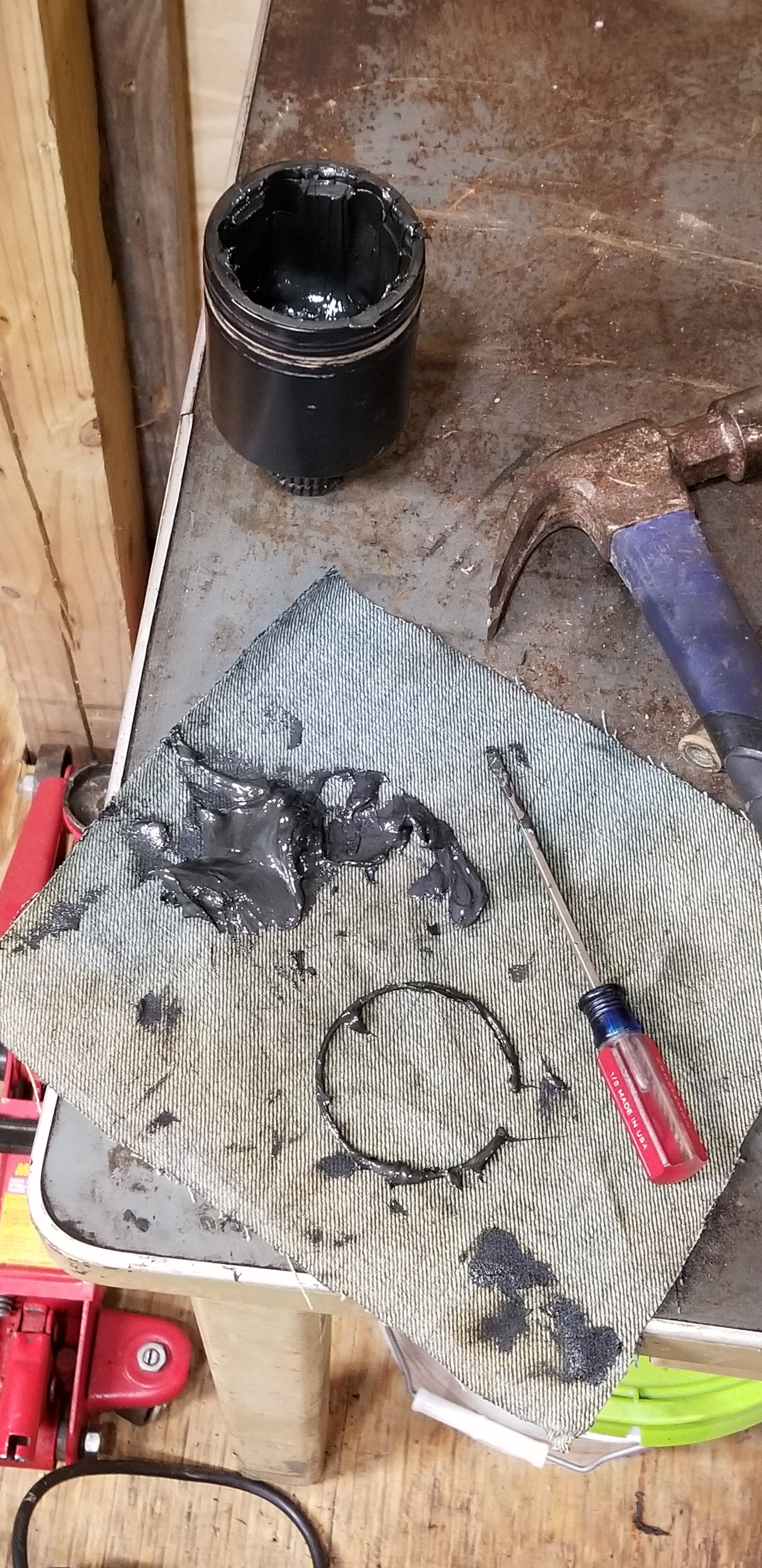

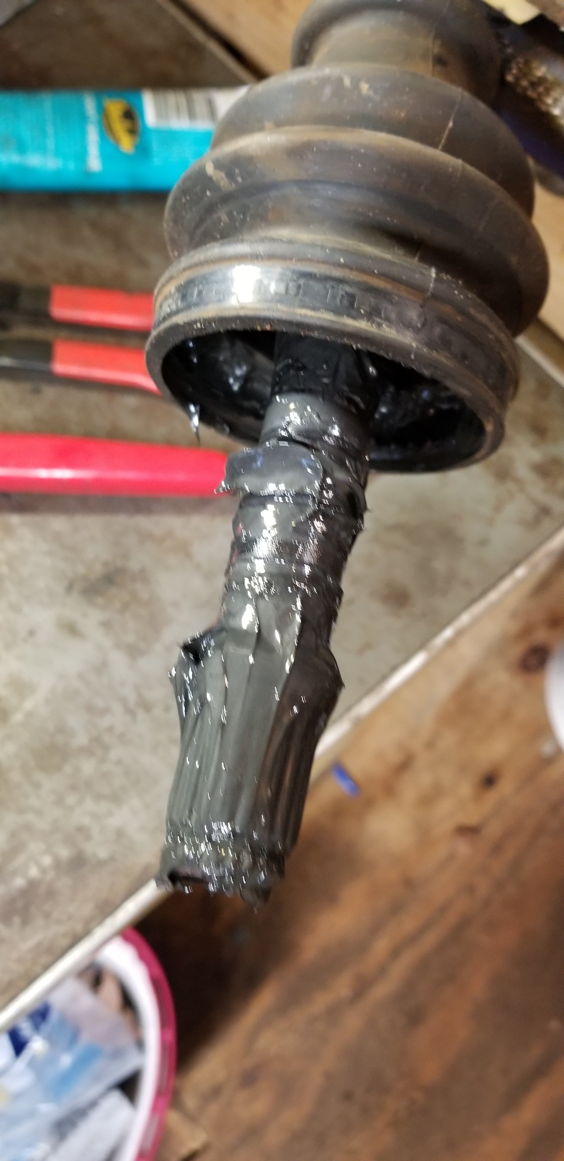

Got it done.  So I ordered a front end lower boot and it fit great!  Bought off amazon.  Heres some pics.  Super easy to disassemble these cv axles if you have the right tools.
I bought a cv clamp tightener/cremper and a set of circlip pliers and pics and swapped a lower boot in prolly 2 hours or less (including disassembly and reassembly of the atv.

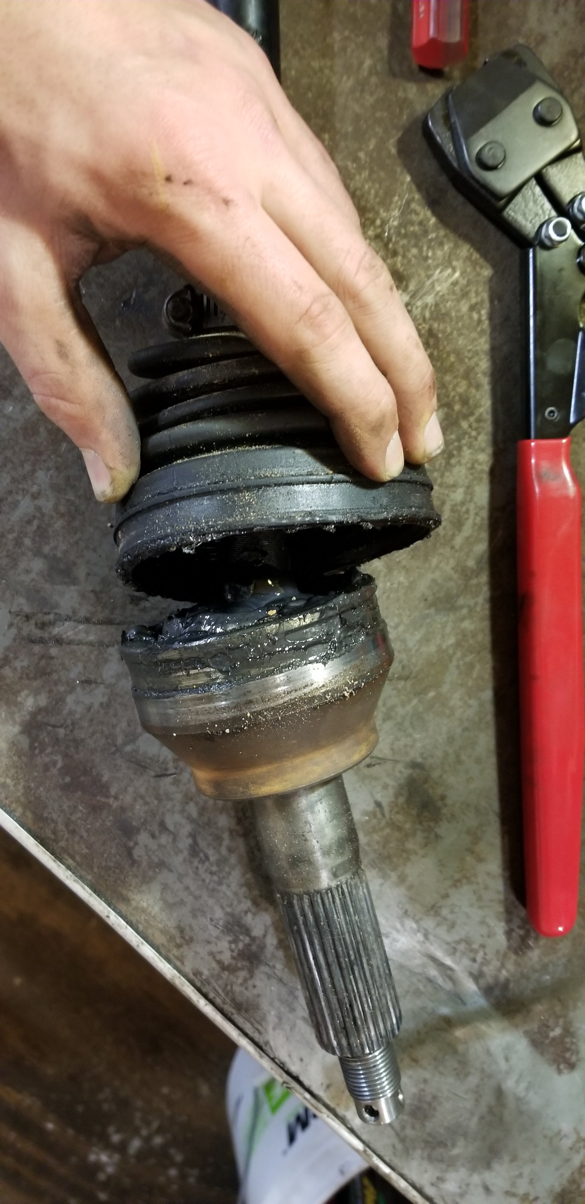

You can see in the first pic I was able to clamp the stock boot with a pipe clamp, but the lower end came apart and lost the clamp.
these pics are kinda in order of how I replaced the boot
Never mind they didnt upload in the right order
Edited by JacobSlabach

Great advice and that’s actually exactly what I did.  Found out the reason the boot popped was because the boots were too wide and rubbed on the hub.  Just rubbed until they got a hairline crack all around and started to leak.  (The other lower boot started leaking too for the same reason)
