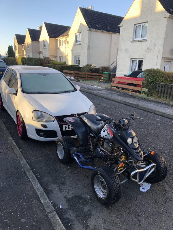

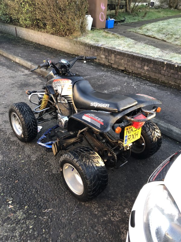

having an issue with my carb slider jamming ect just replaced the carb with a good pre owned unit and seem to be having a similar issue
is there a home fix for this as a posed to buying yet another carb as the quads my daily transport and stuck without it
thanks for looking any help great full can also forward video of the problem I’m having if needed
