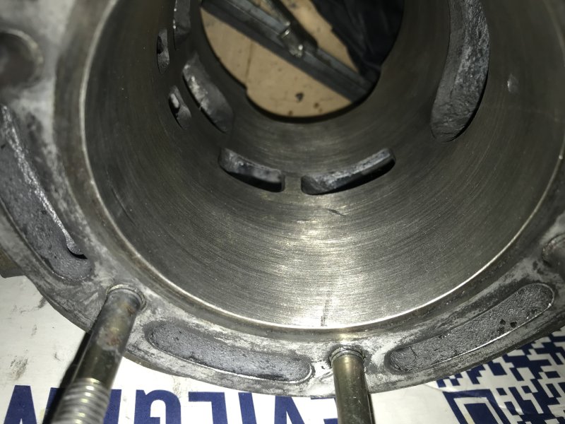

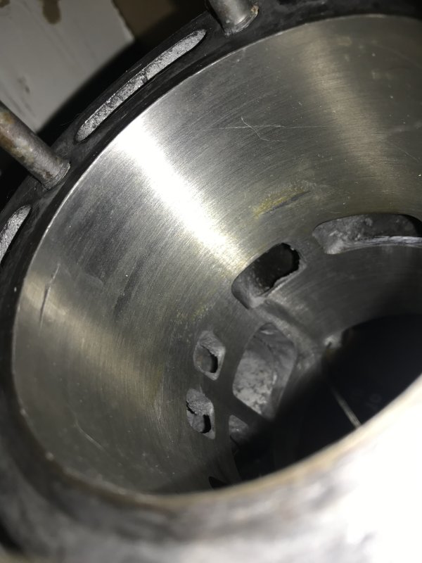

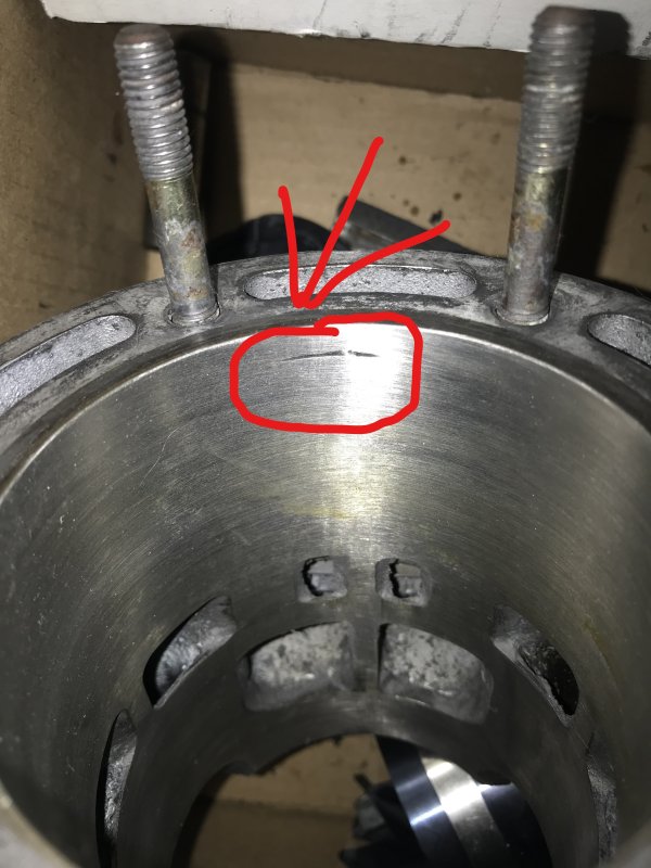

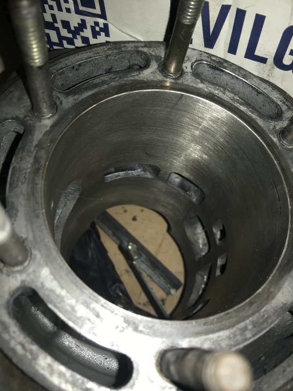

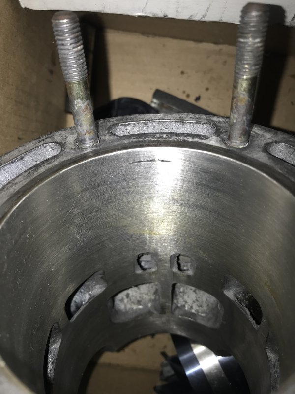

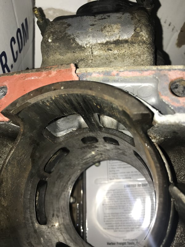

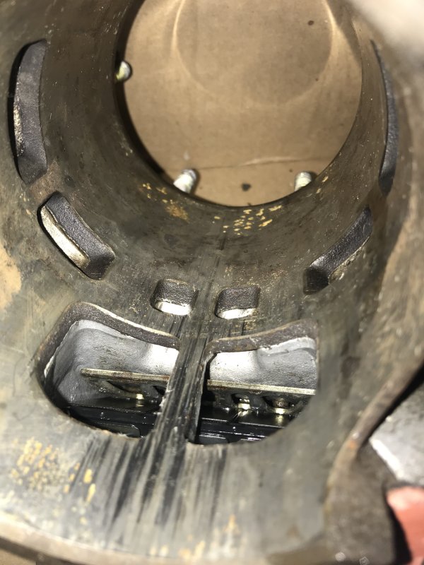

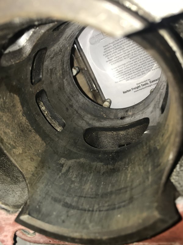

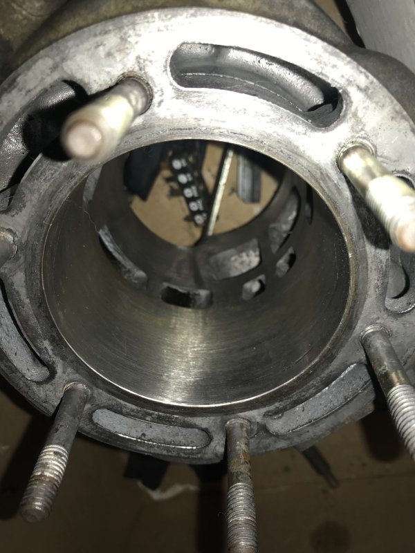

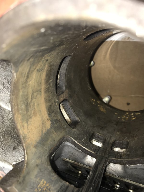

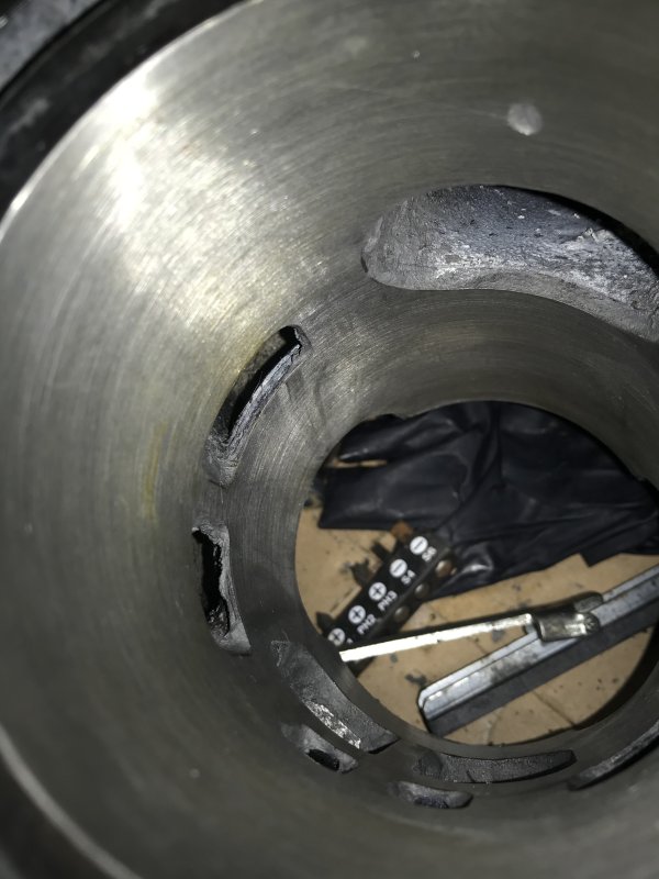

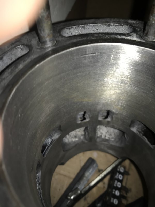

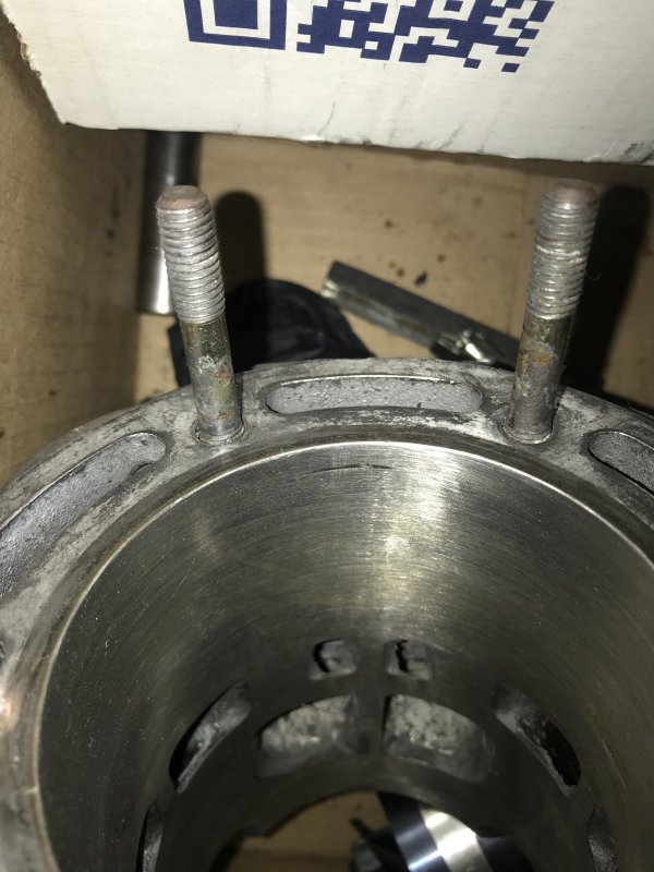

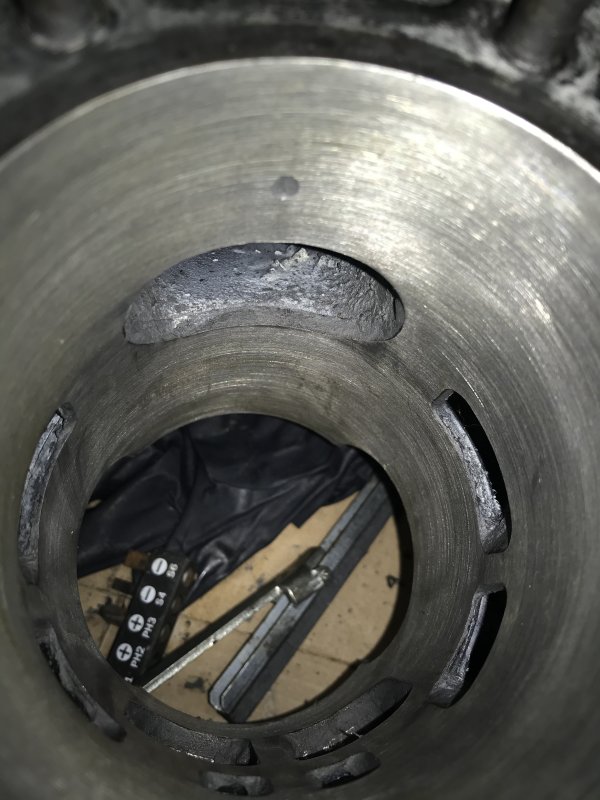

So honed out the cylinder and got most of it nice nice but left with this .. Might just have to have the things bored out now ..... some before and after..pics.
1995 Polaris Sportsman 400 4x4
IMG_9395.thumb.JPG.05a467730c84b985aa3f4c3e993586bd.JPGIMG_9394.thumb.JPG.d07bba3b20372d56f56cc387c05e8a34.JPGIMG_9393.thumb.JPG.ff277a650a464b9859170bc06e73f341.JPGIMG_9392.thumb.JPG.cd00f4cdad458e4919bdda867fbafbfb.JPGhave to have the things bored out now ..... some before and after..pics..IMG_9391.thumb.JPG.c8aa82ce0f64df640662de0cae01e219.JPG

If the rings are below that nick at TDC then it'll be fine. If the rings go over that though I'd bet it would ruin a ring. Looks awesome otherwise, good work.

I have never had any luck with cylinders. I always end up with a scoring or nick right by the exhaust port or the rings break and gouge something. Mine always end up needing to be bored or replaced. I have bad luck though. I hope you are luckier than me. 🤞

Well cleaning it up a bit more and it almost gone and should be good to go with new piston and rings now to get them and the gaskets and put back together and run it
First 2 stoke atv I ever rebuilt , I usually just stick to heavy diesel ..lol
