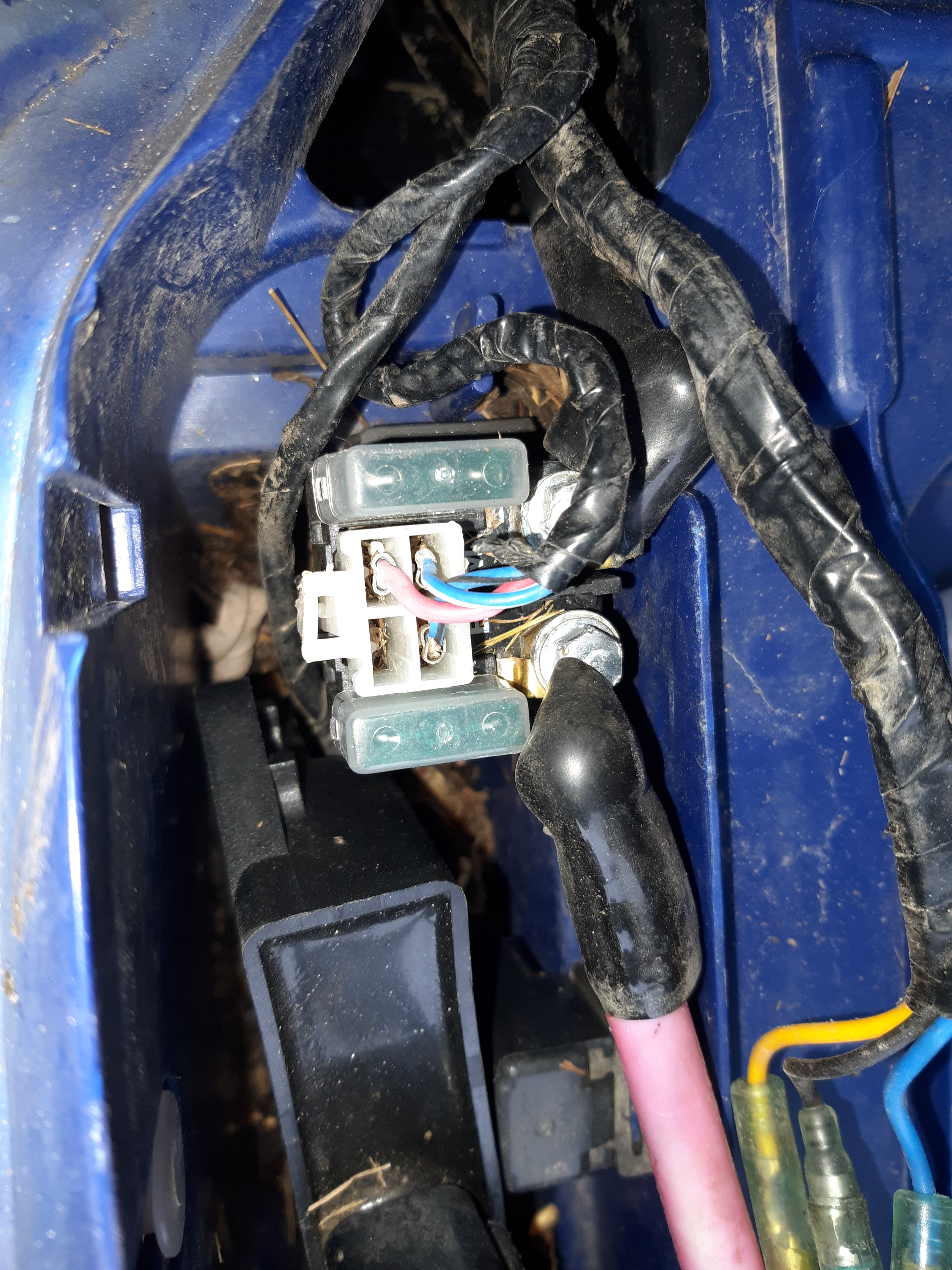

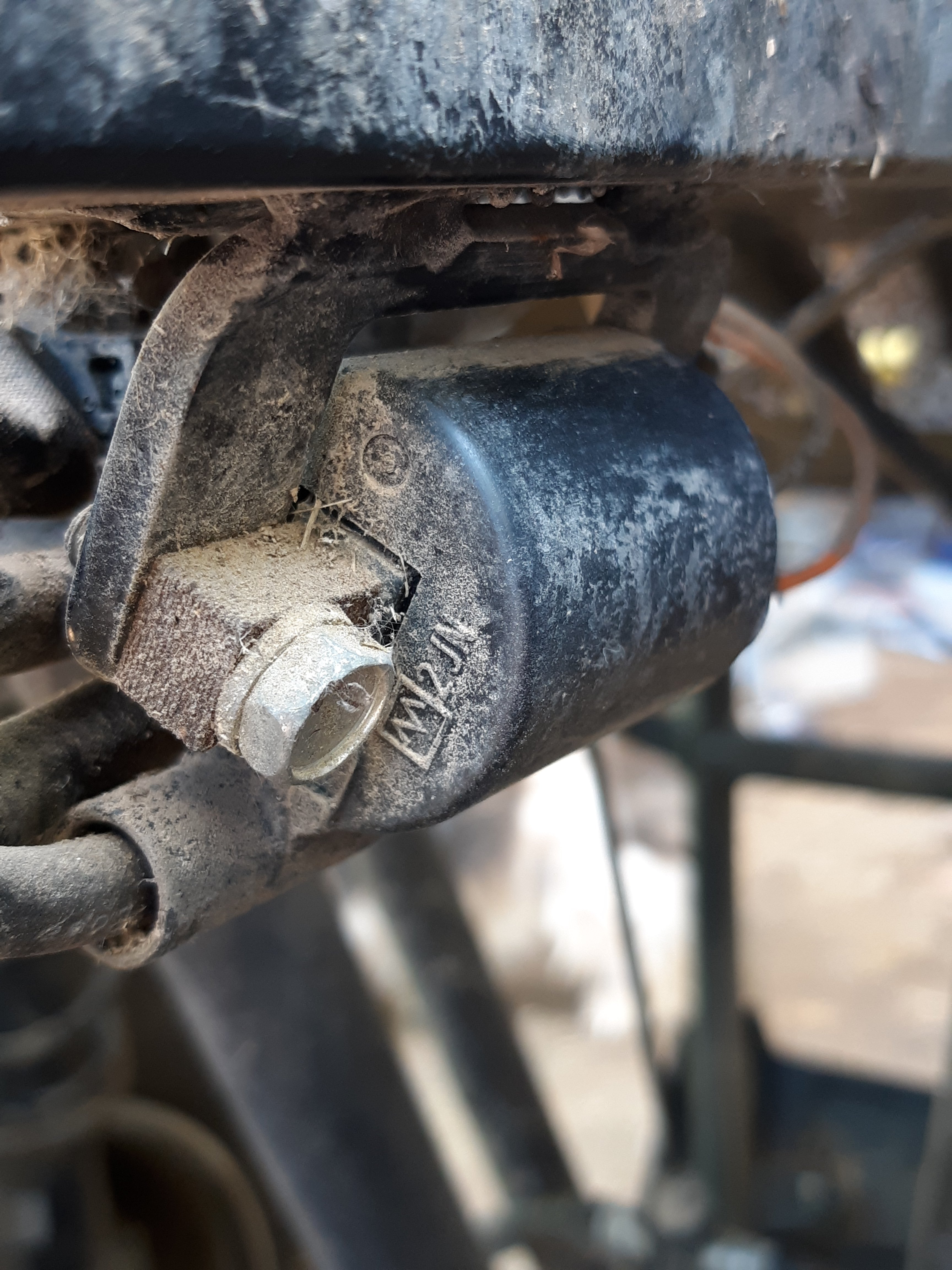

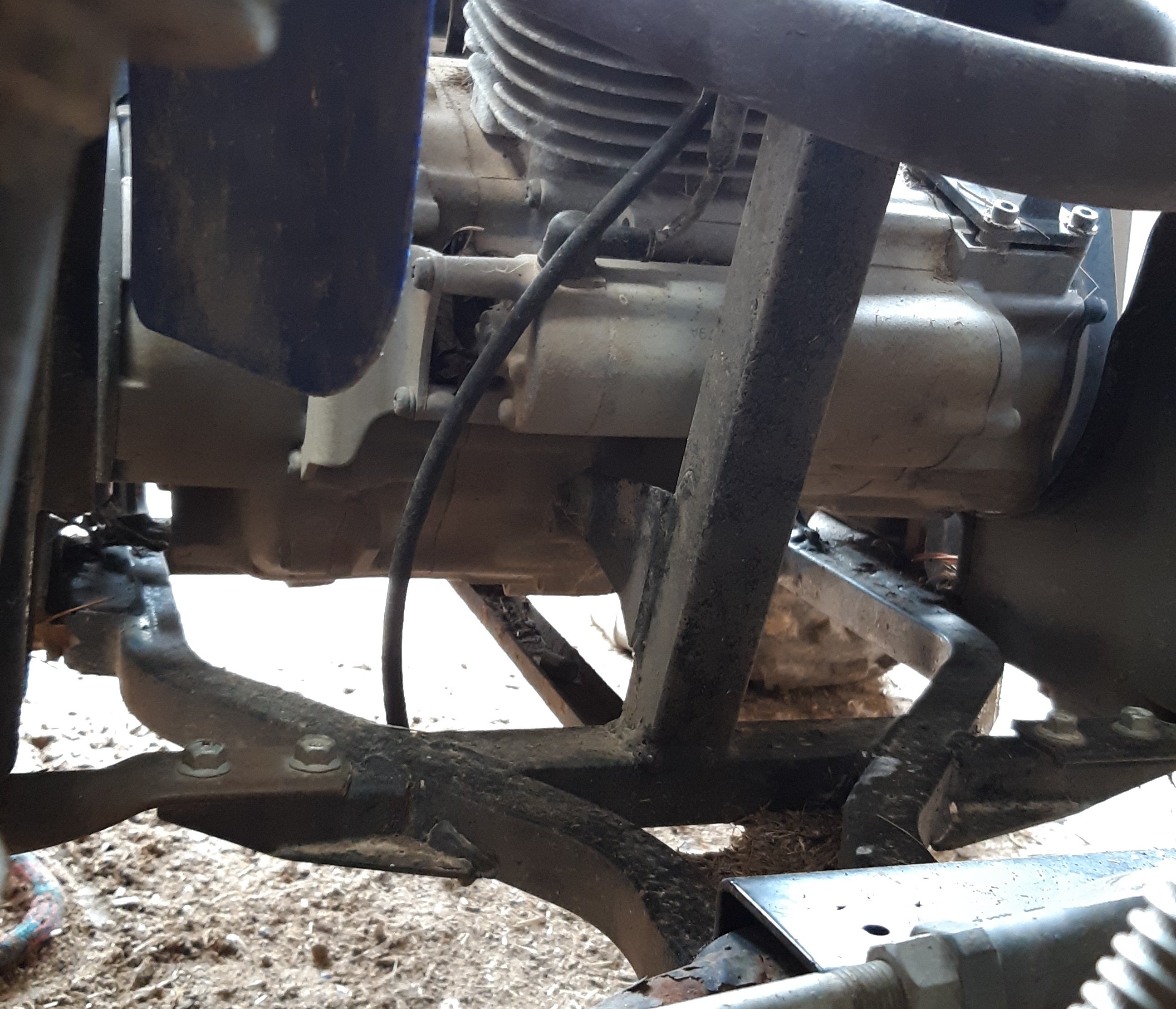

The votage going tothe solenoid is 14.2 with ignition turned off and 12 when its on. I don't have a red wire except for what is in between the fuses and of course its taped together with a bue wire. The battery is also showing 12 volts. I added a picture that I traced black cable to. Please ID it for me. Its attached to the frame with red wire out the front of it.  I'm really trying to avoid a big expense right now if I can

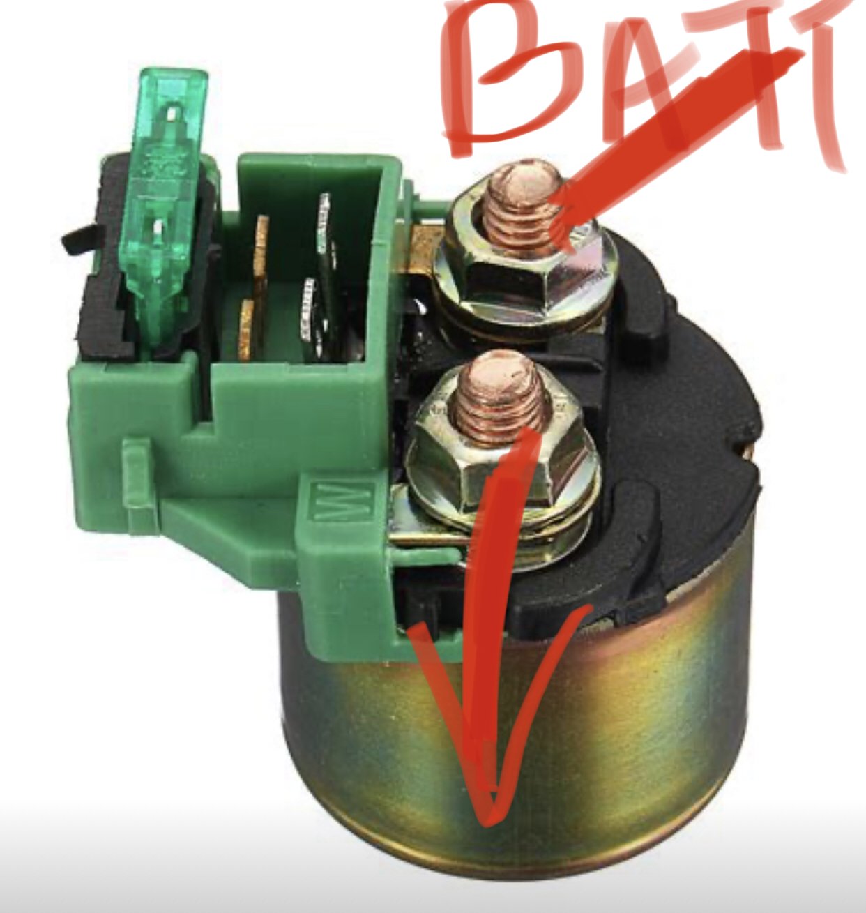

The solenoid is where you have to start. You should have two large red wires on the solenoid (pic attached). Jump the two nuts  together on the solenoid. One wire comes from the battery and the other goes to the starter. Follow those wires and they will lead you to the starter. If you jump them two together the starter should spin. If not then its a starter problem.  The pic you posted is the ignition coil.

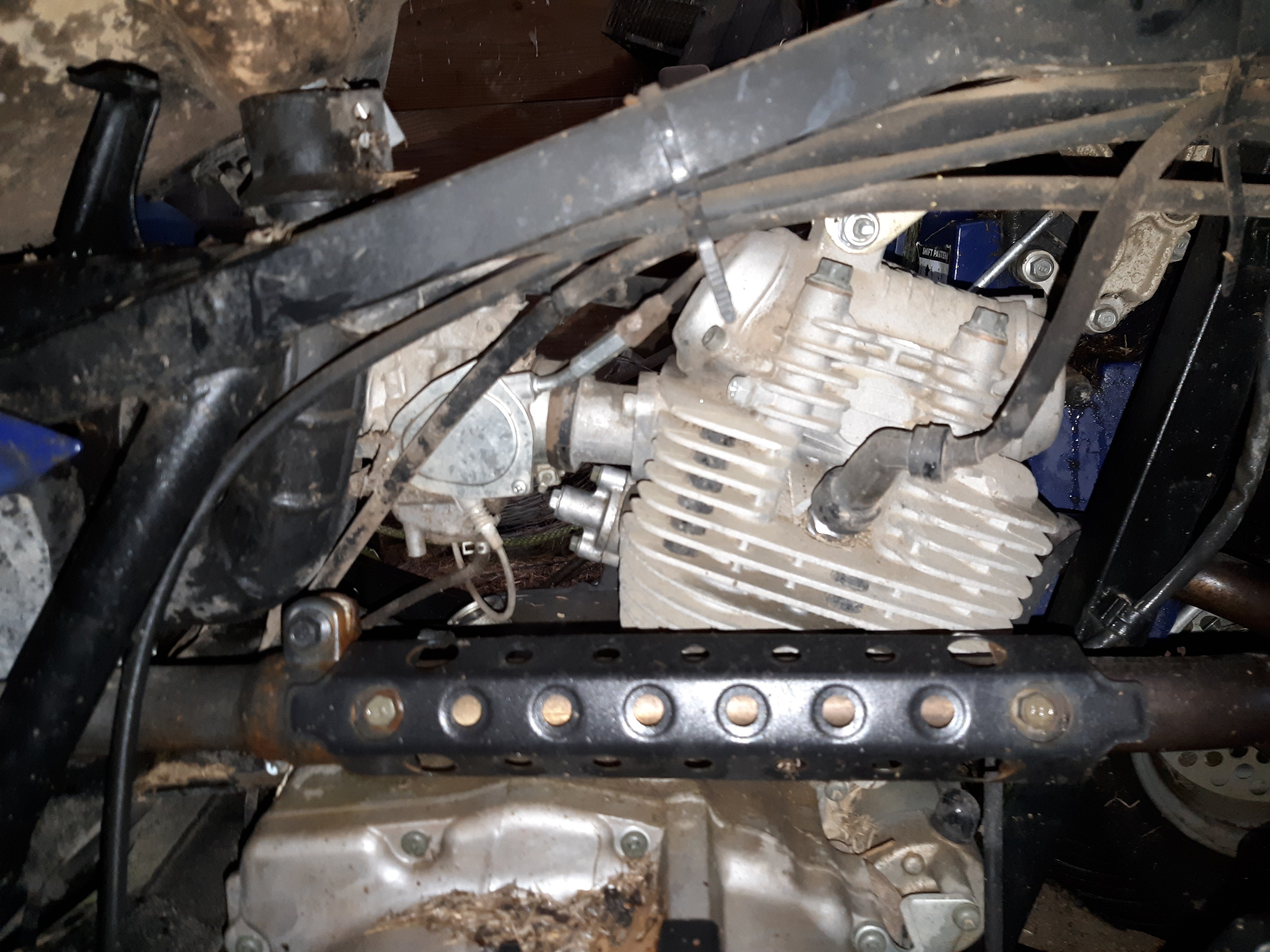

The pic I attached is the solenoid showing the wires from the battery and the arrow goes to the starter motor.
The two nuts shown on solenoid are the ones that you should jump.  You may get a spark when you jump them its ok but should be only done for a second or two.

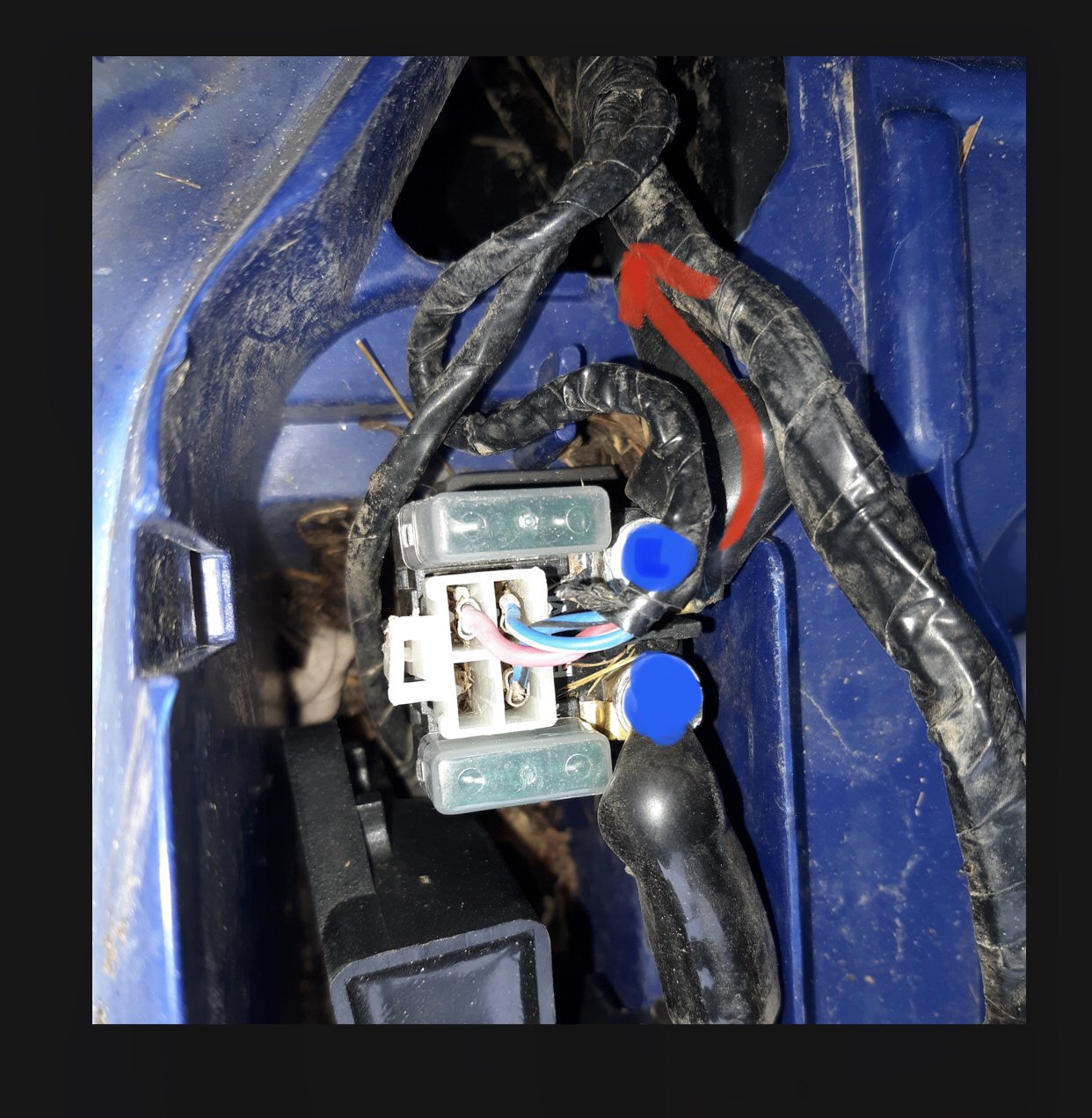

I don't have 2 red wires. I have the red cable that goes to the battery and a black one leads to the engine along with several other cables. Only way to know for sure is I am going to need to cut the zip ties to release all the cables so I can trace them better. Since the Bear is in the barn, I will do that tomorrow. That solenoid is different than what is in my yamaha.
Ok i marked  up the pic to hopefully help you out. The red marking is the wire that should go to the starter. The two blue dots are the lugs that you should jump together to see if the starter cranks. Jump them first for a second. See if the engine cranks.  Don't hold the jumper on for too long. The engine should crank up when they are jumped.  Make sure the atv is in neutral.
Ok thats fine but at least the starter is working.  That small plug on the relay, one wore should have 12v to it. If you have that then the solenoid is probably bad.  Easy enough part to get.  Double check your kill switch is also working properly and not causing all this.
I would also pull the spark plug out and test for spark while your cranking the engine. If you have no spark and no start button then the problem could be causing them both and not a bad relay.

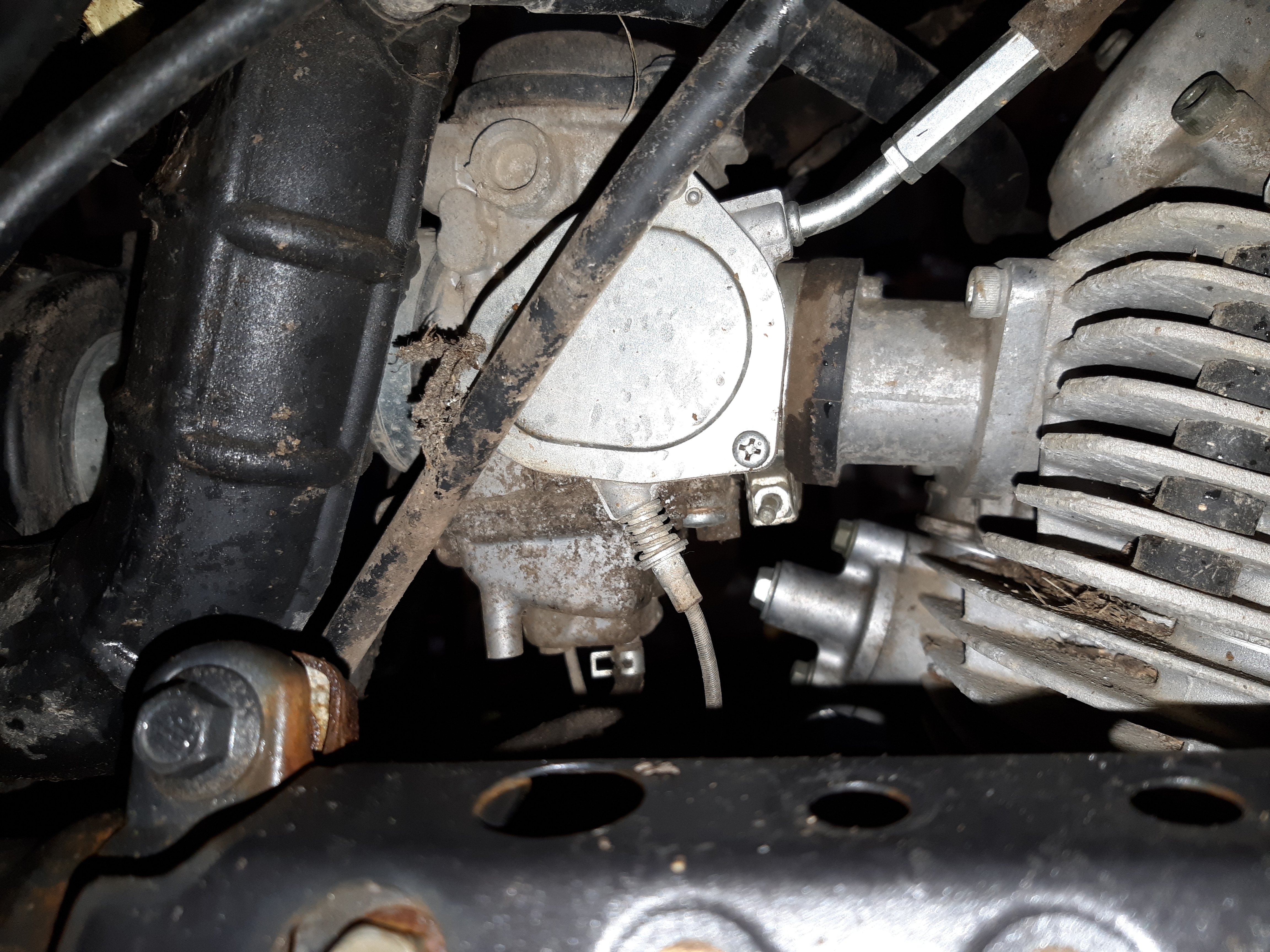

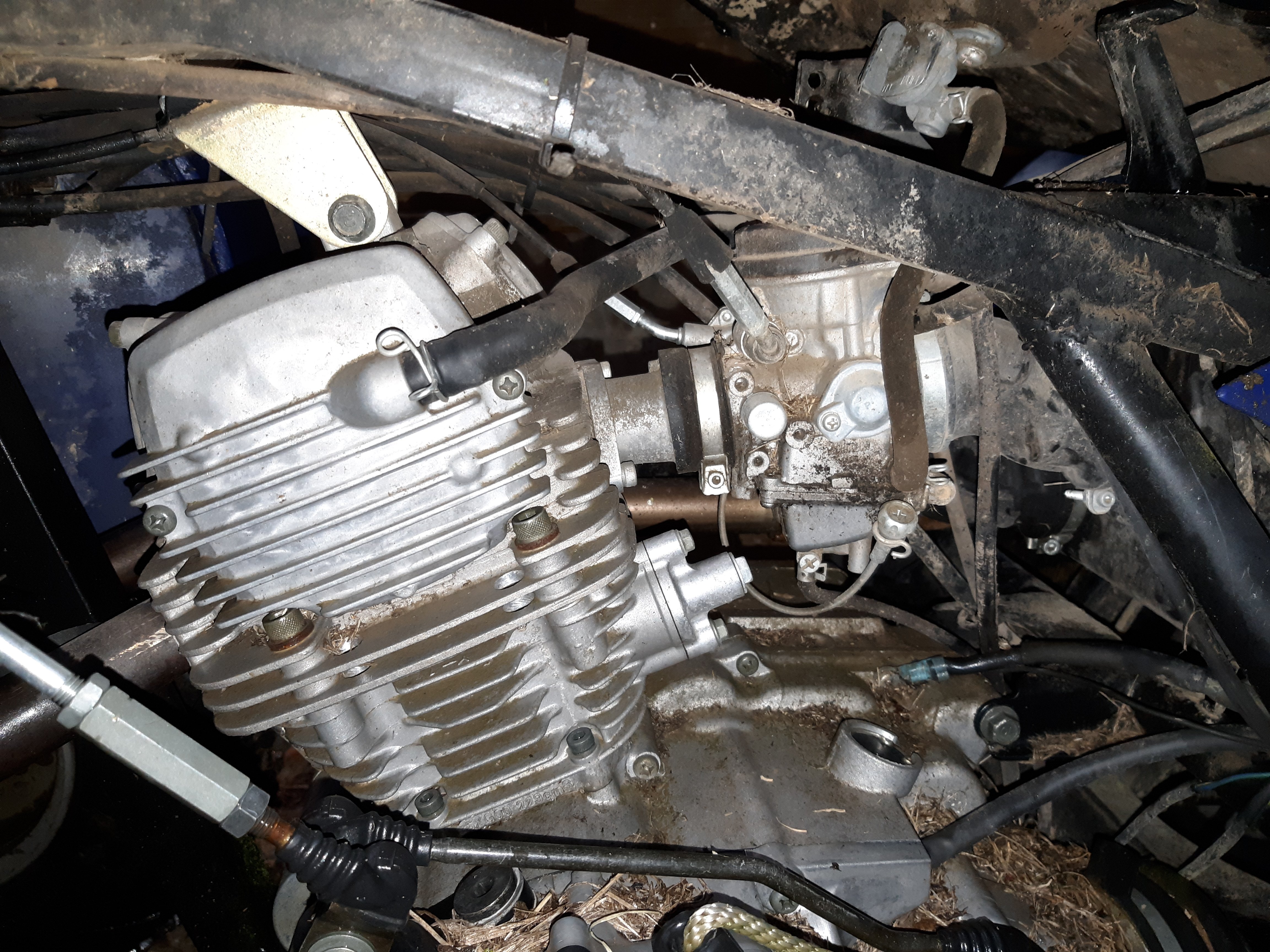

It's been awhile since I have posted, I have changed some things out and had to put a hold on working on 4 wheeler when I had a horse with a serious leg injury had to be dealt with. So I ended up changing the carburetor, after cleaning the jets didn't help. Today I got everything hooked up and it did start, I had to adjust the idle to keep it running without holding the throttle open all the time. It rain great for about 5 minutes, heard a pop... not sure if it was a small backfire since it has sat for so long or if it is something else. Bear died and will not start again. I'm assuming since it ran, the hoses are all in the correct location
Back to working on the bear again. It ran for a few weeks last year but once again I put working on this 4 wheeler on hold. I bought another atv to use on the farm and dealt with the passing of my father. Sadly both 4 wheelers are down now lol. The Bear will crank but not start. It has spark to the spark plug.

Since it has been a while without running, and you have crank and spark, you have to go back to the carb again. It is probably clogged from sitting, even if it is just a few months old.
