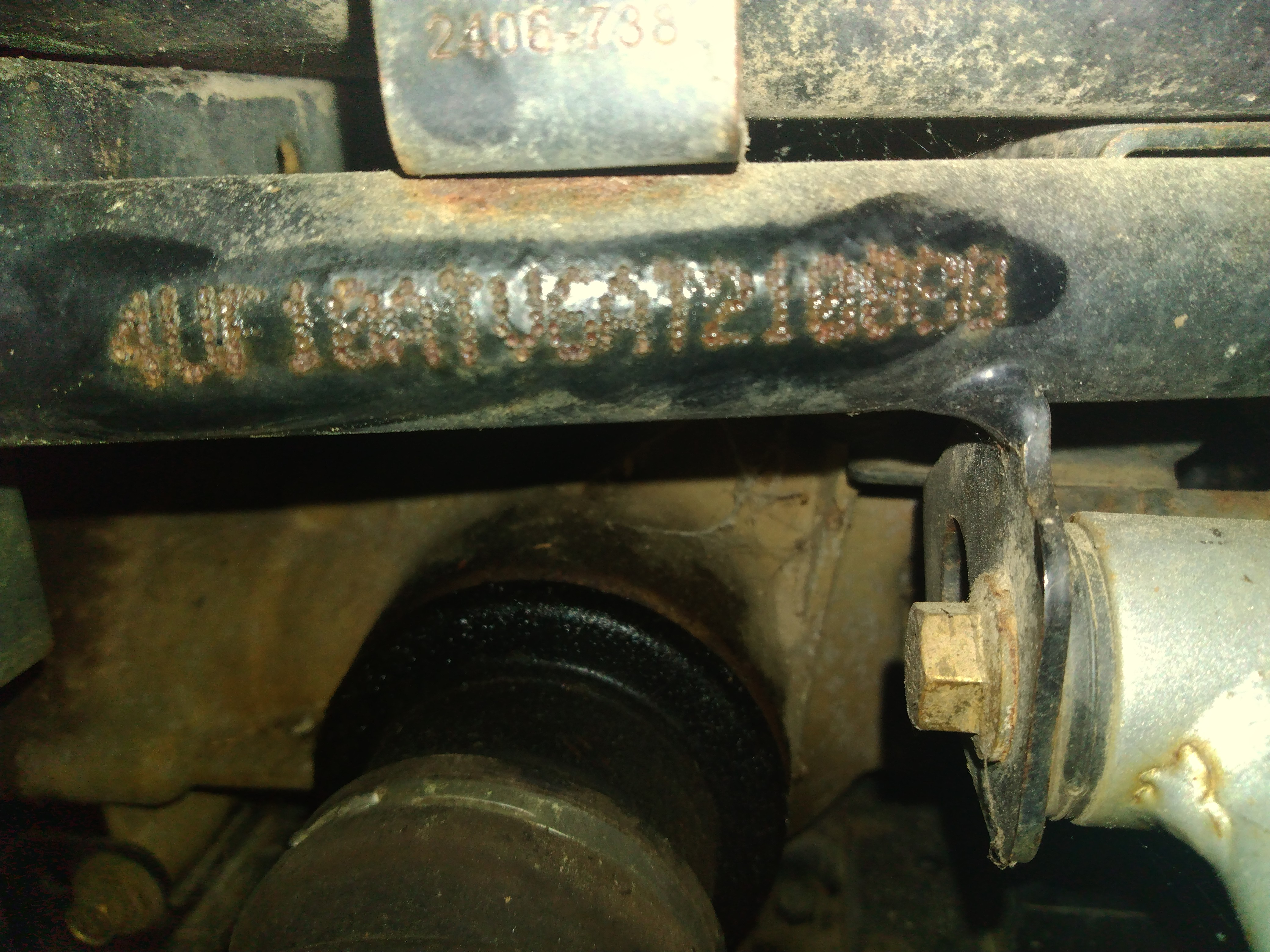

The first digit represents the country of origin. The most common are:
  • 1 or 4 = USA
  • 2 = Canada
  • 3 = Mexico
  • J = Japan
  • K = Korea
  • E = England
  • W = Germany
  • Z = Italy
2nd and 3rd letters signify Arctic Cat
4th and 5th are model year
6-8 are type (SNW snowmobile, ATV, MPV prowler etc)
9th is a check digit
10th is the last digit of the year (9 = 2009, A=2010, B=2011, C=2012 etc)
11th is a "T" This one I don't know why, just that its always a "T"
12-17 are the "serial number"
Your  Cat was made in 2010
