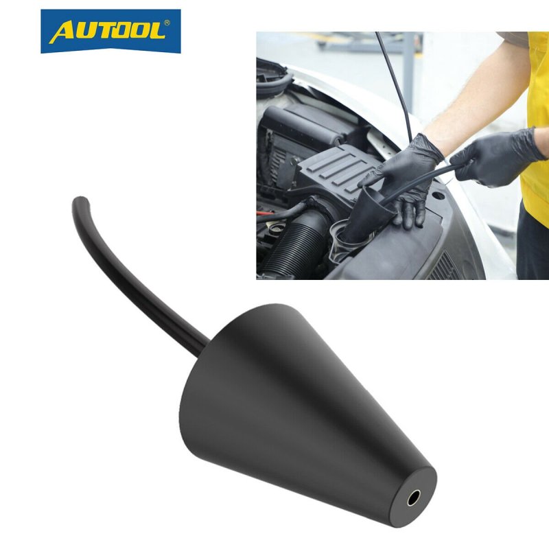

I watched some videos on youtube and the mechanic highly recommends this tool (i found one for $15 +$5 shipping from china)

This attachment is sold separate from 'Autoline pro' i found one for $20 + $5 shipping/ i only just learned about smoke machines yesterday from a youtube video and having a hard time visualizing what this would do
