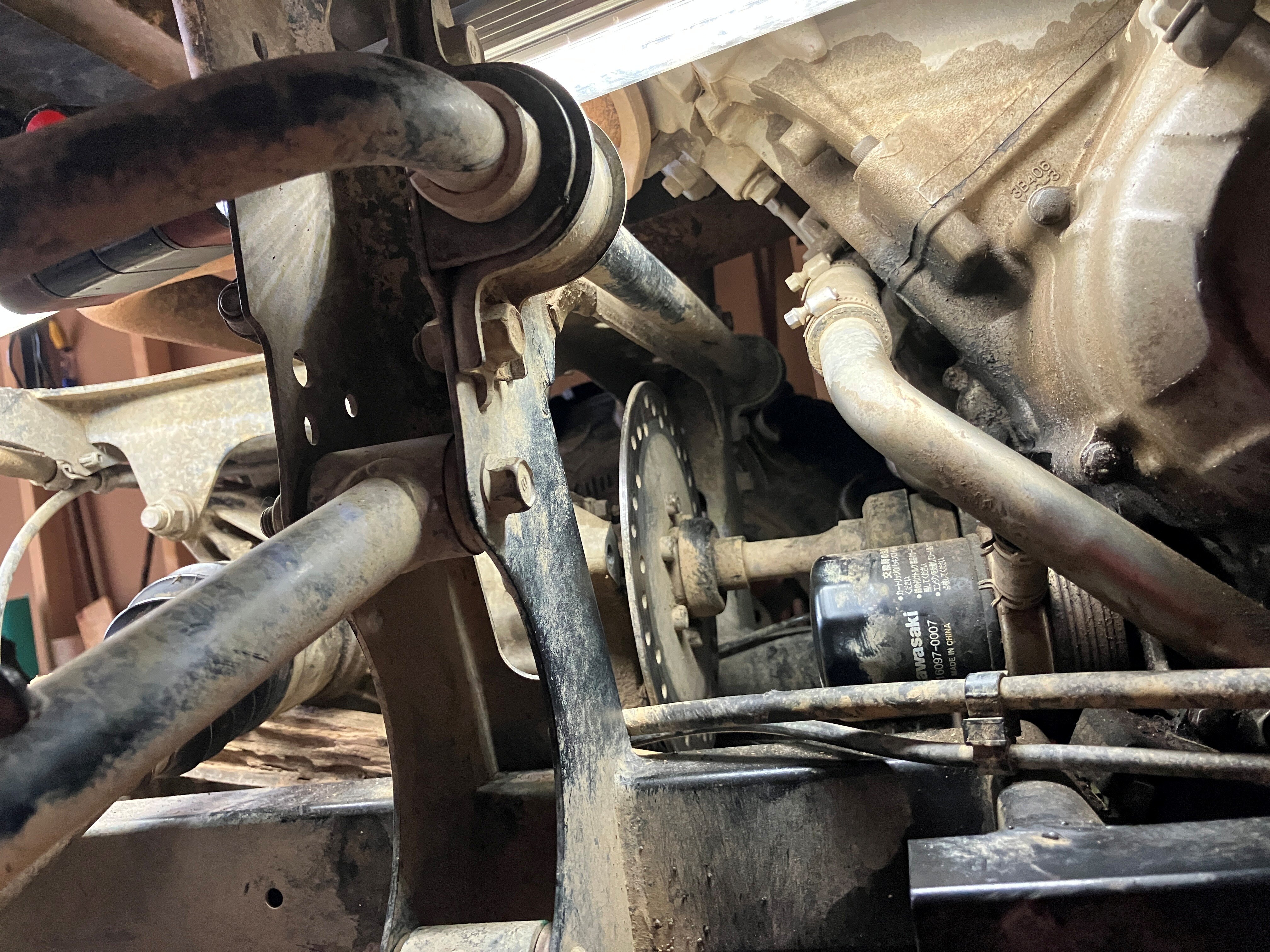

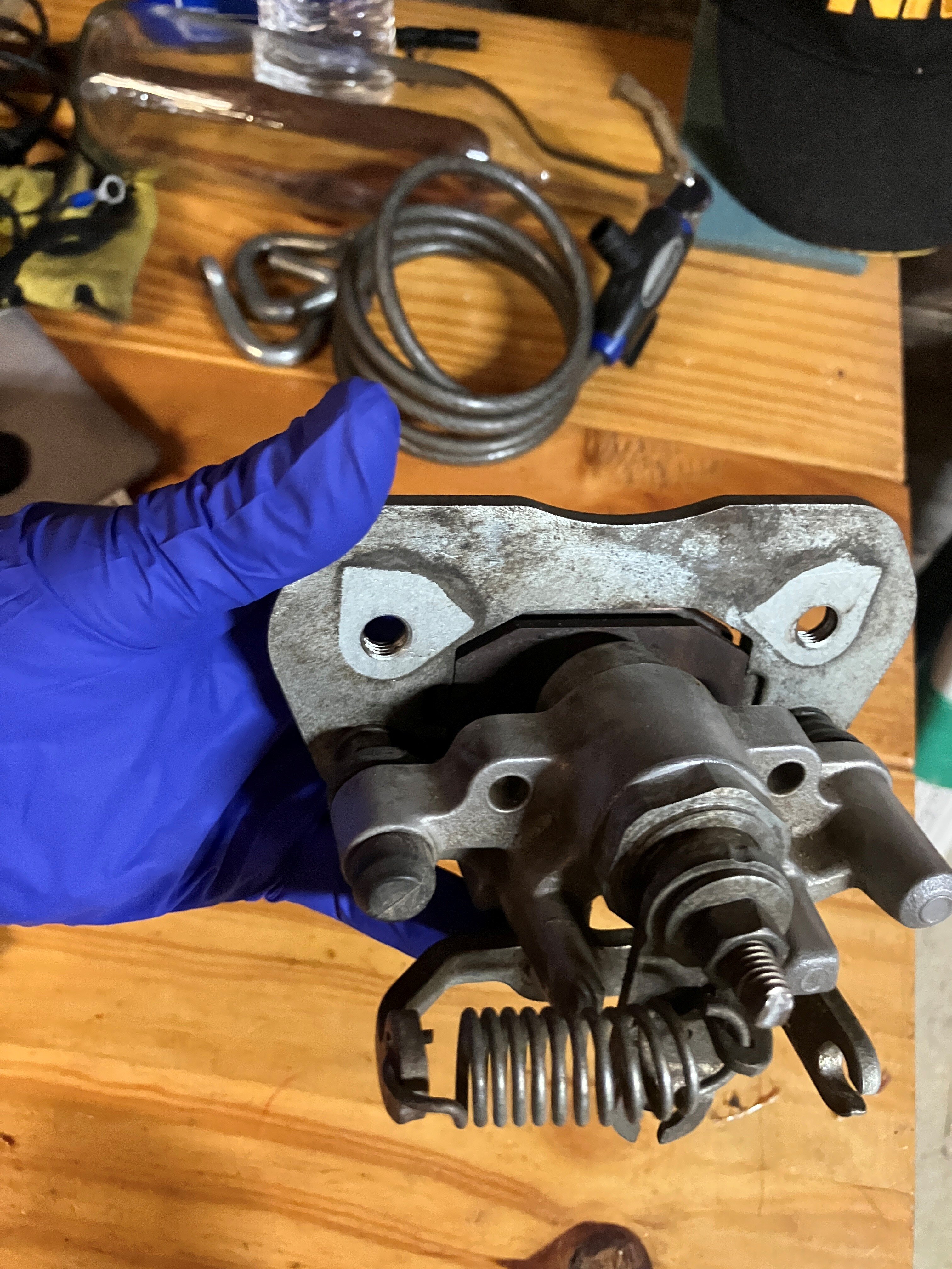

Almost got ran over by Mr always ready...Viking SXSX700..Removed parking brake and found one pad missing. Caliper mechanism does not appear to move.
I soaked the caliper for 3 days to get two pad holdeer allen bolts out.
Here is better pic.
Oh! You said you cleaned the caliper, if it has a caliper it is hydraulic, but you are right parking brakes are not hydraulic, does it have a drum rear brake that is usually where the parking brake is . It would have a cable that keeps the brake held against the drum when you push or pull on it.. I am working on brakes myself and the rear is a drum, what a nightmare, years of corrosion mud and rust. i will have to create a post for the adventures ia m having. If it has a mechanical piston ,that is new to me, but i dont work on UTVs much.

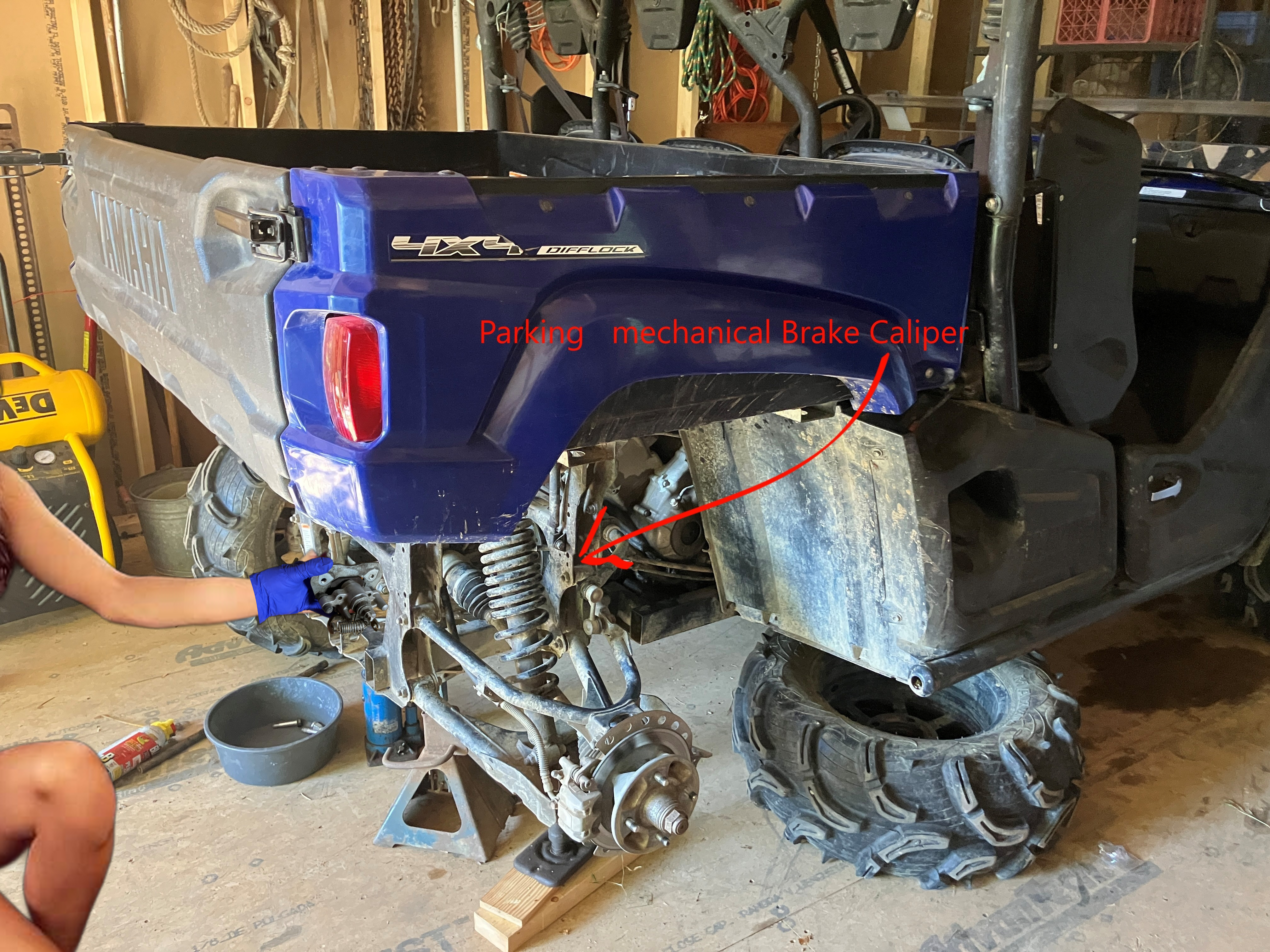

No the wheel brakes are hydralic. The parking brake is  a seperate "Disk"  on drive shaft.  It is a Caliper or disk brake with two brake pads.  However, the parking brake cable caable pulls th caliper closed then a spring pulls the brake open when parking brake is released.
I took a closer look at your photos, not really familiar with that system, but the caliper should move may just need to soak it good with PB Blaster and let it sit overnight, it should only be spring loaded, no brake fluid to cause corrosion and gunk in there . Nothing appears to be broken, its a fairly simple set up not sure why its not working. I would say just replace the pads it might take more strength to move it, out of the machine, than can be applied, or either something is broken internally. Maybe for piece of mind you should just replace it, but i would try putting it back on the machine and trying it first.
Yeah Mr Always Ready would have been on top of me if I had not jumped away.   I made wheel chock blocks as on hills it is best to have chocks.  The pads are only $8 a set but the replacement caliper is $290+

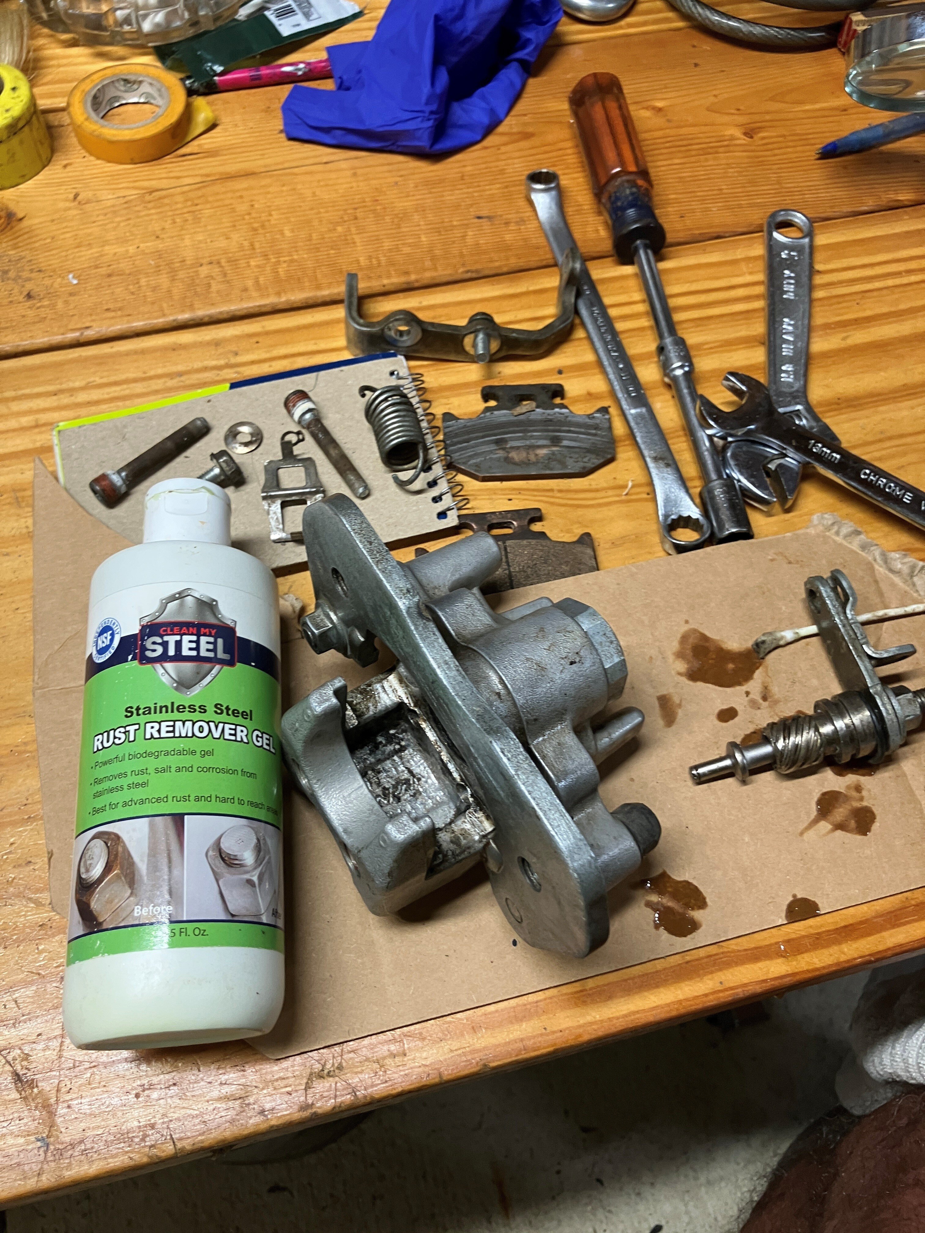

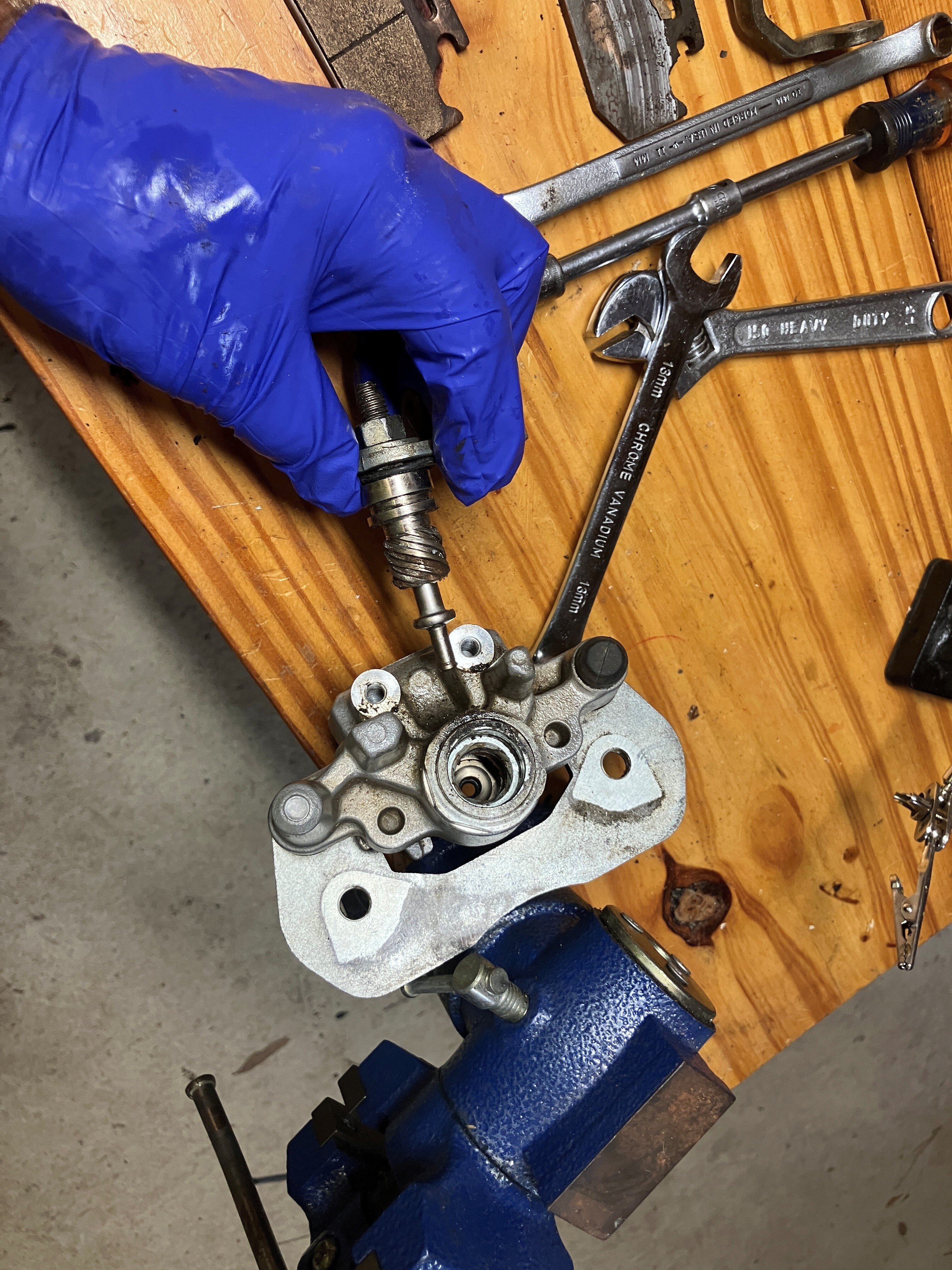

OK got new caliper ordered.  But I took old one apart.  You can see the what-cha-ma-call-it that fits inside the thing -a bob is rusted!  That is why it would not retract the brake caliper.  I yse thisSS rust remover a lot on ferrous metal. image.thumb.jpeg.5651fe9a2b18e4566af17f3fccb1e2a8.jpeg

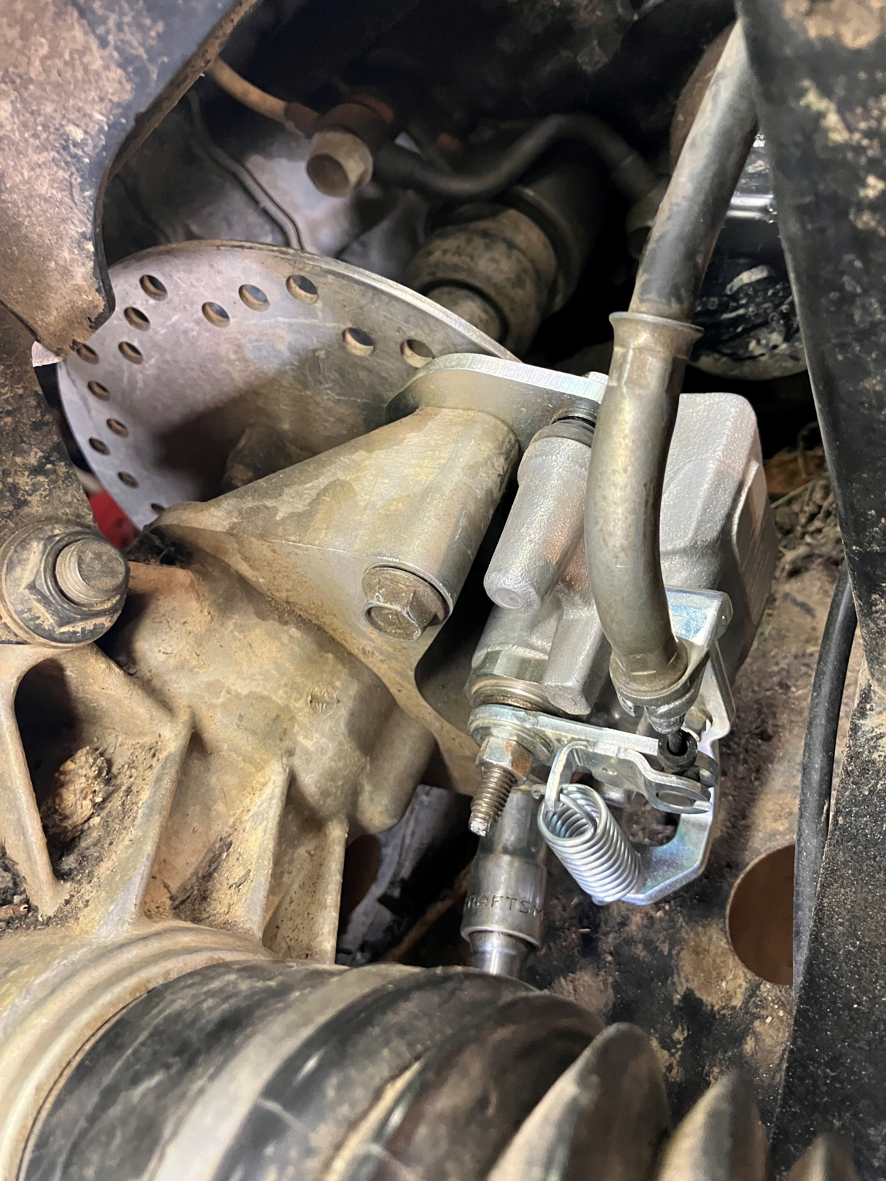

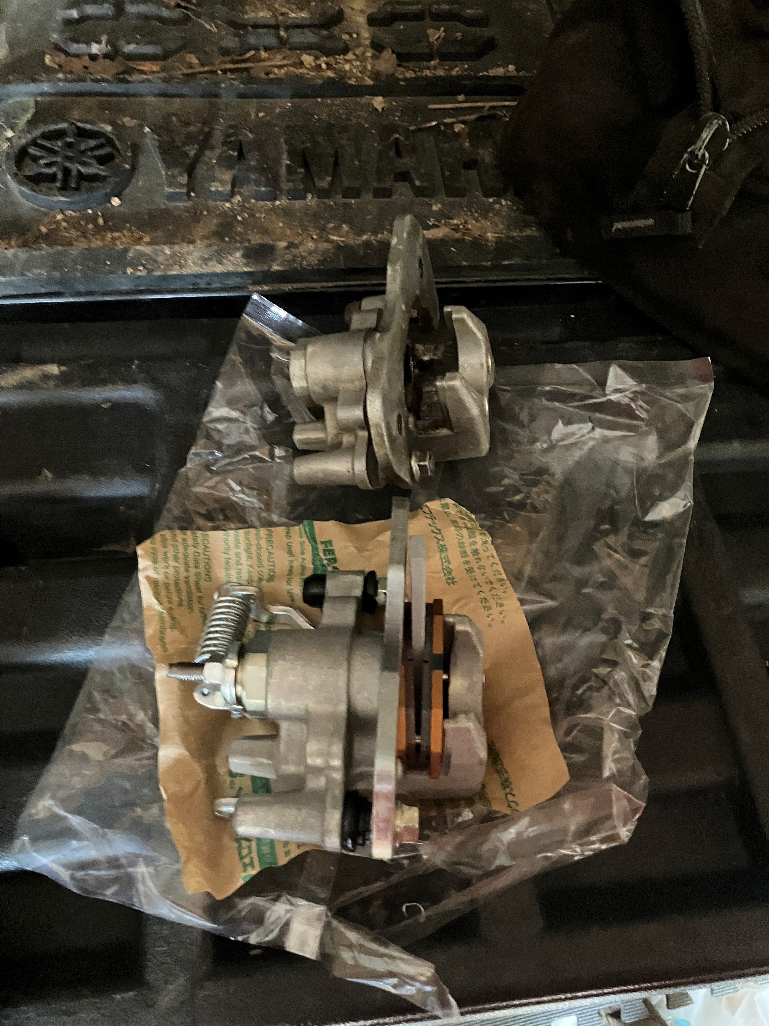

I got the new parking brake caliper...it was loaded.  Installing it was farily easy  30minute job after I spent an hour and a half figuring out how to maneuver the caliper into position. The first pic is the Parking brake rotor with caliper installed.  Second is old caliper and new.  Last is the Rotor before installing new caliper.   Adjusting is easy and can be done wuthout jacking Mr Alays ready up...image.thumb.jpeg.67fb7ad72f9c526430a46d9094fcd01f.jpegimage.thumb.jpeg.106fa15d611424e1cb0d2eb9d9c31306.jpeg
