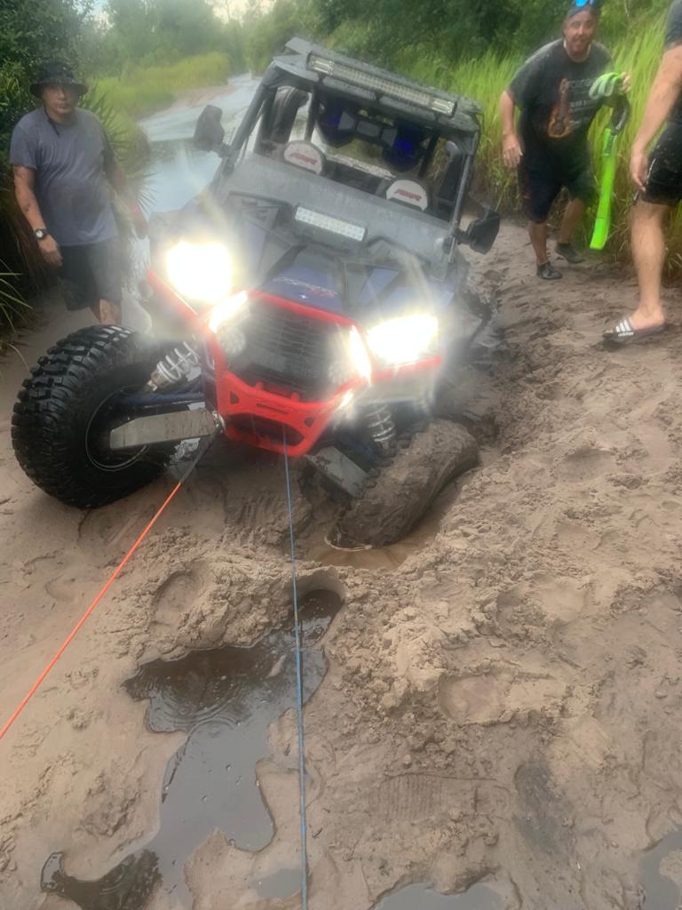

Just my 2 cents worth, but the picture he shows of the stuck  Polaris is hilarious to anyone who  has driven  4x4s / ridden ATVs in the gumbo we have in north central Bc and farther north,  Those people standing around the  ATV would have about 20  pounds of mud on each foot . Where they are looks more like a fine sand than mud.   Since that appears to have an open differential  in front (  back  also?) it is at best 3 wheel drive since if one tire loses traction on front there is no more pull there .  If the rear diff is also open the same goes for there. I would hazard a guess that if the machine had locking differentials front and back it would easily have handled that hole.  Sorry , but that ground doesn't look like it is slippery at all; wet and soft , maybe , but not really a challenge to  all wheel  drive or on demand 4x4 with at least a locked or locking rear differential.  As far as the belt shredding goes, I strongly suspect it is the driver or mechanic's fault far more than the clutch set manufacturer's.   The posts and claims  by Keys  has that familiar farm  smell to me.
Good morning Mech and all,
Mech as ya still seem to think I am doggin STM an y'alls other comments about " easy Riding " let's take your earier suggestion and put this to rest once an for all, and I know how to do exactly that.
First, if you read my comments above that pic you would of seen that my true goal was to actually have Dustin an I figure this out as it would give him an his company another great tool to use for their sales and I would achieve my goal also. I actually invited Dustin to come out an visit and no comment was ever made.

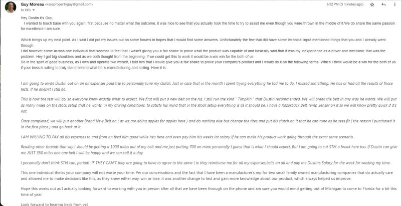

In my first thread,when laying out my issues I maintained that I was convinced to buy a product that wasn't made for what they knew it was going to be used for period.
MECH feels I am not giving the manufacturer a fair shake, fair enough. As I feel that I have a decent repro with Dustin ( STM Tech and racer himself)  here is what I am going to propose to them an ya'll will see a copy of the email I send.
As I previously mentioned, I just got done putting over 700 miles on the belt that's on my rig still now in the mountains of West Virginia.  So yes I am still standing on the fact that my rig, and driving style are just fine and it's the STM clutch, so here we go.
I am going to invite Dustin out on an all expenses paid trip to personally tune my clutch. Just in case that in the month I spent trying everything he tod me to do, I missed something. He has or had all the results of those tests. If he doesn't I still do.
This is how the test will go, so everyone know exactly what to expect. We first will put a new belt on the rig. I still run the kind " Timpkin " that Dustin recommended. We will break the belt in any way he wants. We will put as many miles on the stock setup that he wants. in my driving conditions, to satisfy his mind that in the stock setup everything is as it should be. I have a Razorback Belt Temp Sensor on it so we will know pretty quick if it's not.
Once completed, we will put another Brand New Belt on ( as we are doing apples for apples here ) and do nothing else but change the tires and put his clutch on it that he can tune as he sees fit ( the reason I purchased it in the first place ) and go back at it.
I AM WILLING TO PAY all his expenses to and from an feed him good while he's here and even pay him his weeks lot salary if he can make his product work going through the exact same scenario.
Reading other threads that say I should be getting a 1000 miles out of my belt and me just putting 700 on mine personally I guess that is what I should expect, But I am going to cut STM a break here too. If Dustin can give me JUST 350 miles one one belt I will be happy and we can call it a day.
I personally don't think STM can, period!  IF THEY CAN'T they are going to have to agree to the same ( ie they reimburse me for all my expenses,belts an all and pay me Dustin's Salary for the week for wasting my time.
FYI, for all concerned, bsck in the day that was daily business for me, when people used to challenge me on the product I represented for my manufacturer. The difference,  I believed in, an knew exactly what my company's product would and wouldn't do and I wouldn't lead people just for a sale an say sorry when things didn't work out.
Stay tuned Mech and I guess we'll see just how much they believe in what they sell.
I personally hope they do, as Dustin seems like a real cool guy and win or loss I am sure we will have a BLAST
If that isn't giving them a fair shake I don't know what is?  As I am not asking them to do anything I haven't personally done myself.

As I promised here is a copy of the email I just sent to Dustin at STM.  I will keep y'all informed of my progress. Come on Mech don't be a hater!  I see an opportunity to turn a problem into a success story. Otherwise I would not invest the time. If you don't want to consider me a friend or whatever that is fine. I happen to think all people have value and something good to offer no matter what the circumstance. You got to stop being apart of the problem and be apart of the solution, and that doesn't mean writing people off. I happen to believe there is one and I know if I get a chance to work with Dustin we can probably find one that will help us both out. Doesn't that make sense?
